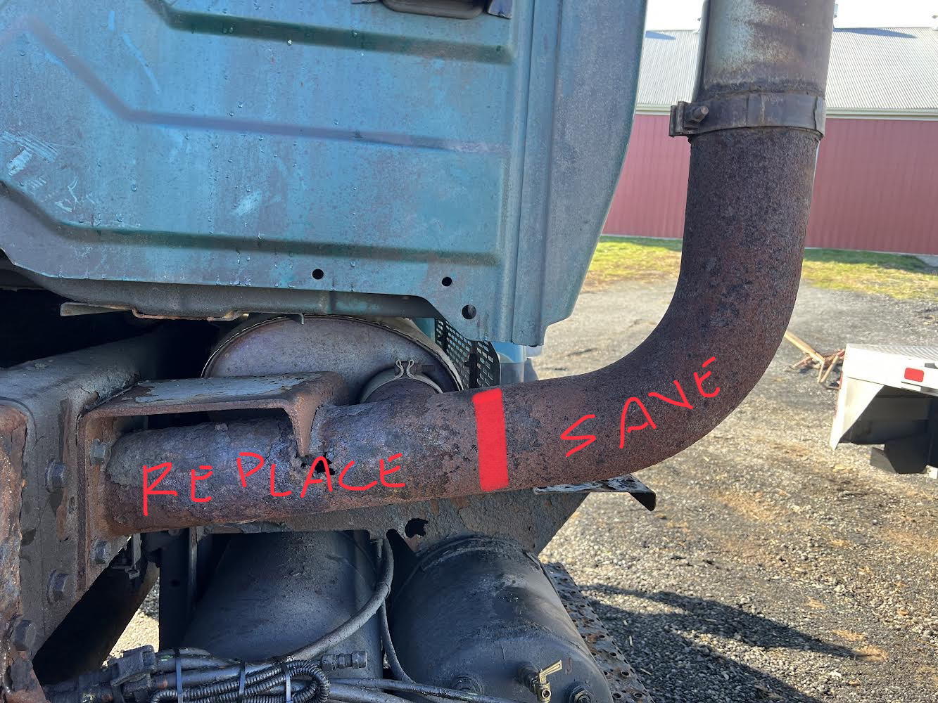

Here’s the plan on the exhaust:
International wants $900 for the piece to the clamp.
That price doesn’t even include the 5” basic stack!!
Sheesh, they're really proud of that piece aren't they. For that it should come with free install FFS.

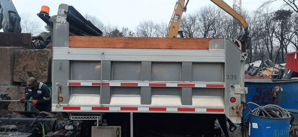

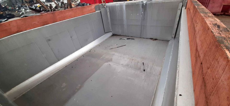

Beautiful 10’ Aluminum state truck bodies for 6K.
Would sell for 20K today
   / New (used) IH 7500 Dump Truck purchase, modification & fix up
#148
They are nice looking, they're used?. Only good for cotton balls and topsoil IMHO :)
Yeah I keep thinking the floor & sides could be lined with steel sheet, but then I get my reality check….
Maybe I have to start re-thinking this :unsure:
