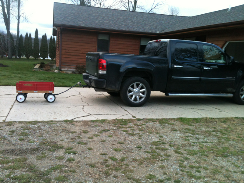

Diamondpilot said:
Pulling what, your kids little red wagon? No matter what pulling any load is going to affect mpg. Your dash is lying to you. Hitch up your load and start with a full tank of fuel then tow it 100 miles and fill up again and do the math. Pulling any load over 8, 000# you will be lucky to see double digest no matter what brand of truck.
Chris
You got me. I pulled it 100 miles. Yup, still 16.4 mpg. I don't have a tractor over #8000, should I put some rocks in it and try again?
Sent from my iPad using TractorByNet
<img src="http://www.tractorbynet.com/forums/attachment.php?attachmentid=292404"/>
Love it... lol
In all serious I have owned two GM trucks, a Toyota, nine Fords, a Dodge, and a Nissan. All 4x4 except one, and four diesel. These are all 1997 and newer and I drive about 20,000 miles a year in each and tow loads from 7,000# to 25,000# about 5,000 miles a year or more and track every drop of fuel for business purposes. Its just the way it works while towing.
Chris
What, not WD, chains and anti-sway bars?...Living dangerously. :D:shocked:
I get similar empty mileage with my '11 GMC 6.2...Mind does around 12-13 towing depending on the what's and where's. I get about 1mpg worse with my gate trailers due to the drag.....I can live with that.
