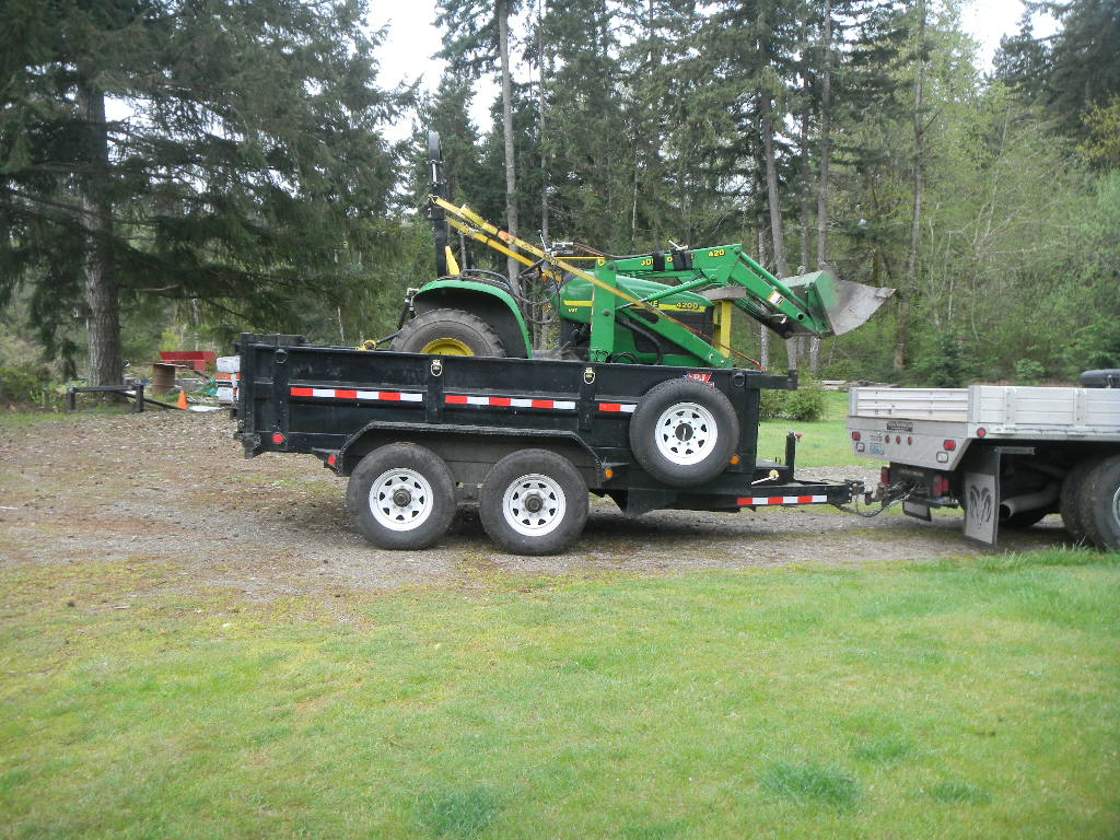

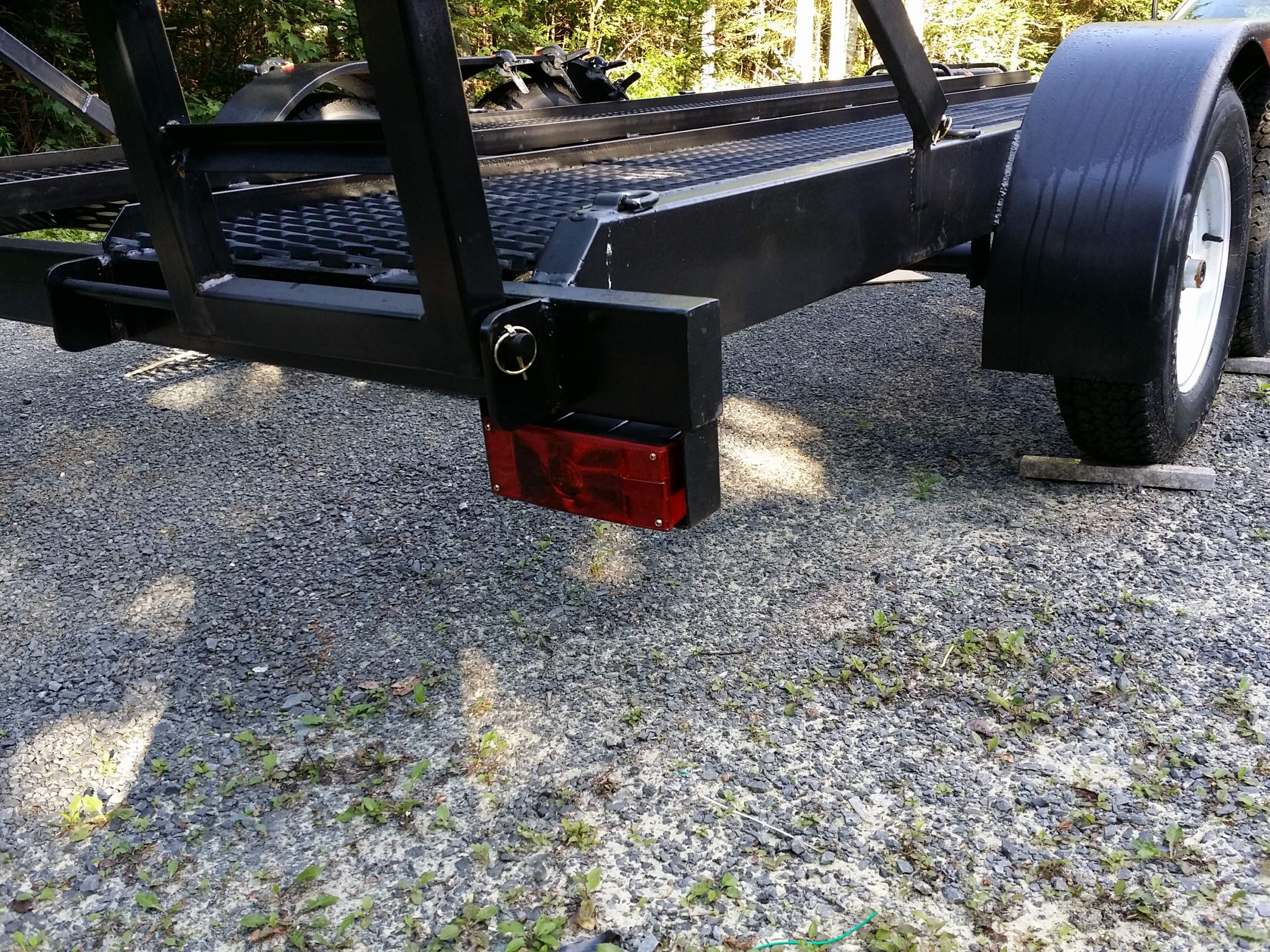

Those supports look like a good idea but how well do they work if on unlevel ground... say the ground is higher at the back end of the trailer being higher than at the wheels? Just wondering.
I did not say I liked the way some trailer ramps are made. The trailer I attached belongs to another member, Not me. I just posted to show pjb09 what I was talking about. When I had a trailer like that I always hunted for a level spot to load or unload.
Mark, that's why I mentioned the ramp feet to pjb. I have been on a few of those wild rides in the past. Personally I own a 20' tilt bed trailer and a 24' enclosed trailer for vehicles and a 16' dump trailer. No ramps on the tilt bed, back drops completely to ground for easy loading. If I were to have a non tilt bed for vehicles I would install the swing down adjustable jacks on the back sides of the trailer like pjb is going to do.

Thanks... sorry for the newbie questions. I am quite familiar with double axle trailers for boats but I haven't had the pleasure of using a trailer for a tractor or loading heavy stuff on land! I am probably going to buy a trailer at some point for my BX as I think it is a little too ambitious of a weld project for me (at least any time soon). Regardless, I sure want to know the advantages/shortcomings of particular designs.

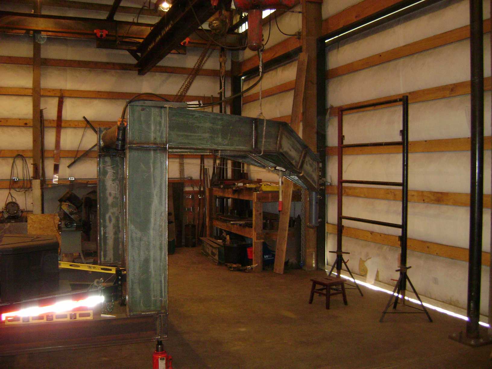

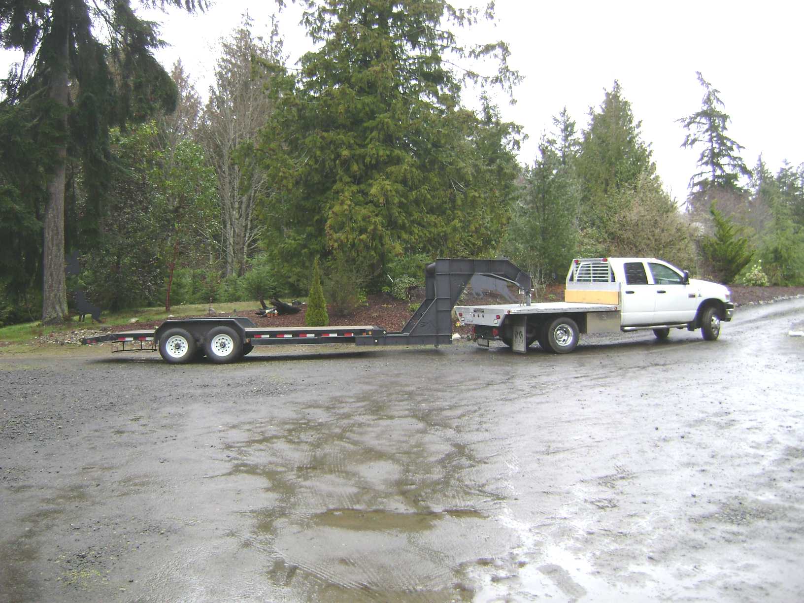

I'd give you hand building it, you could use my shop too;). But trust me you can't buy the steel for what a new trailer will cost. Then the cost of paint will just floor you.
When I built my gooseneck adapter for my flatbed trailer I got a screaming deal on the beams off Craigs list up in your old stomping grounds. When it was all said and done, not counting my labor I saved $600.00 over buying new.:rolleyes:

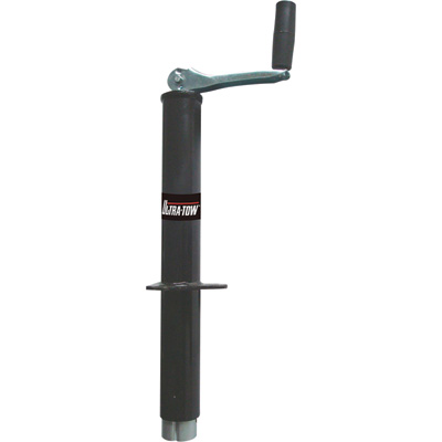

If you really want to get clever, put a tongue jack on each rear corner. Each side is now infinitely adjustable for slope both fore-and-aft and side-to-side.
Sixteen bucks each at Northern Tool

That's good stuff and add a foot pad for us folk that live in soggy weather! :laughing:

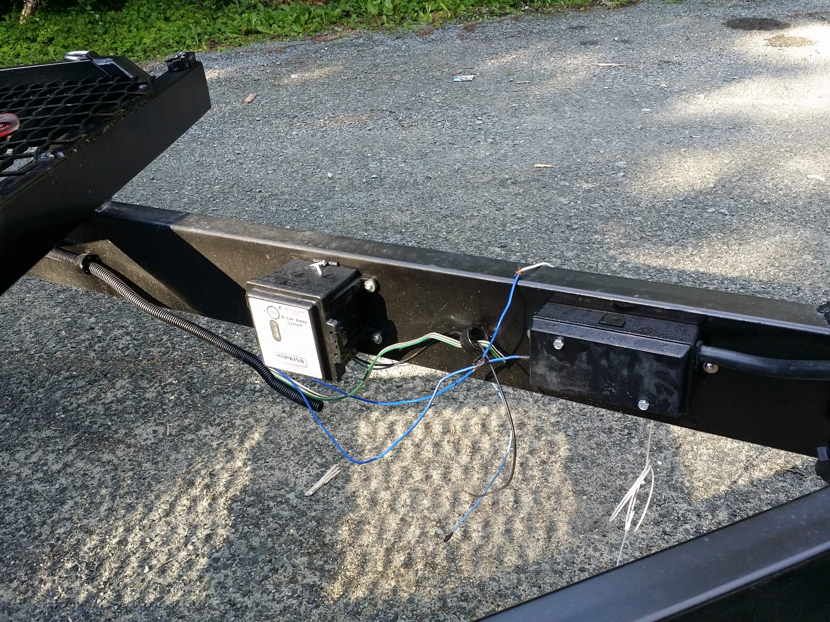

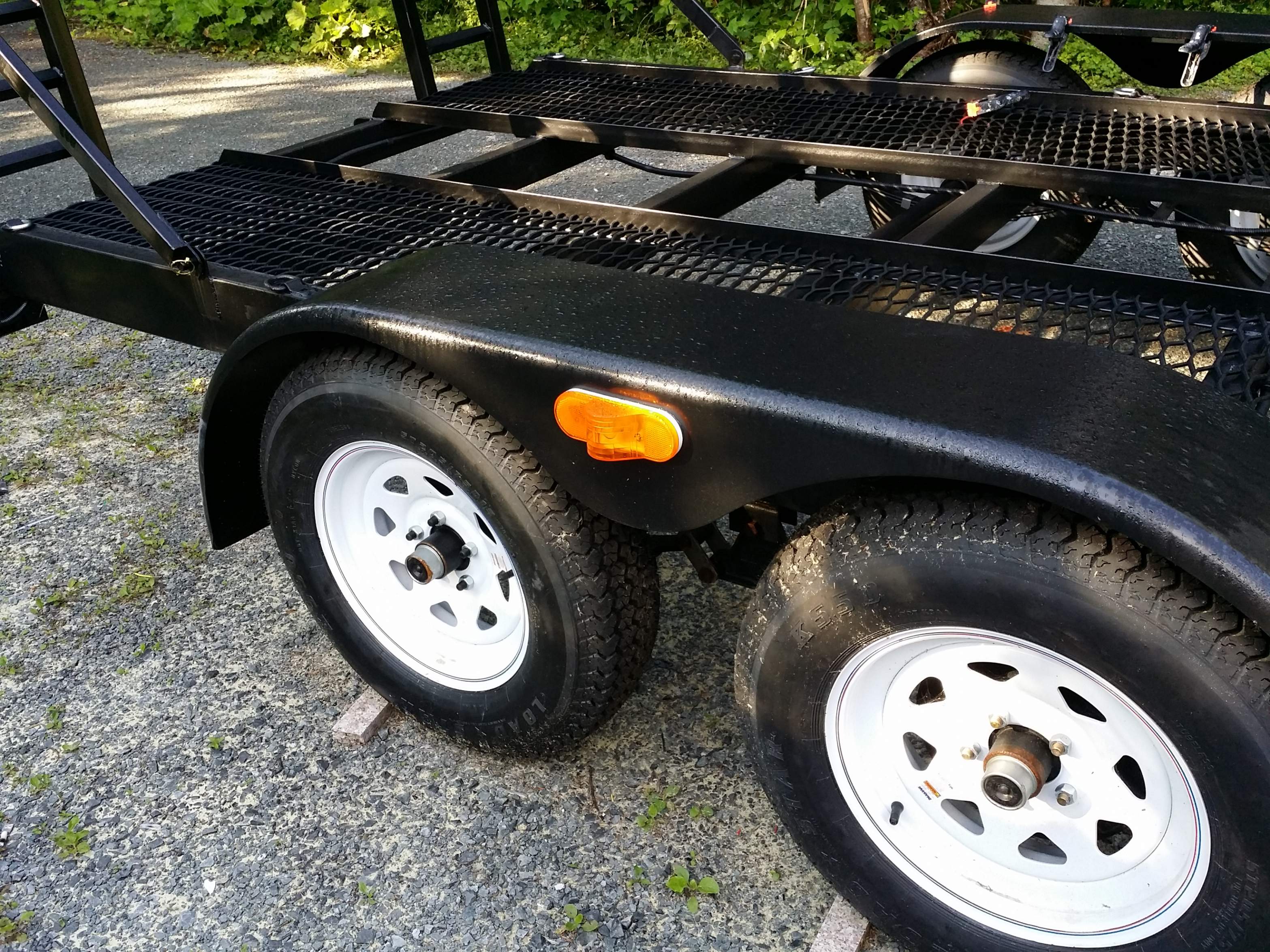

Just a few wire connections to make and it's ready for safety20140812_083747.jpg20140812_083902.jpg

Would using a roller have worked better for painting the expanded steel? I know it's not "proper", but may have wasted less and covered better.
