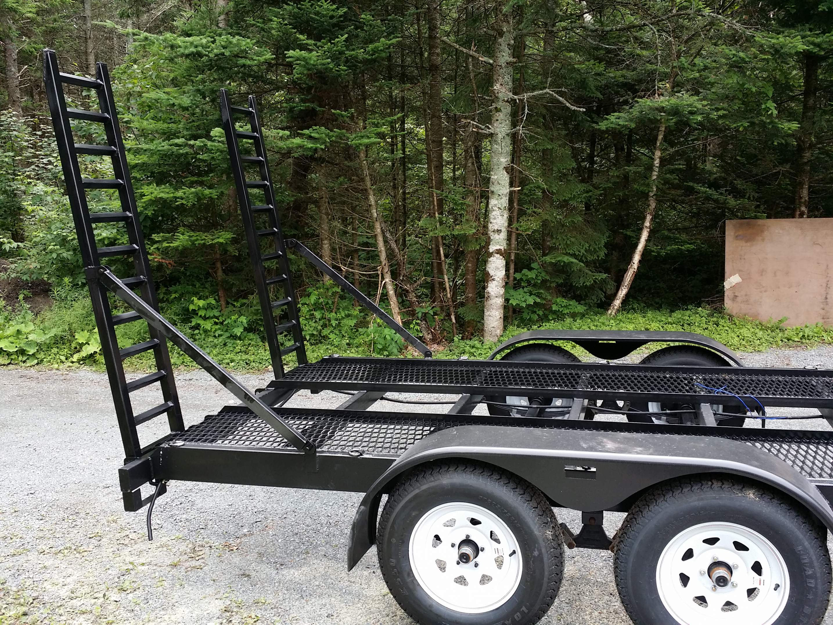

Finally got around to finishing the ramps and installing them. 20140731_143600.jpg
/ New trailer build #74
Finally got around to finishing the ramps and installing them.View attachment 384720
Looking good.
Since the ramps are already painted I guess your not going to add support feet (like attached) or you can add swing down rear trailer support stands to the trailer frame. They will prevent whatever you are driving up the ramps from pushing the back of the trailer down resulting in the front of the trailer lifting the tow vehicle.

Looking good.
Since the ramps are already painted I guess your not going to add support feet (like attached) or you can add swing down rear trailer support stands to the trailer frame. They will prevent whatever you are driving up the ramps from pushing the back of the trailer down resulting in the front of the trailer lifting the tow vehicle.[/QUOTE
planning to add swing down stands similar to those on travel trailers.

Looking good. Since the ramps are already painted I guess your not going to add support feet (like attached) or you can add swing down rear trailer support stands to the trailer frame. They will prevent whatever you are driving up the ramps from pushing the back of the trailer down resulting in the front of the trailer lifting the tow vehicle.
Those supports look like a good idea but how well do they work if on unlevel ground... say the ground is higher at the back end of the trailer being higher than at the wheels? Just wondering.
Growing up in the heavy equipment business, I can't tell you how important it is to have all four vehicle wheels on the ground when loading. lol. If you've ever gone for a free ride down a hill with only the front wheels of the truck on the ground, it isn't that easy to steer if someone is on the backof the trailer holding on for dear life too....and front brakes on a 65 Ford flat bed one ton aren't that great to start with and when the engine isn't running....
Making the hinge points "double jointed" would help a bit for unlevel sites. Chocking trailer wheels is always a good idea also. Terry
