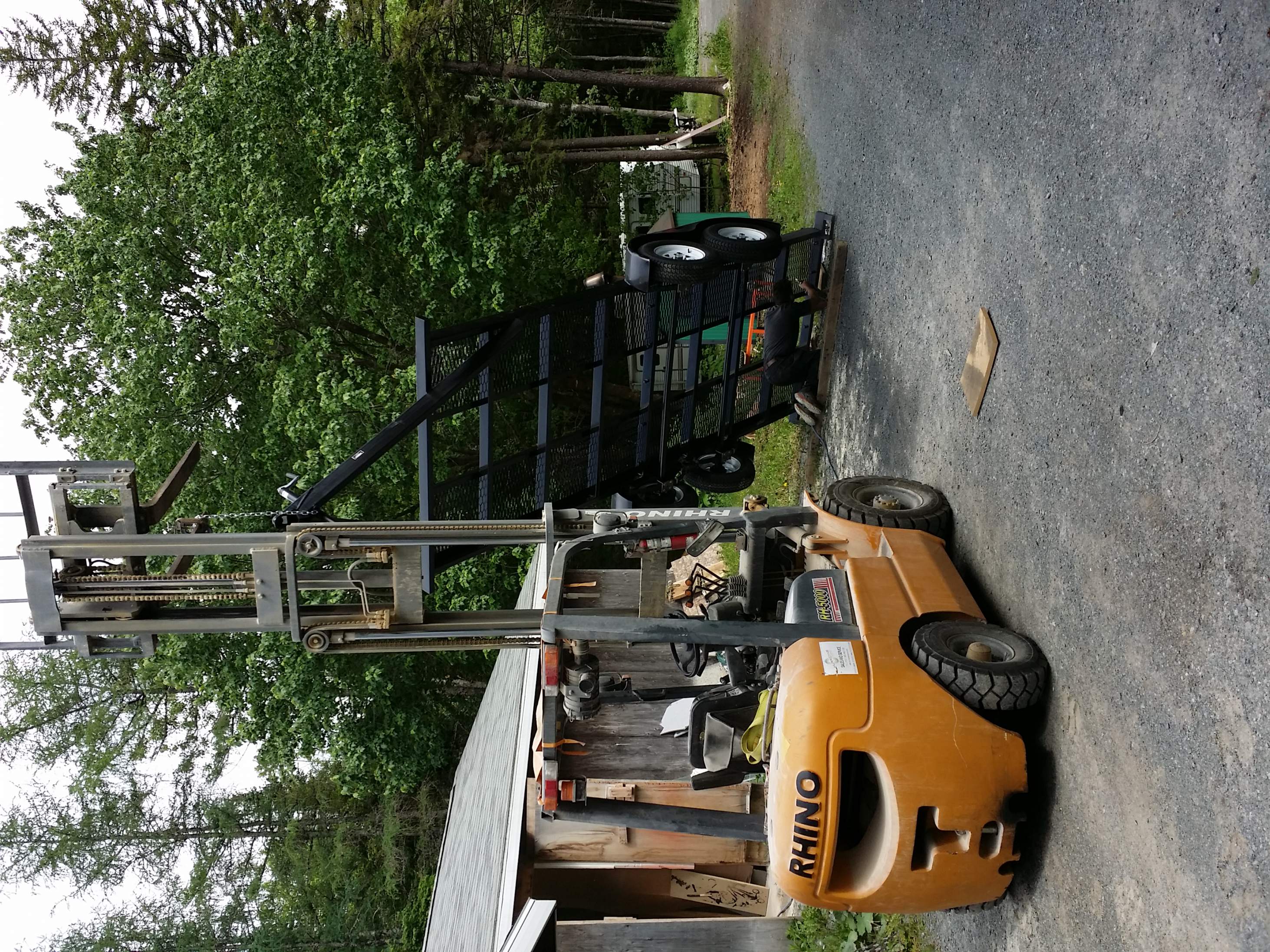

Painting the top of the deck was easy, but crawling around underneath with a spay gun wouldn't be much fun, so we made it easier.
/ New trailer build #67
Hey that's cheating! Nice job... I need a high bay and a lift. Don't think the wife is going to understand the benefits of a forklift. All my life I have been crawling, twisting, etc. Getting too old. :laughing:
