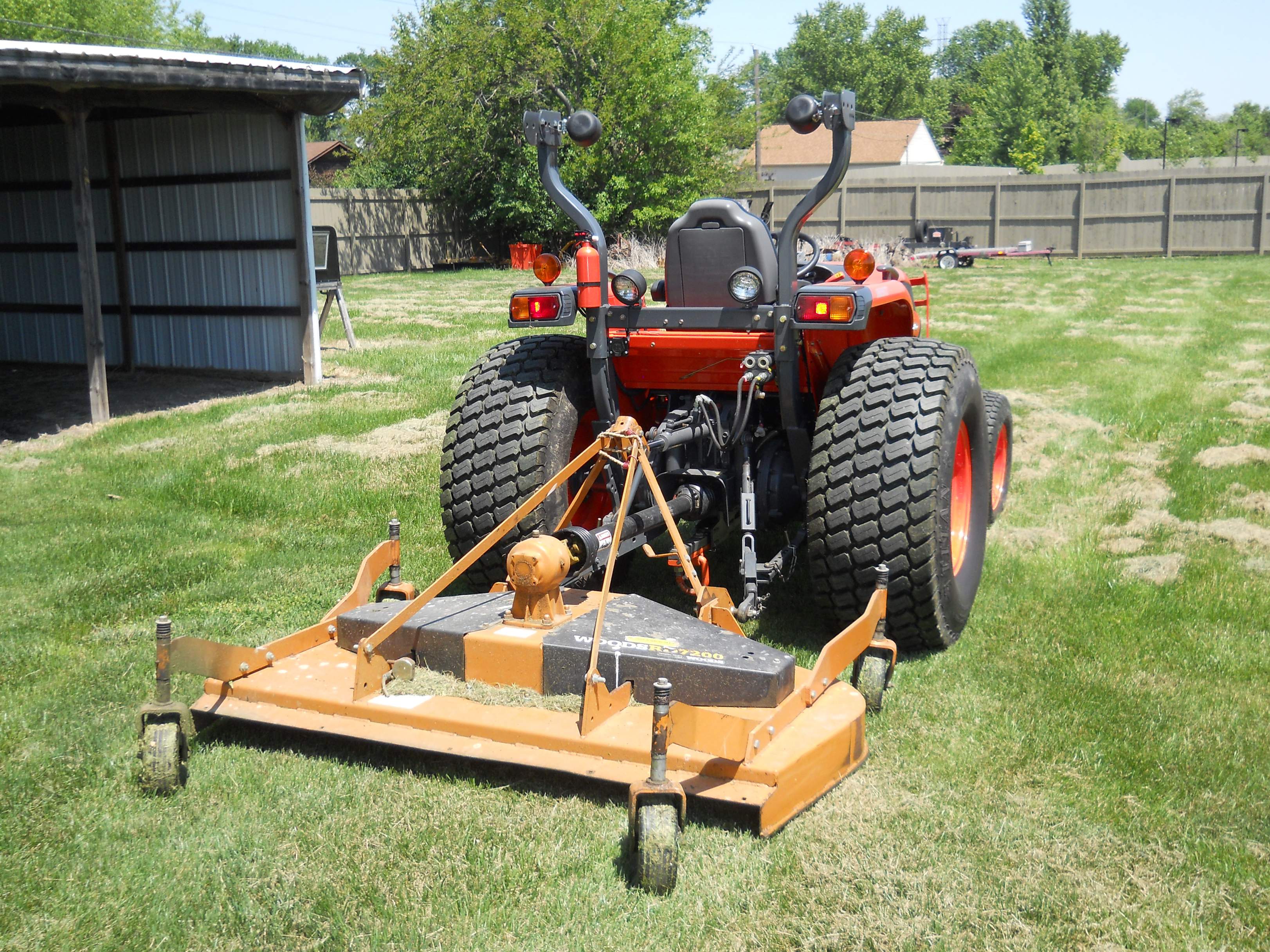

All motors are going to have some vibration, esecially a small diesel. One thing I do not like about the b series is no skid steer quick attach on the fel. A mid pto will reduce ground clerance. You could run a rear finish mower and a loader mounted snowblade, then a l would be a option. A grand l would be really heavy (6000lbs) for mowing your yard. If you are going to be doing much rough cut mowing I think you would be happier with a l sized tractor over a b sized tractor.
/ New tractor #11
3 cylinders engine have more vibration than 4 cylinder engines in my experience. The 4 cylinder engines in the GrandL have twin balance shafts installed, very smooth.
You could run a rear finish mower and a loader mounted snowblade.
Similar to what I do, works well.
I mow my yard around the house with a lawn mower. I use my GrandL to mow the outer grass areas. L3940 turf tires and rfm, does a great job, not too heavy, does not leave tire marks. Plus, turf tires are great in snow.
Philip
