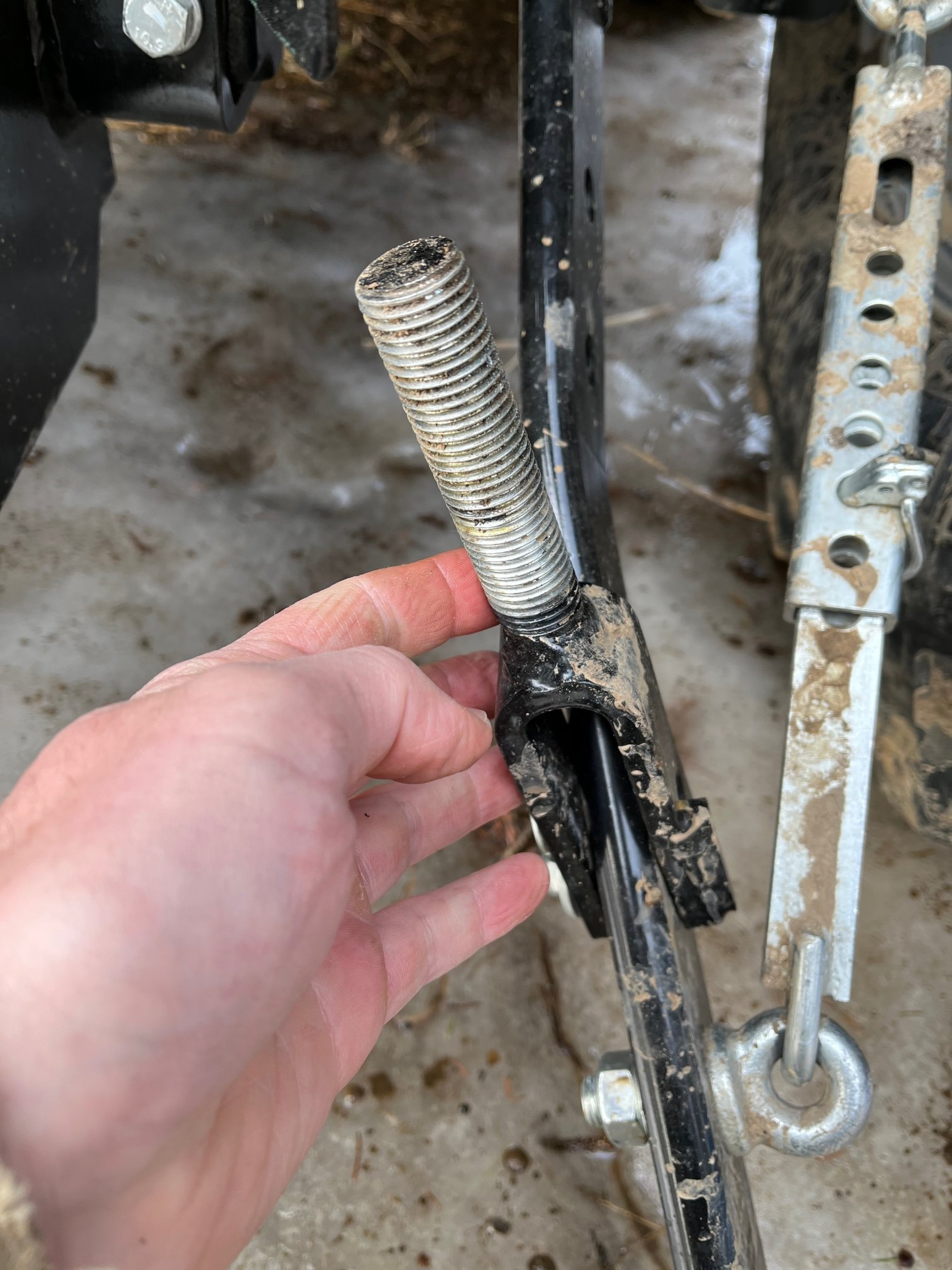

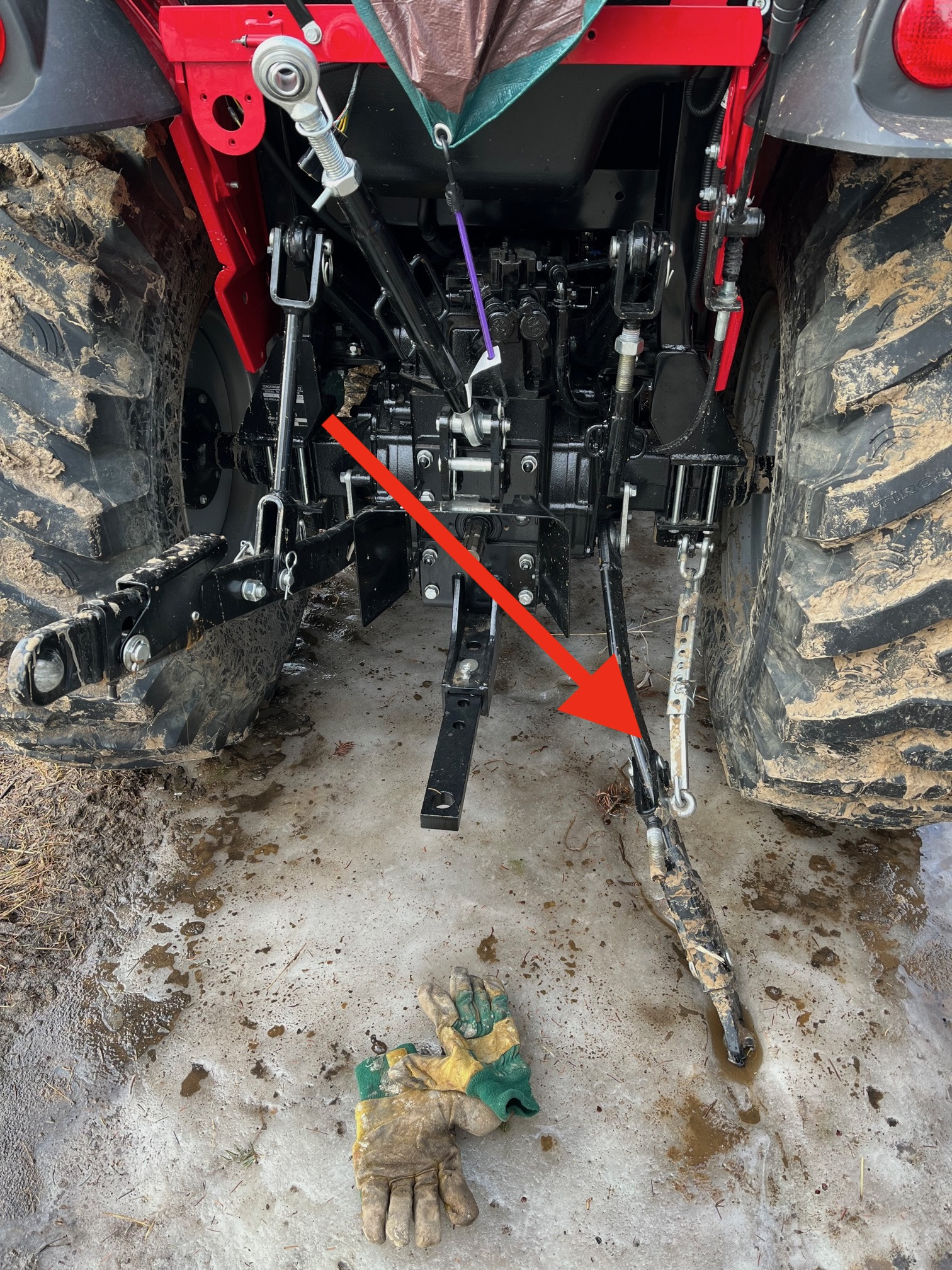

Just a guess. The 3-point arm came loose and dropped on the ground. It bent up when the tractor was backed up. A hammer will straighten out the bent sway arm.

Had the lug nuts come loose on my Kubota L6060 at about 100 hours. Check your lug nuts!
That happened to me one year. I came back from blowing snow and noticed what I thought was one loose nut. However, looking closer ALL of them were loose!! I ended up replacing the lugs because of damaged threads. Checked all the other lugs with a torque wrench and they were all tight. Glad I made it home with no other possible serious damage.

Agree that's probably how it happened but that would be one heck of a hammer ! I'd stop by a shop with an hydraulic press to straighten it (assuming the OP does not have a big press.)

I hate the fact that I make the assumptions/judgements I do but from the damage I would guess he does not. Might be a good idea to check the hind end of the tractor near the pins for the 3PT and make sure nothing moved/cracked there as well.

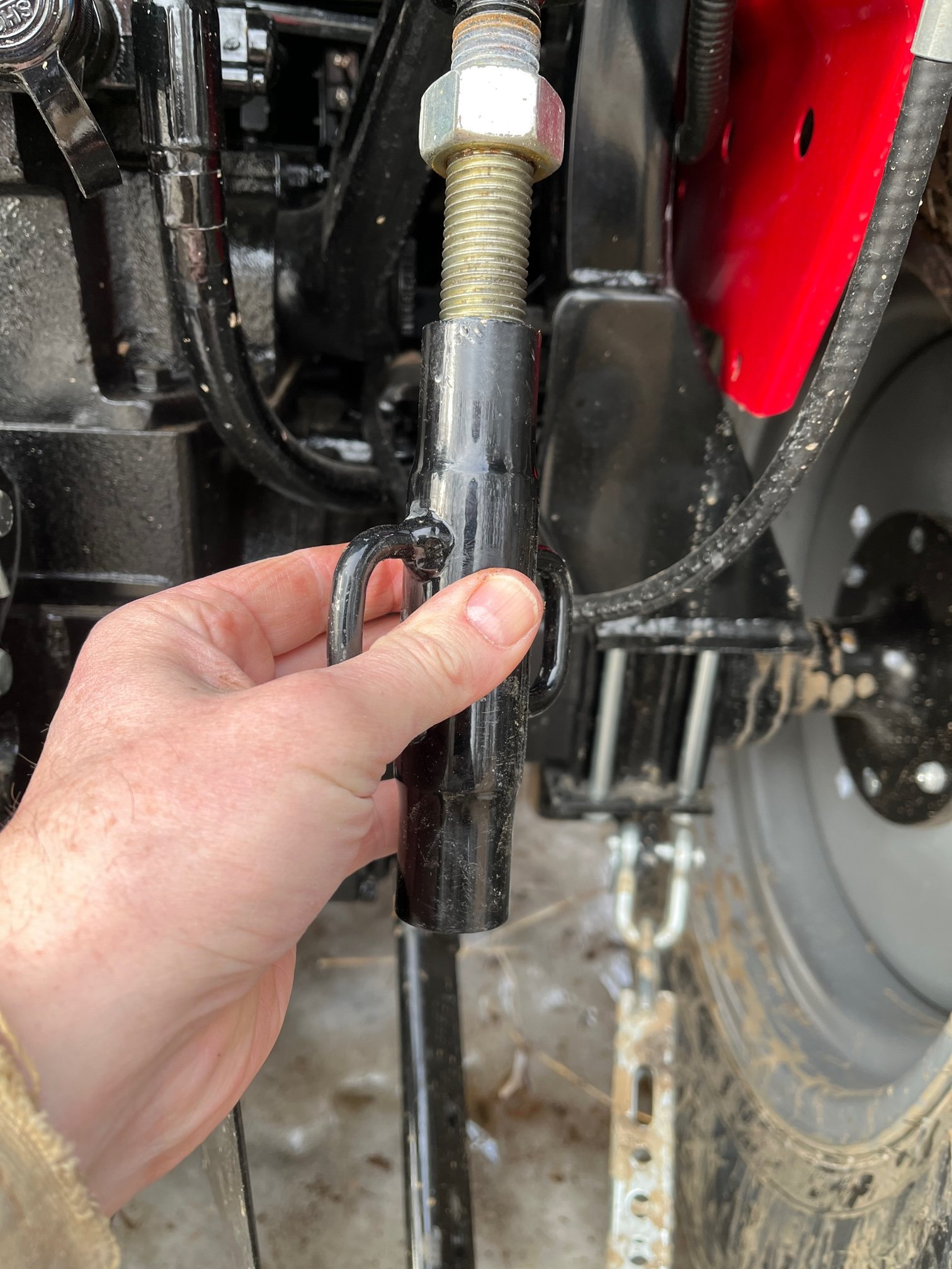

Thank you all for suggestions. Moral of story is I need to get intimate with the user manual and inspect this machine every time i use it. I put it back on for now:
It looks like the turnbuckles for the lift arm and the top link are improperly installed. There should always be the same amount of threads showing above and below the turnbuckle.

Spent about two hours going over my last new tractor. Loose bolts, cotter pins not even spread let alone bent over, and no grease or lube were all over the unit. A lot I don't believe were dealer prep spots, parts seemed to be assembled at the factory, but still annoying. Glad I took the time...lesson learned from my last tractor with endless hydraulic leaks during the first ~10 hrs.
Sorry OP, I would absolutely go over the entire tractor with a fine tooth comb and mark all the nuts/bolts along with everything else you decided to do.
Do yourself a BIG favour and re-torque your wheel nuts. Do the same for all your loader mounts.
After torquing use a paint pen or permanent marker to mark every bolt the same way i.e. a dot at the 12 o'clock position. It's an easy way to spot a problem on your walk around during the tractor warm up.

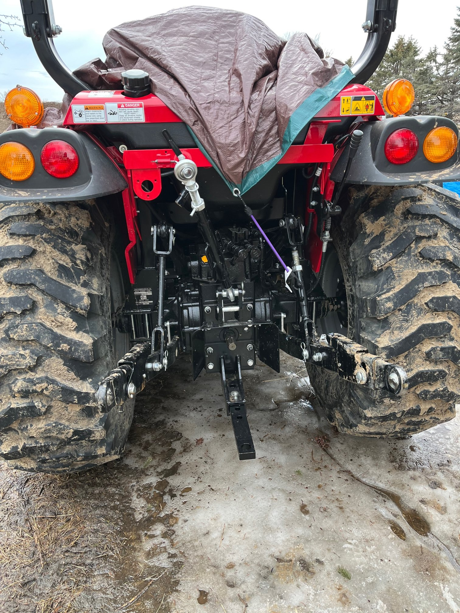

New tractor, with about 10 hours on it (not using the three point hitch). To my dismay when I walked up to it this morning, my 3-point hitch section must have rattled loose. Am I suppose to be checking and tightening this or some other issue?
To answer your question, of course you should be checking it. It sucks that the dealer didnt tighten it...but its YOUR machine now, get to know it and take care of it.
Have you checked lug nut torque yet? Have you checked all grease zerks/joints for proper greasing? Have you checked the front axle for lubricant? Do all of these things now. Dont trust the dealer.
