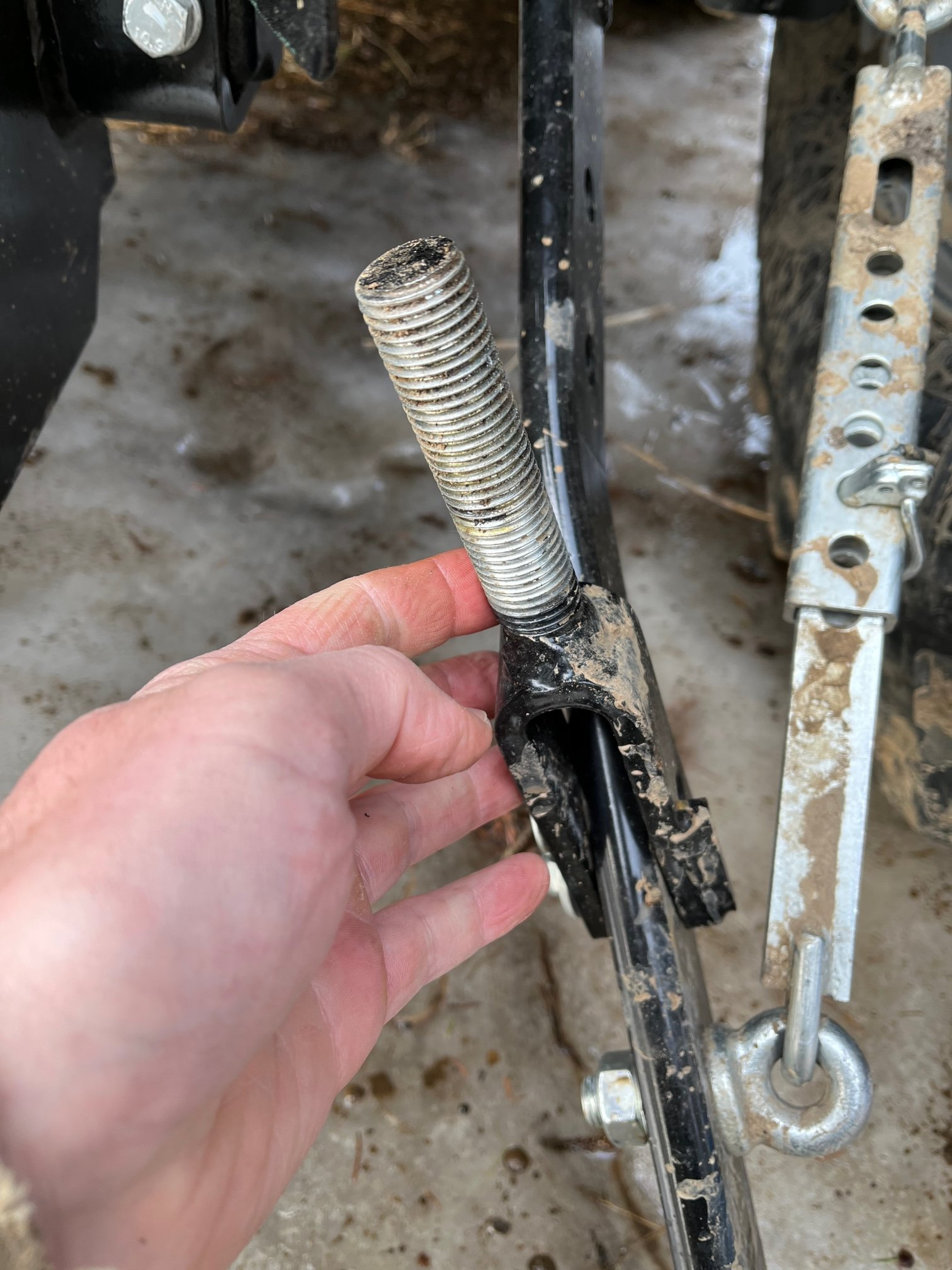

   / New Tractor: Three Point Hitch Came Apart (see pictures) #24
My dealer delivered and installed the mid mount mower on my new tractor last summer, as it was not available when he delivered the tractor. An hour after he'd left, he texted me to check two adjusting nuts for tightness, he didn't recall tightening them completely. I checked right away, they were tight. Not perfect, but adequate for me.
Took my tractor to dealer for hydraulic work. Brought it home, parked it, next morning hydraulic fluid all over the floor. Mechanic loose fit the lines and forgot to tighten any of them. Sadly, you have to check up after everyone who does any work (from mechanics to home repairs, etc.) these days.
   / New Tractor: Three Point Hitch Came Apart (see pictures) #25
All turnbuckles work the same way, and all are vulnerable to coming undone if not locked. It is very low operator burden to check that they're suitably locked, as compared to a potentially complex and expensive mechanism to lock them. I have often found that complex and expensive locking mechanisms (and I see a lot of them on airplanes) will wear/fail/seize, and not release when needed. You end up breaking it off, and replacing it with the more simple version that you wish you'd had from in the first place.
If, on a machine, particularly one which works outside in the dirt, a mechanism can be simple, operated with a wrench (or Visegrips), and is very low cost to repair if I let it seize, that's what I want, and I'm prepared to do daily checks to assure security, rather than suffer frustration and expense when the automatic complex thing fails.
Ummmm, no? There are many quality designs that lock the turnbuckle without tools that are very simple.

I agree. Thus my post. I checked the common item things on mine that would normally go sideways and didn't find any issues. I think it's always a good idea for especially a new operator to go over a new tractor thoroughly if for no other reason to learn what things are and how they work. On my old tractor when I bought it new I kept hearing a noise. Found out all the lug nuts were loose. Actually had lost a couple. Lesson learned.
   / New Tractor: Three Point Hitch Came Apart (see pictures) #28
Glad to see that you prefer that system but I would do whatever I could to avoid buying a system set up as lousy as that . Yes it saves the manufacturer a little money but often winds up costing the owner much more time and money to fix it.
Been working around tractors my entire life and never saw such lousy three point setups until these newer small tractors and the more they can sell with the cheap lousy design the more they will continue to build.
Another lousy thing on these new small tractors is no break away hydraulic couplers, just hate to think of the possible problems caused if someone happens to drive away from some machine after forgetting to unhook the hydraulic hoses.

Thank you all for suggestions. Moral of story is I need to get intimate with the user manual and inspect this machine every time i use it. I put it back on for now:
Fair enough. A trouble free, very low cost solution is to forgo the adjustable lift link, and replace it with a second fixed link if you don't need to adjust the angle of the three point accessory. Sure, the turnbuckle is a simple, low cost solution to the possible need to adjust the angle, it's not a required adjustment, if you don't need it!
After spending a lifetime enduring ever increasing complexity, both mechanical, and more recently computer systems, I am more an more saying "give me simple, I'll operate it responsibly for the privilege of not having to endure its needless complexity!".
To drift the thread, but in the theme, I drive a manual transmission, eight year old car. I love it, it has a steering wheel connected to the front wheels - directly. I rented a very similar car overseas last week, "hey, let me try the most recent version of my car, 'see what it's like!". What a mistake! Driving the Autobahn at 125MPH, the lane narrows for construction, and the car's steering wheel fights me to follow the white lane line into the new barrier, rather than the yellow construction lane lines! When I insist on actually driving in the lane, it vibrates the steering wheel at me! So, no new car for me for as long as I can manage - I do not want nanny systems!
So, I will understand my equipment (read the manual), check it as appropriate before operating it, and have it properly maintained, in return for simplicity in life! I'm going out to check my three point lift arm adjustment now!
   / New Tractor: Three Point Hitch Came Apart (see pictures) #32
Perhaps it was the camera lens but that lower arm appeared to have a serious bend in it.
Are you sure you didn't back into something or pull radially on it?
