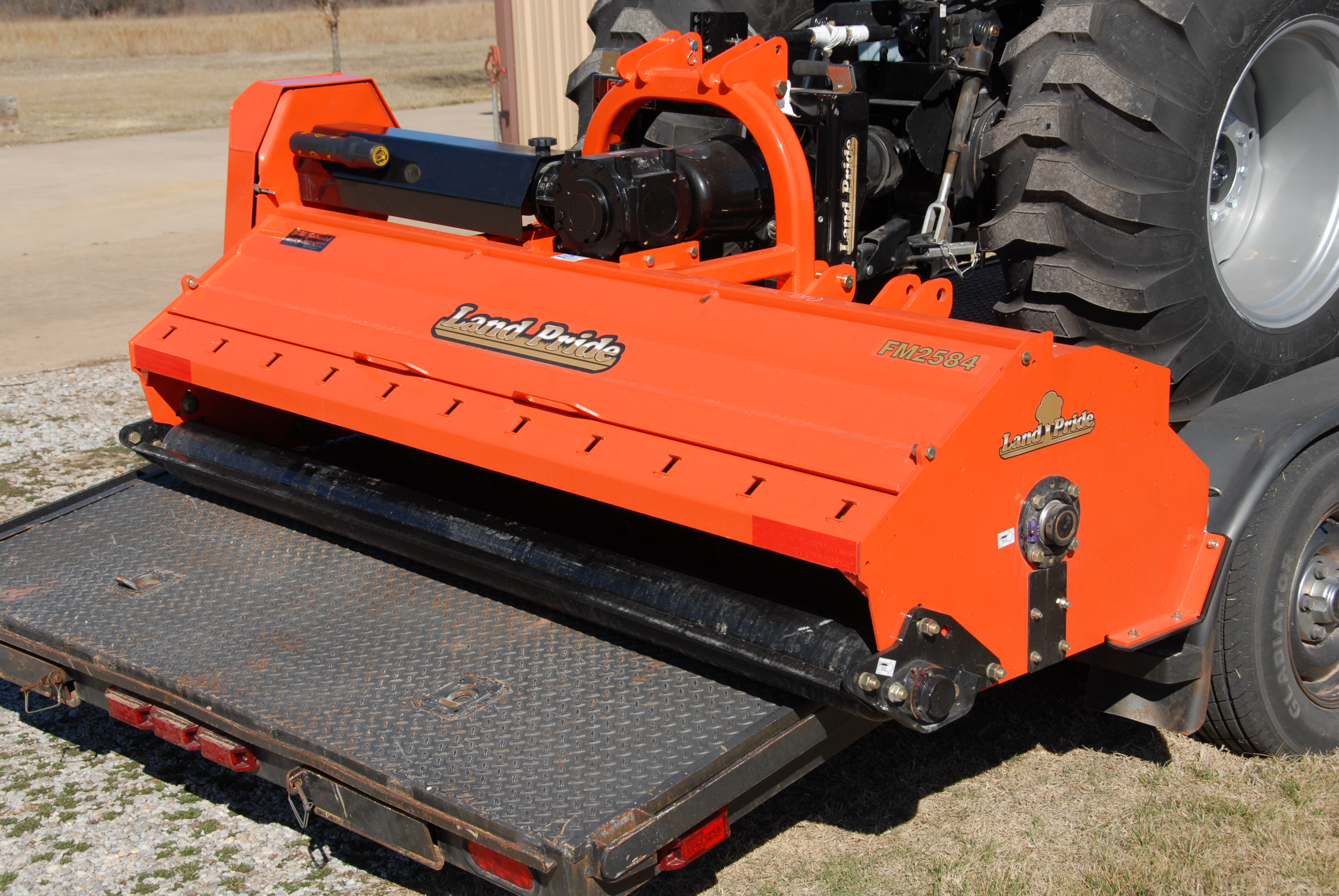

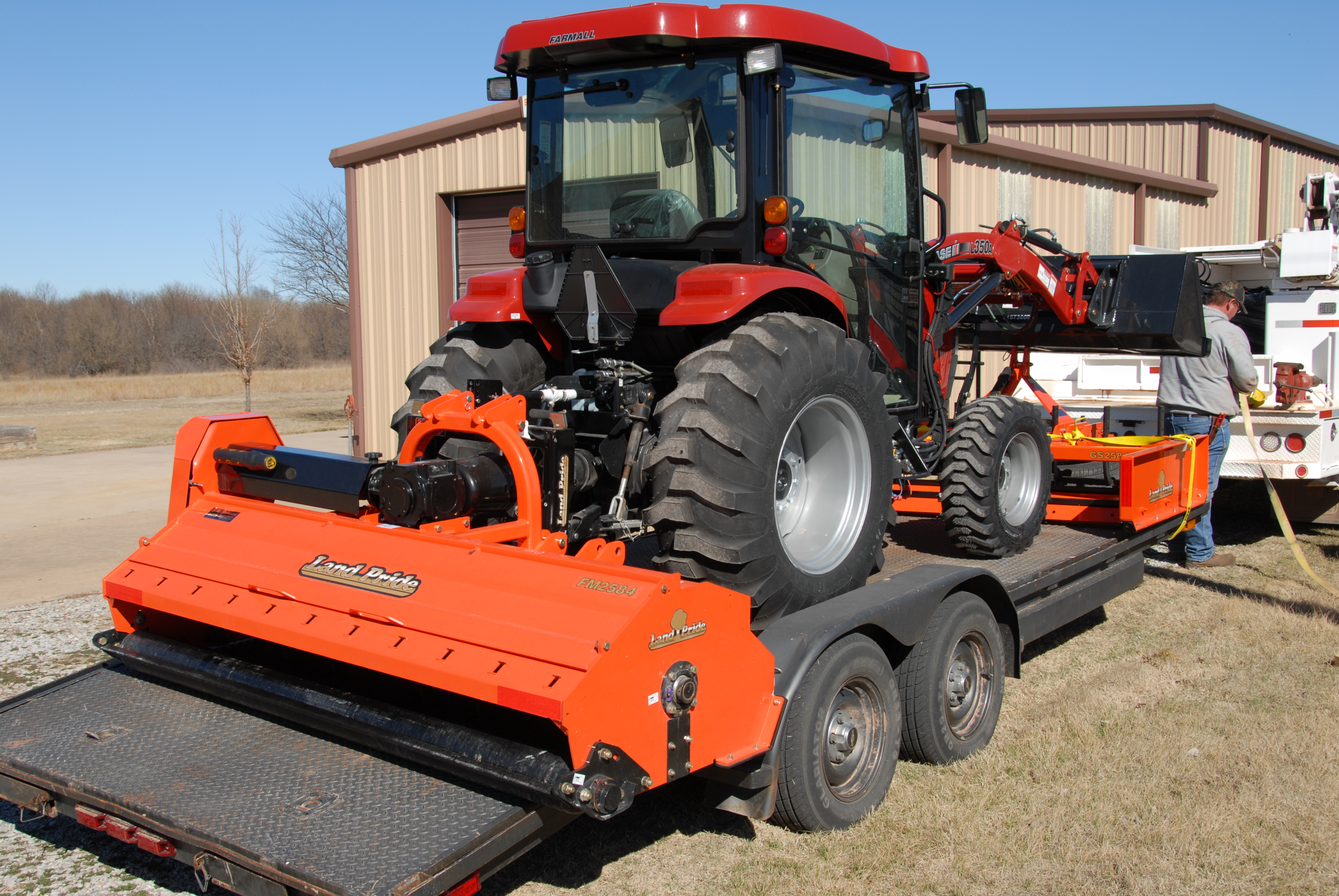

Tractor and implements were delivered this afternoon!
Yuk! New Land Pride / Kubota orange isn't a great color match for a red tractor. It'll just have to do though.

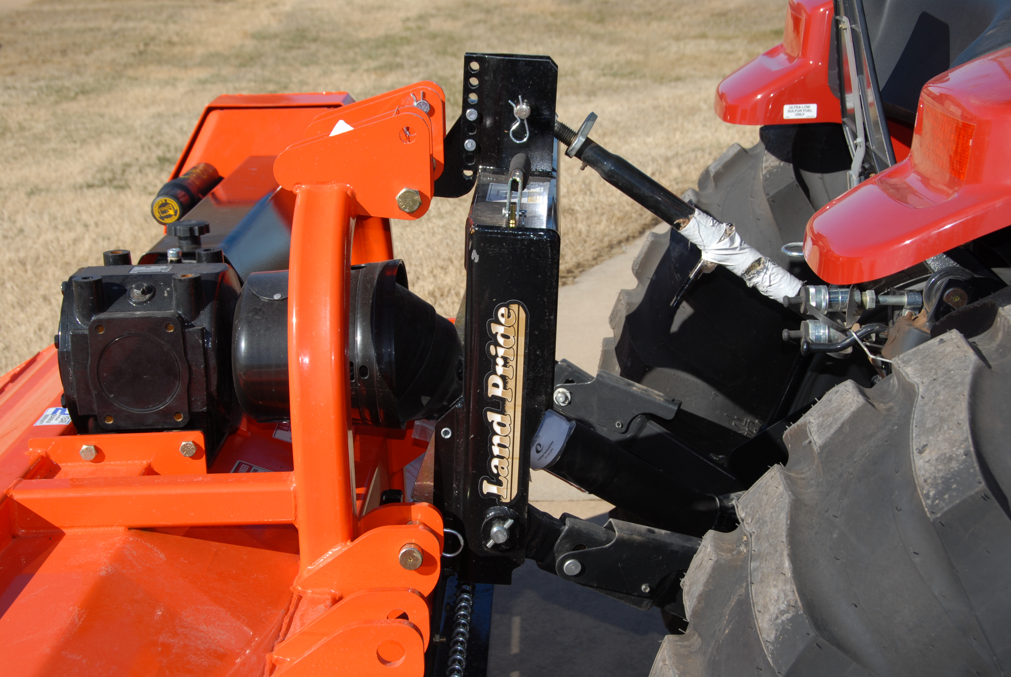

Close up showing LP Quick Hitch installation.
I had to give it a trial run! More later. Vic

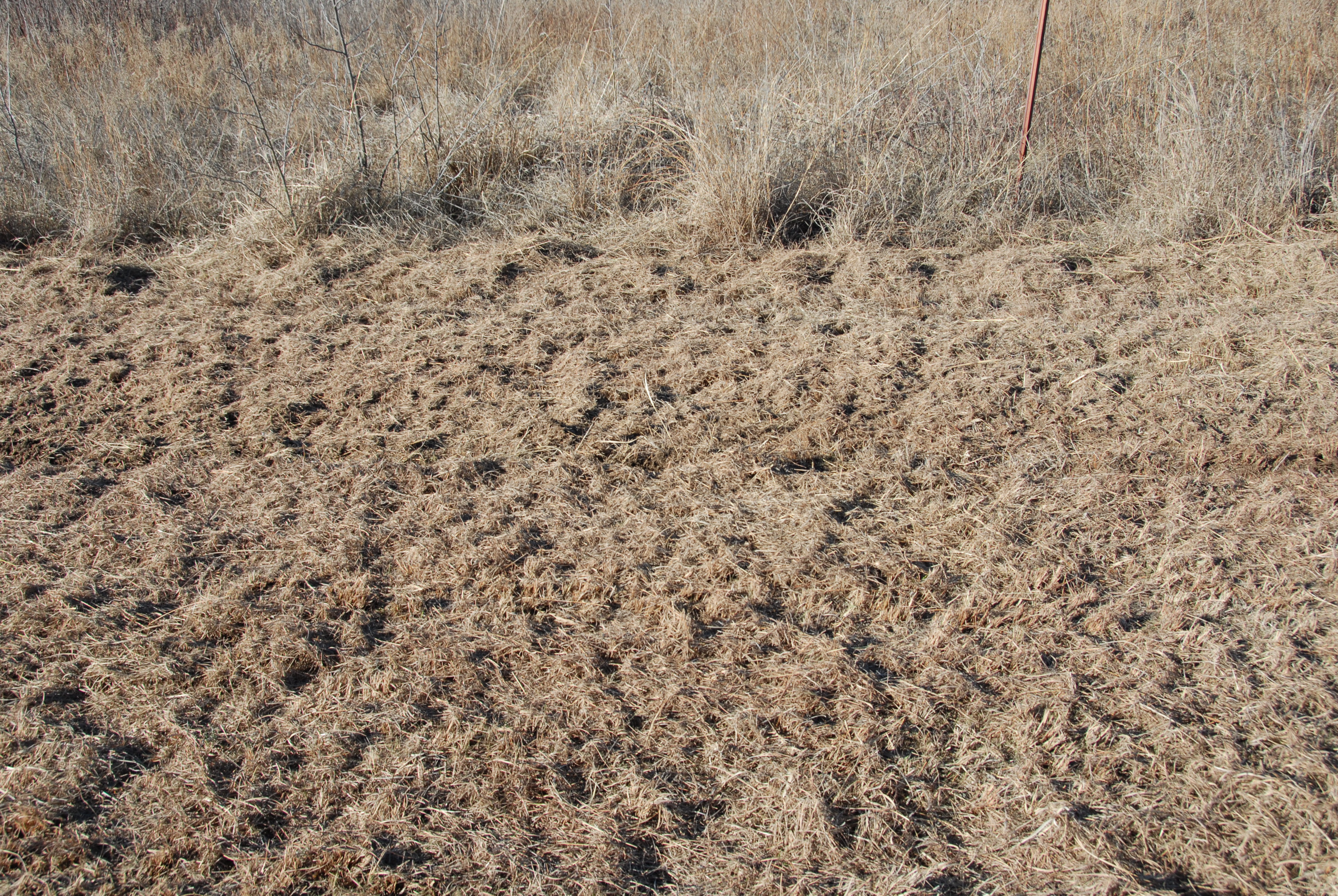

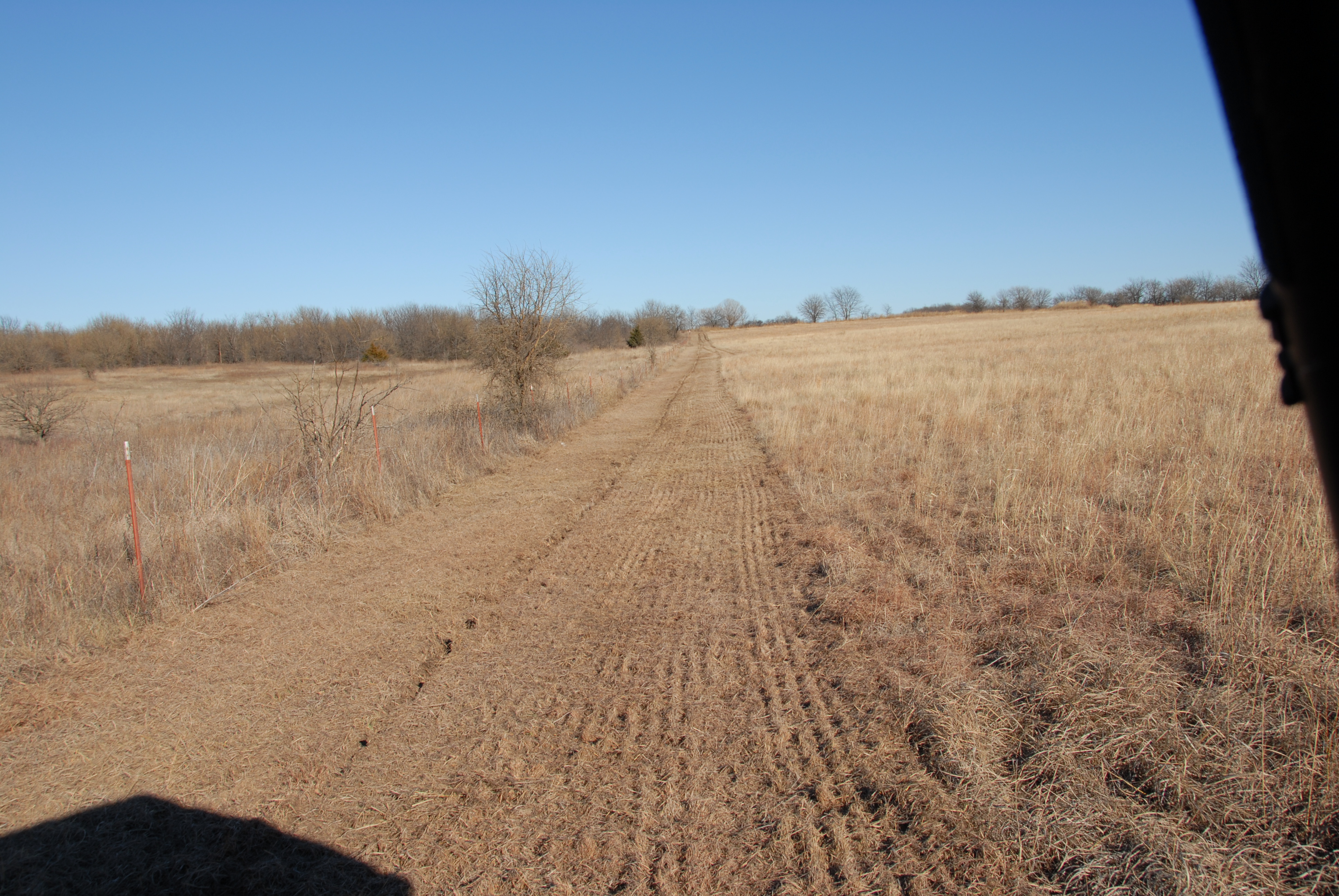

Quick test run on last year's Bluestem vegetation. "Y" blades were on the mower. Hammer blades are on order.
Cut was smooth and clean. Granted, dry grass isn't much of a challenge, but it's all I've got now.
Mulching was very good on the dry grass. The skids will need to be adjusted as they were dragging a furrow. Otherwise everything looks good.

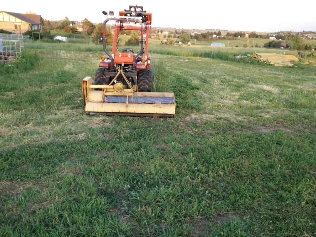

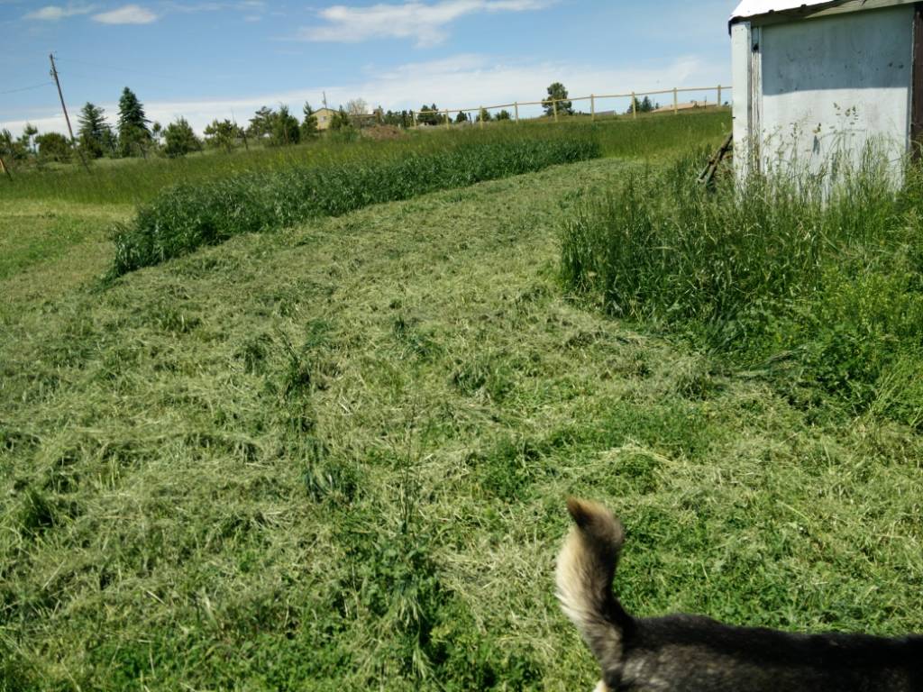

Beat to **** patched up old Ford 917 7' flail behind my old L3200. A 7' wide mower on a 25hp PTP 32hp engine machine is kind of pushing it. But it did the job well if a little slowly in that thicker grass & brush. I ran that mower on my new L4060 last year until I replaced it with the yet un-proven Peruzzo Super Bull here this winter.
I love the nice smooth carpet it left, no clumps even in that heavy grass. And due to the heavy mulching action that fine carpet disappeared below the live grass quickly.IMG_20150626_200301.jpgIMG_20150626_200320.jpgIMG_20150614_130149.jpg

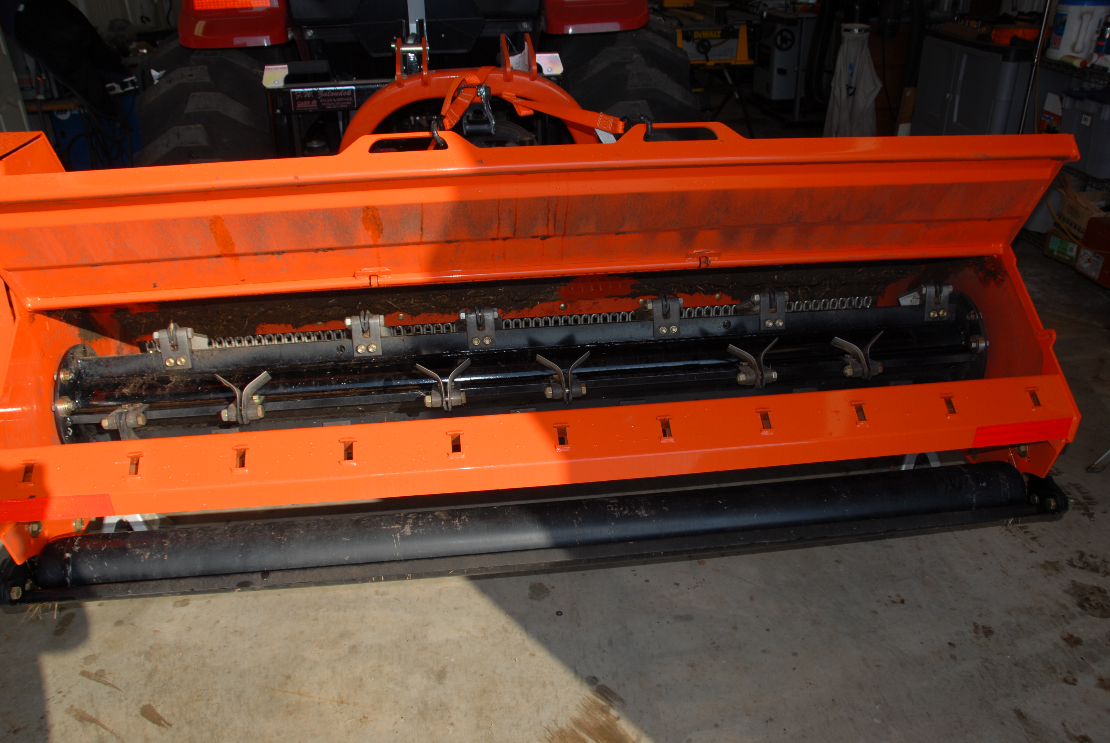

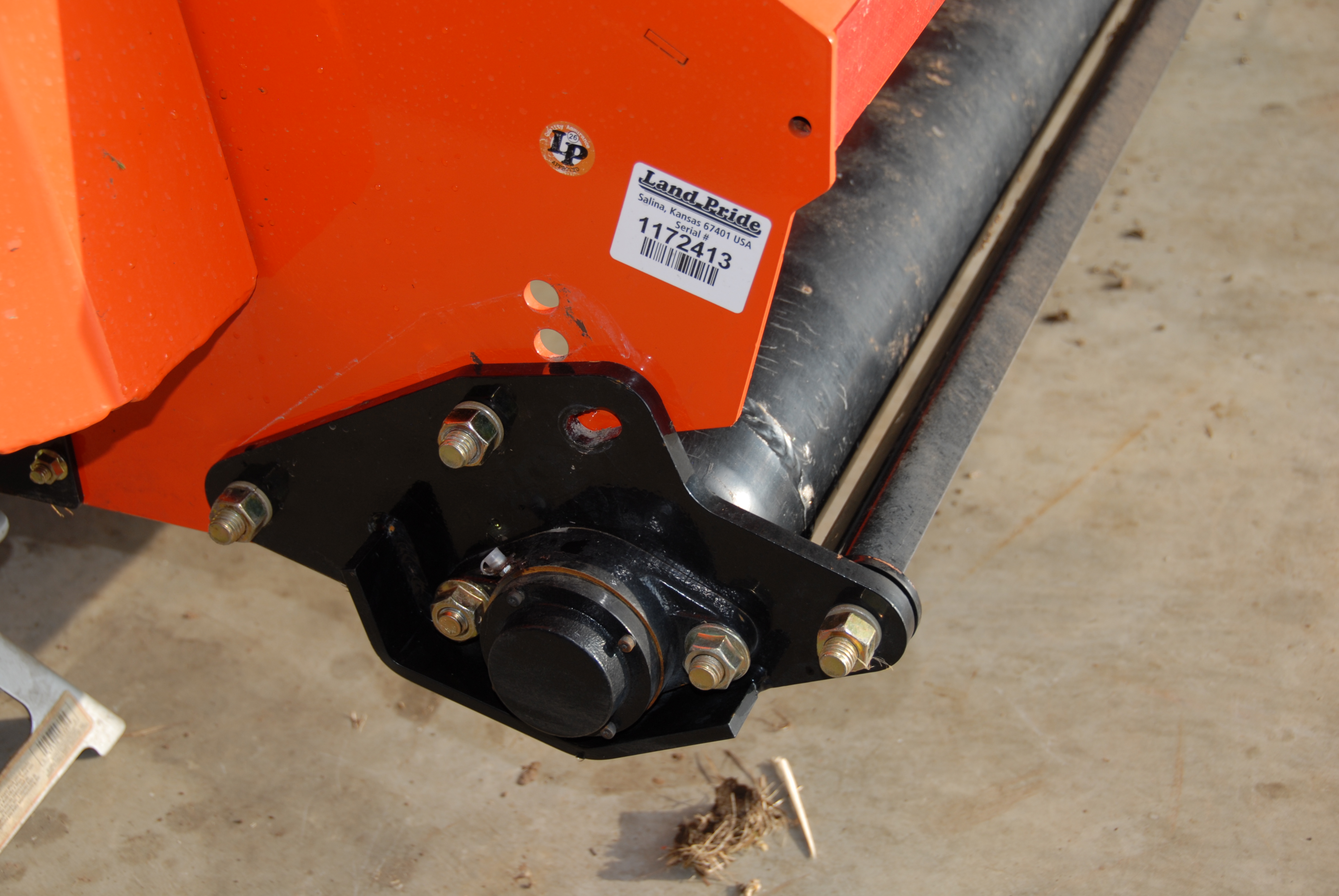

Adjusted the cutting height of the LP FM2584 flail mower today. Cutting height can be adjusted from 0" to 6" in one inch increments by raising or lowering the rear roller. As delivered it was set at 1" which resulted in excessive scalping, the skid plates digging furrows and a nice mud pack on the inside of the mower housing. Here is a shot of from the rear with the access door open. It isn't necessary to open the access to adjust the cutting height, I wanted a better look at the internals of the mower. The rotor and Y blades are shown.
The mower was raised and supported on jack-stands. Shown here is the left side roller adjustment plate in the original 1" position. The right side is a mirror image.
The plate is adjusted by removing the uppermost large bolt and pivoting on the one on the left side of the plate. The LP manual suggests lowering the mower to the supporting surface to the approximate height desired and using a pry bar to raise the roller assembly to final height. I chose to leave the mower on the jack-stands and raise the roller with a Hi-Lift jack under the rear skid plates. I decided to raise the cutting height 2" from the original position for a total of 3" for another test run. Shown here is the roller in the new position.
Another test run was made. No more scalping, furrows or mud slinging! I plan on leaving the cutting height at 3" until later this Summer when the turf grasses (mostly Bermuda here) are actively growing, Then I'll raise the height a bit more. Later, Vic
