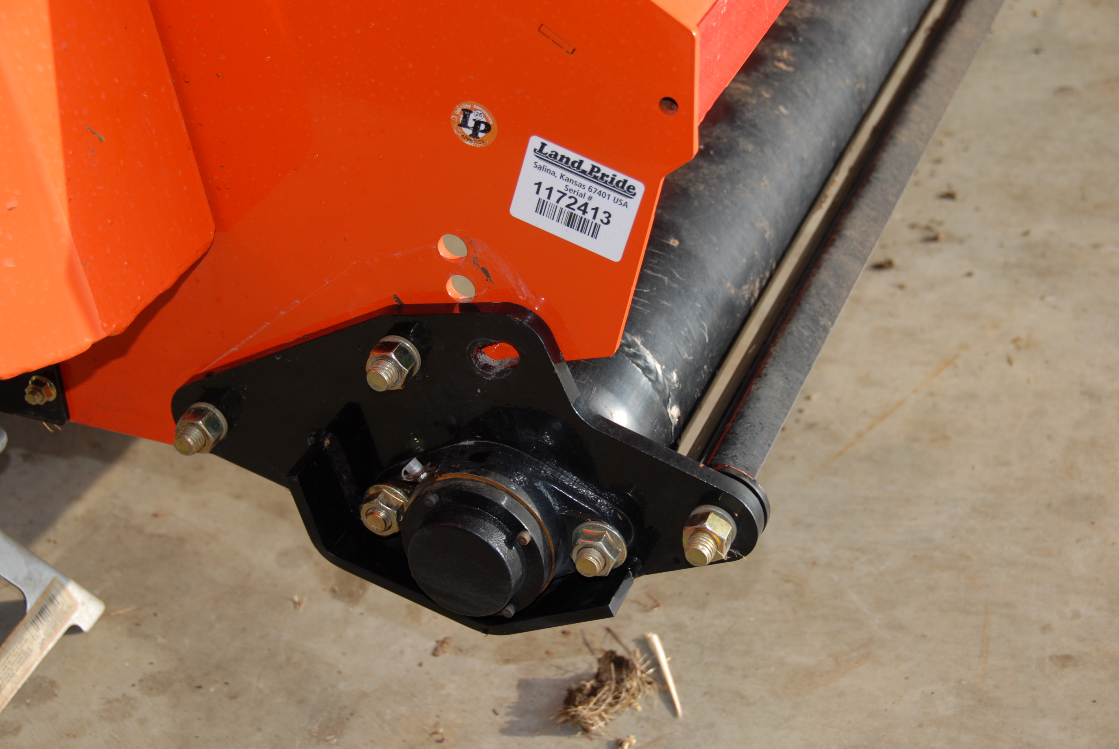

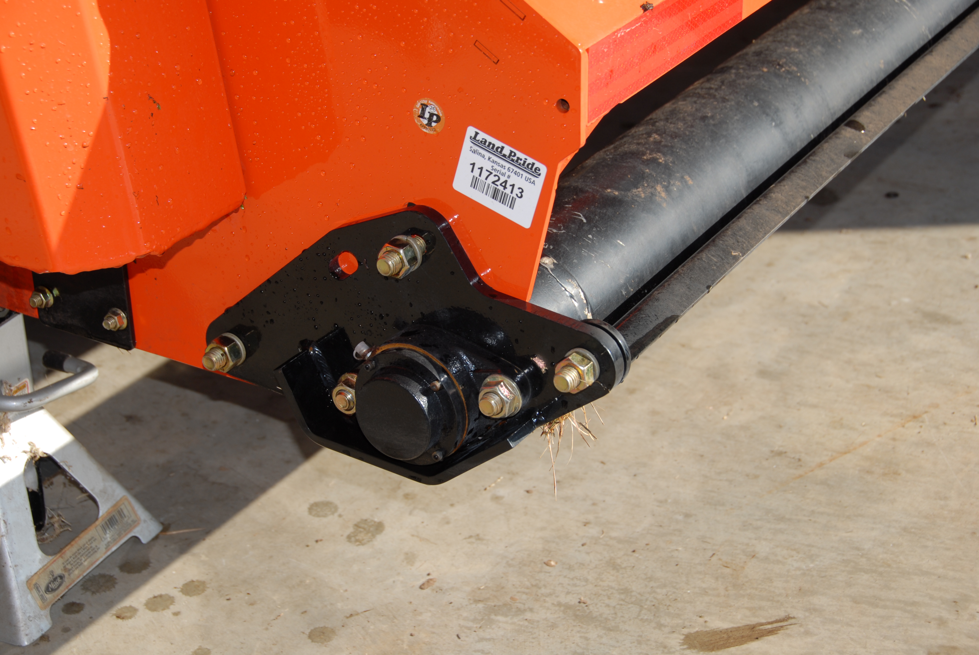

Adjusted the cutting height of the LP FM2584 flail mower today. Cutting height can be adjusted from 0" to 6" in one inch increments by raising or lowering the rear roller. As delivered it was set at 1" which resulted in excessive scalping, the skid plates digging furrows and a nice mud pack on the inside of the mower housing. Here is a shot of from the rear with the access door open. It isn't necessary to open the access to adjust the cutting height, I wanted a better look at the internals of the mower. The rotor and Y blades are shown.
The mower was raised and supported on jack-stands. Shown here is the left side roller adjustment plate in the original 1" position. The right side is a mirror image.
The plate is adjusted by removing the uppermost large bolt and pivoting on the one on the left side of the plate. The LP manual suggests lowering the mower to the supporting surface to the approximate height desired and using a pry bar to raise the roller assembly to final height. I chose to leave the mower on the jack-stands and raise the roller with a Hi-Lift jack under the rear skid plates. I decided to raise the cutting height 2" from the original position for a total of 3" for another test run. Shown here is the roller in the new position.
Another test run was made. No more scalping, furrows or mud slinging! I plan on leaving the cutting height at 3" until later this Summer when the turf grasses (mostly Bermuda here) are actively growing, Then I'll raise the height a bit more. Later, Vic

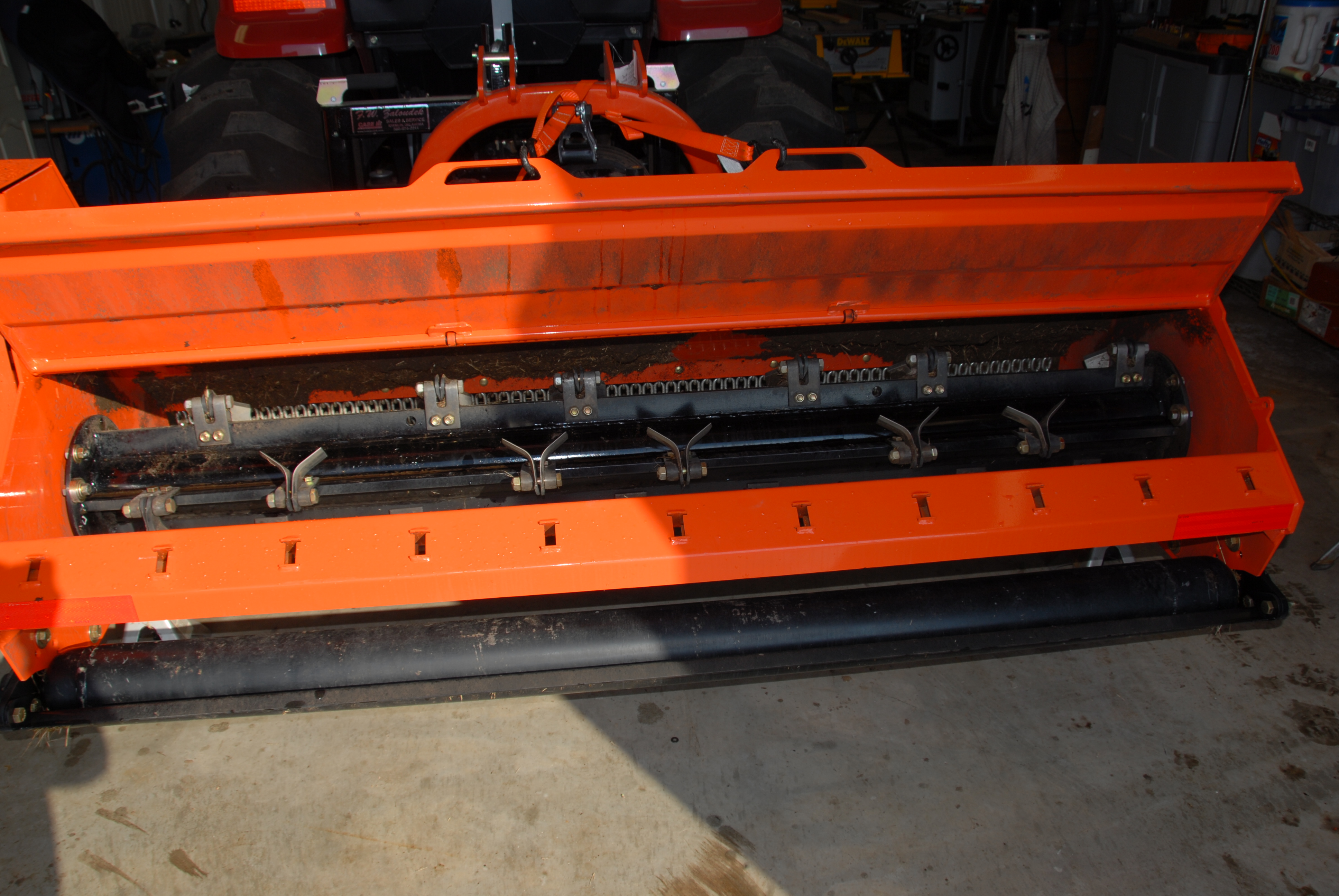

You need to slow down, overlap the cut a bit and open the trash door if you are not going to use the recutting bars.
when you use the cast hammer knives they are not going to recut the brush for you unless you put the recutting bars in and mow slower.
You need to drop down to 4 MPH to get a better cut to eliminate the clumping without the recutting bars in or with the trash door open.
Quite often the skids will catch the mowed brush from the last lap and hang on until it drops off.

I ordered the mower with the "Y" blade option with an extra set of cast hammer knives. The hammer knives are still back ordered, I don't have them yet. All mowing so far has been with the "Y" knives. I have not tackled any brush yet. All mowing has been on last years Blue Stem vegetation. The cuts are clean and smooth on the dried Blue Stem grass. The "Y' knives are giving a nice clean cut on the dried grass with very good mulching action. No complaints there. The only uncut grass is when I fail to overlap the previous cut enough. My problem, not the mower's. The "clumps" I poorly described are not uncut areas or un-mulched grass. They are simply small mounds of well mulched grass that accumulate along the ends of the mower and are strung out across the field as I mow. It looks as if this isn't going to be a problem after all. After a couple of days the Oklahoma wind has pretty well spread the clumps out and they have pretty much disappeared. I think you were right on about the skids catching the mown grass and it hanging on until it drops off. When I do get into the brushy areas even with the hammer knives the mowing speed will no doubt have to be reduced. On turf grass I believe I could mow even faster if the terrain were smoother.
From the LP website:
"Three different blade options make quick work of grass, grapevine shoots, saplings, and tree prunings. Cutting height is variable from 0" to 6". Cutting capacity is 1" with Duckfoot Knives, 1.5" with Heavy-duty Y Knives, or 2" with Hammer Knives. The rear access door and quick-change D-ring system simplifies blade changes. Optional Brush Rakes hold prunings and other woody materials in the cutting chamber longer for better shredding and decomposition."
Land Pride still steadfastly denies this mower has a "trash door"! :eek: It certainly wasn't designed to run with the door open. There is no mechanism to hold the door open when in operation. If the access door is opened and raised all the way up by hand, then released, it instantly slams closed under it's own weight. The only way to keep it open for inspection or maintenance is to prop it up with a stick or the like.

Vic, with the rear trash door open the mowed brush is ejected from under the flail mower shroud horizontally
and then falls to the ground a long distance away.
There is no reason you cannot open it with the job of mowing heavy brush load or shredding crop residue as long as there are no pedestrians or 4 legged rug rats running around when mowing heavy tall brush.
I would invest in the recutting bars though as they will help you with shredding when using the hammer knives and the scoop knives.
Are the "recutting bars" the same thing LP calls "Optional Brush Rakes" on their website"? If so, I'll contact my dealer to order the kit. Thanks, Vic
/ New Tractor and Flail Mower #32
I have no idea why they would call them that GGGRRRR.
If they are the "recutting" bars that stick up through the rear of the mower shroud yes
they are the same thing.
Just keep in mind that you can not use them with the side slicer knives as they will not work
to shred more brush as the scoop knife and hammer cutting edges meet the recutting bars
edge to allow them to recut the brush/grass before the brush leaves the mower shroud and
passes over the rear roller.
I do not want you ruining a full set of side slicers by mistake.
