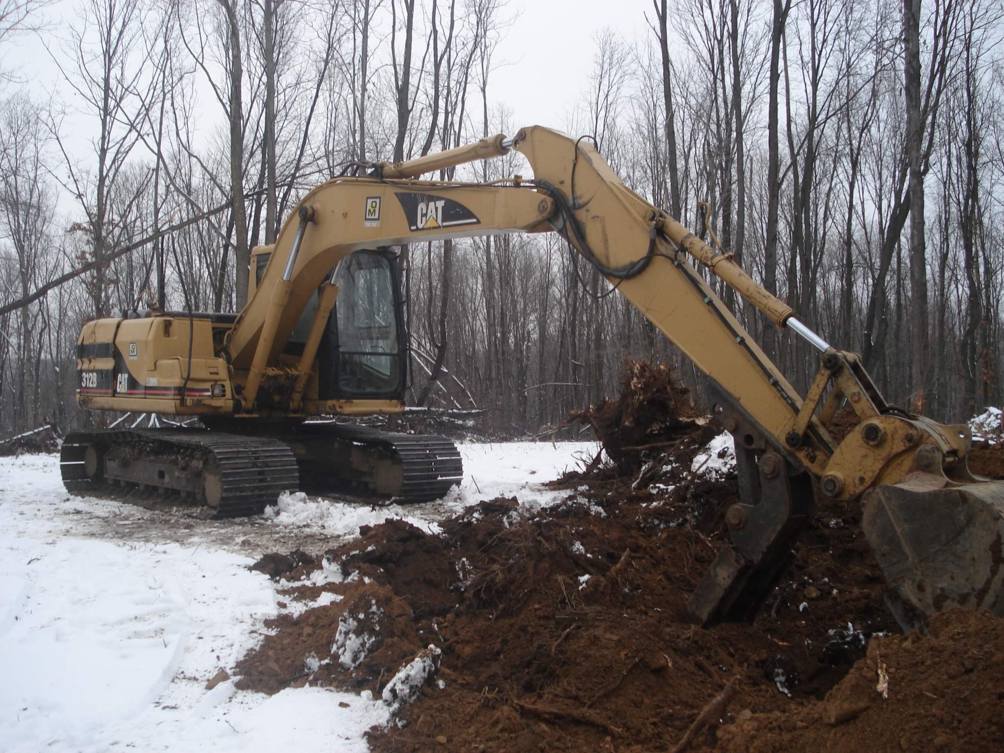

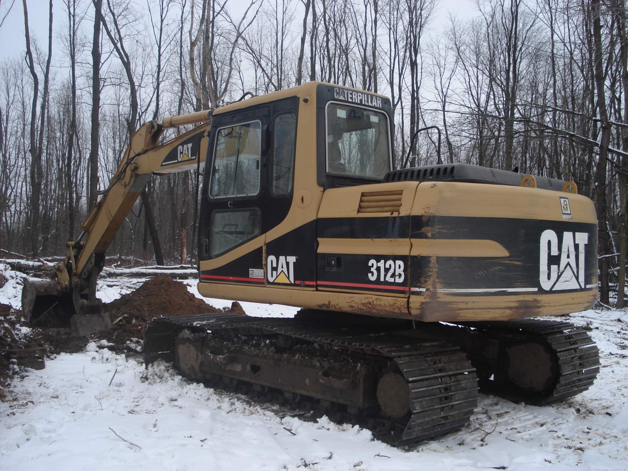

After much debating over size and shopping, the newest toy was delivered yesterday. A '01 312B with 42" & 24" buckets, quick coupler, and mechanical thumb.
Some initial observations....
1. at first I was overwhelmed by the size when driving it back to the home site....the trail was fairly narrow, and I see how it's easy to put some dings in it.
2. Someone had mentioned it might be "tippy", well that's correct depending on what you're doing... I was digging some stumps, and was thinking I would lift them up as high as possible, to drop em and knock the dirt off.....all a great idea, except i had rotated the turntable 90' and between the stump and the weighty thumb, she started tippin pretty good! That was a quick lesson in physics.
3. I had toyed with the idea of a bigger machine, and while it might not tip as much, to move it around thru the woods would be even more of a pain, banging into trees, and not fitting on the current trails on the property. I had to stop and remove a tree just to get it back to where I wanted it, and barely fit on the trail with the 312!
All in all, I'm very pleased with the machine thus far, and will be able to do a lot more work than the dozer alone. I'm still getting used to the controls, since they're different from my tractor's backhoe and dozer controls.

very very nice machine...just a quick note that you more than likely already know...switch to the 24in bucket for stumping as it will save you alot on weight...between the weight of the bucket and the weight of the extra dirt that will get in the bucket...

Man, what a great toy!! I spent around 10 hours pulling stumps over the last few days, definitely a great machine to have.
As Mike said, some stumps would pop right out, others I'd spend nearly .5 hour on em. Course they're frozen in, and I'm still on the upswing learning curve.....probably different species and root systems.
I was thinking it would be nice to have a larger machine to pop them with one scoop.....but then you'd lose all the seat/stick time??!! And as I said before, that size machine would be hard to get thru the woods.
I also "experimented" with knocking trees over.....man is it easier than the dozer!
