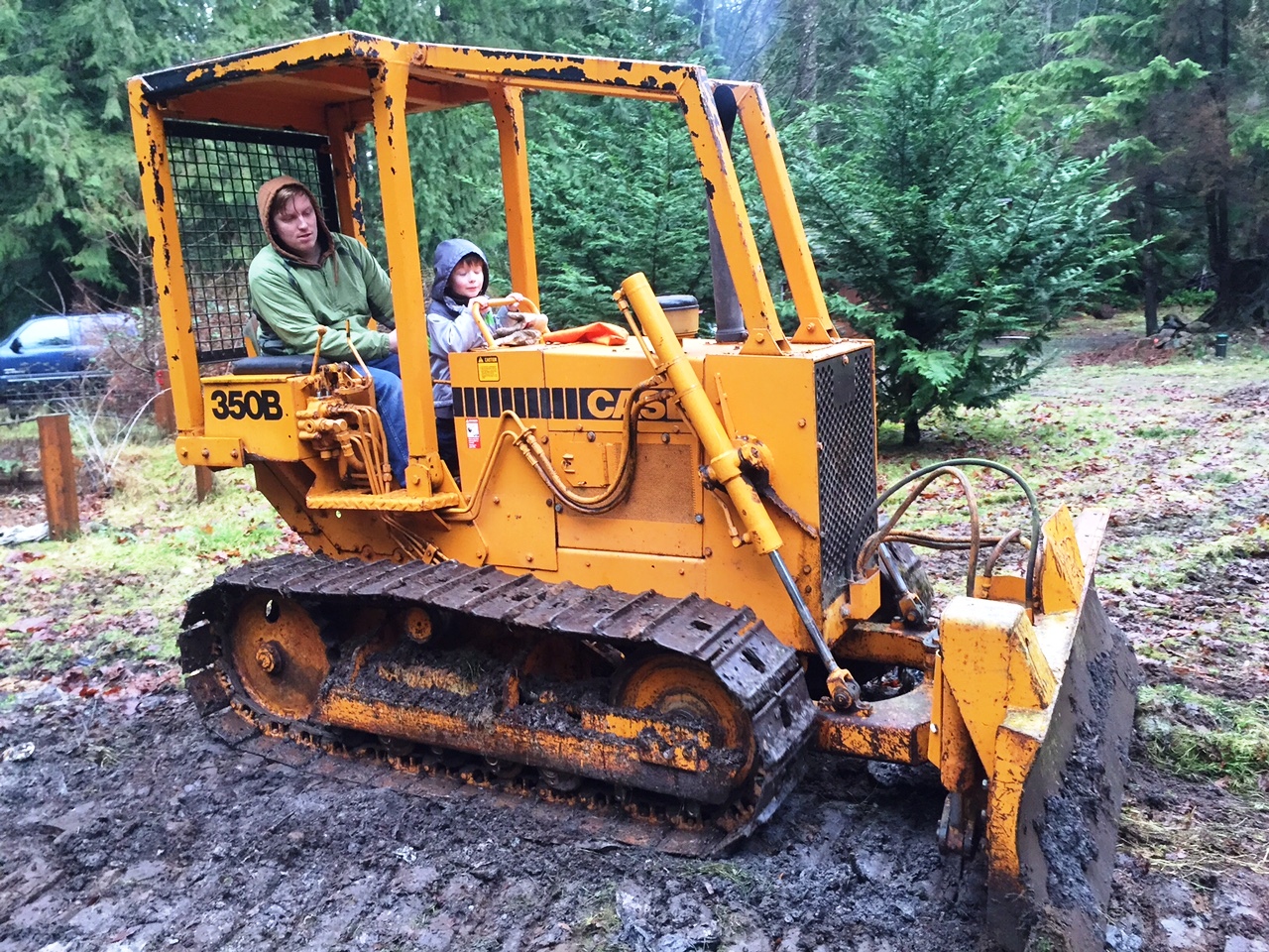

Looking for advice on purchasing a nice used tractor. Our situation is; we bought five acres in western Washington. 80% heavily treed. We'll be living on site in a large RV while we have a house built. The property came with a Case 350B dozer, which operates well, but isn't the best tool for my use as I see it. I'm wanting something to more efficiently clear small trees, ferns, fallen trees, etc. I have discovered that the dozer does move a lot of dirt, and can do a lot of damage quickly in untrained hands! :eek:

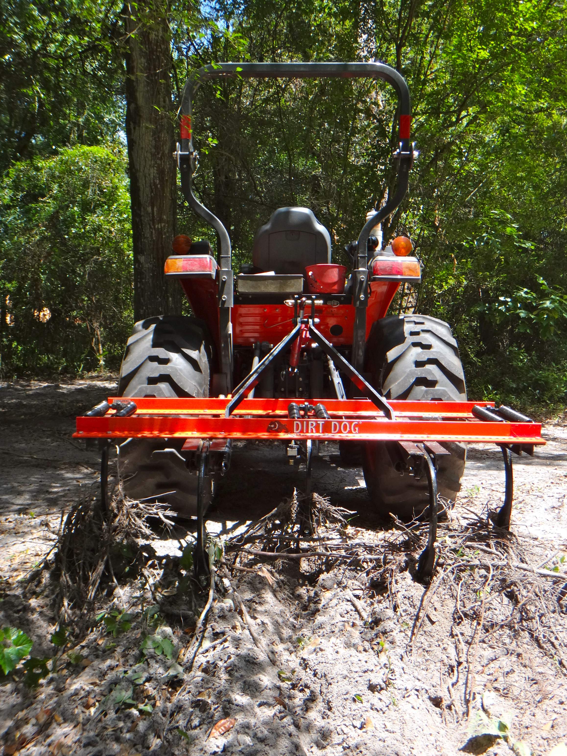

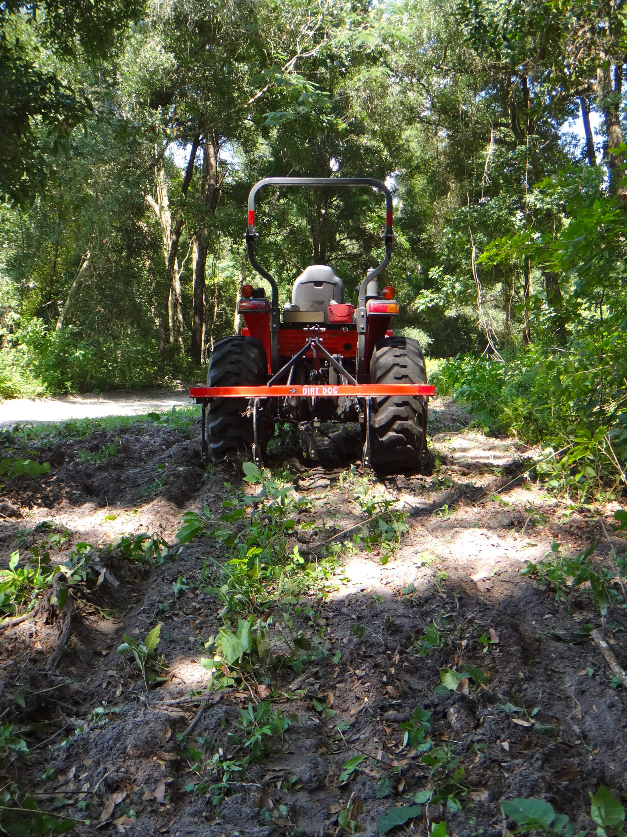

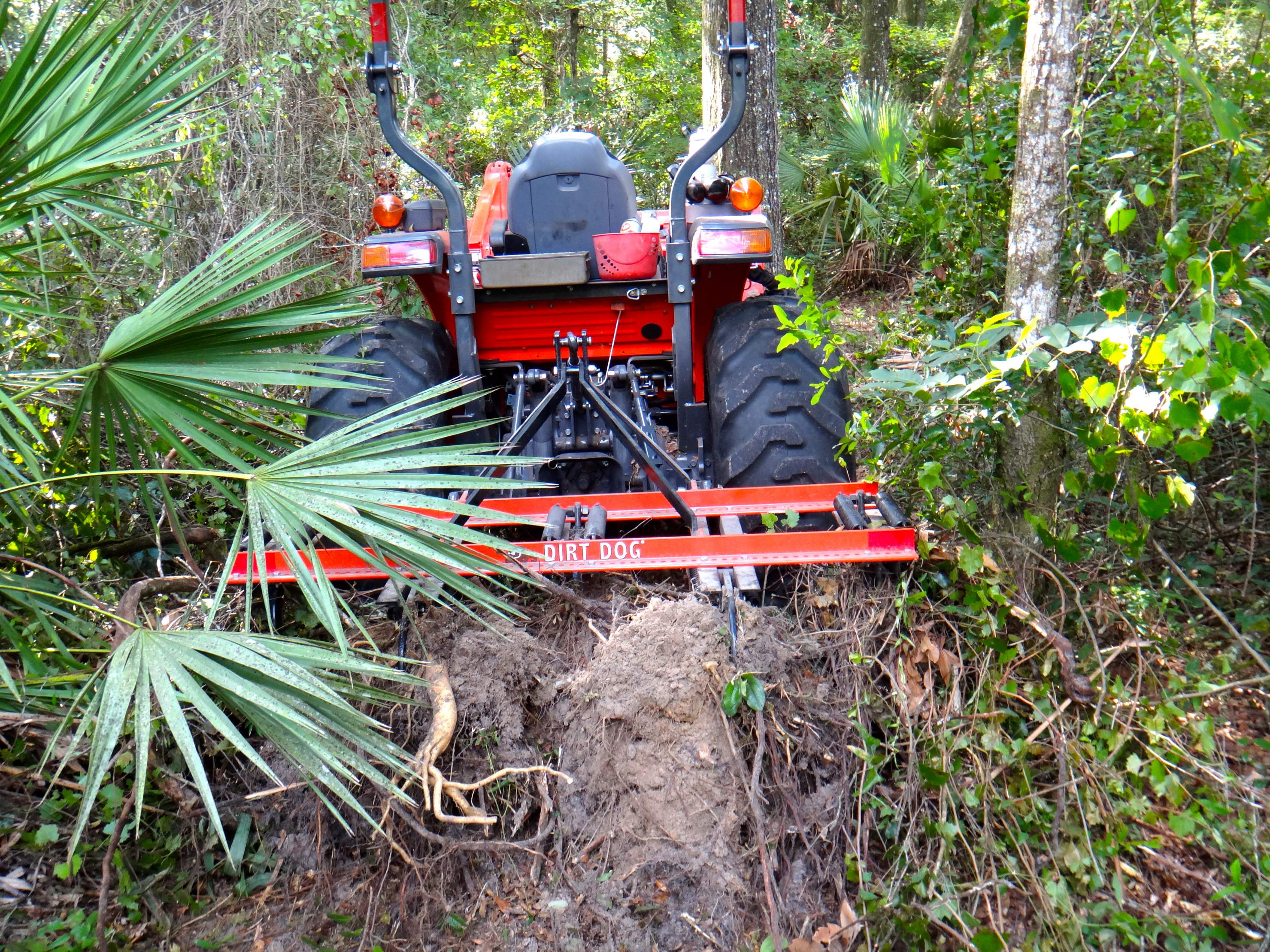

A bulldozer is the First Choice equipment for tree clearing, much better than a tractor.
Research tractors for your secondary work.
Even a small tractor can skid trees over the ground to a burn pile. The large rear wheels provide tremendous mechanical advantage when PULLING. Tractors are not much for PUSHING. Bulldozer and Skid Steers are for pushing.
Consider tractors with a minimum of 12" ground clearance for woods work.
A good implement for clearing roots, vines, corms, bulbs, ferns plus aerating is a Field Cultivator.
VIDEO: How to Use a Ripper / Field Cultivator - Gardening Series - YouTube
LINK to T-B-N archive: http://www.tractorbynet.com/forums/attachments/339095-dirt-dog-all-purpose-plow.html?highlight=
The small but HEAVY tractor-loader pictured, a Kubota L3560, sells for around $27,000 plus tax.
Field Cultivator is <$900.
