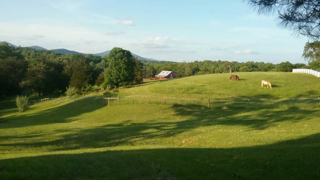

Looks like some good suggestions. On your first pict, i can see mowing by that tree would be interesting. Be on the look out for a hole or abrupt drop, i've brought regular tractors up off the top hill wheel, because of those. Slow and easy after you've sussed out your route, your slopes aren't ones i'd take a leap off the tractor for, and less likely to end up on the down hill path of your tractor.
Nothing like the one Agvg shows, that slope you might want to take your chances on and leap off, before the tractor picked up too much speed, tumbling down the hill.

I am not new to the land, but to driving a modern tractor on these slopes, yes. I don’t know how to calculate, but basically, our land that’s mowable is one long swale (we call it the bowl). The outer, upper edges of the bowl can get pretty steep, but a lot of it will be quite tame. I am NOT seeking mow ALL of it, just as much as can be safely done in this tractor.
I have found that my tractor will hold a steeper slope than my butt will
