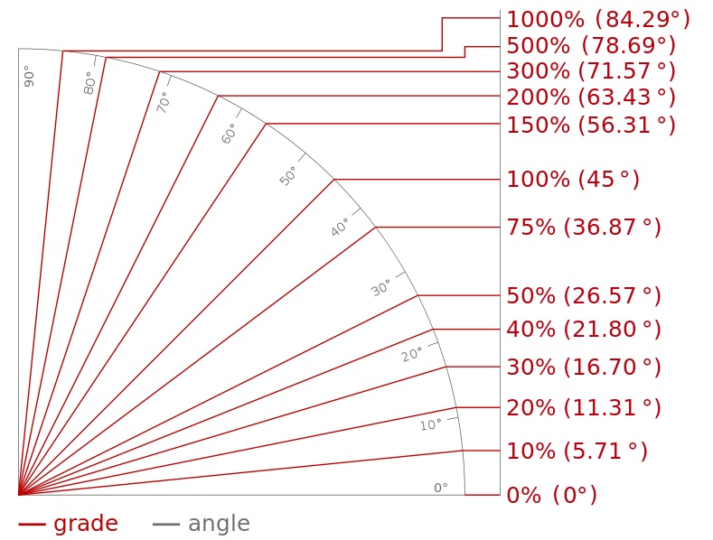

How did you measure? I assume you meant 70 percent because 70 degrees is an impossible hill. Even dedicated slope mowers wouldn’t do that. Even then I doubt your measurements are accurate because 70 degrees would put most machines on their side and is very difficult to walk on. Slopes are hard to display with pictures but those look like 15-20 degrees not 34 degrees.

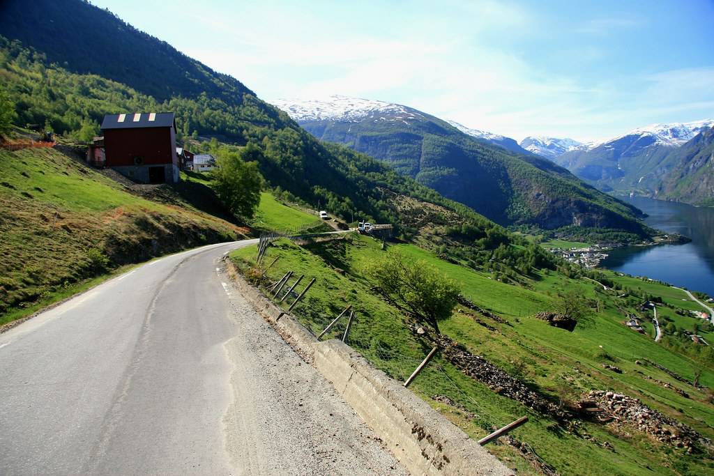

It takes time to be comfortable on slopes, have been a passenger on the fields in the picture, know your equipments limits are the clue.
Never felt nervous, but if the wheels slips and starts sliding you better jump....
And we drove a AEBI TP so I'm not sure it would be particular fun to try a compact tractor ;) 5763896611_a459f0870d_b.jpg

Judge by the picture it should not be a big problem, if needed invest in dual rear wheels as it helps enormously on stability.

How did you measure? I assume you meant 70 percent because 70 degrees is an impossible hill. Even dedicated slope mowers wouldn稚 do that. Even then I doubt your measurements are accurate because 70 degrees would put most machines on their side and is very difficult to walk on. Slopes are hard to display with pictures but those look like 15-20 degrees not 34 degrees.
So, I got the Clinometer app and went out to my hill and laid my phone on the angle and that痴 what I got. :confused3:
I guess in the end the # doesn稚 matter. I知 going to do what makes me feel comfortable. Basically, I started this thread by wanting to know some safe approaches to handling hills, and have gotten a lot of good general advice. THANKS to all who took time to answer! I値l let you know how it goes.
