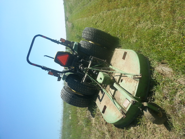

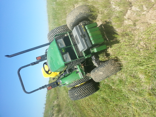

I don't know how steep the land is that you want to mow. On my tractor I've had to raise my bush hog and also the three point hitch finish mower slightly to keep the high side tire from losing traction on the grass. One time it was only the gauge wheels on the finish mower that kept my tractor from rolling over.
I bought a set of tires to use as duals and that has saved my bacon many times.
I wish I knew how to rotate the images so they show the way they are supposed to. I am not mowing grass up side down!

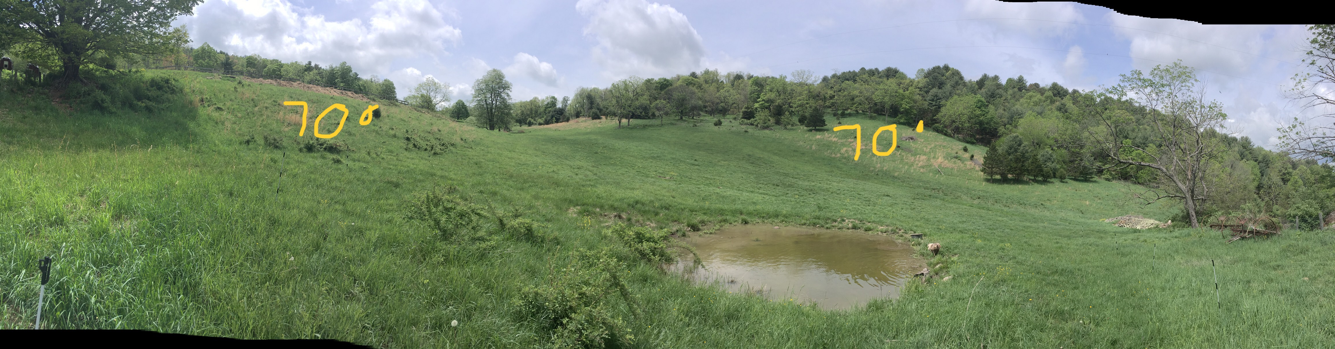

So, pictures are hard to get a real good sense of it, but here goes.
First one is a panorama, and I measured the left slope at its steepest, and it痴 70ー. The opposite side of the bowl is also 70ー. In the middle is a swale that is going uphill away from the camera for about 1200 feet, give or take. I dunno, maybe 10-15ー tops? Not a problem. We mowed the center and lower slopes in our 8N last year, and this new tractor has to do better than it did, with its wider front wheels and loaded back tires.

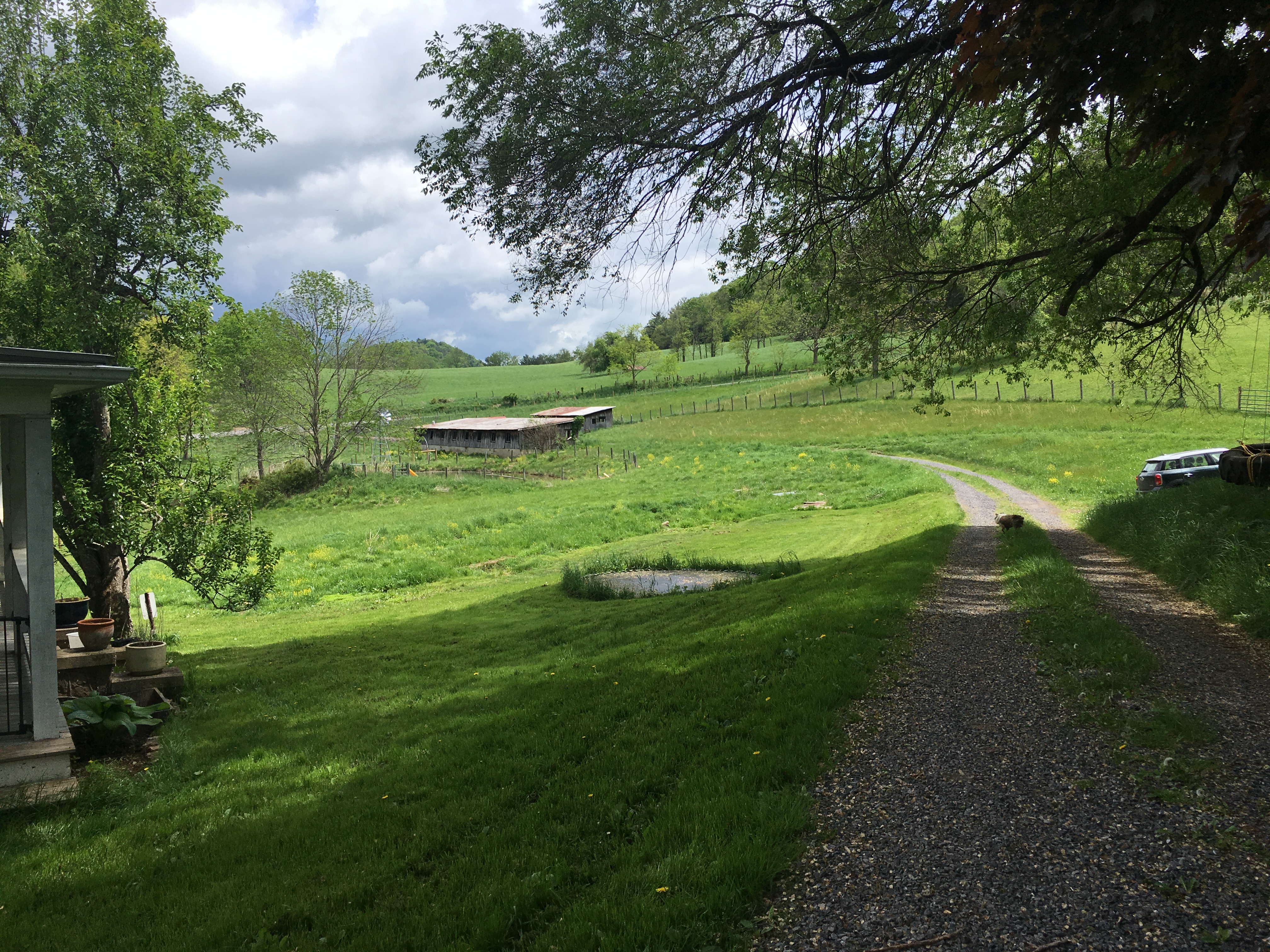

Last picture is our front yard and hill up to the pasture (across our driveway). I measured it at its steepest, near the top, it is 65ー. My husband JUST managed to mow that cross hill on our 8N, but it sure looked scary.

I'd have a 4 point ROP to start. a 2 point has killed many before. you only live once. then only mow up and down the hill. there are mowers connected by a long arm, where the tractor can remain on level ground, and the mower angles for a very steep incline, but that's only good for about 10 feet or so from the tractor. I've seen those used..
   / New to mowing hills... what are safest mowing patterns? #30
My approach is pretty much like Gary's though I will mow diagonally in some places and in some places will pick up a bucket of dirt for counter balance. To start with determine if an area really needs to be mowed and how soon until you become more comfortable with your equipment.
Land can be tricky, just because there are no obstacles are present now doesn't mean there won't be next month, we are talking about hills and a washout can appear really quick. A low bucket has saved me several times.
Beware of a missing or poorly calibrated pucker-meter.
