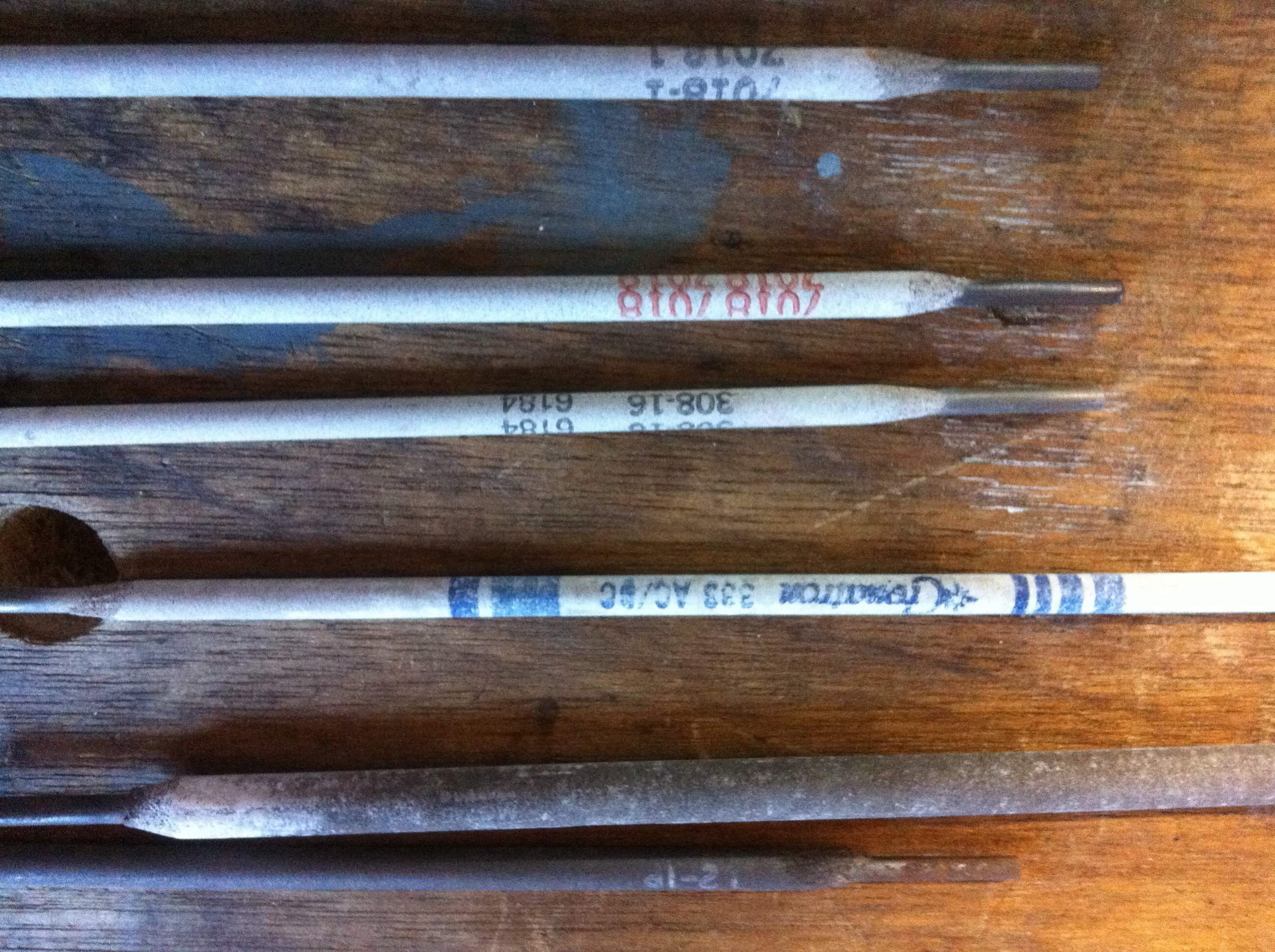

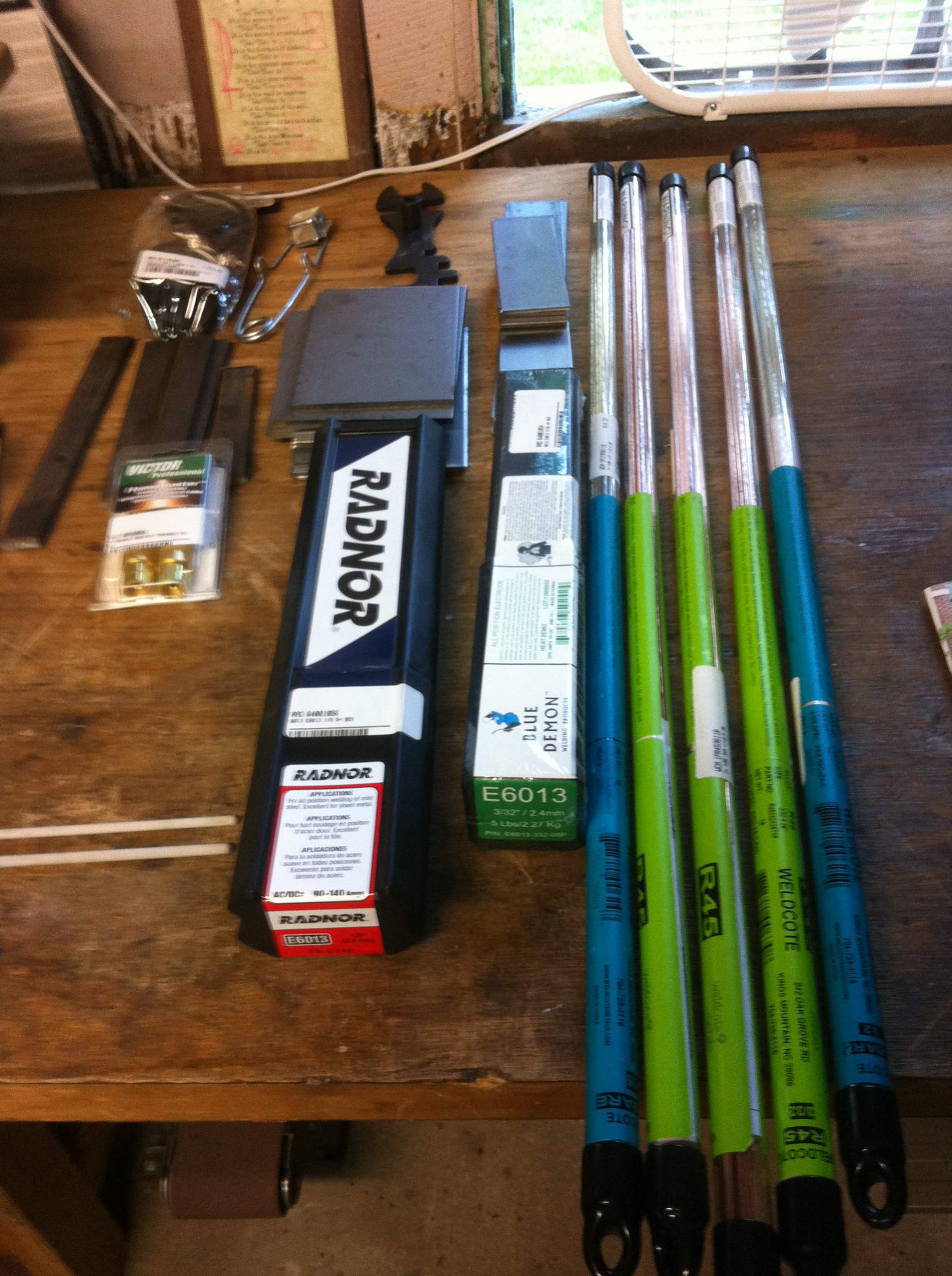

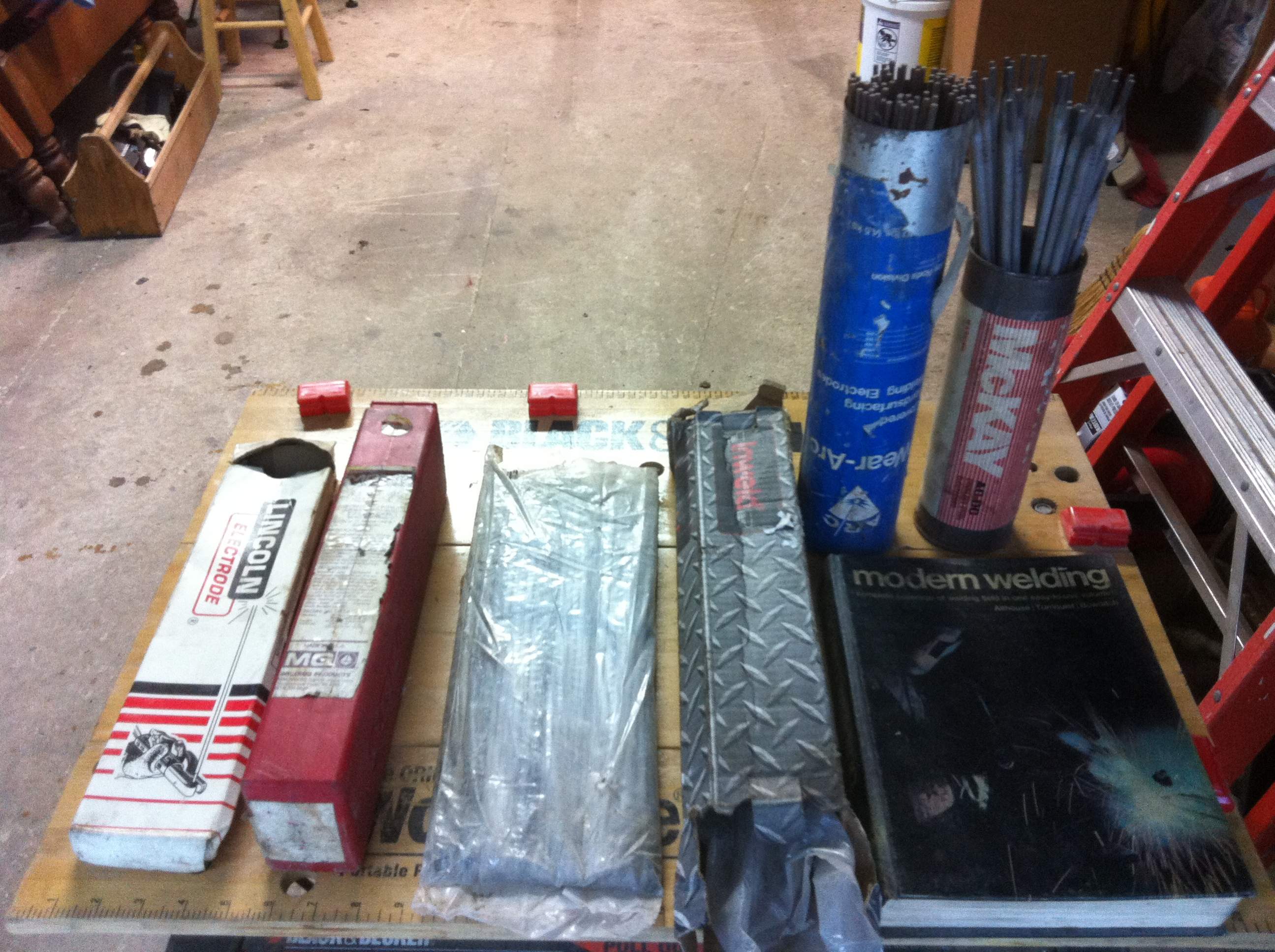

I was a cert welder for some time and still enjoy doing it around home. The numbers on your common rod,that is 6013,6011,6010,7018 and so on have a meaning you should know. The first two (and in a few cases three) numbers stand for your tensil strength. Example,7018 is a 70,000 psi steel 6011 would be 60,000 psi. The normally third number is the position the rod is designed for 1 is all position,2 is horizontal,3 is for weling flat work only. The last no. is the flux coating type. 6013 is good to learn with on A/C. It also make a pretty bead. 6011 and 6010 are good D/C rods and will penitrate the parent metal better. Try tacking 2 pieces of scrap together with 6013 then break it apart. then do the same with 6011. You'll find the 6011 is a bit tougher to pull apart. Of course 7018 & 9018 are even stronger. they are both D/C rods and you steel needs to be really clean and it also helps if you preheat the parent metal to about 400 deg. F. You would use this tech to repair a broken ripper shank for example.

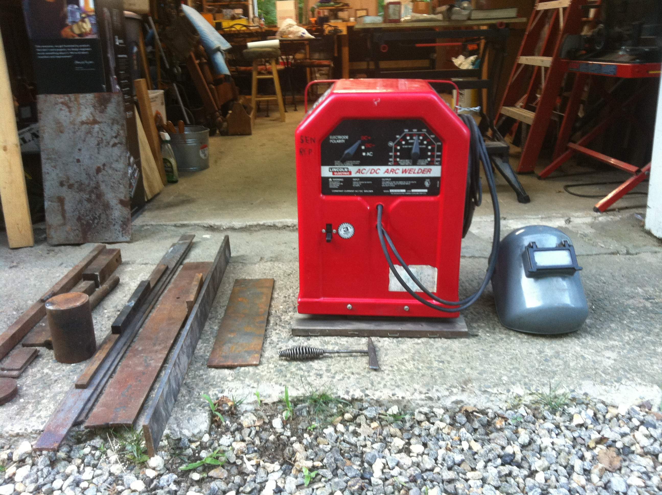

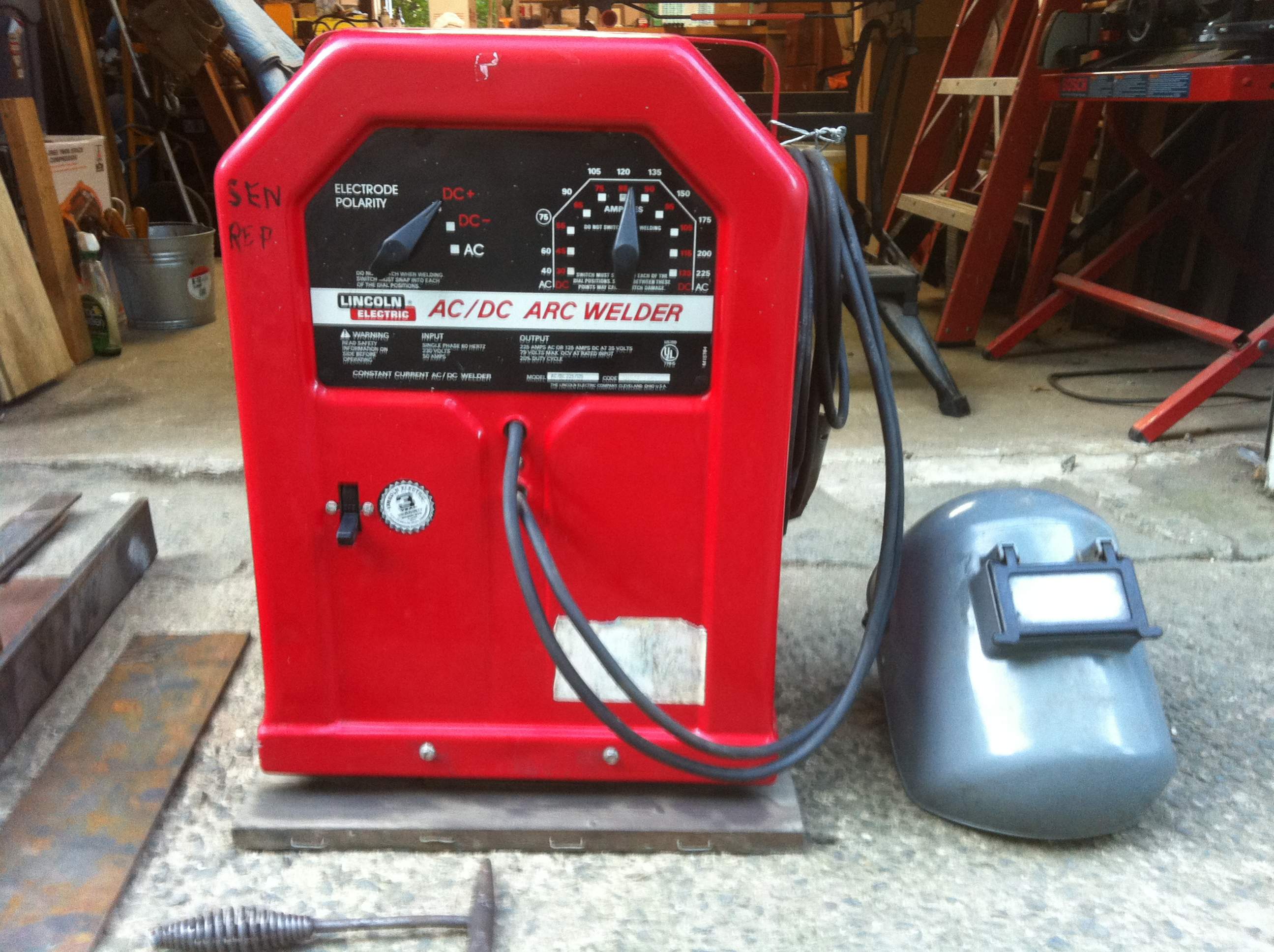

Nice thread. I just picked up a (well used) Lincoln 225 on Saturday. I have 220 to the panel in the garage, but no 220 outlets, so I too need to get an outlet wired up.
Mine came with two helmets (1 reg, 1 auto darkening) and maybe 70-80 pounds of various rods. :)

Like riding a bicycle, you never completely forget. You may be a little rusty at first, but it'll come back to you pretty quick. :thumbsup:
For starters, just get some 7014 or 6013 and burn some rod. :cool:
