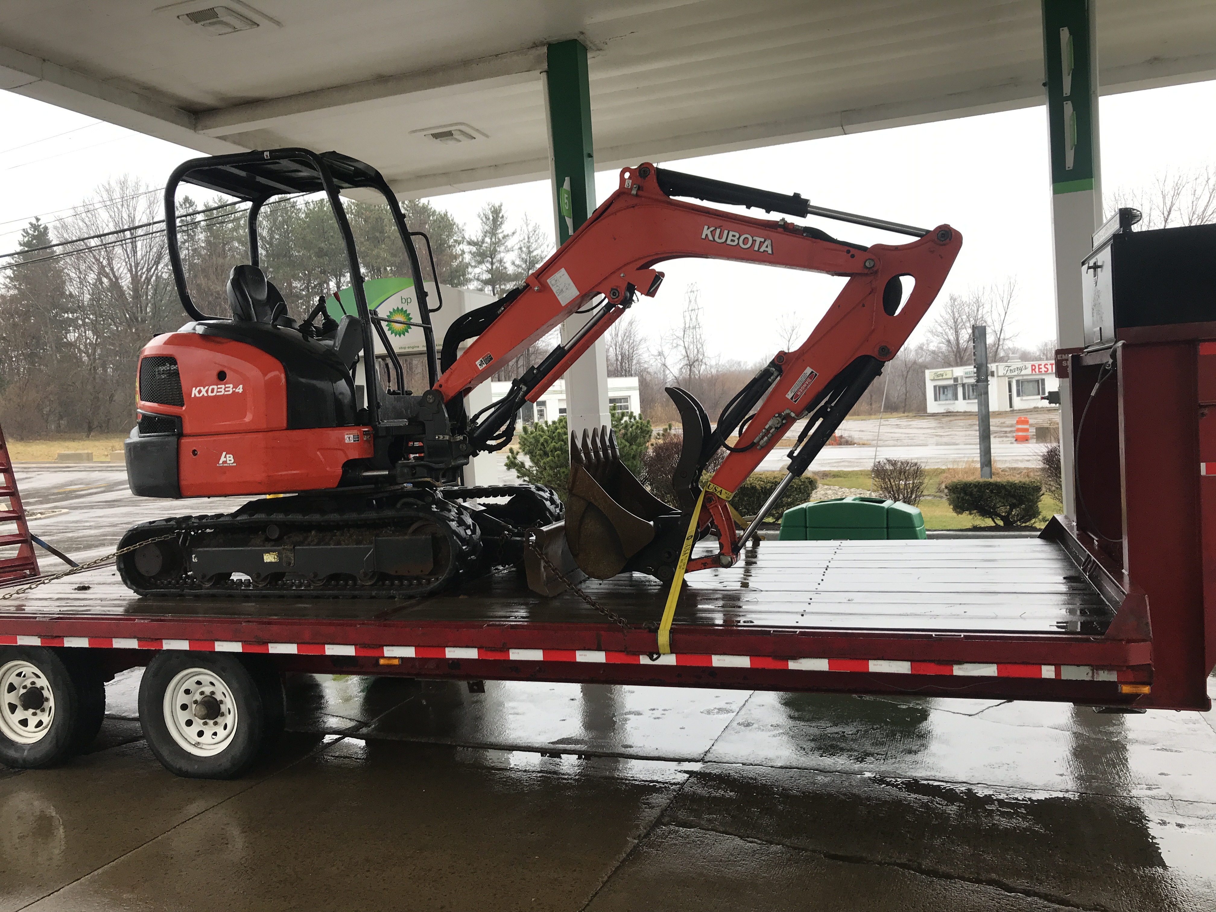

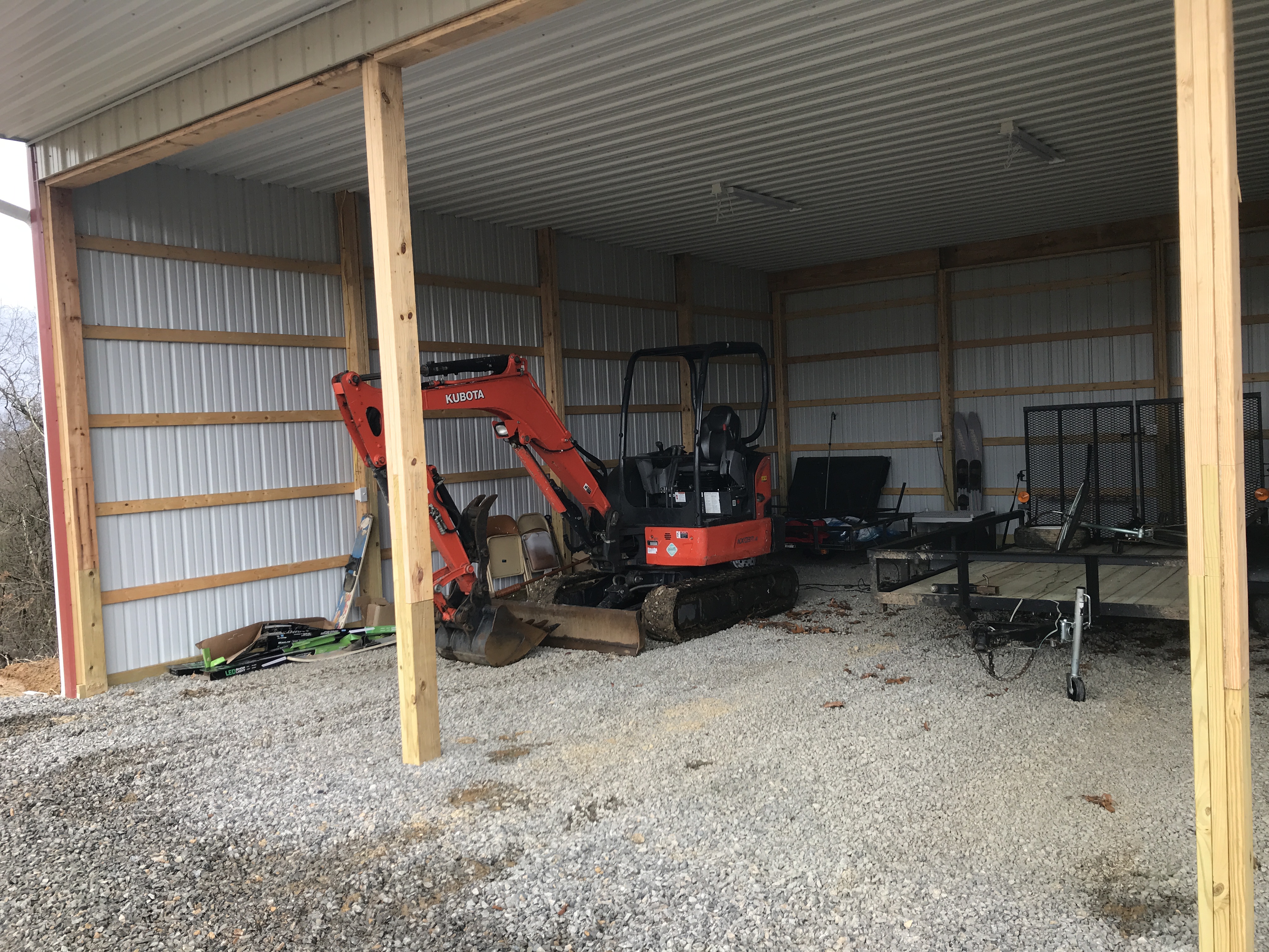

I've been shopping for an excavator for quite a while and finally found what appears to be the right one for me. A Kubota KX033-4.
It has 536 hours on it and is in pretty good shape. However it is missing the grease gun that came with it and was stored under the seat.
I'm wondering what that grease gun was like. Anyone have a pic of a kubota KX grease gun. I suppose I can order them from Kubota but I have not checked. I would like help with grease points to be sure I do not miss any.
Tips on safe operation would also be appreciated. I live in SE Ohio, very hilly terrain.

I'm looking at how you chained that down on the trailer..did you wrap the chain around the track in the rear ?

Yes. Plus after the pic above was taken we moved one of the chains and added a heavy duty strap was added to the set up. No issues towing it home.

I have a KX121... never thought of wrapping a chain there. Have to see if it is possible on mine.

I wasn't sure how to best tie it down. The ole feller I bought it from suggested that and I took his advice. Worked great.

Congrats on your purchase! I just want to offer some advice, I wouldn't suggest tying it down by the rubber tracks if you're going to be moving it a lot, you don't want to tear or cut a track with the chain. There are plenty of places to chain it down from, I usually goto the blade and the welded "hoop" under the side without the blade. You can also usually tie down from somewhere on the track frame.

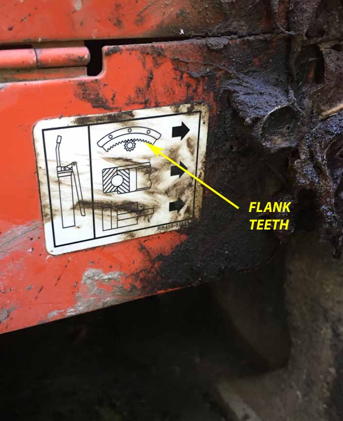

I'm totally lost on spinning carriage while greasing flank teeth. Where are the flank teeth? THX

656016d1589768537-new-me-kx033-4-a-flank-jpg
Cant see the (3) grease nipples under all that grease but you should have a similar greasing decal.
Owners manual says to grease the flank in 4 locations (Like North, East South West)
But you can spin the carriage while holding the trigger down on the 18v greasegun.
It's much more satisfying but my advice is to do it in private.
If anyone sees you having that much fun...... they will never understand and may judge harshly.

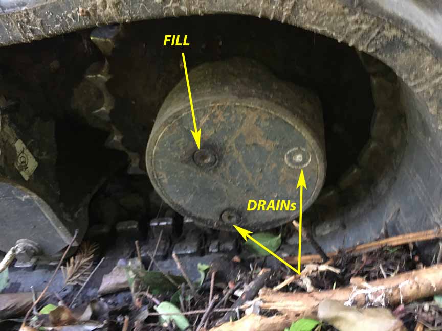

656017d1589768537-new-me-kx033-4-a-filldrain-jpg
Drain from the bottom and fill to the middle hole.
Super easy.
Just simple gear oil, 90 or 80/90.
Don't get hung up on oil type, just drain the oil with the metal dust out and refill with clean gear oil.
Special oil that you don't keep clean is not special anymore (if it ever was).
