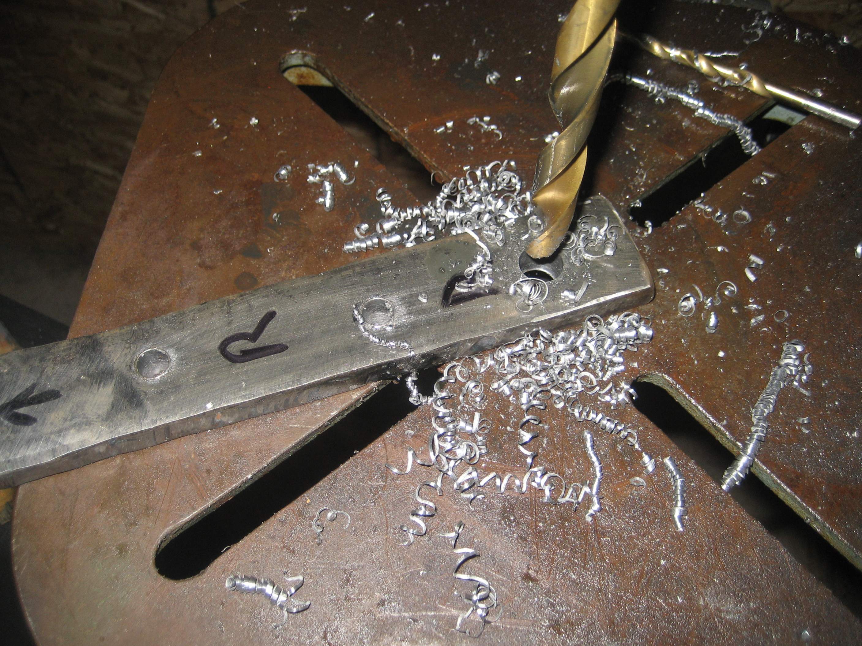

So, I got to spend some quality time with my drill press last night, and I am VERY happy with the purchase. My only complaint is that this drill press is much taller than the last one. I have to stand on a stool to see the belts, etc. I may eventually build a stand for it that will drop it down a foot or so.
At one point last night I had the drill press in about 6 pieces on the bench as I gave it some detailed TLC. I used a lot of WD40 to clean and lubricate the pieces. I think I'll probably go back in a month or so and re-clean it to get the WD40 off and try to use some kind of dry lubricant to keep the grime to a minimum. There were a few spots where I decided to use some molybdenum grease (the rods that the motor slides on to adjust the belt tension). The end result is a much quieter drill press that moves smoothly.
I've included a few pictures of 3/4" holes I drilled in 7/16" steel. I drilled a 1/4" pilot hole and then went straight to the 3/4" bit. The belts kept slipping for the hole in the first picture. It was still a TON better than what I had before. I tightened the belts and put some belt dressing on. Then I drilled the second hole. Note the long, pretty shavings that came off for the second hole. That's what I'm looking for. I still got a little belt slippage, but not like I had on the first hole.
Does anyone have other suggestions for preventing belt slippage? Do I need to get new belts or different belts?

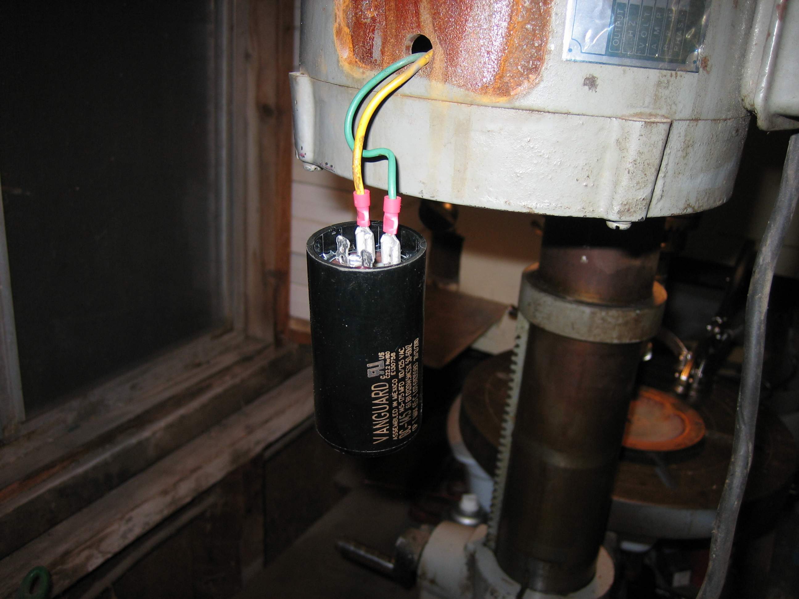

Minor setback... Today when I flip the motor switch the motor sits and hums. If I start the spindle turning by hand it keeps going. I'm thinking start capacitor.
How specific are these start capacitors? Mine is spec'd as a 150uF 125VAC Electrolytic Capacitor for Motor Starting. Can I vary from that 150uF? If I get a 250VAC one is that good enough?

Yes a 250 volt rating is fine, it is just rated for a higher voltage, the 150 Microfarad is the "capacitance" of the capacitor, I doubt it is an electrolytic tho, most likely not. Do not put an 150uf 250 volt electrolytic that is polarized (designed for DC voltage, and has a + and - connection) on it as it will go bang pretty quick. Make sure that 250volt rating is for AC..this should be a cap you buy that is designed for motor starting. You can also test the existing cap with an analog ohm meter to get an idea if it is bad or not. This take some experience, but basically put it on the rx100 scale, and put the leads on the terminals, it may kick the meter but return to an open condition pretty quick. If it shows a constant resistance, it is defective. then reverse the leads it should kick the meter again towards 0 ohms and rapidly fall back towards infinity. repeat procedure a couple of time. It wont kick to 0 with 150Uf, but should head that direction rapidly by reversing the leads, as the ohmmeter charges the cap from its internal power. good luck.

...I doubt it is an electrolytic tho,
It says electrolytic right on the capacitor. What does that even mean? Are there better capacitors that would give me better performance out of my motor?
Thanks for the heads up on DC vs. AC. I'll be sure to get an AC capacitor. Any ideas of a good online source?
Everything I've seen in a few minutes of looking has been in Taiwan or Hong Kong.

It won't hurt to change the belt if it's worn,but that belt slipping is what keeps those old machines going.That is their way of telling you to take it easier.

Most electolytic caps are polarized,(+ -) and will go boom if you put 125volts AC on them. However there are non polarized Electorlytics.
You need a motor start cap, made for that purpose. I go to a local industrial supply house for them. Johnstone industrial, or Harry Cooper. No the cap is to kick the motor over upon starting and is taken out of the circuit when the motor reaches speed.
maybe this one if you want to mail order, but I would look locally.
PSU12465 Cornell Dubilier Aluminum Electrolytic Capacitors - Snap In
Electrolytic refers to the "goo" inside between the aluminum foil plates inside the can. it is some kind of liquid paste of just what I dont know.

Bad News!! I replaced the start capacitor and that didn't fix the problem. Any advice? Do I have to charge the capacitor or something before it will work?
The symptoms are as follows... The motor sits and hums a little when I flip the switch. If I give the spindle a spin, the motor fires up and runs fine.
Nevermind. I fixed it. The little mechanism that disengages the capacitor was stuck disengaged. I have a picture of the mechanism in the first picture. I wiggled the mechanism and exercised it a few times, and it seems to be working fine now.
This likely means that the original capacitor never was bad, but for $6.50, I'll just keep it as a spare. I already changed the ends on the wires to fit the new capacitor (second picture).
