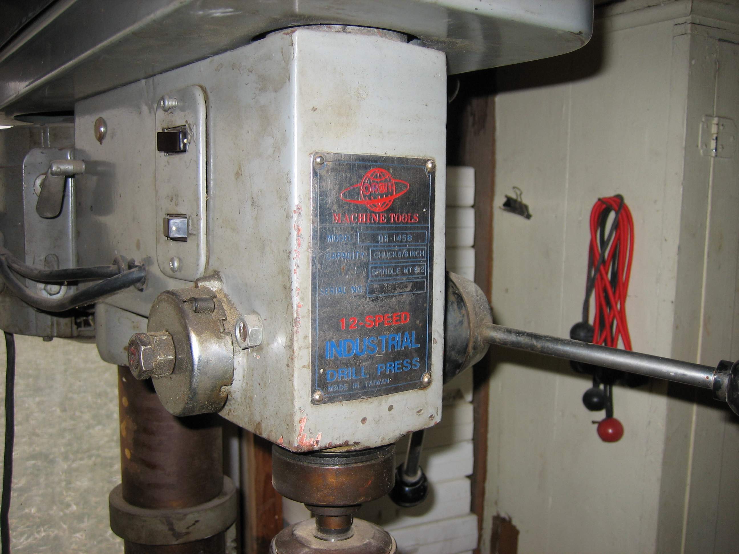

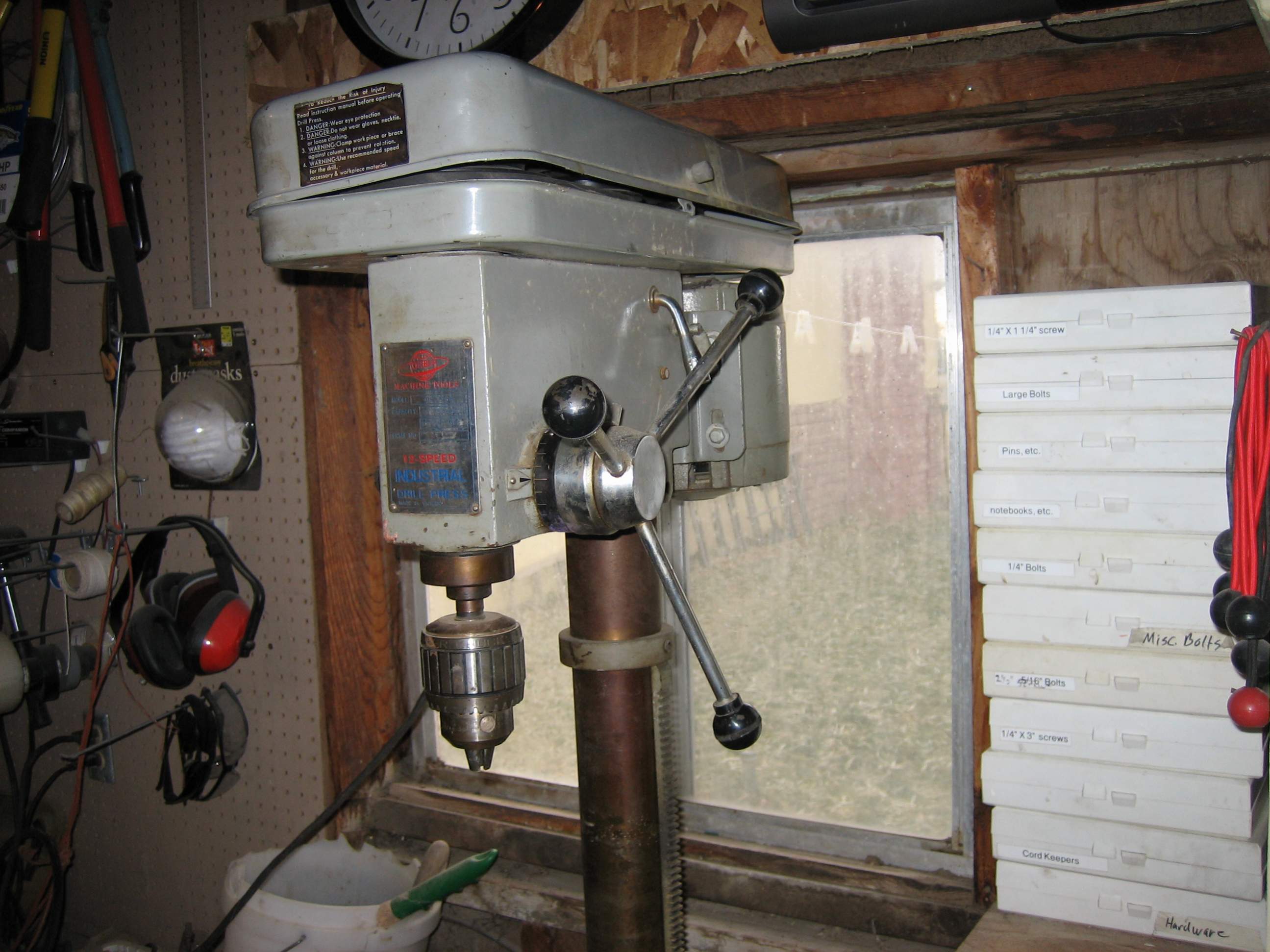

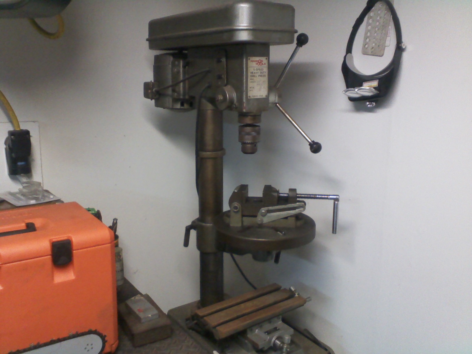

Thanks to Rawinok2 and his praise of the benefit of a slow speed drill press in his mini dozer thread, I got motivated and bought a used drill press. My wife picked it up for me when she was at a conference 250+ miles away this weekend. She is the best wife!! I didn't see it until she got home today. This thing is a Beast!!
(For those who are wondering I did give my wife a hug and ask how her trip went before I ran out the door swinging my arms and jumping up and down to get a look at the new toy... er... tool. She's sleeping now, so I've taken time to poke around and see what I have.)
It is a Orbit brand OR 1458 Drill press with a 1/2 HP motor and 12 speeds. This will be a big jump from my little 5 speed 1/4 HP Delta that I have been using. I will likely take some time tomorrow and drill some big holes in thick steel to see how well it works. There's nothing available for it on the web. No owner's manual, no parts diagrams. It's made in Taiwan, so I don't have super high expectations.
It's old and used, so I'll spend some time tuning it up. It seems like what it needs most is cleaning and lubrication. Any suggestions for a good oil to use on the moving parts of a drill press or how to clean it?
I also need a chuck key. I've never had to buy a chuck key. Do I just need the numbers off the chuck to get the right key?

Nice drill press. Is that a Jacobs ball bearing Super Chuck. If it is, that chuck is worth way more than you probably paid for the drill press.
Looks like you also have a morse taper spindle. Drop the quill down and see if there is a slot for a drill drift used to remove drills and chucks. Then you can use morse taper drills and other tooling.
One of my drill presses looks identical to yours. It's made in Taiwan also and called a Packard. It has a Morse #2 spindle.
Congrats on the new tool, and the great wife.

You can clean most of that with steel wool, I would not apply oil to the moving parts except maybe the spindle, if there is a way to do that, I never have. Oil on any of the gears or other moving parts is going to attract metal chips etc and do more harm than good.
I've had no problems with mine, It's not as slow as it should be for boring large holes over 3/4 " in thick metal over 3/4" but for most tasks it works well.
I keep a plastic garbage barrel cover handy to put under the round table to catch the majority of the chips. I also have a cheap vise that helps tremendously holding what ever I'm drilling.
Good luck, JB

You will need to clamp your work to the table as this drill press will not back down if the drill grabs. I use SAE 10 w 30 oil. I am not sure if your chuck is a morse taper or not . How I would find out is to stroke the quill down with power off and see if there is a slot through the quill shaft. If there is you use a a tapered drift to drive the morse taper out. Then you can buy a set of morse tapered drills and really start making holes. You could also buy a set of 1/2 inch shank drills that are turned down and you can drill up to 1 inch steel with ypur drill press.

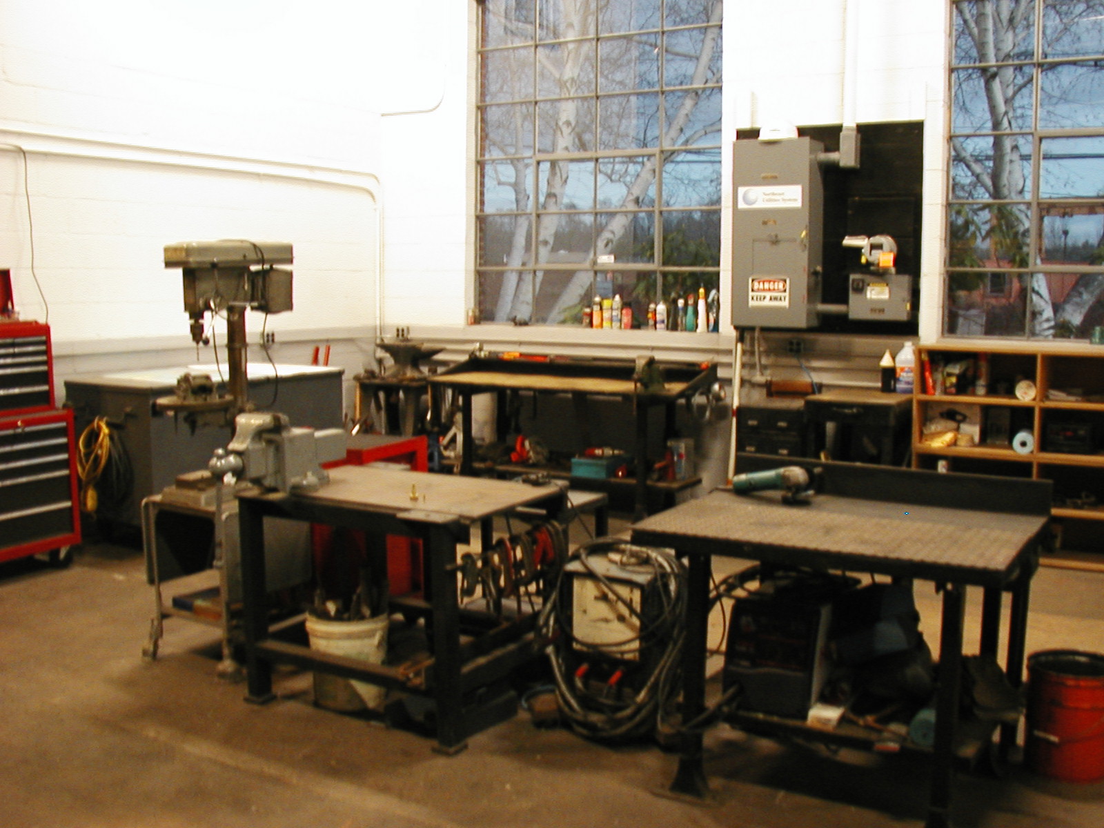

JB, your shop makes me sick. :rolleyes: Tall ceilings, windows with a nice view, lots of tools and the worst part, neat and clean. I'm very envious, oh well maybe someday. ;)

QUOTE: I also need a chuck key. I've never had to buy a chuck key. Do I just need the numbers off the chuck to get the right key?
It is best to take the chuck to a machine shop supplier to get a quality key that fits correctly. There are minute differences in keys that make them real aggravating when they don't match the chuck correctly.

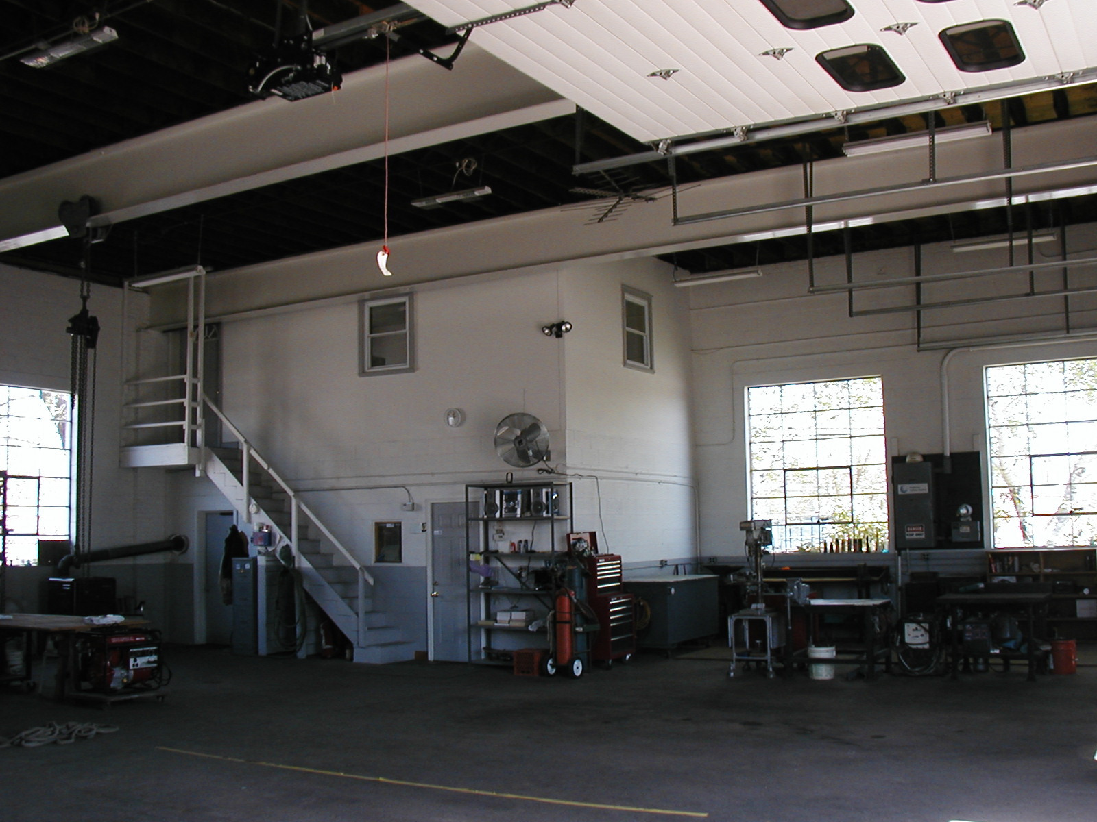

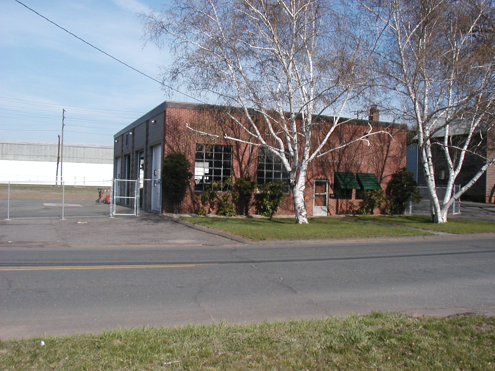

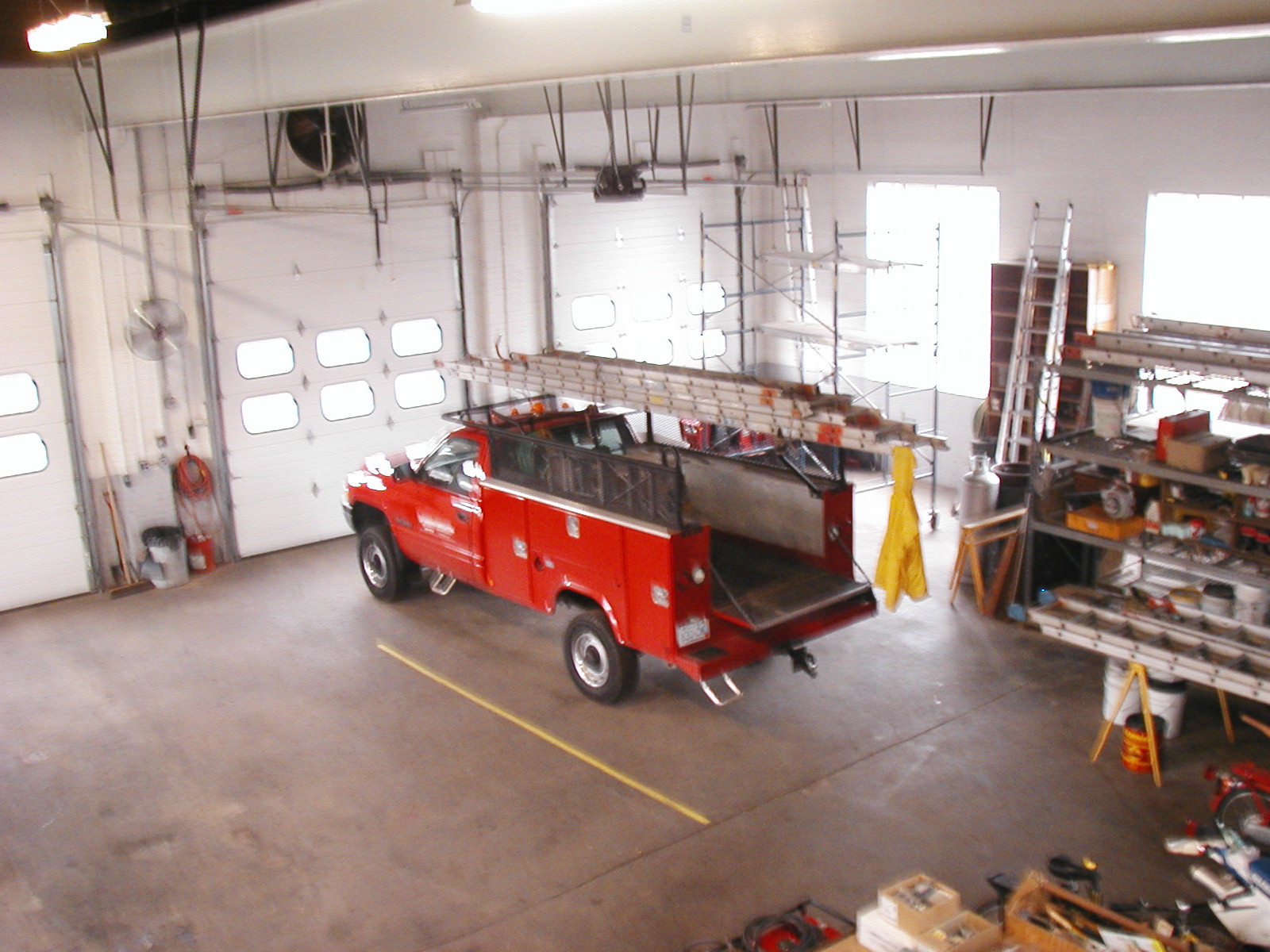

I'll show you some more pics just to show off, but don't be envious, cause I don't own it anymore. This was a commercial building I bought in terrible distress, renovated it and used it for just a few years, and had to sell it.
Don't feel sorry for me either though, cause I didn't sell cause I couldn't afford to keep it. I sold it cause I couldn't afford not to. Got made a deal I couldn't refuse :eek:
The building was awesome though for us mechanical type people.
Masonry construction, 50'x60'= 3000 sq ft. 18 ft ceiling, four 10'x12' doors, one 12'x14' door, 2 storey office suite. 36" I beams with hoist trolleys, 1 acre of fenced, industrial zoned lot.
I do miss it but really didn't need it, got a smaller shop behind my house now. No overhead doors, but I do have a 20'x40' covered truck port at least.

Went out to the shop to see if there was a number on the chuck key but there isn't. Measured the nipple part of the key, that goes in the chuck, it's 5/16" dia. and there are 12 teeth on the key. don't know if that will help.
The chuck says "Select" JT-3# 5/8 cap- 18mm.
An old timer taught me a trick for tightening a chuck, tighten from all three holes, progressively tighter from the first to the third.
Don't know if that's any secret or common knowledge.
Mine still has the orig price tag on it, $149. in 1981. I bought it used for the same amount around 1993.
The speed on mine goes from 460 rpm up to 2400 rpm

WOW, Thanks for all the good info. I was excited about this drill press when I got it, but now I'm even more excited.
The chuck IS a Jacobs ball bearing Super Chuck. I really don't know what that means, but I trust flatheadford that it's a good thing. The numbers on the chuck are Jacobs 16N 3 UT, 1/8 - 5/8 CAP. The spindle does have the slot in it. The spec plate on the front of the press calls out the spindle as MT#2. I assume that means Morse Taper #2. Once again, I don't know what that means, but I'm excited to find out. I did a little more looking and found that a Jacobs K4 key fits the 16N chuck (and others). I'll see if I can find a K4 key locally. If not, I'll try and get the chuck out and take it in to get the right key. I don't even know where to take it around here. I'm guessing Ace Hardware is NOT the place. I may have to ask the guy at the machine shop where I've had a few things done.
Craig Clayton's suggestion that I can drill 1" steel is nice. I'll have to look into morse tapered drills and see what you're talking about. I guess that means I need to add a tapered drift to my wish list.
Thanks to all who posted brand names of your similar machines. I may need to cross reference one of those machines to get parts. I'm pretty sure I'll need a recoil spring. I'm guessing that Baby Grand's Black & Decker will be the easiest to find. Baby Grand, what is the model number of your drill press?
My slow speed is 250 RPM. I'll work with that for a while and see if I want it any slower. I know that there are router speed controllers available to slow the speed down even more. The chart on the lid of the drill press specifies speeds for both 60 Hz and 50 Hz. The 50 Hz. speeds are, of course, slower. I didn't even look to see the high speed for this drill press. I'd guess it's in the 3K RPM range. I may use the higher speeds for a sanding drum, etc.
As for the cleaning and oiling, Everything on this drill press is stiff. The table adjustment, the spindle, the belt tensioner. The motor is a little loud, too. I may pull it and see if it has an oil hole. I'm hoping that with a little cleaning and oiling and exercising of the moving parts, I can get this ugly old beast moving gracefully and smooth.

Yeah, I think the chuck is a keeper assuming it still works.
I got the K4 key from a machine tool supplier this afternoon. It's tight, but it will work.
