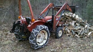

The aspect of chains falling between lugs is a myth. They only fall between lugs when you are looking at them on the top of the tire. At the bottom where the tire meets the road, they are the prominent entity digging into the ground. Just do not put them on dead tight. In this picture it is clearly evident that the chain is hitting the surface before the tire. Any chain will help you out including 4 link ladder chain.
