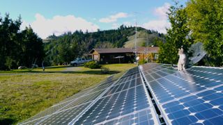

Well today (Wednesday 10/5) is the first full sunny day we have had. Today's harvest was 54 KWH, and 275 KWH since it was turned on on 9/25. I am pleased considering the crappy weather. Forecast is for clear sunny days thru Monday, so I will see what we get.

Here in California, we have some of the highest electric rates in the country. I had a 6kw grid-tied system professionally installed 2 years ago. In the summer, it produces 40-45kw per day. Prior to the install, my average yearly electric bill was $3600. Since then, $0. Peak summer rate was $0.33/kwh, off peak (9pm-12 noon) $0.10. Winter, $0.12 peak, $0.08 off peak. This is time of use metering (TOU.) Thus I am selling power to the utility at the highest rate, and buying back after dark, and winter, at the lowest rate.
The rates have just gone up:
Peak Summer $0.44703 (R)
Part-Peak Summer $0.20182 (I)
Off-Peak Summer $0.12183 (I)
Part-Peak Winter $0.16794 (I)
Off-Peak Winter $0.12503 (I)
Thus, I will probably be getting a cash refund at the end of the year. I have no doubt this will not be the last rate increase.
