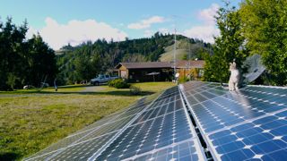

Well today (Wednesday 10/5) is the first full sunny day we have had. Today's harvest was 54 KWH, and 275 KWH since it was turned on on 9/25. I am pleased considering the crappy weather. Forecast is for clear sunny days thru Monday, so I will see what we get.
paul
