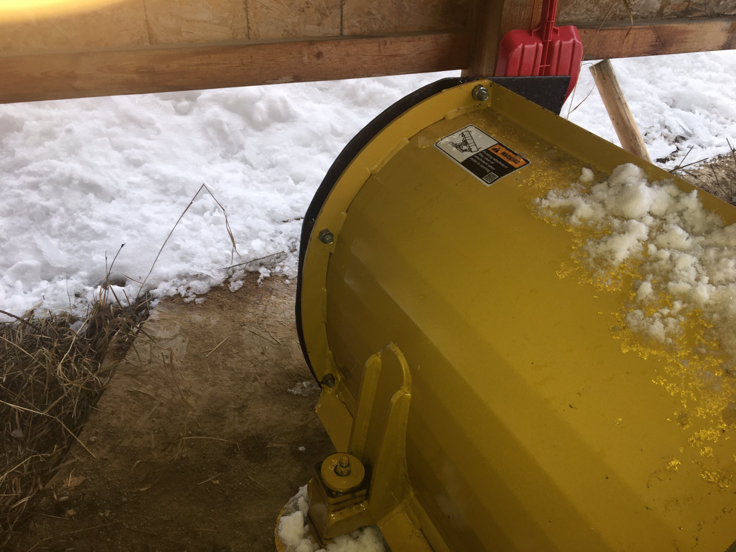

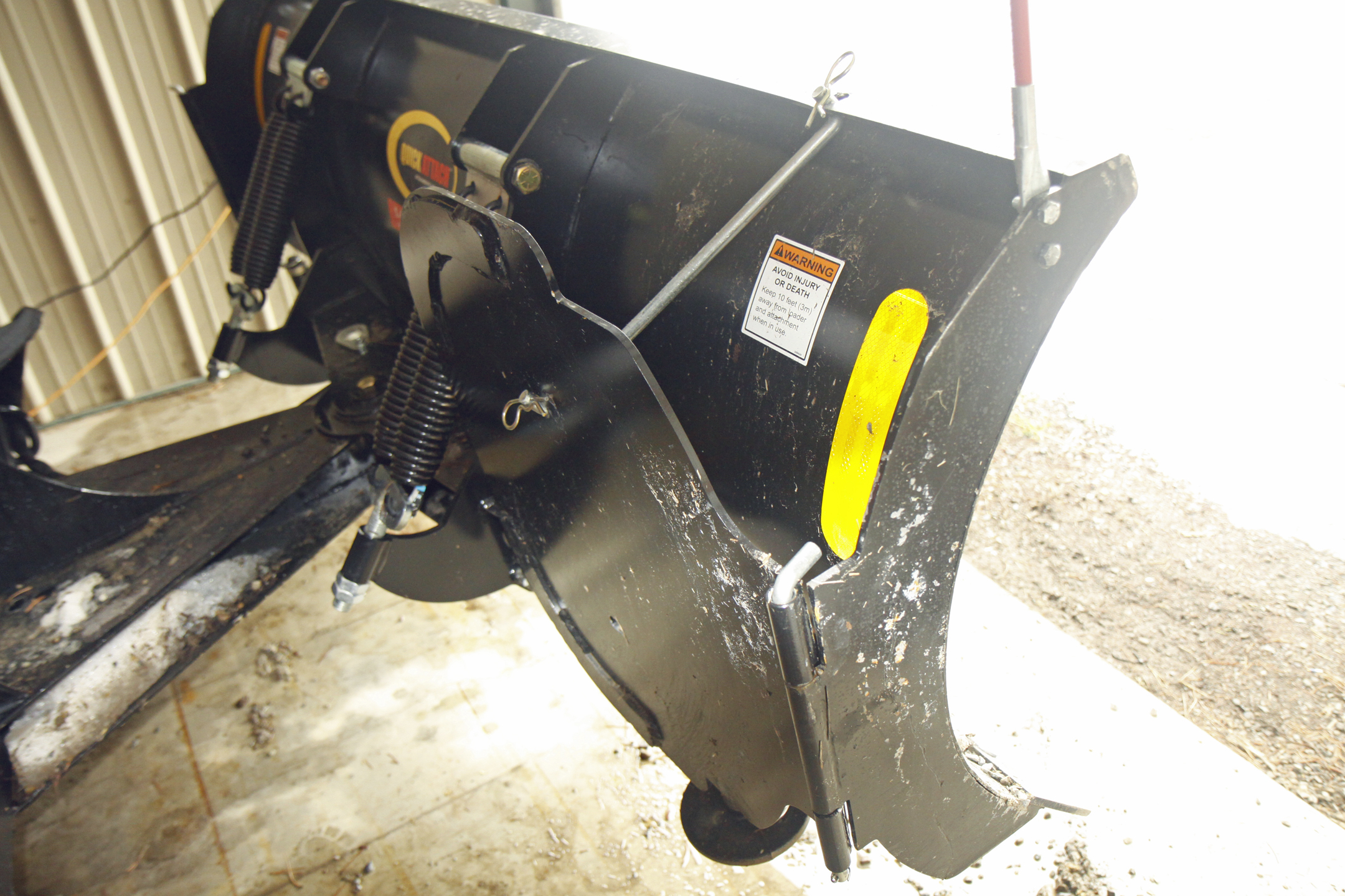

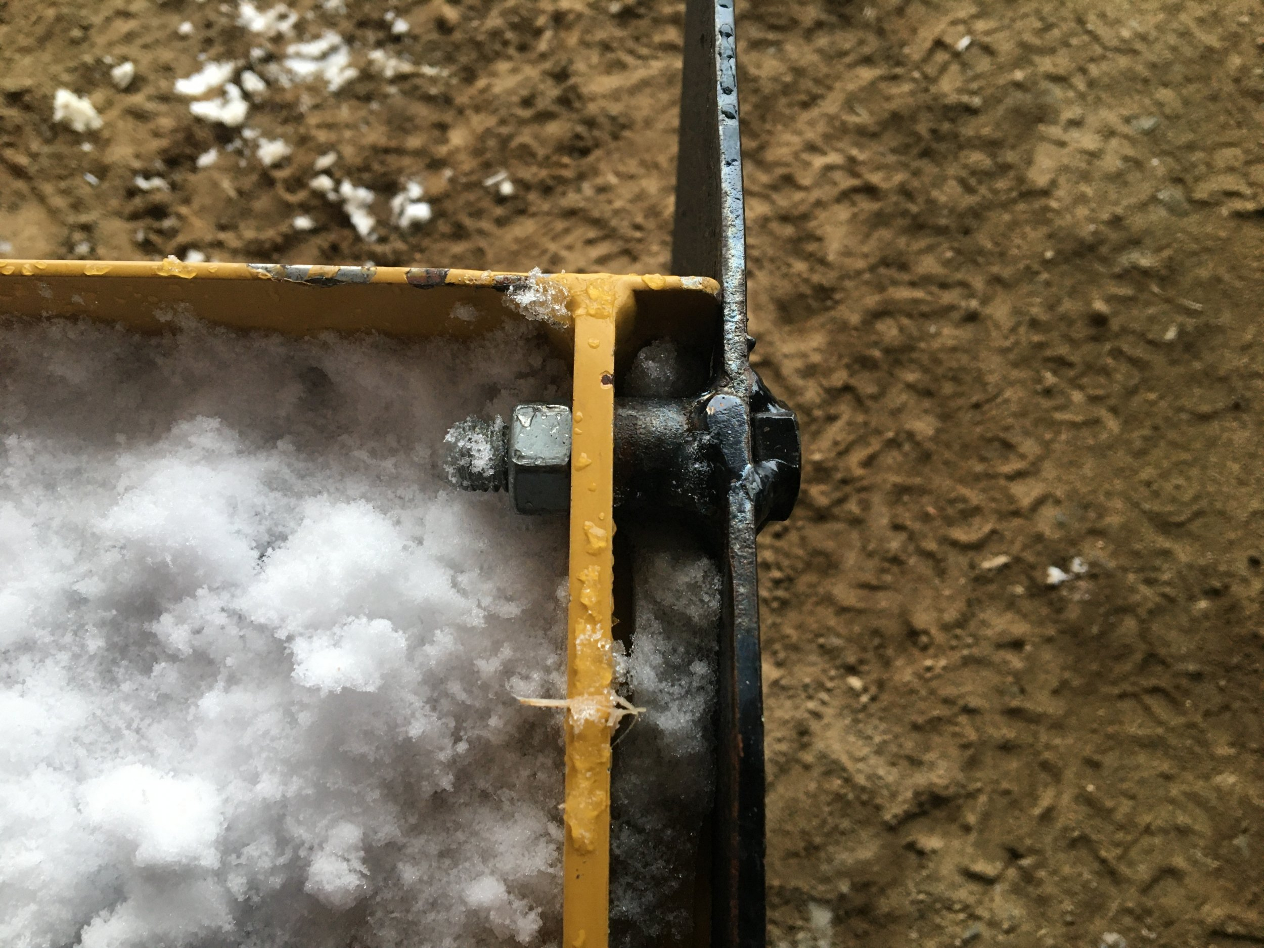

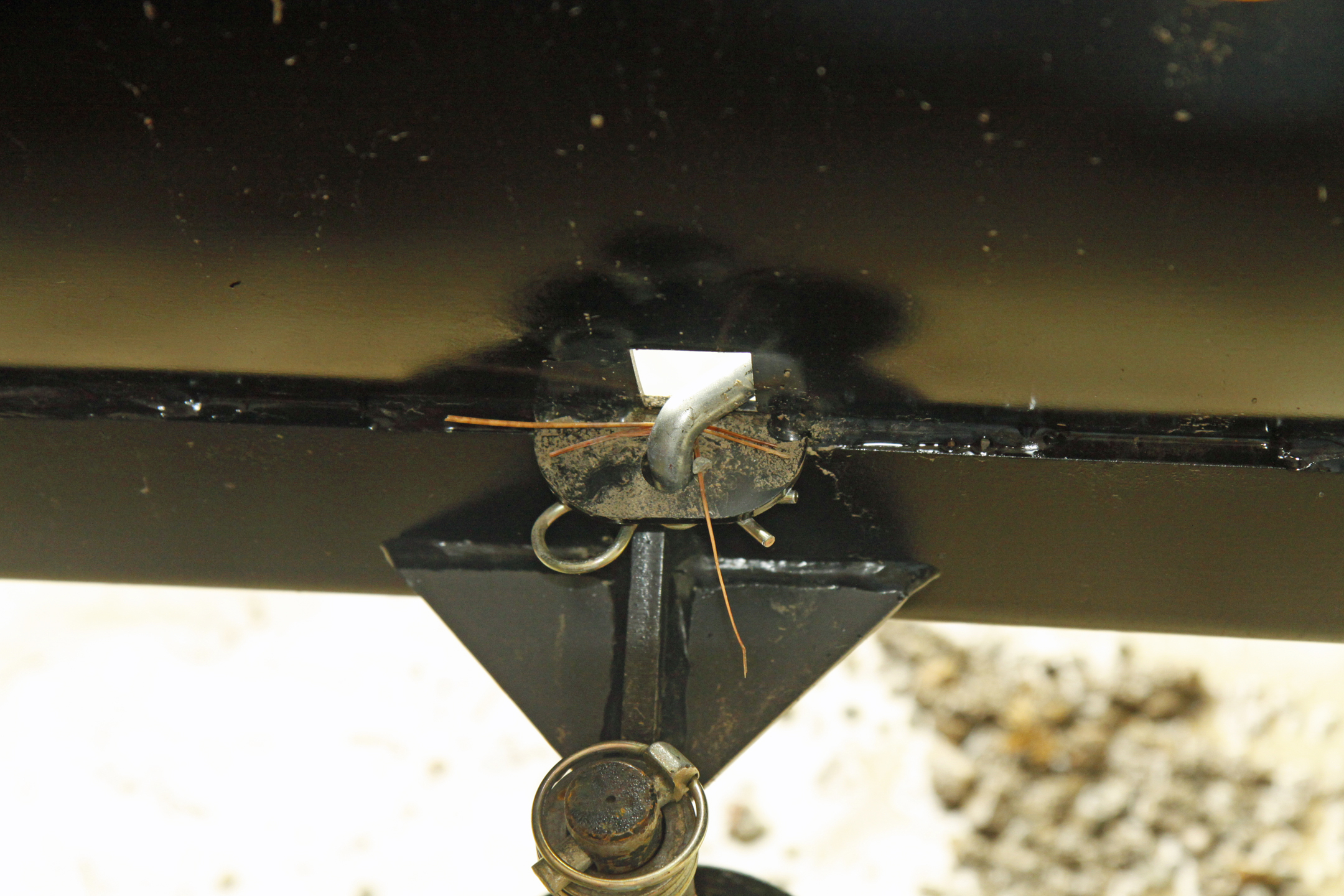

mind you, i didnt build this. i purchased it.
there are a few holes in the blade and in the swings with a bar that swaps between the set of holes. one set holds it open. one set holds it closed.

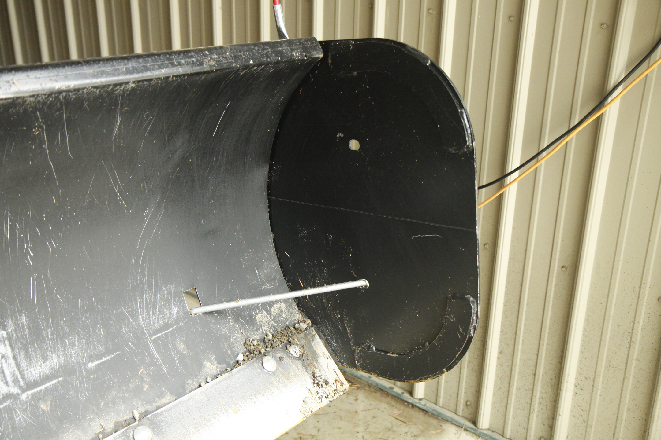

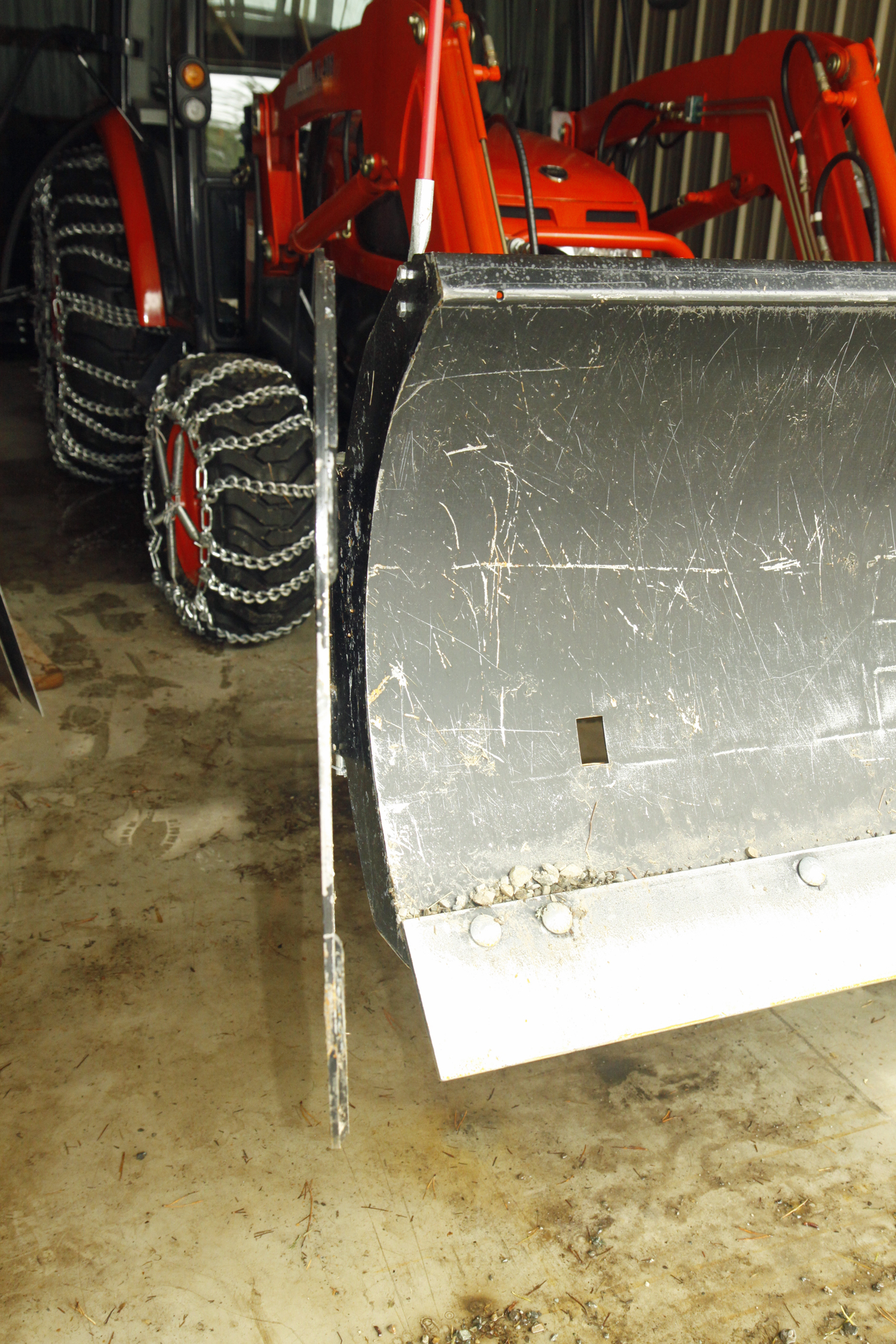

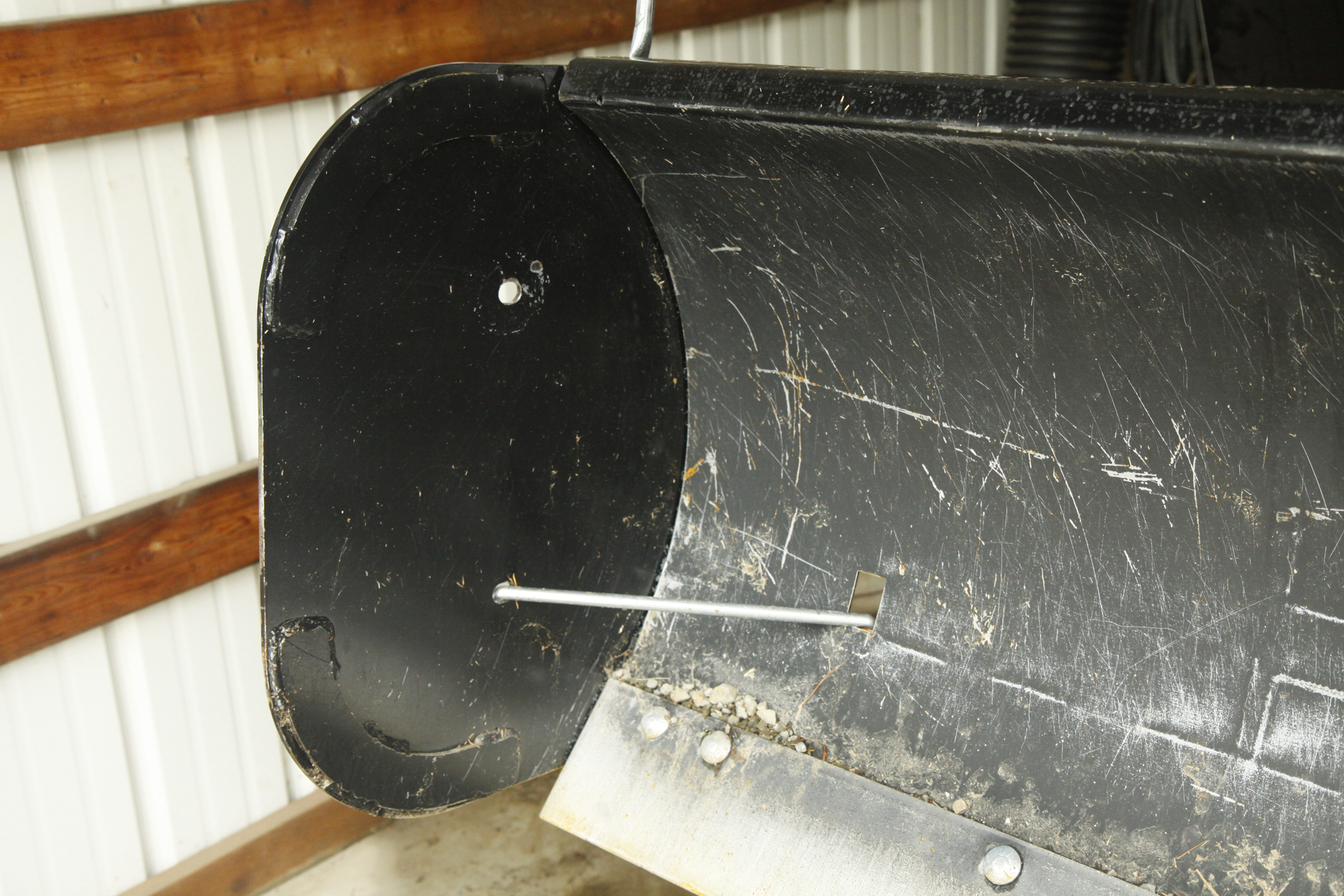

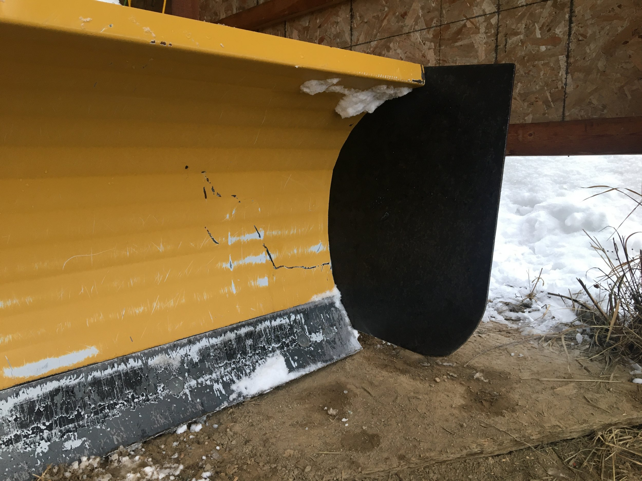

The plow is a 96" HLA 2000 as you guessed. The side plates are something I made to help contain the snow. They work better than expected but I never knew until I took some videos. I couldn't really see how they worked from the seat in the tractor. I think they are 3/16" plate that I cut to suit and just made some spacers to fit between the plate and the ribs on the back of the plow. Then welded some bolts to the plates that just bolt to the plow. It takes a few minutes to put them on or take them off. I've been thinking of making some sort of permanent mount so they just swing out of the way when I don't want to use the plow as a pusher.
Here are some pics.
View attachment 732273View attachment 732274View attachment 732275
Thanks for the detailed photos. It sure would have been nice if the rib was flush with the moldboard. I may try your solution, but I am a terrible welder.
/ New snow #205
You don't have to weld anything if you don't want to. Just cut some pieces of pipe with the right size hole and feed the bolt through the pipe when you mount the side plates. It's just easier to have the piece of pipe and bolt welded onto the plate.
