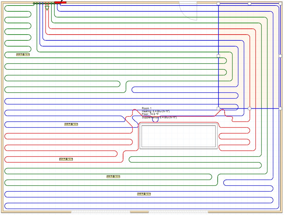

Thinking it over again, I'm gonna talk to the guy, might take him up on the quote for rebar if he'll give me a week after rebar so I can get the PEX in... I attached a picture of my first go at the PEX layout in LoopCAD, two openings on the bottom are rollup doors, open box is 4'x13' for the lift about 12' from the door, box in top right is office/bathroom/loft space. I'm not used to the software yet so getting dimensions is difficult, I don't know if the big doors or box are in the right spot or size...

I'm not sure I get the sonotube bit, what's that for? I've given up on the gantry idea, if I go with a 2' grid of rebar suspended on the brick things it should be good to go and have the PEX zip tied to that with 12" spacing or more. Looking online a 9000lb lift should be perfectly fine on a 4" slab so flat 6" should be just fine without anything fancy.
As far as spacing for the lift, my longest vehicle is I think 22' long (crew cab long bed '97 F350) so 14' from the door should be fine for the center of the posts.

They install those lifts in all sorts of older buildings where no provisions were made for thicker steel. Most lift platforms have large bases to spread out weight. I have powered up lots of them placed in 30 year old garages and shops. Now having pex heating tubes present....that could be an issue. Need to plan around lift. I have seen so many of those tubes ruptured over the years. Also, better plan on investing in a good infrared camera device. There great for finding the tubes as long as unit is running and producing heat.
