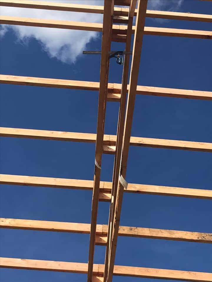

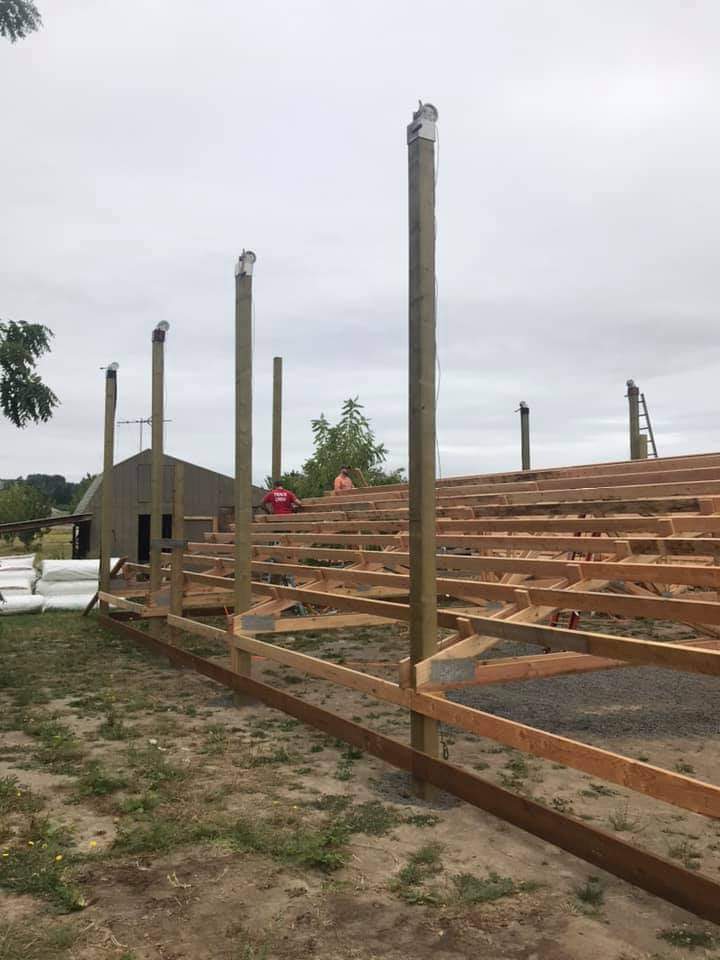

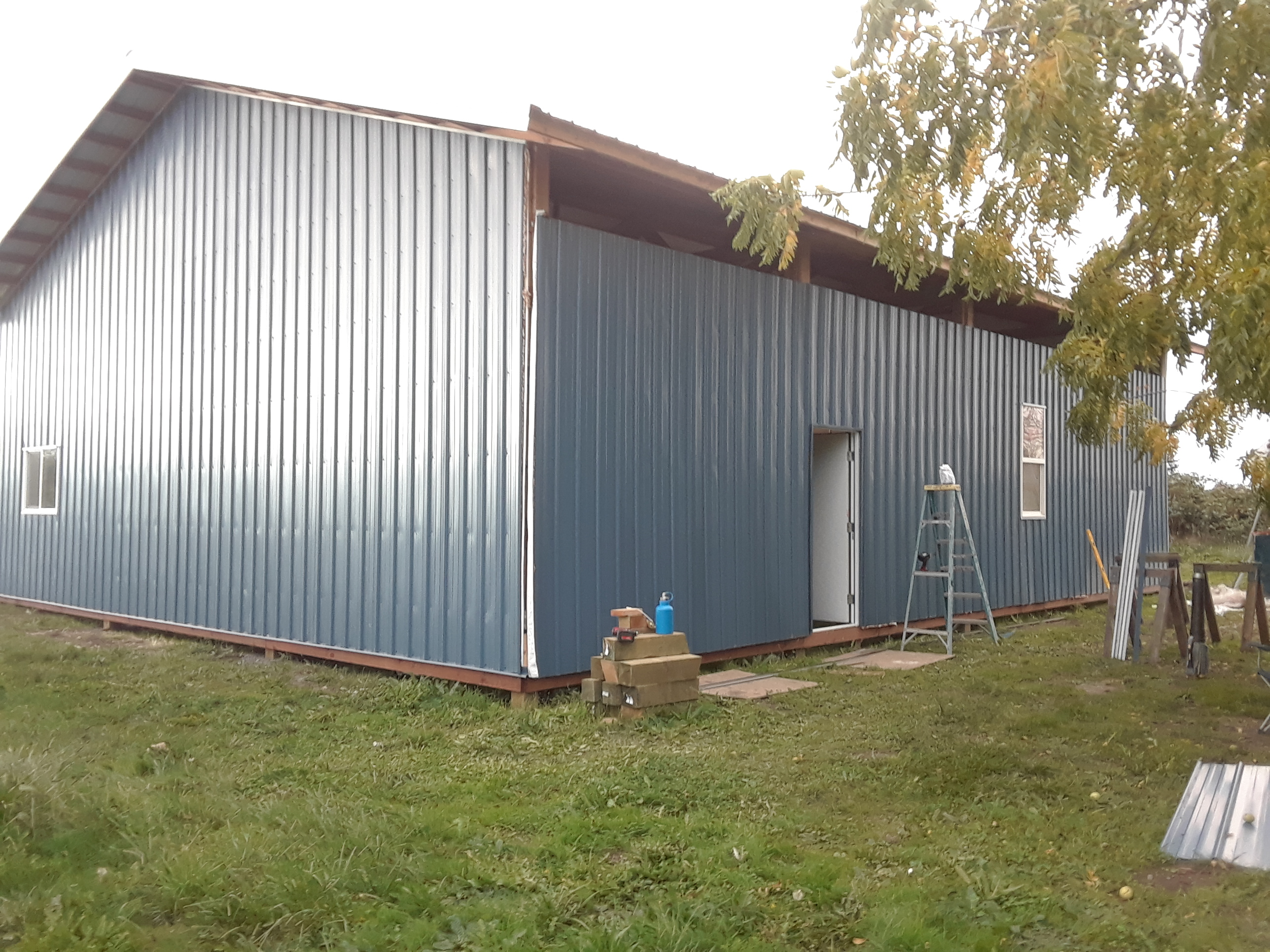

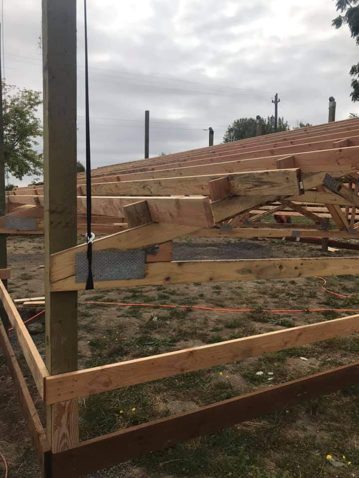

Here's some pictures, the only one with siding is from yesterday, that's the last of the tin sheeting, I still have to do the corner flashing and the eave flashing but that's it, I took the picture before I got the bottom trim on the man door side wall. The clear panels will stay off until I get the concrete poured for ventilation, unless that's not necessary...
The rest of the pictures are of the work party day, one is of my square that went for a ride :)

thanks for the pictures. those winches on the tops of the posts surprised me. I've never seen this before.
   / New shop build, beginning stages with questions #125
thats how they do it here in north idaho also. seen it done many times. its how they did on 2 of my 3 buildings. was amazing to watch.
   / New shop build, beginning stages with questions #126
My pole barn trusses were "raised" the same way! The installers even let me climb up the girts and assist on one of the winches. So I guess you could say I helped build mine. :laughing:

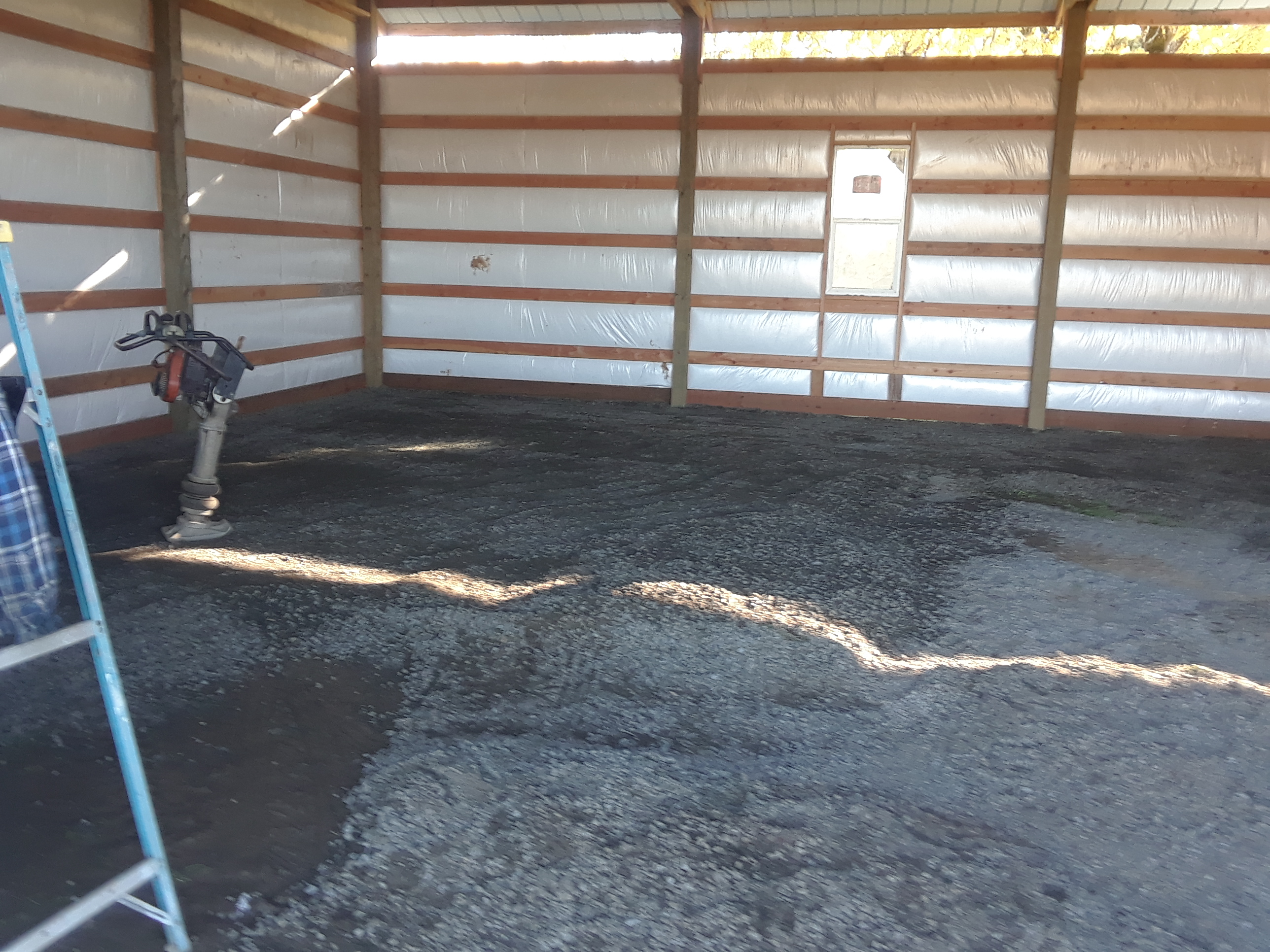

I don't feel like pulling pictures off my phone right now, but I spread all the gravel between yesterday and today. Also ran the jumping jack around for the first round, need to get a laser level to get it level all around. Also realized that my math was WAY off on how much gravel I needed... I had gotten 2 loads last week and after spreading I still need another 7 yards if I estimate reasonably, so another load it is... I tell ya what, having a bigger tractor or a skid steer would have been nice spreading the gravel, on a rough estimate it was about 150 buckets for around 17 yards.

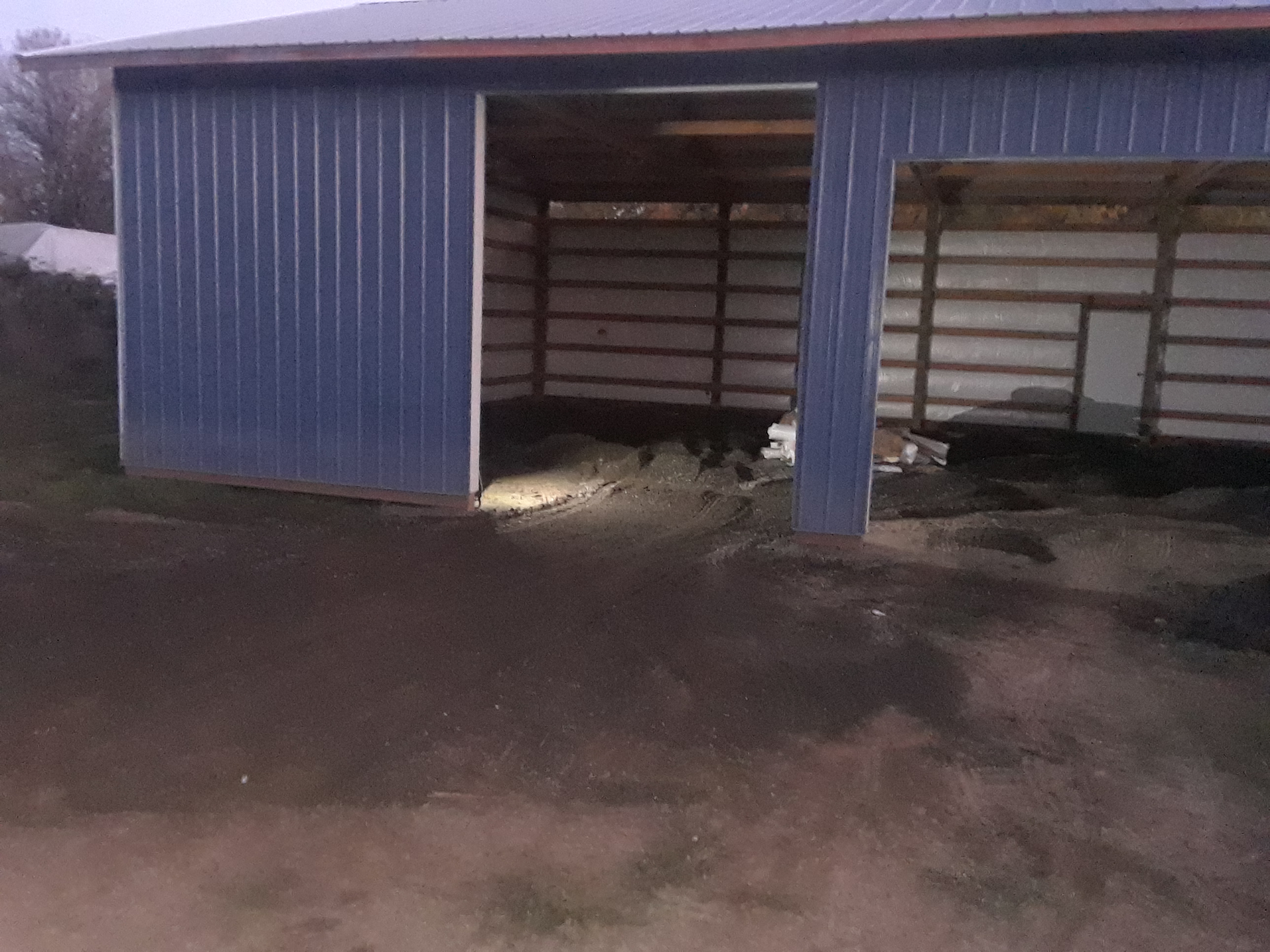

Ok, here's some pictures from the other day.
One is from the outside in near dusk, I had just finished moving the two truckloads of gravel inside...

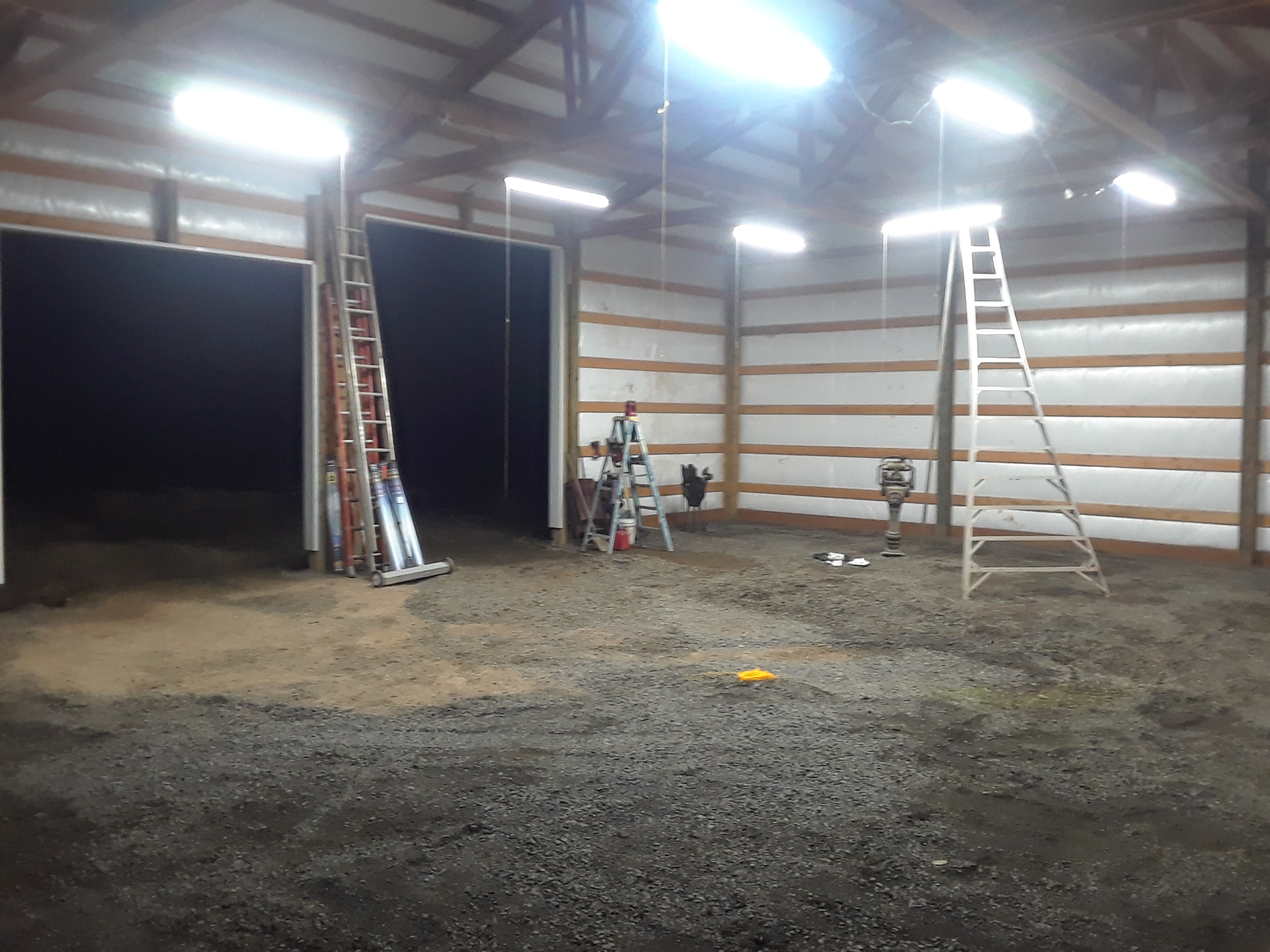

Another is with the jumping jack off to the left, I'd just got done with the first round of compacting

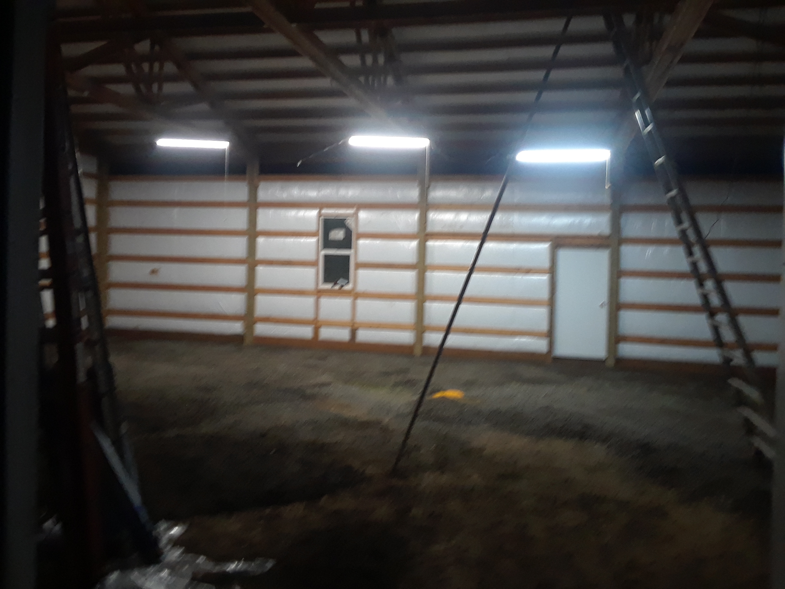

The other two are the progress of the lights, the pic with 3 lights, the two on the left are the cheap ones from HFT, the bluer one is the dual row linkable more expensive version... For the difference I'm going to get more cheap ones and keep an eye open for the better ones on sale... With 7 of those lights it's pretty bright in there. The cheap ones are $18 ea no coupon needed until the 11th...
