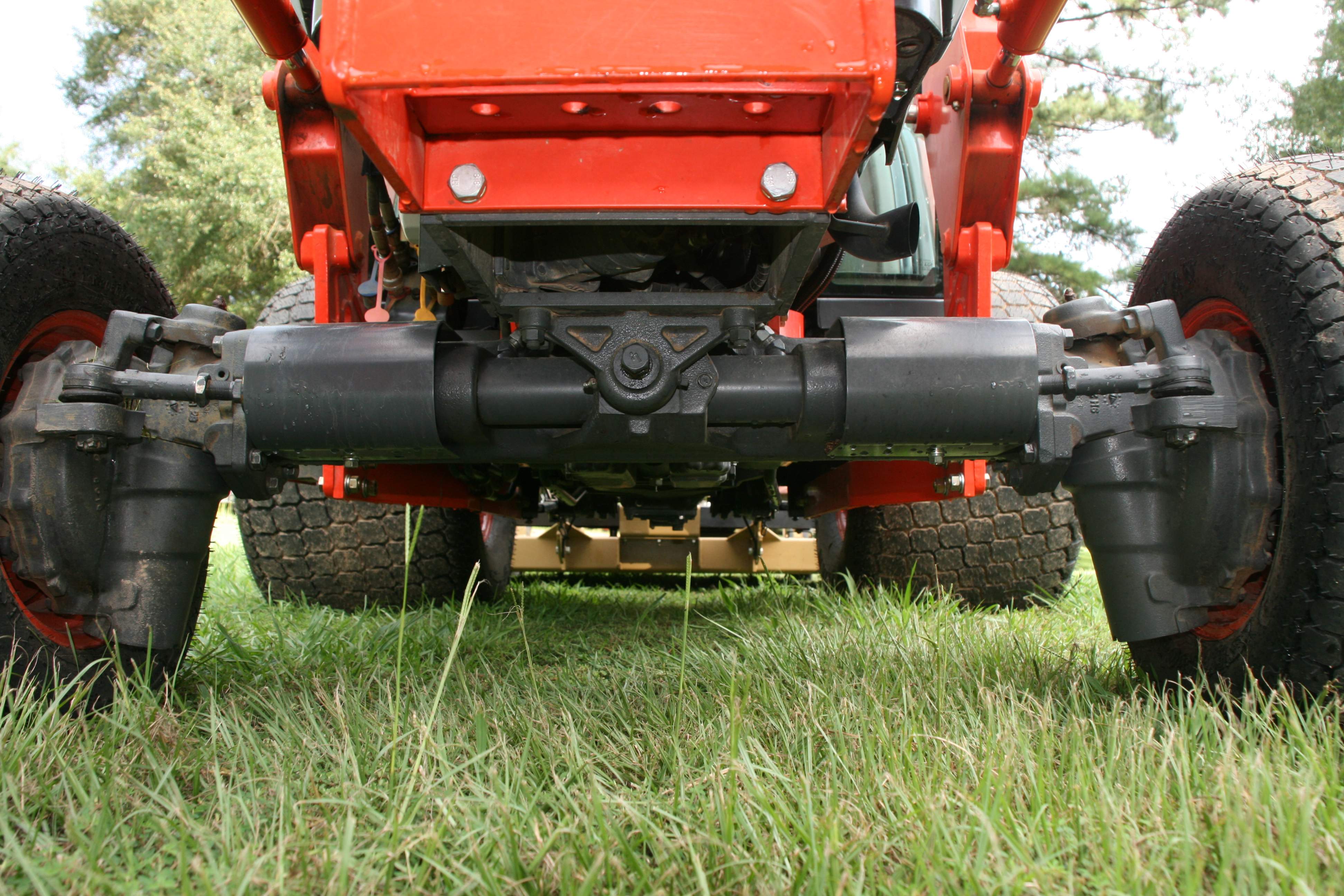

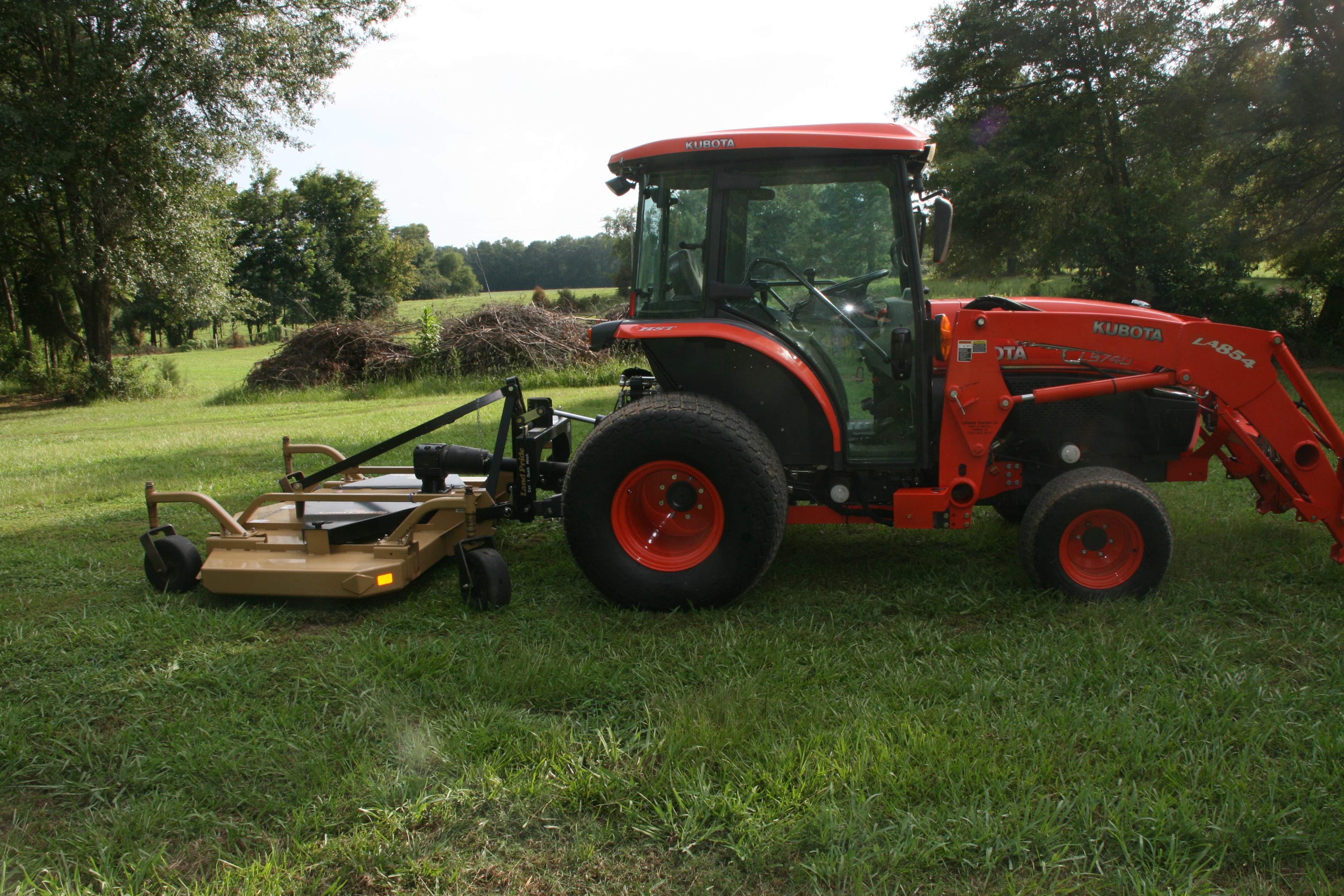

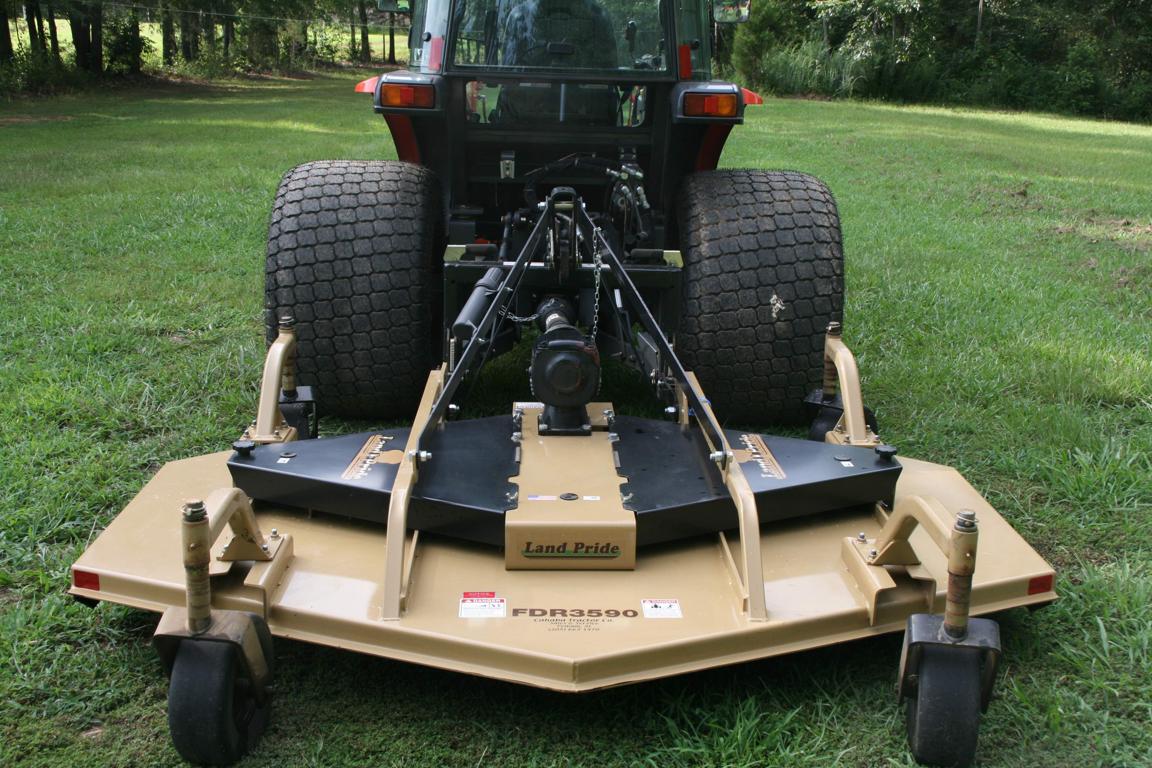

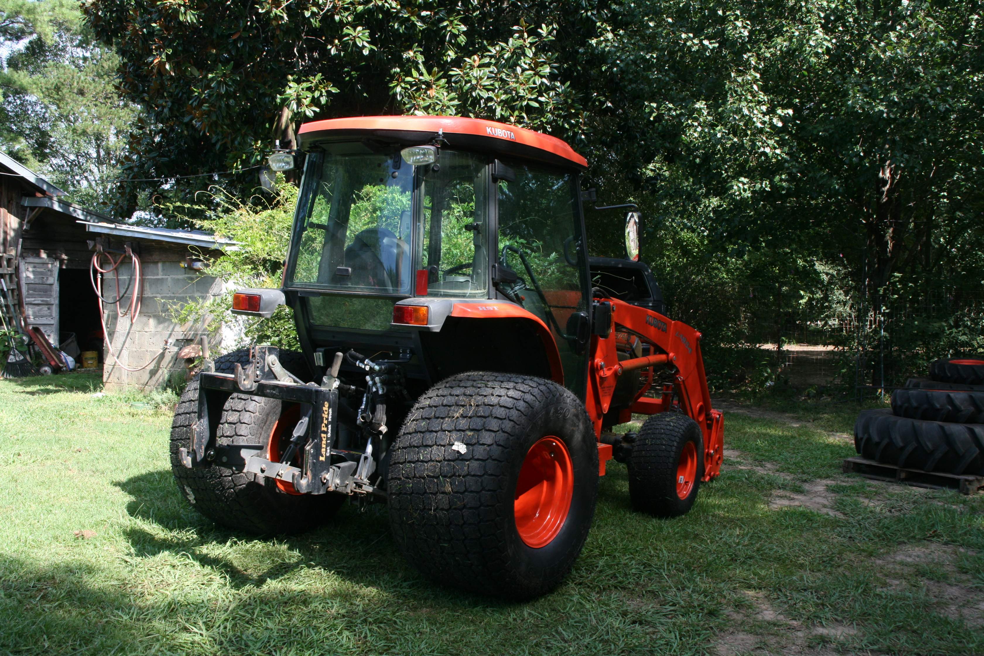

My L5740 ("Big T") came back today with some new shoes. Kind of funky looking, but should do the job they're design for - saving my turf and my ribs. My loaded Ag's were leaving shallow grooves in my fields. I spent days/weeks smoothing them with disk and tiller only to have them go washboard on me with each cutting. Rear tires have around 22" of thread width - fronts about 11". Additionally, with these turfs, my tractor has been lowered about 5". Should be a bit more stable on the hills.

Very nice! Boy those rear tires are wide! They should be very easy on your lawn :thumbsup: Where did you get them? How much did they run you? Did you need to adjust the tractor's 4WD to account for the different diameter tires? I would sure like to have turf tires, but I'm still doing work amongst trees, branches, stumps, etc., & I'm concerned I'd pop a tire. Maybe I'll swamp if this work ever ends :eek:

Nice looking field there!

Those back tires look like you're ready to do a few laps on NASCAR. :laughing:

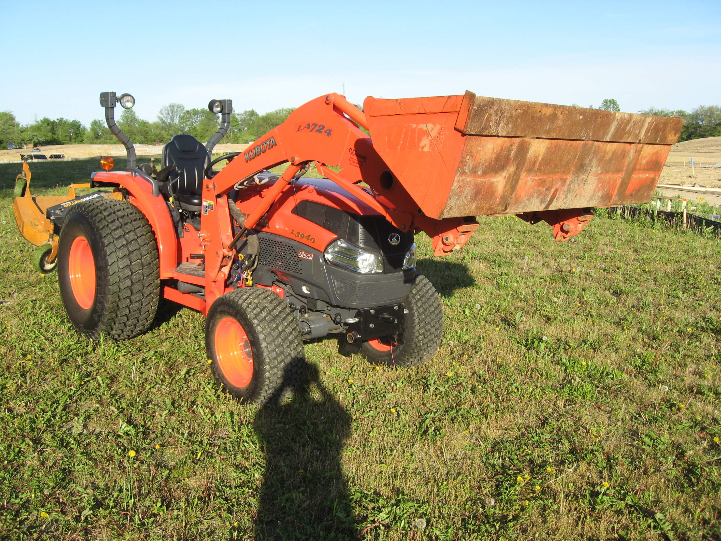

I would say he op has galaxy 'golf course' tires due to the minimal tread depth, but they do not look oem. Kubota offers 3 types of turfs. The galaxy, the ones you see on my tractor here, and a narrow set of mis-matched turfs. I am very happy with mine. Philip.

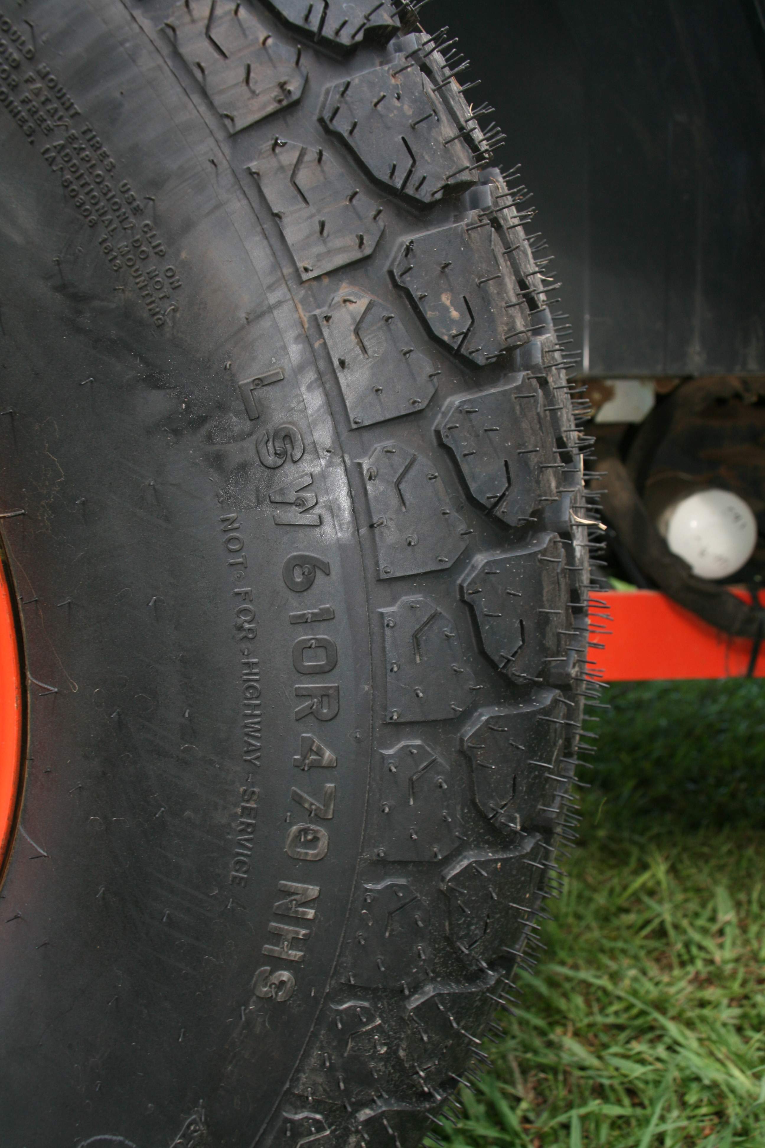

Here's more of the story. Told my Kubota dealer that I was tired of the ruts and to get me some turfs to go on my L5740. I didn't really care too much about the cost. I'd worked too hard and long getting my pastures smooth and I didn't feel like going back to rough - kidney and rib busting rough. He told me he had 2 sets in stock, but they had already been spoken for - a local golf course. So, told him to order me some - guessing I got the same. It took about 2 weeks for them to come in and I'll admit I was somewhat taken aback in their shape. Not so much with the width (wider the better), but with their height (10" smaller diameter vs stock R1's). Sure leaves an empty looking wheel-well. The lowered ride does have some benefits, though. Especially going side-to-side on a hill - cutting is much easier now (i.e., less pucker factor).

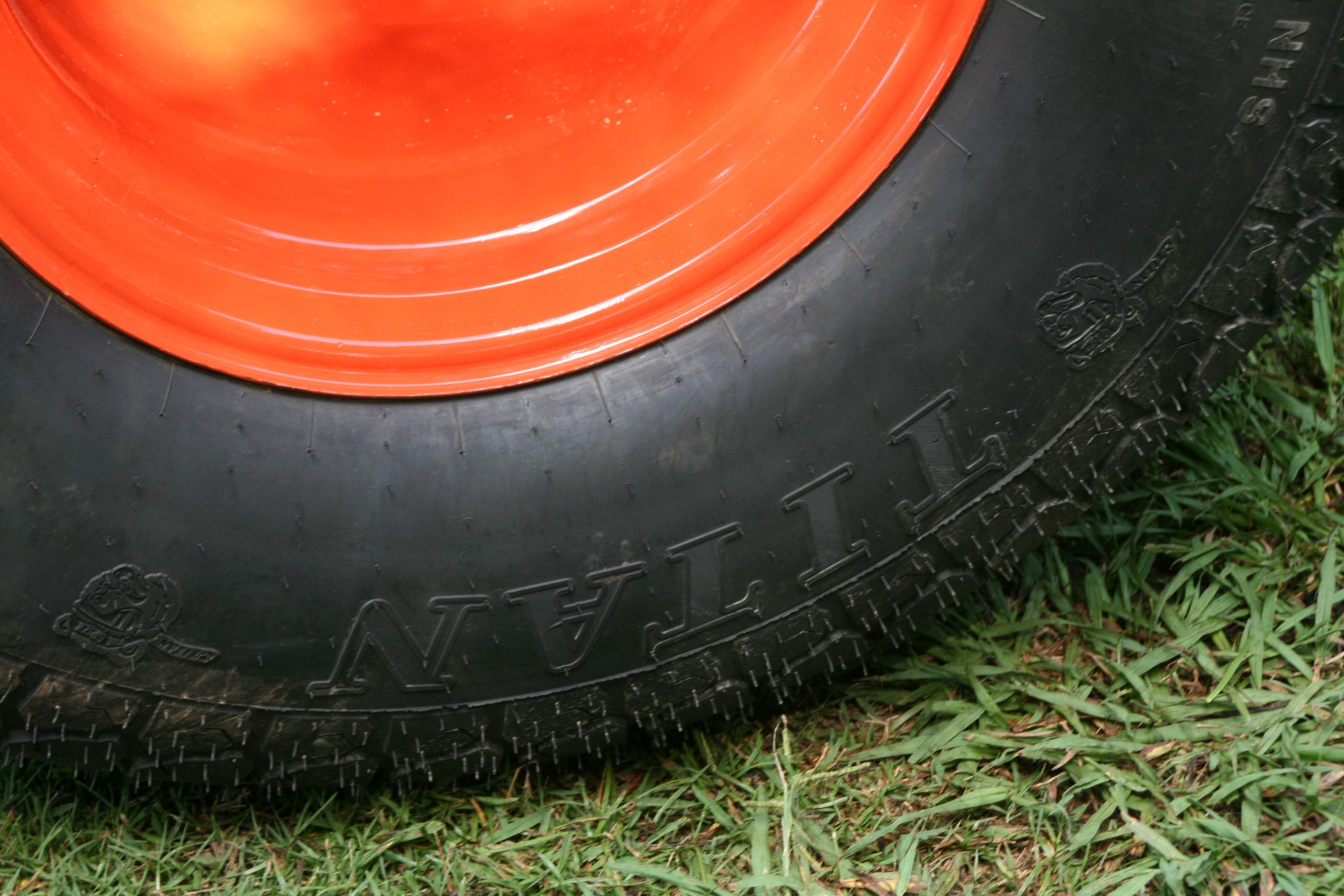

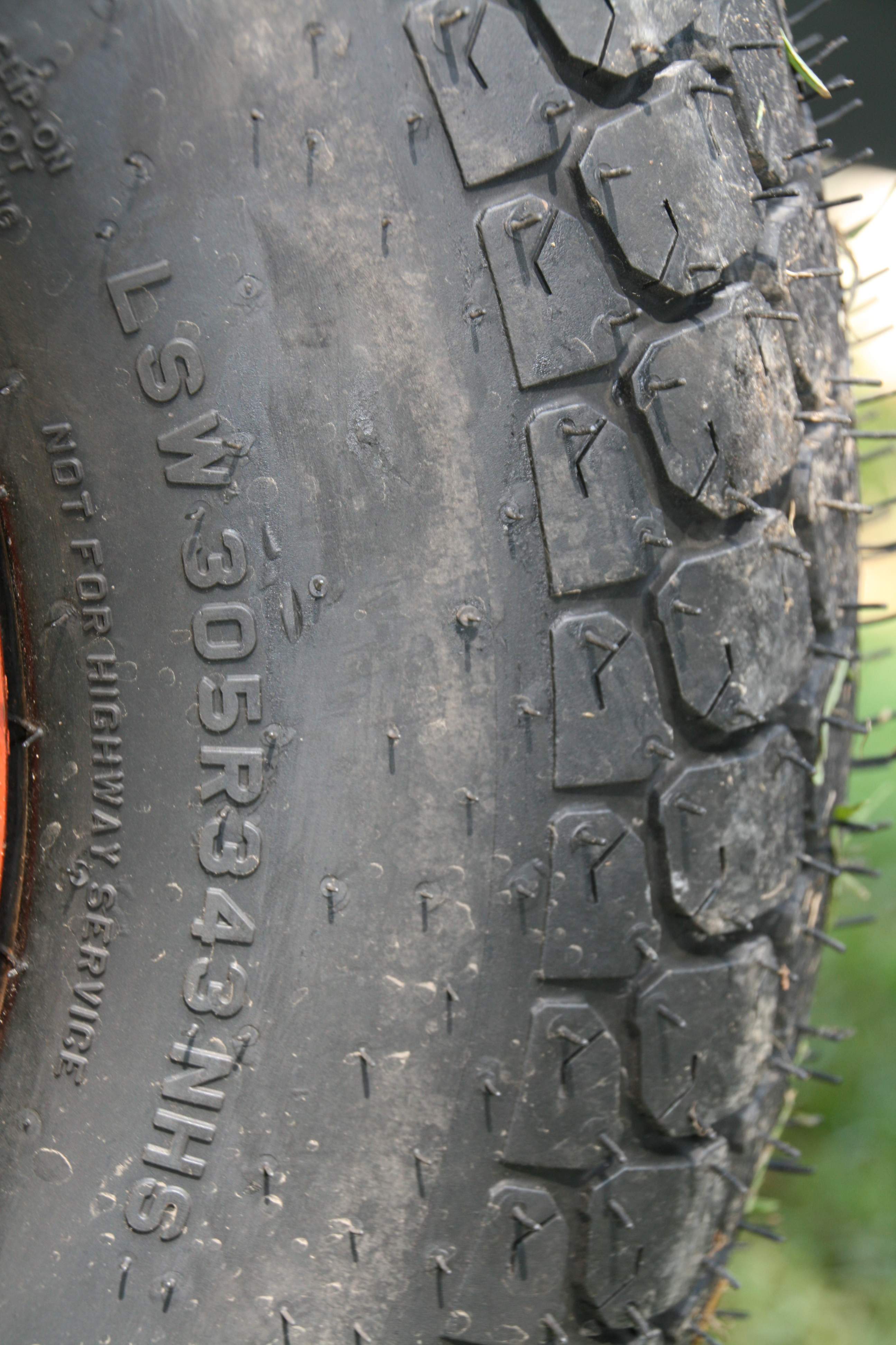

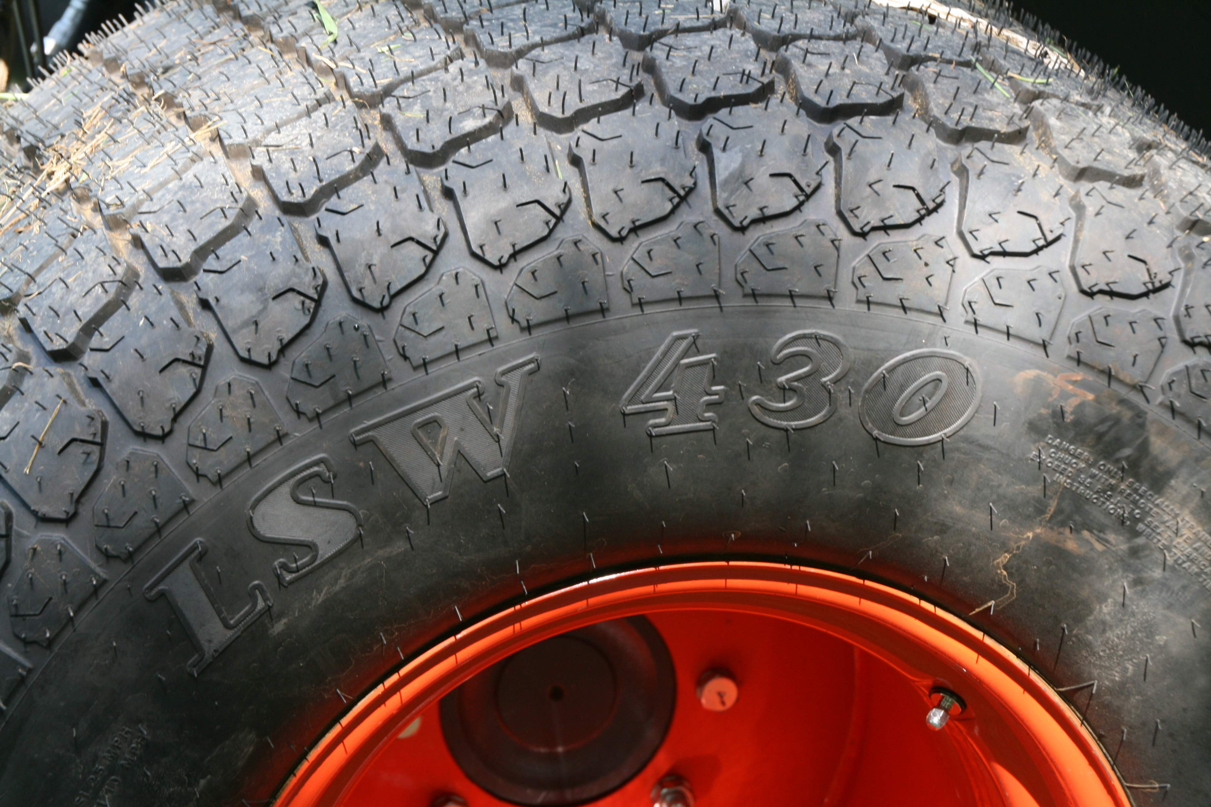

Dealer tells me these tires and rims are straight from Kubota (i.e., they're OEM). I've attached some sidewall photos showing make and size info (meaningless to me), but info appears to match some of what's in Kubota's Grand L40 brochure.
I've cut about 5Ac this weekend with the mounted turfs. Here's what I've found so far. My trenching problem is gone - big plus. Unfortunately, the ride quality of these turfs is worst than the R1's. These tires (turfs) ride the surface of the ground (flotation) and if a harden ridge is there, you will feel it - big time. First couple of passes, I was bouncing hard over the grooves made previously with my R1's. Back to the barn to let out some air. When delivered, front tires were at 30psi and rears were at 40psi. I lowered fronts to 20psi and rears to 25psi. Ride quality improve considerably with far less bounce, but I still feel the hardened ridges. The turfs didn't come loaded like my R1's - wonder if that would make a difference in the ride? Course the added weight might get me back to cutting shallow trenches again - don't want that. Will add, however, ride is smooth as silk on my roads. So will work on getting my pastures smooth again - more work unfortunately.

I'm not following you. The Grand L40 brochure (Pg. 23) pictures 3 different turf tires. They are (1) "Galaxy tire", (2) "LSW turf tire" and (3) "Turf tire". The "Galaxy tire" looks far more rounded than mine and shows little tread pattern. The "LSW turf" tire shows more tread and squared edges. The "Turf tire" looks quite narrow (compared to the others) and resembles (to me) vintage bias-ply tires. From my latest photos, you will see that my tires are by Titan, ID'ed as LSW and have a somewhat squared edge profile with discernible tread pattern like (2) above. I see nothing to suggest that what I have are Galaxy (golf course) tires.

Okay i just went to kubotas site and "built" your tractor. It seems the brochure is either outdated or generic. I do know of those cruddy bias looking 1960's tires you mentioned but we'll forget about those for now. Under turfs, you have two build options. Titan multi trac R3 turfs (what myself and philip8n have) and then the LSW turfs. The multi trac R3 with rear size of 44x18x20 is a taller stiffer and narrower (looks about 25% less than yours) tire. They are 4 ply rear, 6 ply front. It is your standard multi use turf with deeper more agressive tread. Your asws are similar to galaxys in terms that they are a very soft wide golf course/sports field tire designed to minimize turf damage and compaction. Dont get me wrong, both tires bounce more than R4s or1s but i would tend to believe the asw "might" be worse. Hope that cleared things up

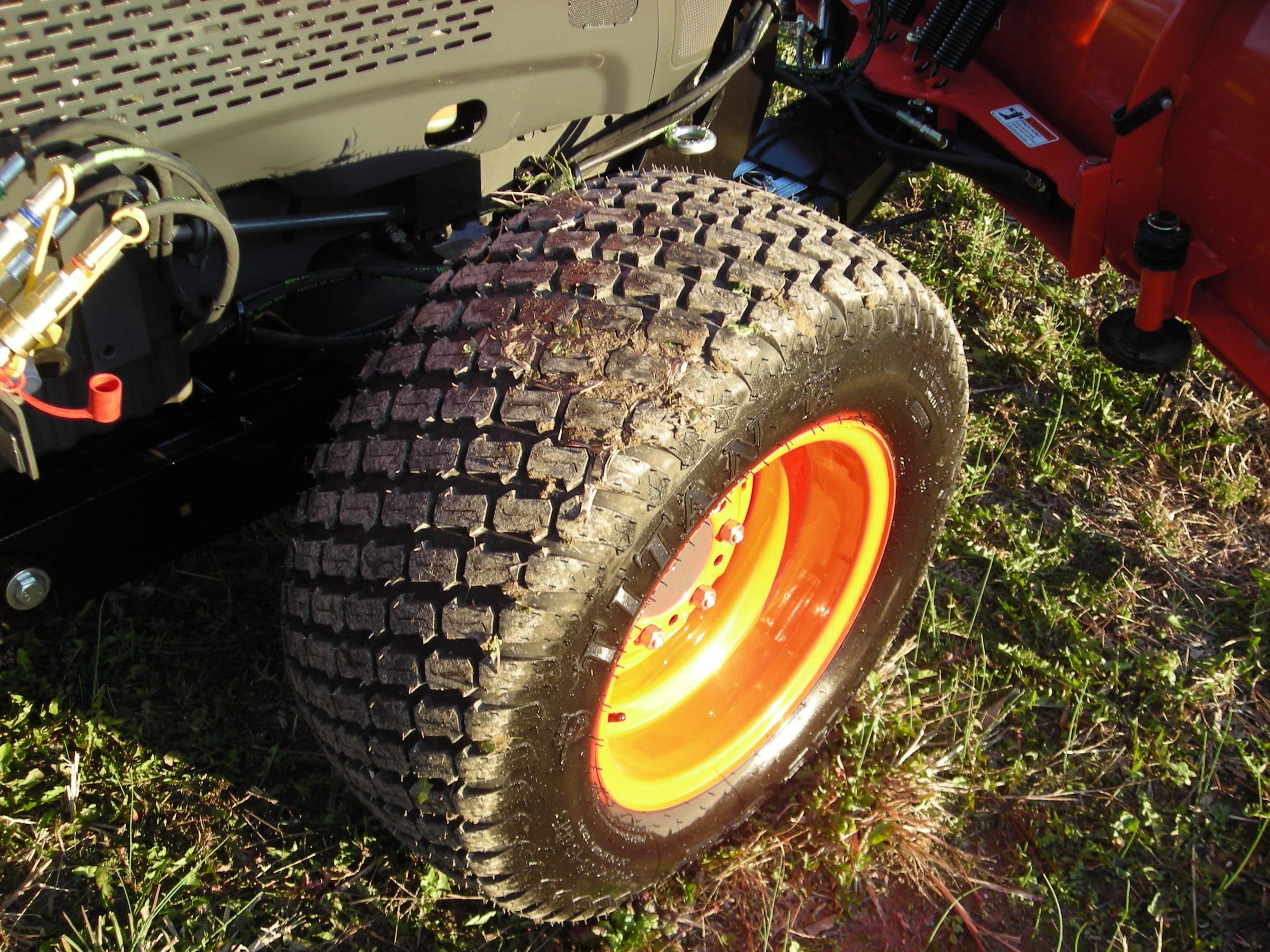

I only run 20 psig in my front and rears, which is what Kubota and Titan recommends. Your front sidewall is not very tall, which I am sure leads to a rough ride. Here are close up's of the Titan Multi-Trac. Philip.
