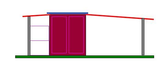

As for making sheds from containers, we use them a lot in construction. we usually start by placing them 30-40 feet apart. Then we install a 2 foot riser on both inside container edges. We then set the prefabbed joist on top of that. We can then use 2x4 to extend the roof line from the prefab joist out past the edge of the 8 foot wide container. The 2 foot riser not only gives us enough slope to carry the roof out beyond the outside edge on each side, but increases the roof height so we get about 11 feet ground clearance with the container up about 1 foot off the ground for ventilation. You could adjust the riser according to the slope needed to reach the edge of your container so if you wanted a higher slope just make the riser higer.

Eddie,
That is an amazing idea. Could also close in one end, and have a nice dry work area.
Would you have pics of that?
A few years ago, I bought two containers and put a roof over them to create a larger area under roof between them. Then I added a storage area to one side and a cabin to the other. For very little money, it came out pretty good.
Here's the link to the barn I built with those two containers. http://www.tractorbynet.com/forums/projects/33401-my-container-barn.html
