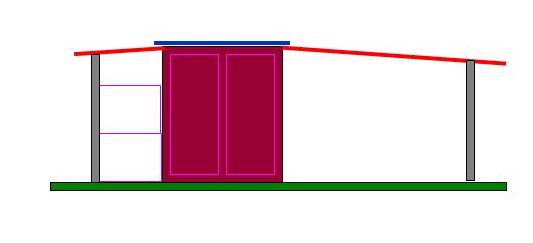

Your roof line has me curious. Why have a flat section? It seems that one continuos slope would mean one piece of metal that you don't have to tie into another piece at a different pitch. If it was me, I'd add some lumber to the far side of the container roof to raise it to the same pitch as the lean to. 1:12 ?
Something else to consider. Even though the container is water tight, or should be depending on the level of abuse it received, allowing water between your metal roof and the container creates a situation down the road for rot to the wood, mold and bugs. Keeping the water out all the time is the only way to gurantee the life of any building and eliminate long term problems.
Eddie
Eddie, I used screws for all Simpson ties and tie-ins to the posts. I also used screws on the the blocks that tie to the container. I only used nails on the flat purlins where I'll attach the metal. I shot three nails into each purlin over the lean-to and two on each one on top of the container.
I'll be putting materials shelves on the back side of the container (see attachment). Those shelves will also have a short roof, 6', and run the length of the container. The flat roof (shown in blue) will actually overlap both sides of the container by 6". There will hardly be any gap between the overhang and the sloped metal, 1/2" maximum.
I'm going to shoot sealing type fasteners in the flat roof, so any leakage should be minimum. At 9' wide, I don't think much water will collect. Even in the heaviest rains, the water will run off before it gets even 1/2" deep.
I failed to mention that this is a temporary structure. I've promised Kathy that I'll tear down the lean-to and move the container after I get my shop built. When I move the container, I'll reinstall the flat roof and give it a 4" pitch by blocking it on one side to allow better water drainage. The roof will stay with the container only to keep the internal heat down. I'll paint the sides white.
If I had run the purlins all the way up and across the container, I'd have to have lumber over 22' long. I hauled all this lumber in my pickup because the longest was 14'. The same will be true for the metal. There's something to be said for being able to haul all your material in a pickup and not even fool with a trailer. I have a trailer, but why bother when I can flag my load and carry it easily?
The nice thing is that most of this will just unscrew and come apart without complete teardown. I can move 10' x 14' sections as a unit or completely disassemble them without too much difficulty. That said, I'd bet this will be just like I build it for at least 3 years. Things have a way of filling up and becoming "needed" space. I may have to alter my roofline slightly if it leaks too much or we decide to make it more permanent.:)
BTW: The cost of wood for this project is $350 and my metal will be about $750 or less. I'll know more later this afternoon. I could get custom metal, but there is a place nearby that sells precut galvalume panels and I've heard they are very reasonable. I may be pleasantly surprised. All the poles, fastener brakets, screws, and nails for my nailgun I've had for years and finally found a use for them.:rolleyes:
Hahahahaha! Who was I tryin' to kid? A neighbor gave me prices on metal from over 3 years ago. Guess what? The price has gone up. The metal for my project was $1400 ($2.90 per ft), about twice what I expected. Oh well. . . . I'm not the only one who has been shocked by steel prices lately.

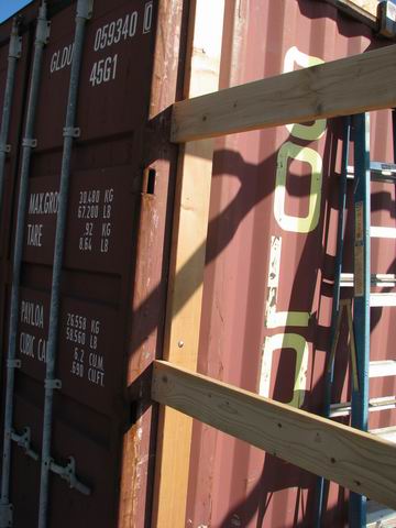

/ New shipping container shop... #32

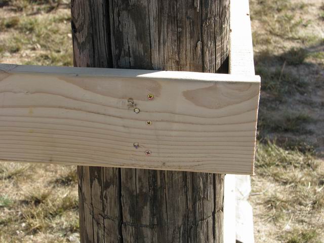

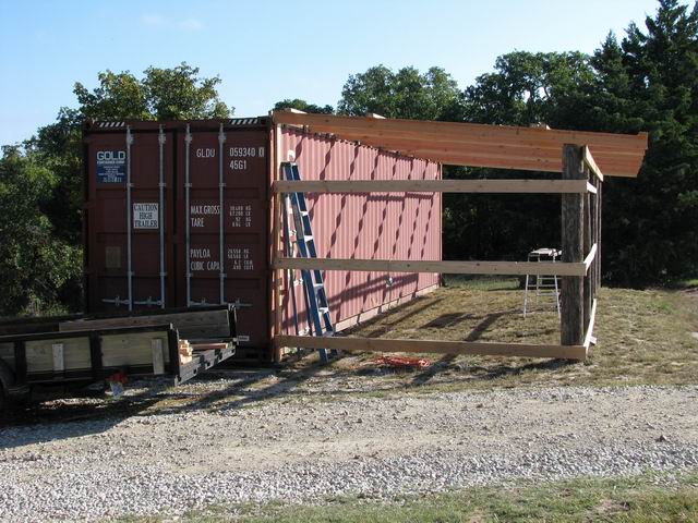

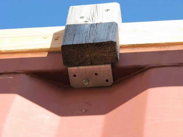

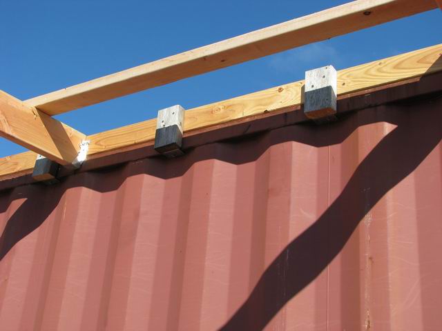

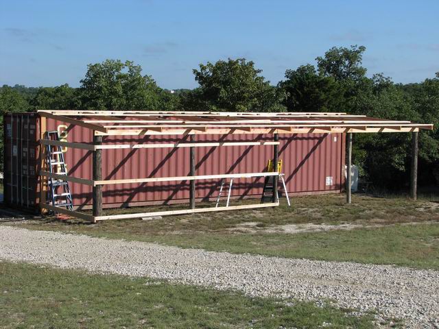

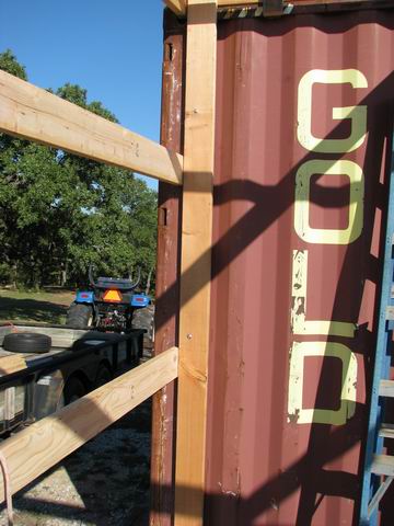

I posted earlier in this thread about a container lean-to I was building. I've just about completed the construciton for now with the constant great help from my wife.:) Here's a link to my first post for pictures and I've attached some pictures to this post to show the finished lean-to. I've got some molding work to do and later I will put a wood crib on the other side of the container. This will have to do for now because we have to clean all our stuff out of our second house before closing on the 10th of November.
Framing the lean-to
In the pictures below, you can see that we put a flat roof on the container. Even if that flat roof leaks a little, it will be okay. There's about a 6" overlap of the sloped metal on the lean-to. If we have a problem with leaks, I'll go back with some caulk under the metal to seal it. Since our weather comes from the west, it will blow against the front of the container and I doubt the roof will leak much if any. However, if we get a little snow, I may see some leaks as it begins to melt. We don't usually get more than one snow each year with any accumulation of over 4", so I'm not really worried.
Oops! I almost forgot to mention that the container used to get so hot you could not stand to be inside it for more than a few minutes at a time. In the hottest part of summer, it was unbearable. Now, it's as cool as can be. The roof and lean-to on the south side really did the trick.
