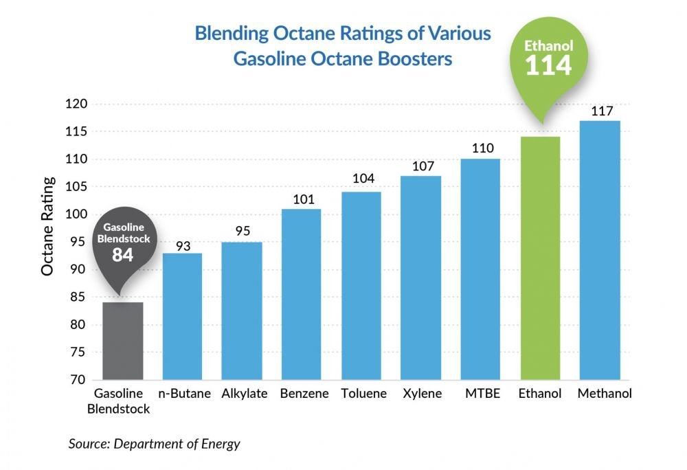

The funny thing is that the "booster" you would be adding to your fuel is likely just very expensive ethanol in a bottle. Ethanol has a very high octane rating, particularly when blended in small quantities to gasoline. It also is an oxygenate so you will have lower tested emissions, and unlike organometallics, it won't destroy your catalytic converter or foul your oxygen sensor. Those are why pretty much all of those little bottles of "gas booster" at the auto parts store are basically ethanol plus just enough methanol or gasoline or something else to let them avoid having to pay the alcoholic beverage tax and requiring a liquor license to sell.
