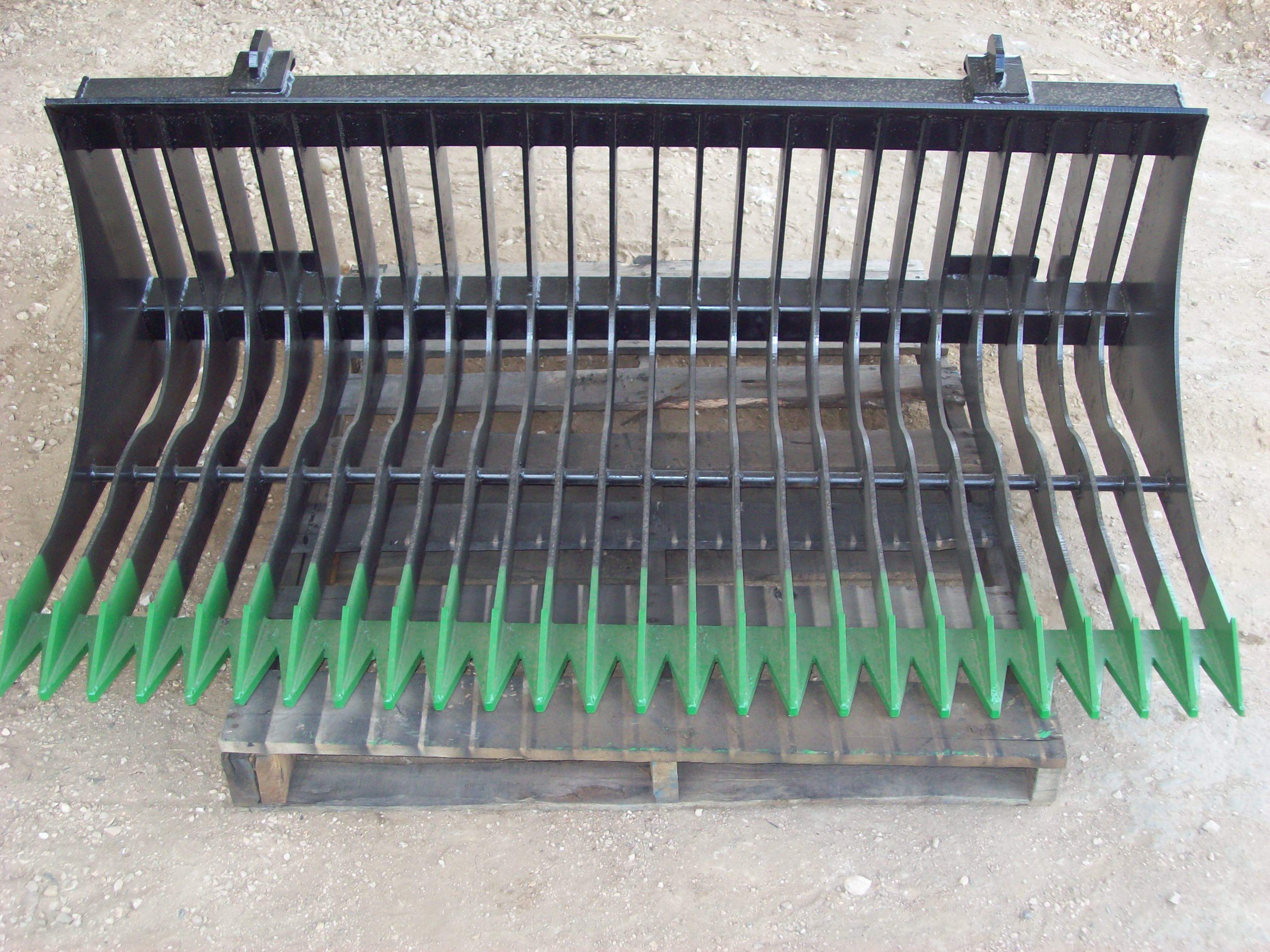

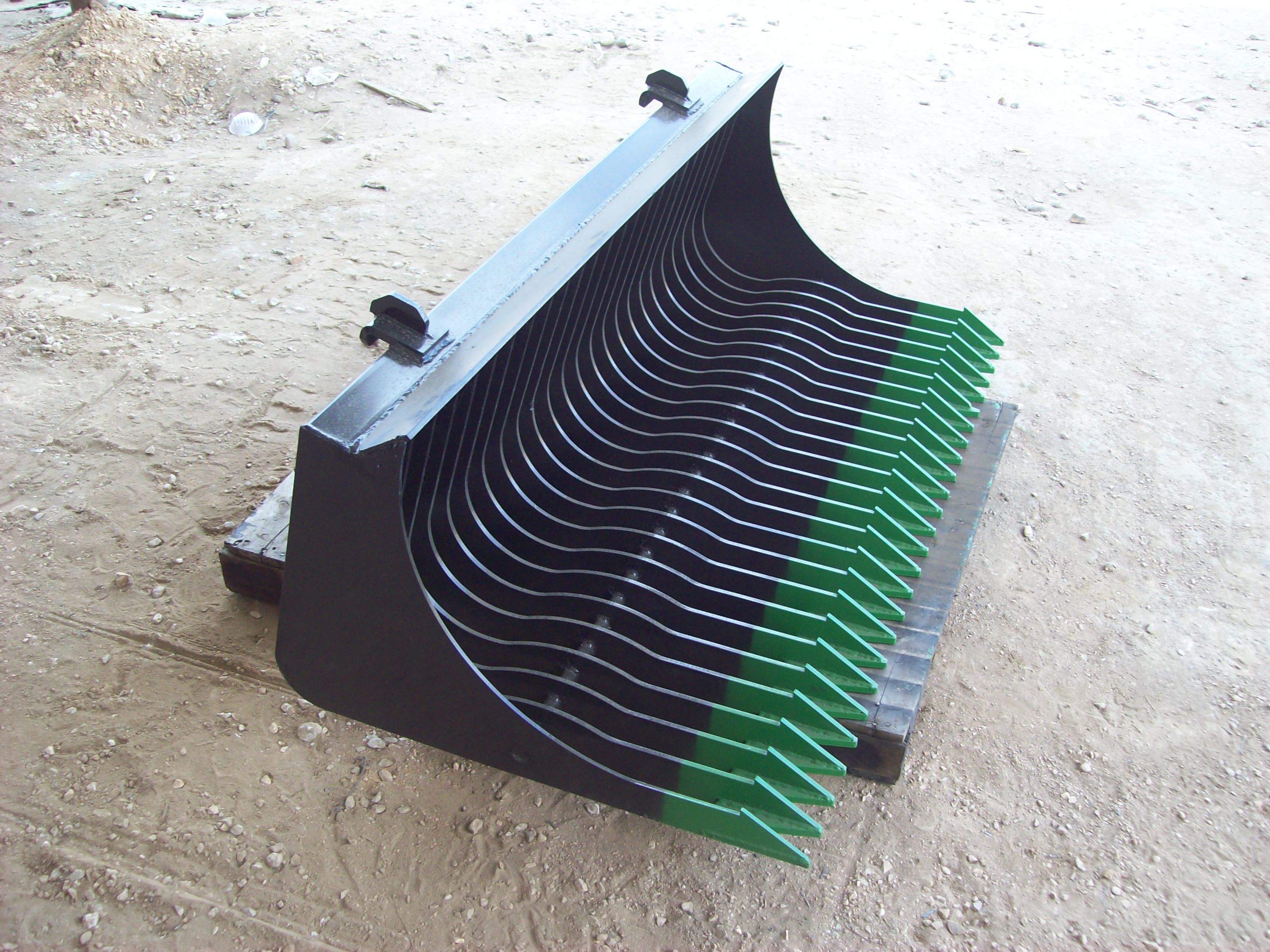

I bought this Armstrong Ag rock bucket to help with clearing prickly pear and of course rocks. I'm hoping the teeth on this bucket will grab the pear and tear them out by the roots. My regular bucket just slides over them. This is their smallest at 60" but a hefty 600 lbs. It's designed to sit flat and slide under the rocks. Anyone else try one of these. Can't wait to try it on the pear which are difficult to deal with.

I think you'll be happy with that rock bucket design for grubbing up prickly pear cactus. I'm not sure how well it will work as a rock bucket because of how close the tines are spaced. If you have very dry loose soil, it will probably be great. Clay or wet soils will be a challenge to get the bucket to shed everything except the rocks. It's always a tradeoff and your bucket looks to be very good for lots of chores. If you put a simple thumb grapple on it, you'll double its usefulness too.

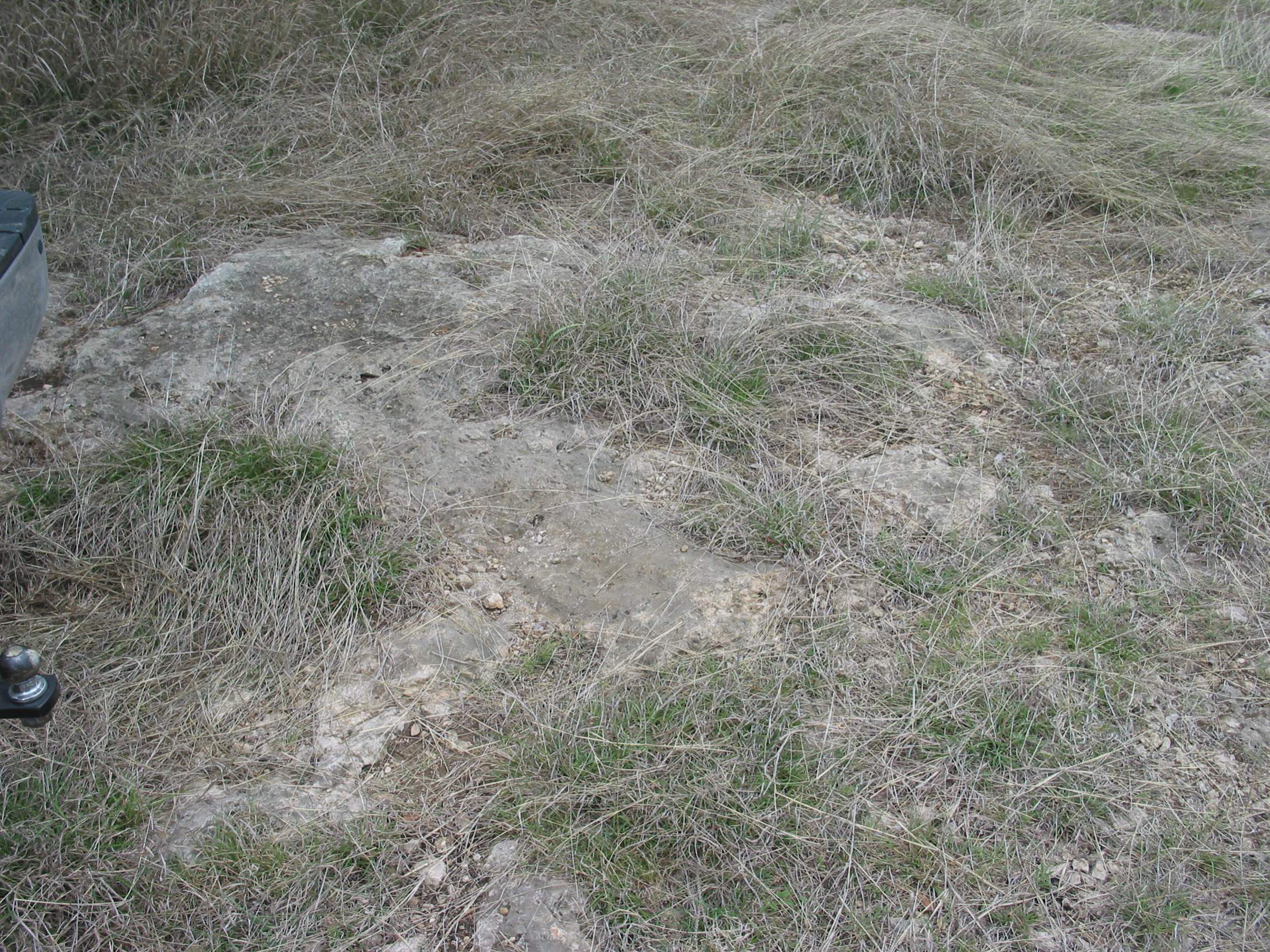

This property is on a bedrock dome. Beneath the 2-3" of soil is solid rock. So this bucket will just slide on top and not penetrate any soil to speak of. As resilient as these native plants are, they are able to grow and prosper, but their root system just penetrates cracks in the rock. I still intend to sharpen the tines a little to get a better grip on the pear. Should work on Holly and some other brushy plants too.

That said. Nice bucket. If that won't do the job for you, then nothing mechanical will.

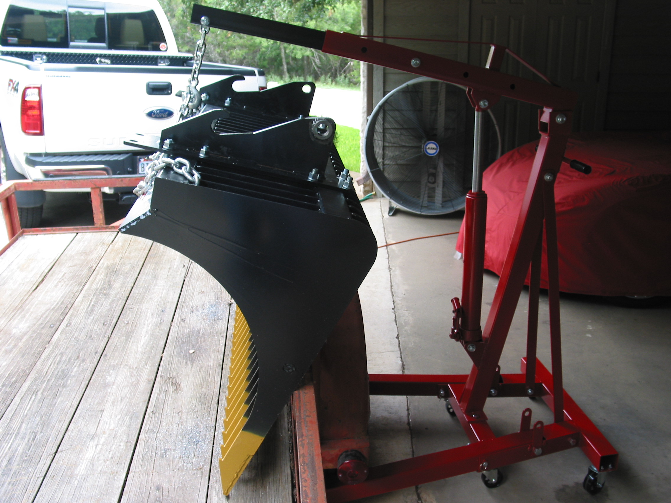

I haven't had a chance to use it. I had to first put these brackets on so it will fit my Branson's quick attach. Branson's QA is good but it's hard to find attachments ready to go. Hopefully I'll get it up to the place this weekend.

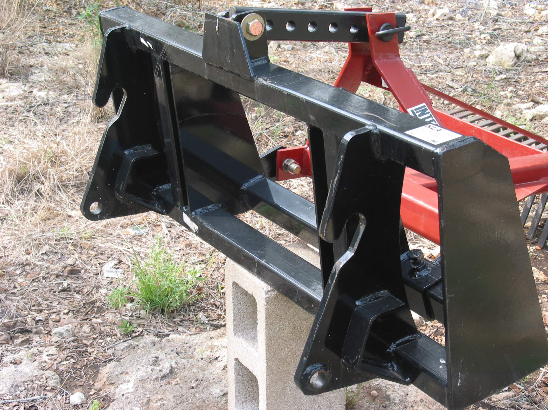

I've been using this attachment to drag out many of the pear. It's a 3pt adaptor for the FEL which has a 6' rake attached. I can reach in under trees and brush, drop the rake over the pear and back out. It tears them out by the roots and I then push them into a pile where I can pick them up with the bucket. It is time consuming but is the best way I've found to get at the hard to reach places.

I took it to the property this weekend and hooked it up. I was concerned about my measurements on the QA brackets but they worked. I dropped it in front of a few pear and put the FEL in "float". Being that heavy, the bucket lies flat and catches the root as low as possible. It works great. I even pushed out some Holly. Now to find some time to use it. These days, by noon it gets too hot to stay on the tractor and bake.
