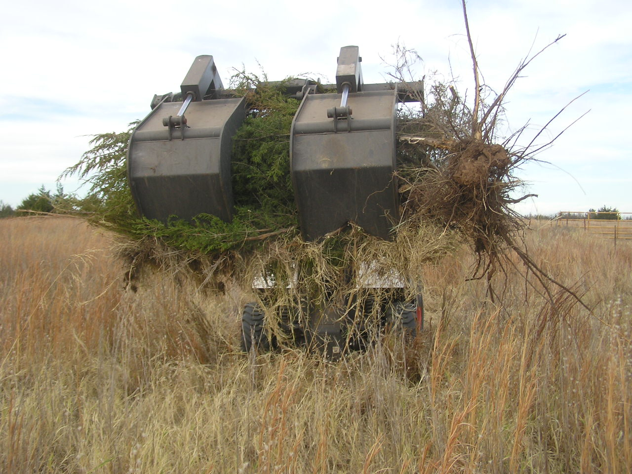

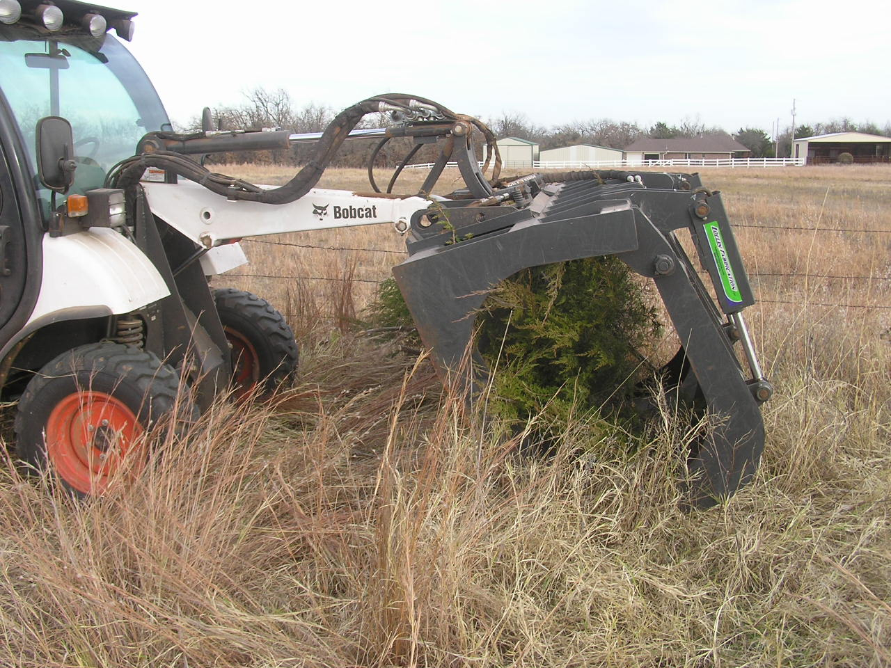

Well as long as we're waiting around for delivery, what are some other attachments I might want?
A grapple:
