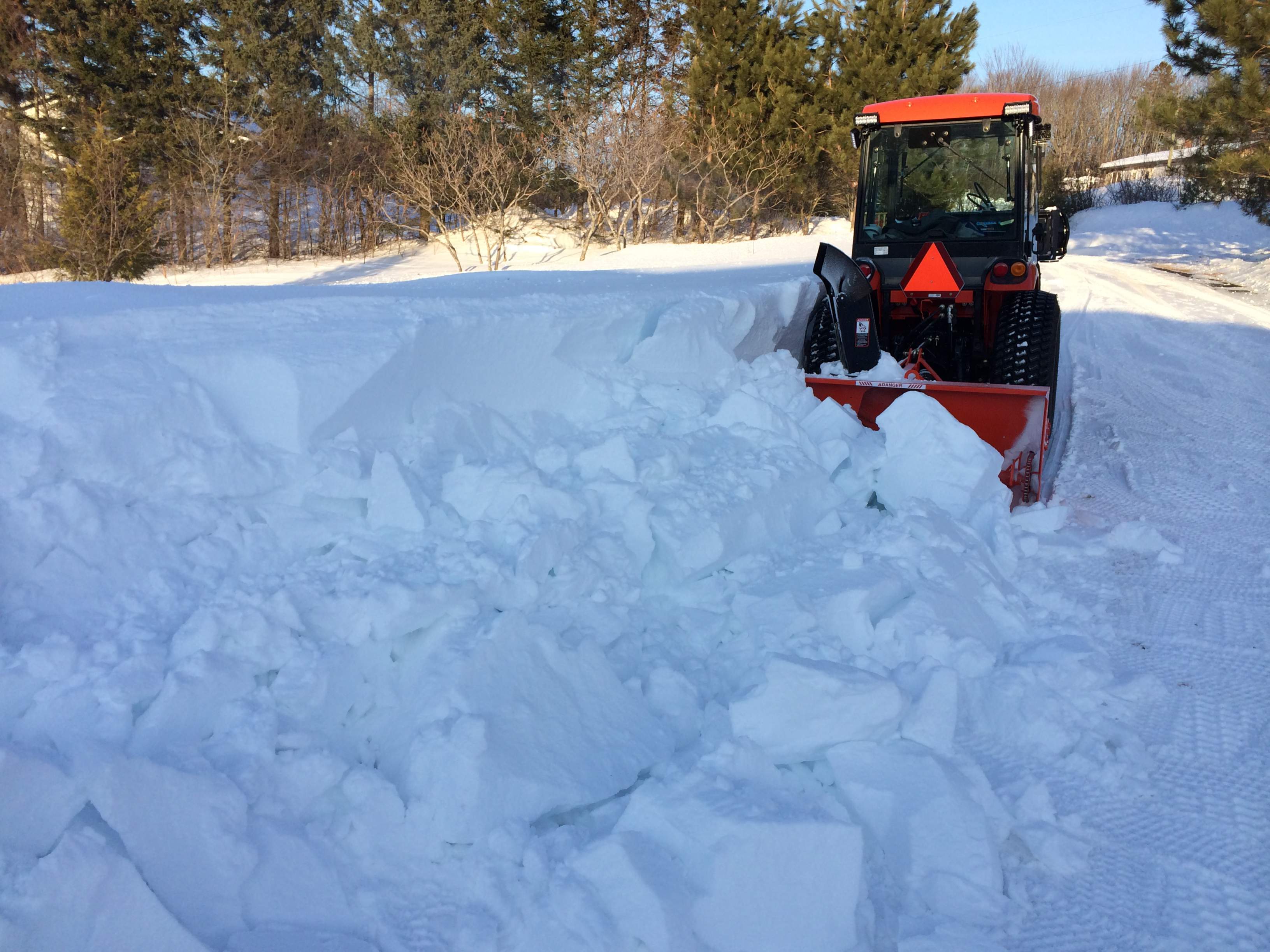

A pull type Blower would be a waste for me, I regularly get 4' - 6' drifts all the time. A pull type Blower would be useless. Even a regular Blower needs help with big drifts. 001.jpg
/ New pull type blower #54
Rear pulls are not for the little machines, you need a good "L" or above with weight.
Having pulled those banks down like you have, there would be no problem for a rear pull and
the proper tractor to drive through that. With a front blade about 1 1/2 feet up, no problem.
My L4200 would have ate that for breakfast. Sadly, it's sold.

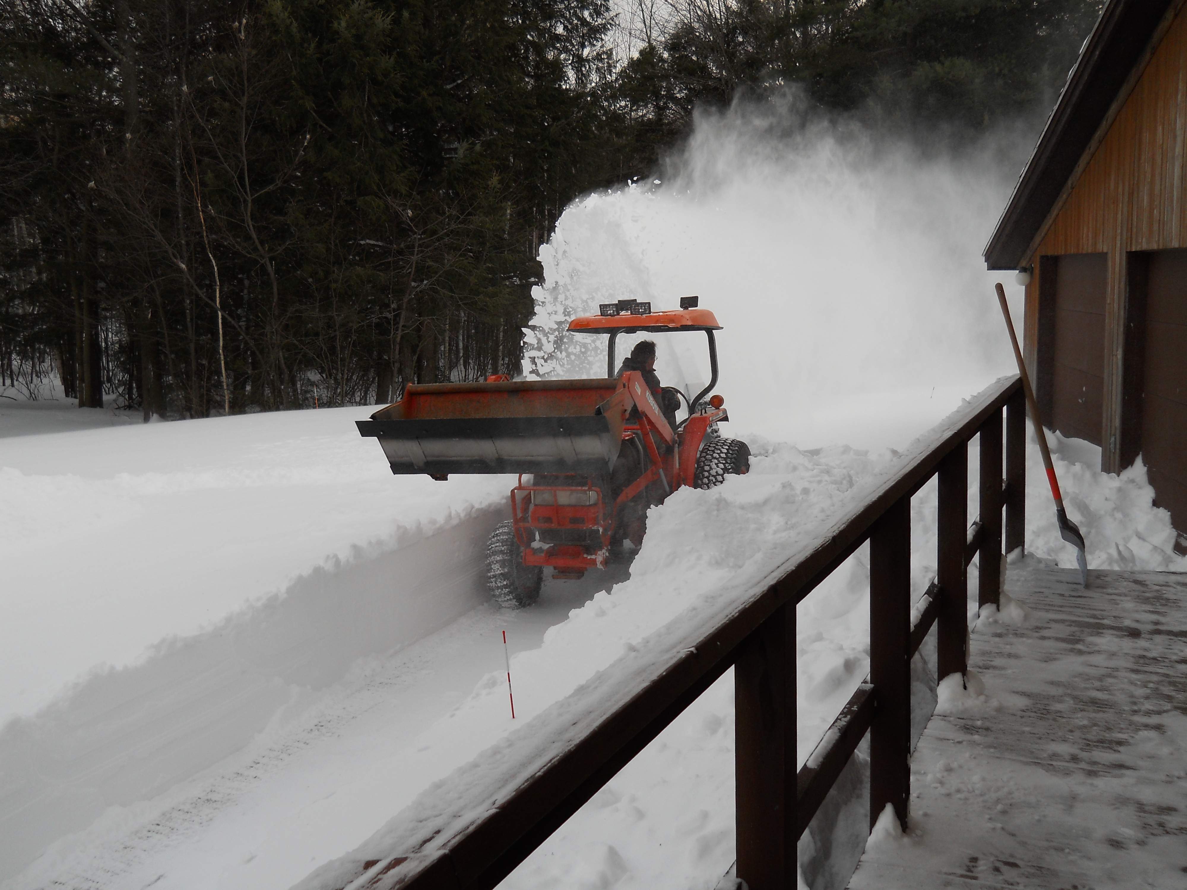

PXPL. Best of both worlds. This guy could have done better by the garage, but meh. Now i just need a big wallet to buy the tractor and the $$ blower
