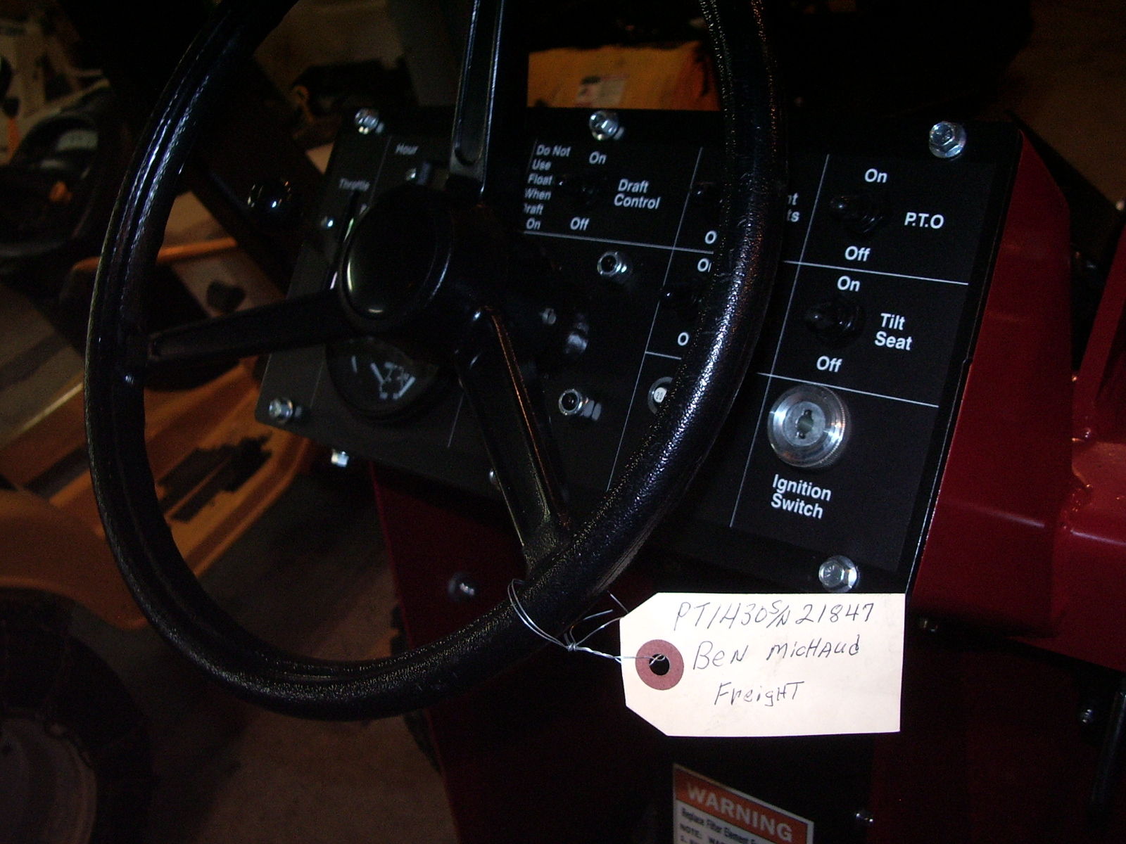

Hey Bill. the serial# on my new 1430 is 21843. Would you mind checking yours and see how it compares to mine? trying to get a handle on how long this tractor has been sitting around in the warehouse. Thanks.

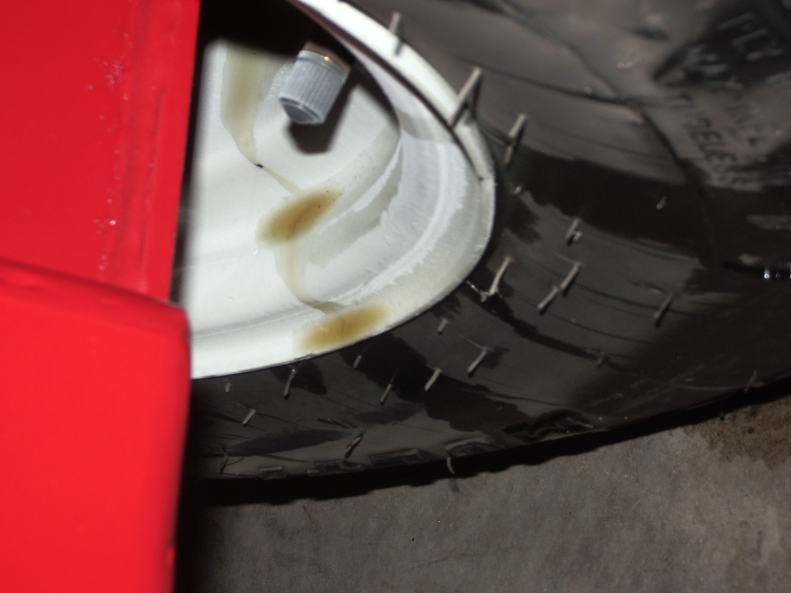

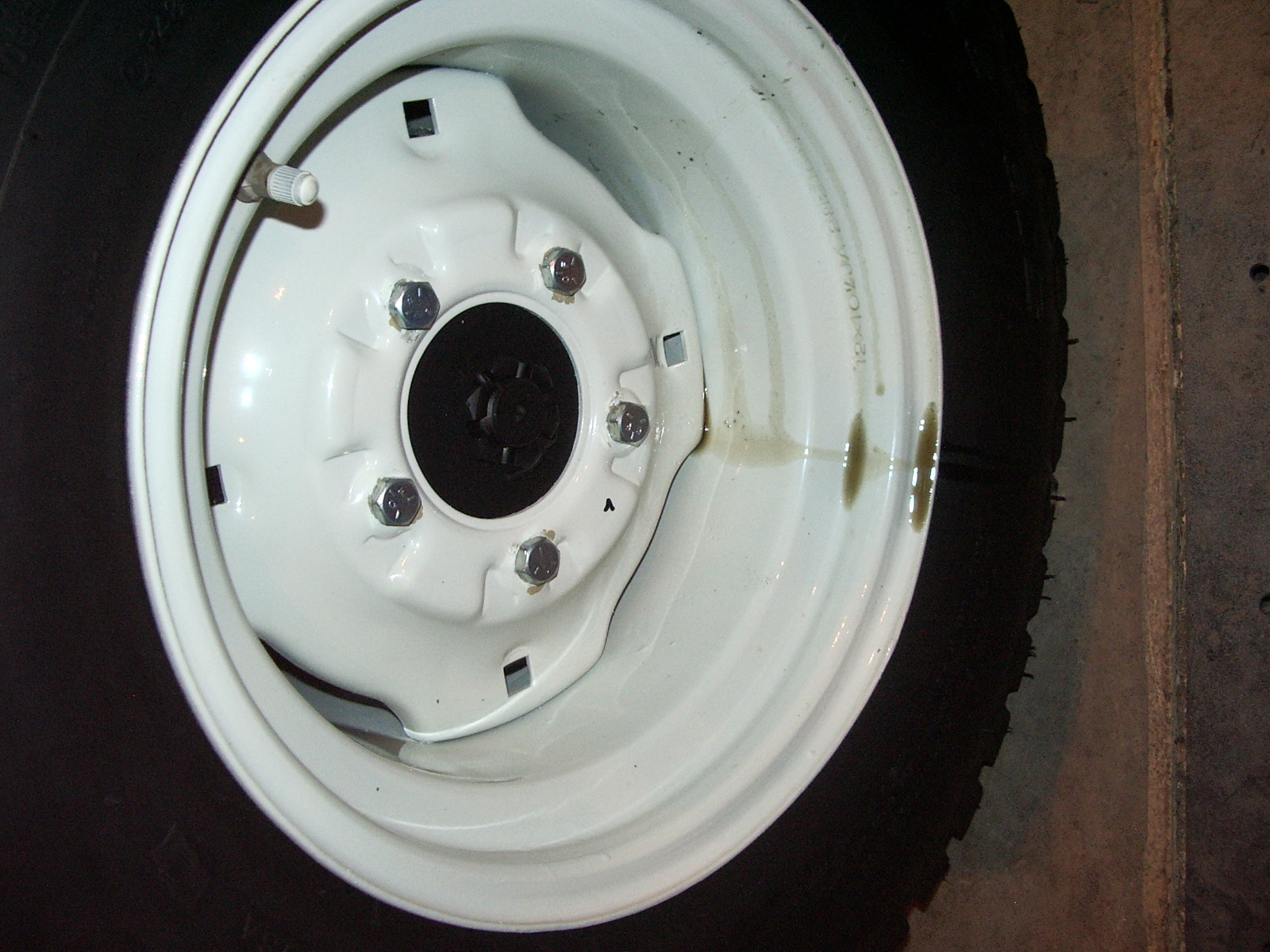

I joined the PT Forum in 2010; today I may have to consider changing my online handle (name) on this forum... :cheerful:
On the downside (as experienced by others with new machines), I soon noticed the first out-of-the-box defect:
The above are both front wheels; it appears to be not-so-clean oil seeping out... :sigh: Looks like I'll have to jack this thing up and perform repair/maintenance before the 1st hour is up... I hope to be able to see where the oil is coming from; hopefully just a hose that needs tightening on the wheel motor.

Welcome! I didn't realize that 1430s came with tilt seats!
It may be too late to mention that you don't want to be using the engine or the wheel motors at full throttle or full pressure for the first ten hours.... Given the current temps in your locale, perhaps a little longer...
My guess is that you have some axial leakage out of the wheel motor(s). With luck, the seals will bed down as you use it more. Could I also suggest that you double check the oil level in the tank?
Can I point out that you can use the front end loader to lift the front end, so that you can get jacks under it? :) You probably also want to get the the FEL on supports for more working room, but make sure that they are strong enough. You don't want it coming down while you are working on the wheel motors.

Thanks Ponytug, advice appreciated; all things I had thought of trying today. (I'm off this week.)
I hadn't thought that the wheel motor seals would need to 'seat' themselves, but a good thought. I may pull the front wheels anyway to try to confirm the origin of the leak. (Will definitely check the tank level as well.)
The oil seeping out might be clean; it might just looks dirty because the rim surface might be dusty...

My left front is leaking also. And that's just sitting idling. I think these tractors have been sitting in the warehouse for some time and seals and such could have dried out. Don't think it's a hose because they are in back of motor.

According to Char-Lynn, motors need about 10 hours at half pressure to 'seat' the seals. YMMV. It would seem reasonable that the process might take a little longer out in the cold of winter, but what do I know?

Good to know (even if we do not have Char-Lynn motors?)...
Mine are leaking enough with the engine shutoff that I suspect worse when under pressure and moving... I'll probably pull the wheels anyway to satisfy my curiosity, and then put them back on to see how bad the leakage is under operation.
Peter
Yeah... Noticed that too. I'll be posting a few questions later in a separate thread about some discrepancies on the instrument cluster...

The 1430 uses the same instrument panel as the tsm class. the seat tilt switch is not connected to anything so you have a spare switch to use for something else. By the way, you might want to check that the hydraulic radiator is mounted securely to the hood. mine fell off and landed on top of the engine.

Didn't get around to taking the wheels off; heard back from PT/Terry to use it as it was meant and call back if the leakage is still there after 10hrs. on the clock. So, that's what I'll do.
I pulled the console covers to see if my Seat Tilt switch is connected. Mine has two yellow wires on one post, and an orange with black tracer on the other post. I haven't tried to see if the switch does anything yet, but I'm wondering if it's not pre-wired for an accessory (left-most position of the key).
