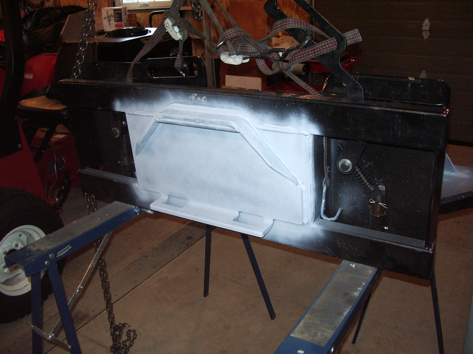

Got my skidsteer adapter plate mated to PT female/receiver plate, and beefed up the tow adapter as well... (Local welding shop.) Easier to see with primer, before black paint...
/ New PT1430 arrived. #71
Nice. However, and I don't want to be a Debbie Downer here, I hope your skid steer attachments are at a good angle for you to get the best use out of them. You'll notice that most Power Trac attachments have some sort of angle compared to the angle of the quick attach plate. Hopefully your dump/curl circuit will give you enough play to get the angles you want. :thumbsup:
/ New PT1430 arrived. #72
So, this may not work for you. My concern is that I have a similar setup (so does ken) and we found out that the plate cannot be welded to the QA plate directly, it needs to have the bottom kicked out by a couple of inches (At a bit of an angle). The PT QA plate is not straight up and down but angled forward a bit.
Just be careful on your first attachment with the QA, the angle down might be too much.

/ New PT1430 arrived. #77

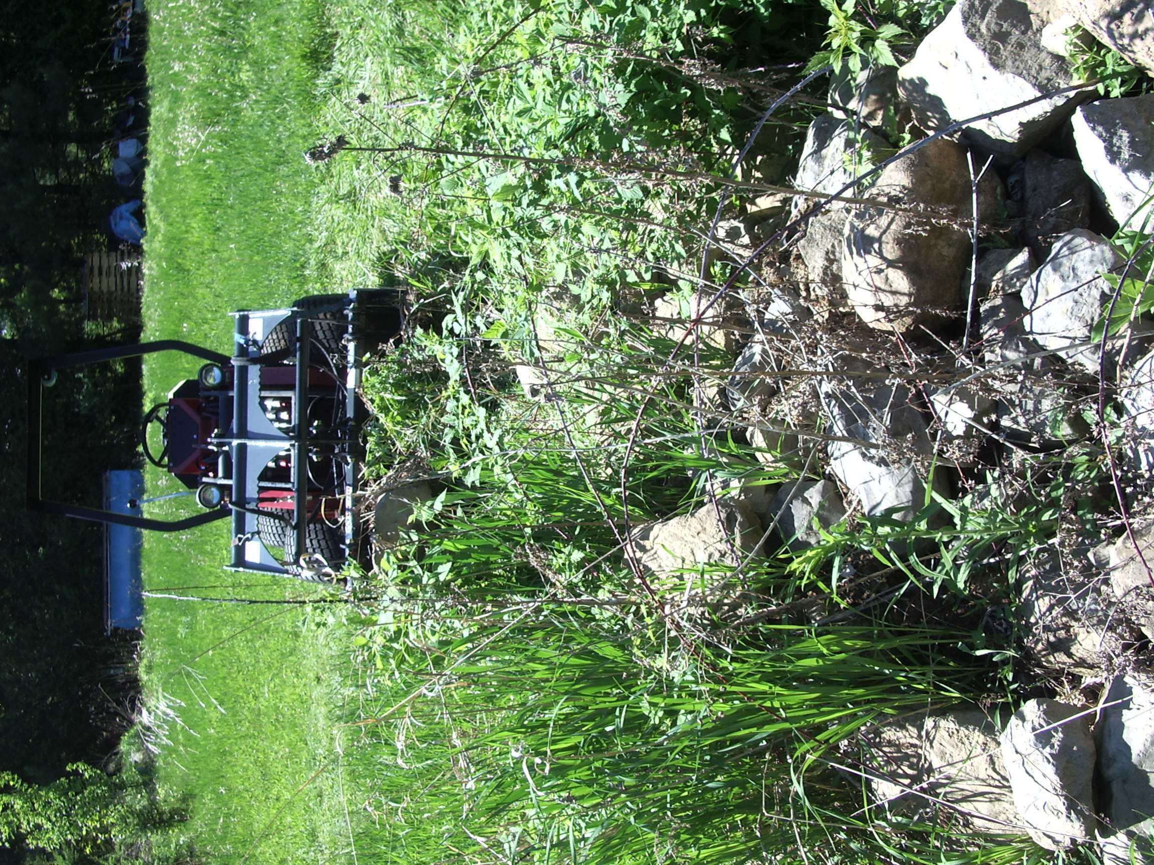

Hi, I'm back into the land of the living after a self-imposed exile with a very nasty winter cold/flu... Not over it yet, but definitely on my way. Spring is in the air, but my body sure did not feel it yet!
I should've paid more attention to the angle between the PT and SS plates. I didn't, but seem to be fortunate that it seems to be working out alright. (Phew!) I moved a pallet off the ground with relative ease, and as you can see in the attached pic, I don't think I'll have (angle) issues trying to dig holes. Time will tell... I do think it would have been a good idea to kick out the bottom of the SS plate 1-2 inches to provide more flexibility/range of motion.
/ New PT1430 arrived. #78
Yes, normally you need to kick the bottom out. You can put the PT plate flat on the ground which is more than many CUTs but not as much past vertical as most CUTs.
