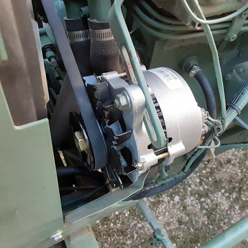

More on my project , still waiting on water pump to come back. The connector to the altenator is sun damage as far as falling off , so I'm looking for a replacement connector. The connector is 4 wire and that back of altenator looks like this
I just changed the alternator this weekend. The OE original lasted 41 years.
Guess what brand fits.
I have Mitsubishi on my Yanmar now. :)

How do you change from 4 wire to 2 wire ? which 2 do you use and what do you do with the other 2 ? What about using a 1 wire ?
   / new project #33
My machine uses the 4 wire setup. 2 wires on the female Delphi connector spade terminals and then 2 eyelet wires that are tightened down.
Mitsubishi makes more than just one type of alternator. You'll need to find what type works for your machine. ;)

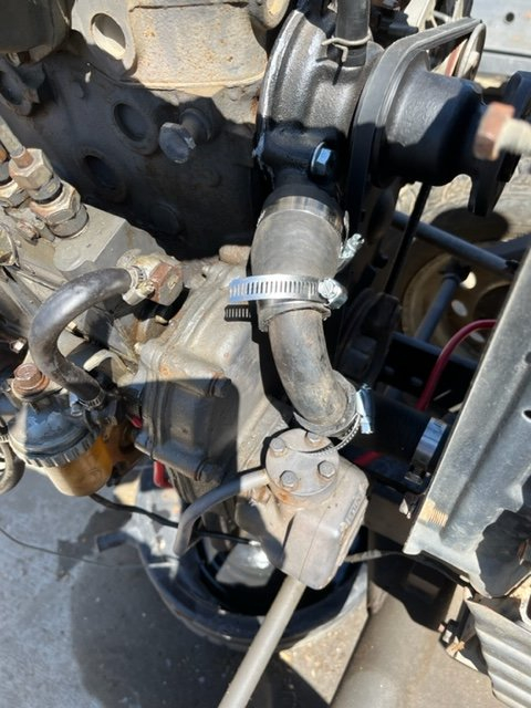

Thanks , I'm still looking for a lower radiator hose and can't find one. I just got the parts book and it calls for a number 68401-00300. I tried on line search and no luck , any ideas ???
   / new project
#35
Got the radiator hose fixed just did a splice of 2 hoses and some tubing. The tractor runs now and does not over heat temp at 176 . Also just taped the wire and plugged into the alt and charging battery at 13+ vdc

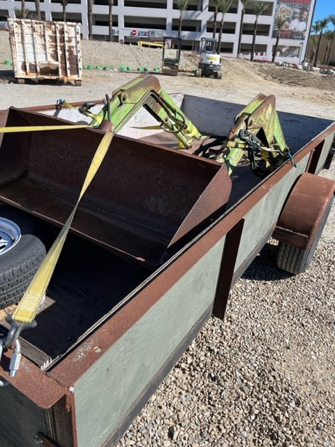

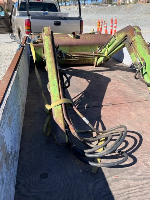

I now have the FEL it is a JD. think it maybe a model 70 the bucket is 53 inches. Now I need to make the mounts and get some parts. I need a 2 spool control valve , I have found a 11gpm on e bay is that a good one to use ? I need the parts to tap into the hydraulic system , is there an adapter that mounts to the pump ?

I have found the control for the loader , I need to know how and where to splice the hyd line to connect to the loader valve.

here is a page from the manual I have , is at the top wher I spice into the hyd pressure line
   / new project #40
I usually cut the pressure line & braze pipe fittings on the cut ends, Bell adapters work good. You can drill the line side to the size you need. Run the pump side to the IN on the valve & the OUT to the other cut line.
