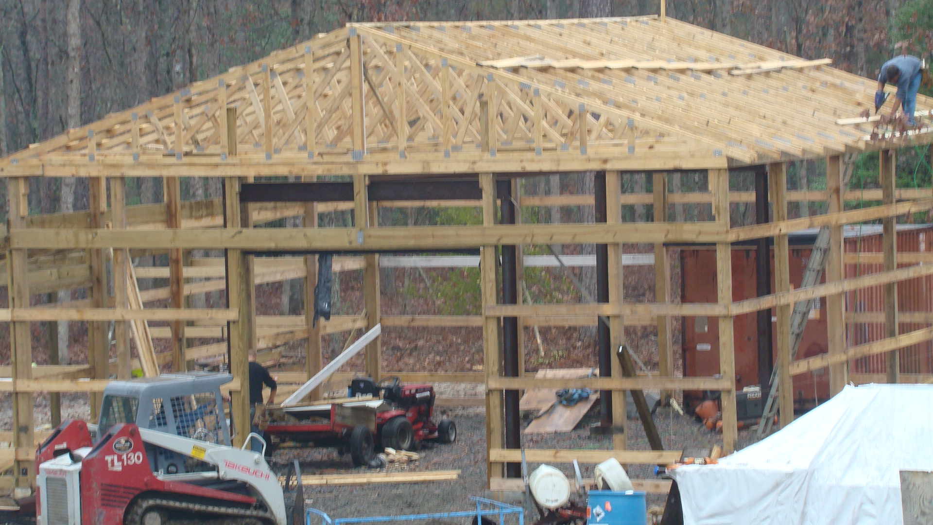

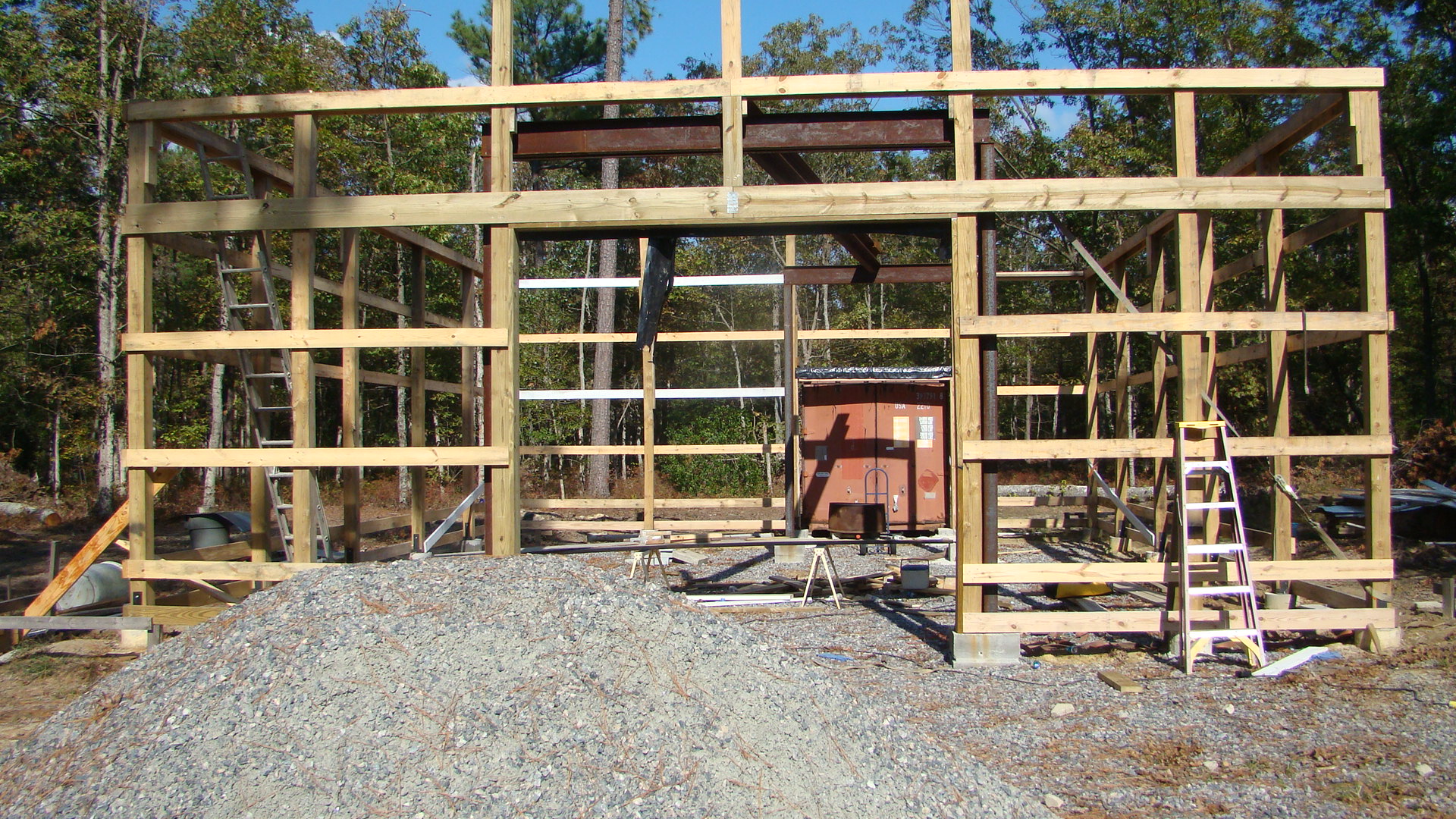

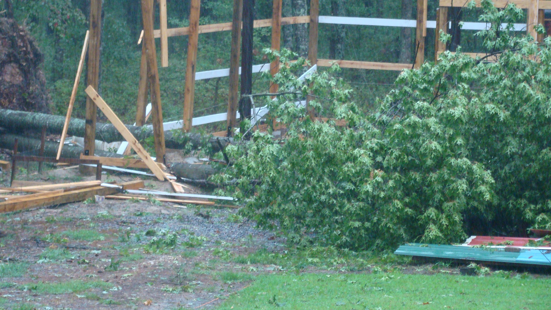

Well I'm finally back to square one. Or back to where I was the day after the storm. I didn't think there was as much damage as there was but I had to rebuild over half the barn. I had to tear out the whole front wall, most all of the left and part of the right wall too because it was bent and twisted so badly. I also went ahead and put 2x6's in between the double top wall headers and this helped stiffen and straighten up all the walls in the process.
I was going to build my own truss system but I have gotten so far behind I bought them already made and they should be here in about 2 weeks. I was planning on this to be a 6 month project but with all my delays and problems I had with the steel beam I installed and now the storm I'll be lucky to have it done by spring. I'm not really rushed for time but I'm at the point I'm getting fed up with problems and just want it done.

MX, that's coming along great...I like the trolly lift I beam...nice touch!

well looks like came a long nice bet your glad you weren't farther ahead when it fell..
mark
Yeah, it's a good thing it came when it did because I was going to start putting truss on it on Monday. I had everything all lined up and even had some help to build and place them on the roof. It was harder to get everything to line up the second time around and probably would have been faster to just tear it all down and start all over, Everything was all twisted because I guess the wood got wet and then as it lay there it took on a whole new look. But with my ratchet pull straps and a little cussing I managed to pull everything back in to some kind of order. Another problem was the lumber had dried out on the building and it was smaller than the stuff I was putting up some of the new stuff was a full 1/8" thicker or wider than the wood that was already up. It looked kind of funny :eek: when I nailed the two together and hopefully it too will dry out and even out.
Thanks! That beam cost me a lot of problems and time to put up and I hope it will stay up there long enough to get some current down there so I can weld it in place. Right now it's just sitting there with a few bolts holding it together on the ends of each beam. The uprights are bolted to the footings but it is still kind of shaky if you push on it hard. The bolts must be doing a little because that tree hit one of the corners and slid down it when it came down through the whole mess.
The building is mainly for me to work out of I want to do light fabrication and powder coating in there if I ever get it done. The beam is so I can load and unload stuff at the big door and one of my ovens doesn't have a door, you have to lift the top up off the burner table. It's kind of hard to explain but I came up with this idea a couple years ago when I was building another oven and having problems with the doors opening and closing and leaking out all my heat. When I'm done I'll post up some pics of the whole thing in operation so you can get a better feel for how it all works.

Messing around with all those trees has not left me with much time to work on the barn but I have got the truss up and the perlins nailed on. The medal should go on the next day we get that it is not raining. I also finished framing my lean to shed off the side of the barn and that too is ready for roof medal. Maybe I'll have siding on it by Christmas if my money holds out and a concrete floor by spring.

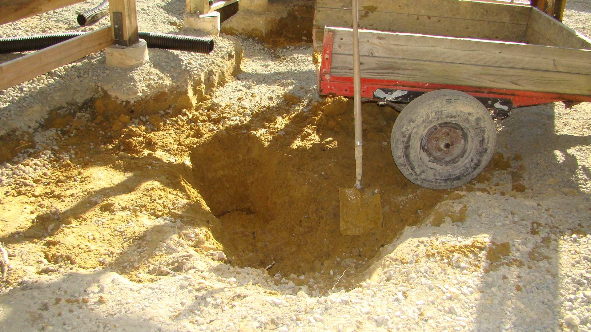

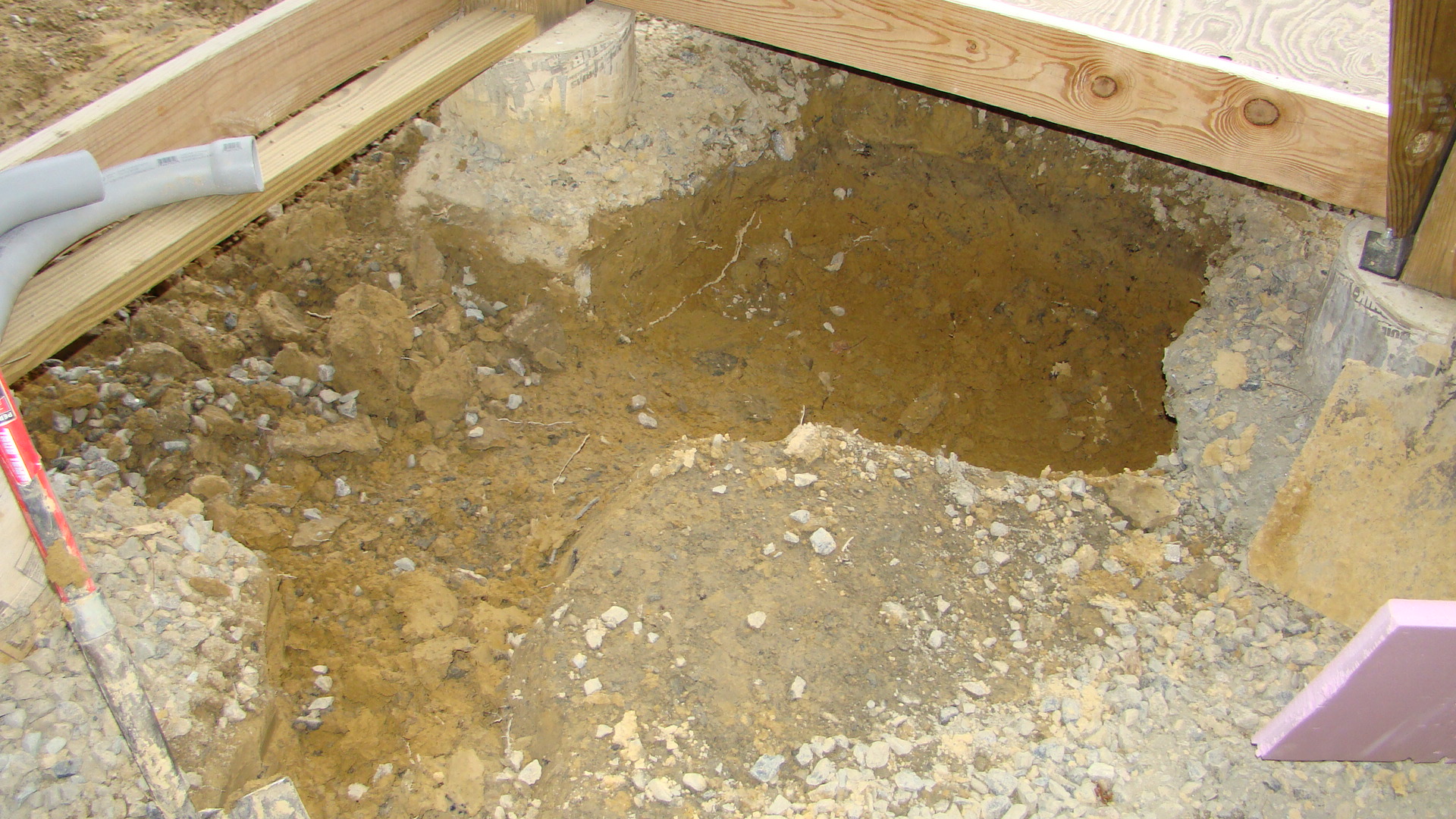

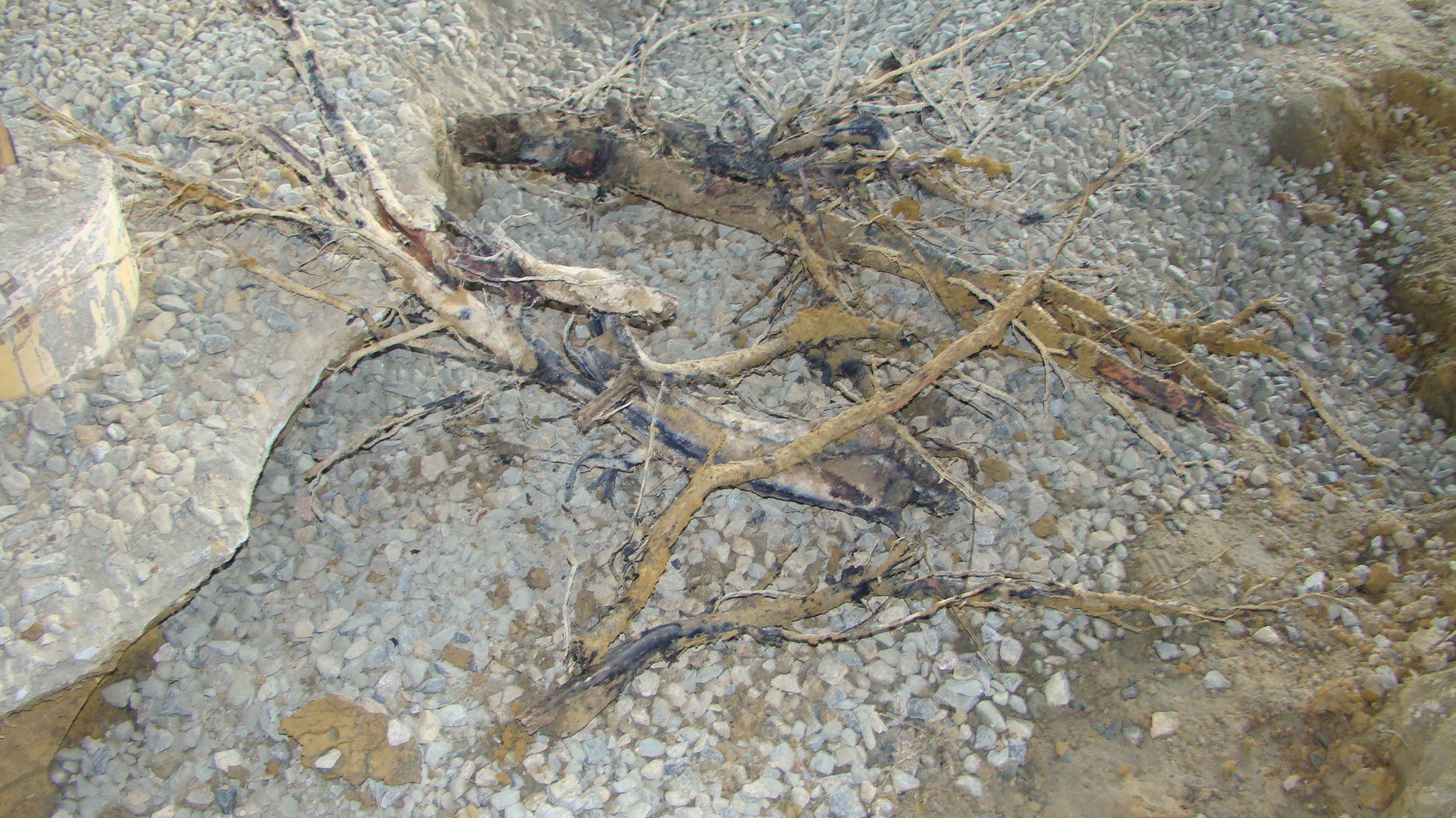

I also decided to rough in an area for a possible bathroom if I ever decide I want one. I did run into a major setback when I started to dig out for the conduits and plumbing pipes. When I cleared the trees out of the building site you may remember I used my old truck to pull the trees over. I managed to get them all out but in doing so I must have broke off a lot of large roots and some of the holes got filled in with topsoil that I missed when I borrowed my friends tractor to strip the pad. One side of the pad was high and I cut the dirt out of that side and used it as fill on the other side. I cut down almost 11/2 feet and the dirt looked good and there were no soft spots.
When I dug my piers I did run into several places where there were a lot of roots but just figured they were just isolated cases and put the piers in. Once the building was up and I had been working in it for almost a year the floor was so hard you couldn't drive a steel spike into it. Then as I was diging trenches in the dirt and gravel once I got down about 4 or 5 inches it was soft and after digging in an area I could go back in an hour or so and there would be wet spots starting to form and in some places there was water seeping up and actually puddling in spots. This has been one of the wettest periods in history around here and I guess the ground water is so high that the old stump holes that had been covered up filled up and was holding water.
I started to dig around in a couple of these places and the more I dug the worst it got. What started out to be a small wet spot on one end of the building ended up being a major excavation effort and before it was over I had shoveled and area 15' on either side of the whole right hand pier line the whole 40' length of the building. In some places I had to dig down 4' or 5' to get to good solid soil. When I was done it looked like one of those archeological digs you see on the history channel. I took almost two tandum loads of gravel to back fill the area that I had dug out with my trusty little shovel. This ***** ordeal took me almost 3 weeks to dig out and fill back in. Then I found one or two other spots that I thought were going to be the same way but ended up not being as bad and only took me three days to dig them out and fill them back in with gravel.

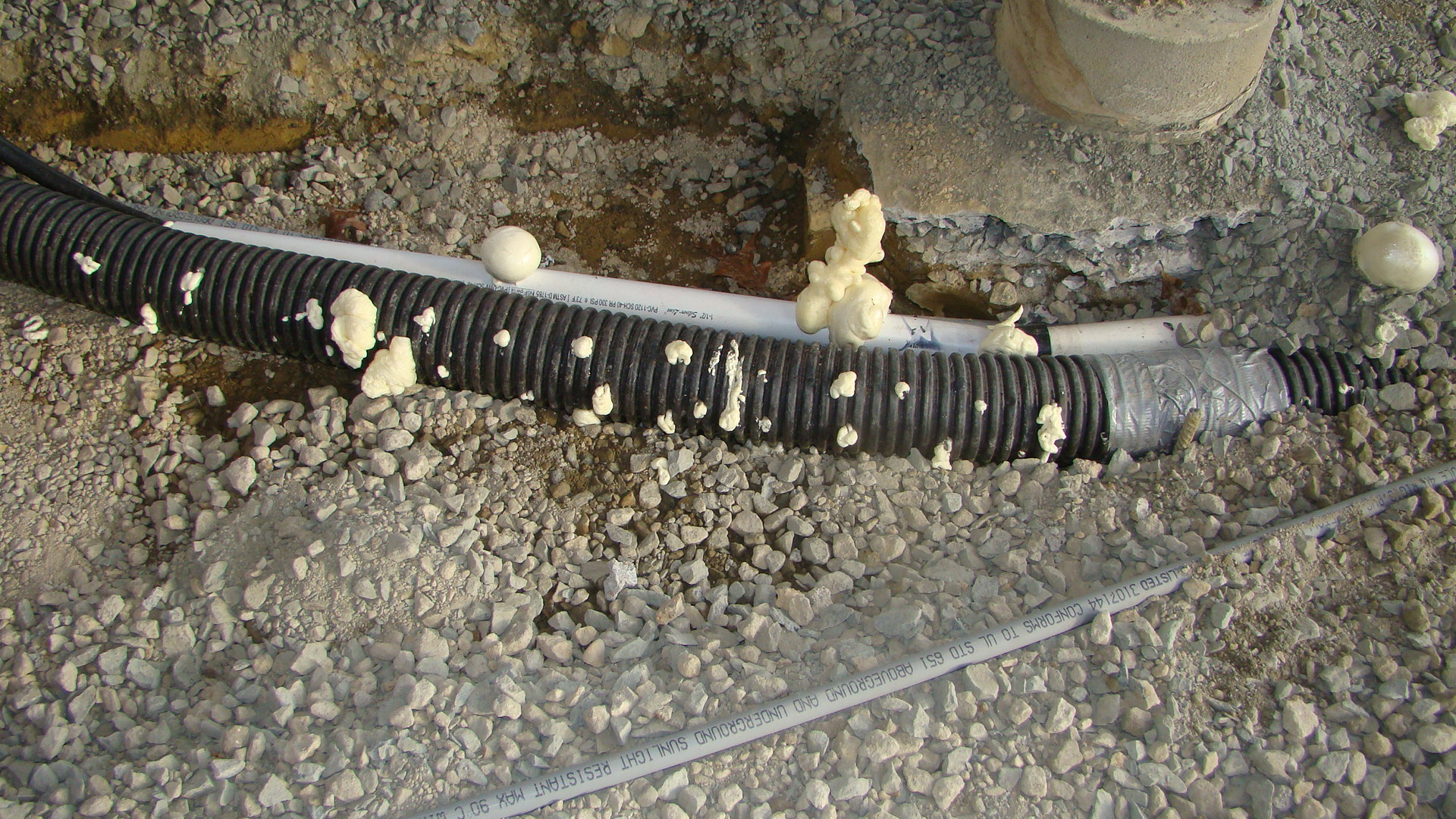

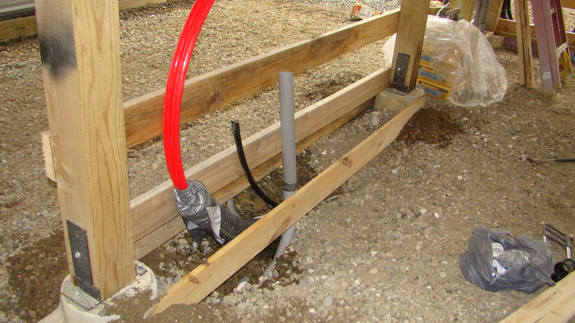

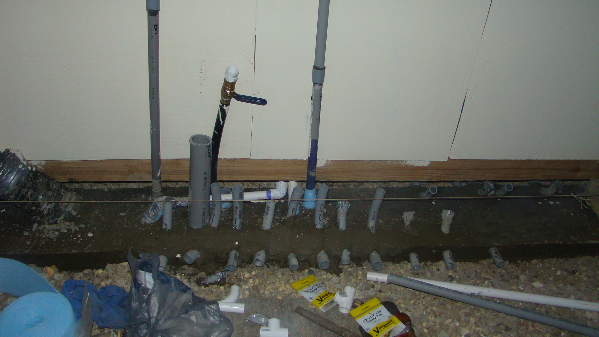

Once this excavation project was done I started putting in my plumbing, electrical, placing insulation around the outer edges of the building getting the floor up to sub grade. Doing this by myself has it's problems as no matter what I start to do there is always something else I have to do before I can proceed or I have to dig up a section again because I forgot one thing or another.:laughing: Needless to say most everything I have done here lately has to be redone for one reason or another or I just change my mind because I think of a better way to make something work.

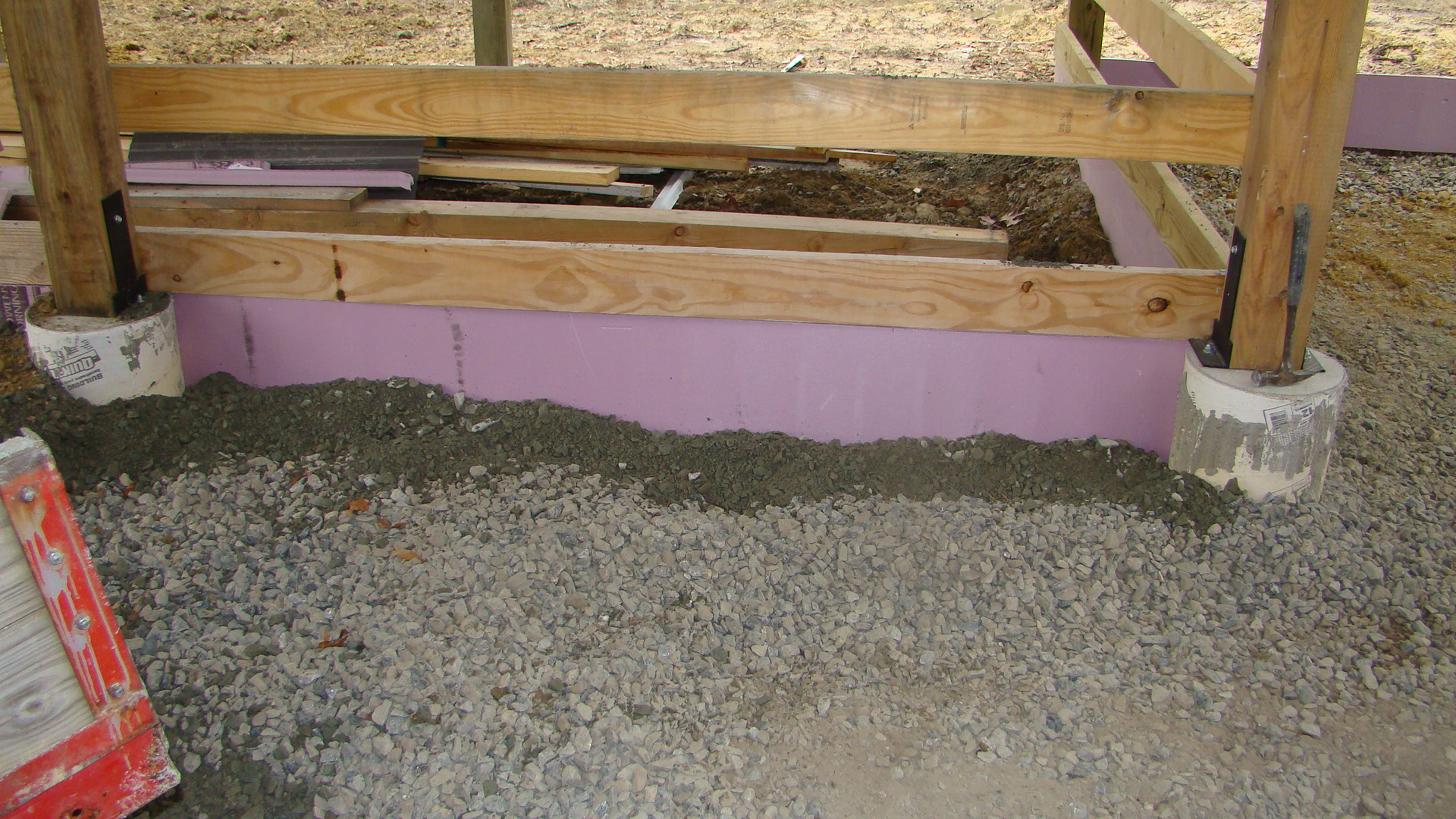

I also have started the prework for the heating system. I have almost everything I need to put it in and once all the other slab work is done I'll start my tubing runs. I found a couple pieces of 3/4 that I put together to use as a backing board to mount all my equipment on and I have started to put some of the parts together and hopefully soon I'll have this part of the project done so I can go out and make some more money to be able to do my pour.

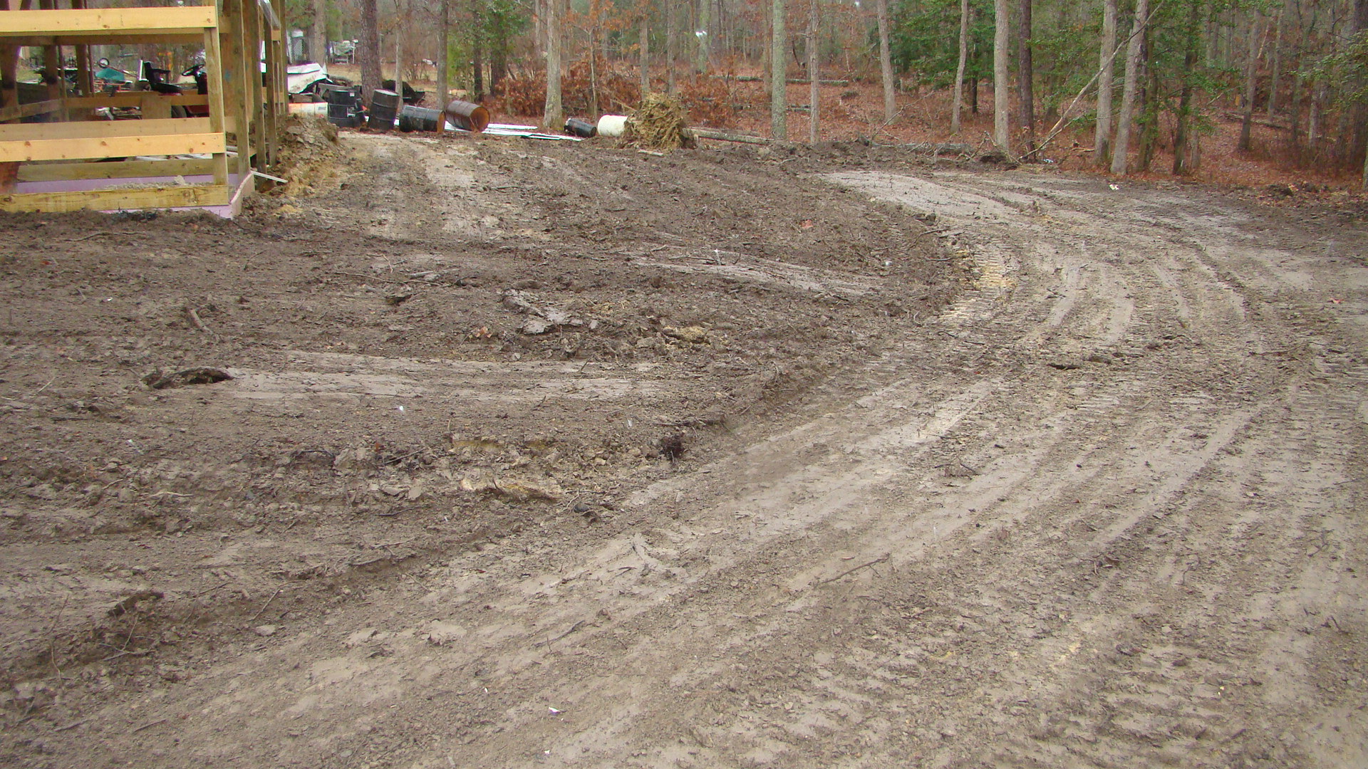

I also have been doing a little grading around the outside of the building in hopes the water can drain away a little better than it has been doing. This is all I have time for now but I'll be back.
