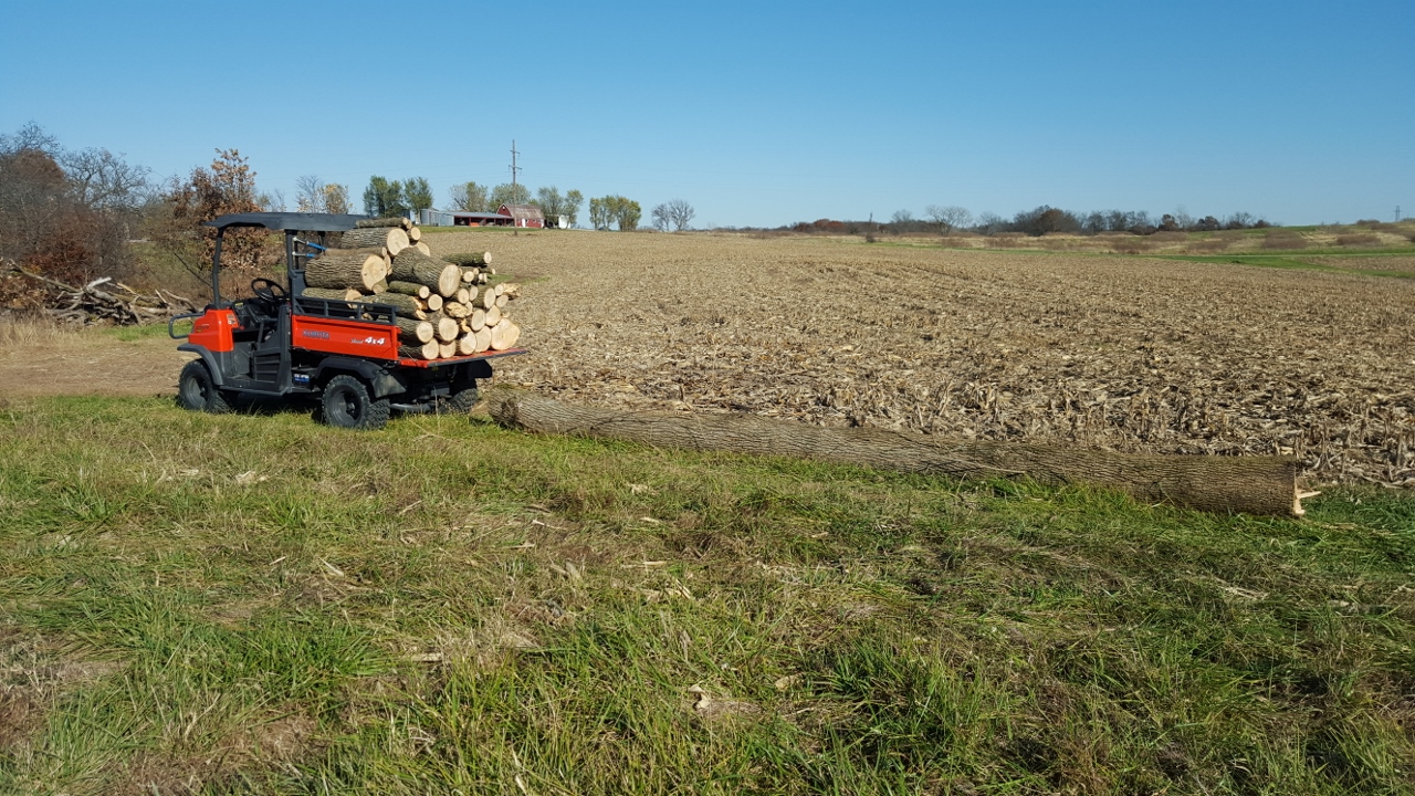

I wouldn't attempt this task with my CVT machine. Hauled this load of wood while dragging the log for 1/2 mile. Abuse?? :confused3:
