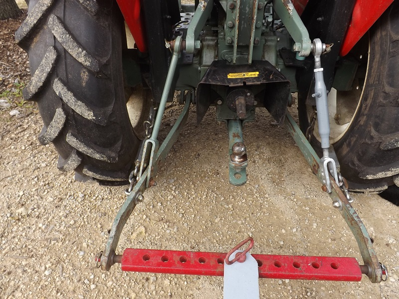

Do you live near any farm stores like Tractor Supply, Rural King, Farm and Fleet, ASC, or the like. You can pick one up really easy there. These things weight a bunch, so having it on-line ordered+shipping would be painful.
Most stores sell them in black or red. So, for a Yanmar either works great.
Here is mine from Rural King,

I think the OP is looking for the hitch ball tongue under the PTO in your picture. If he has a receiver mount there easy/peasy. If not, I think he is looking for what he needs to fab up for attachment. If the OP is looking for the 3pt drawbar, maverick just gave the answer.
Ah, so he is really looking for the trailer drawbar then.
Thomas did provide the link for that, however, Yanmar uses two types for the YM series. 1. round tube drawbar 2. flat like many of the Deere models.

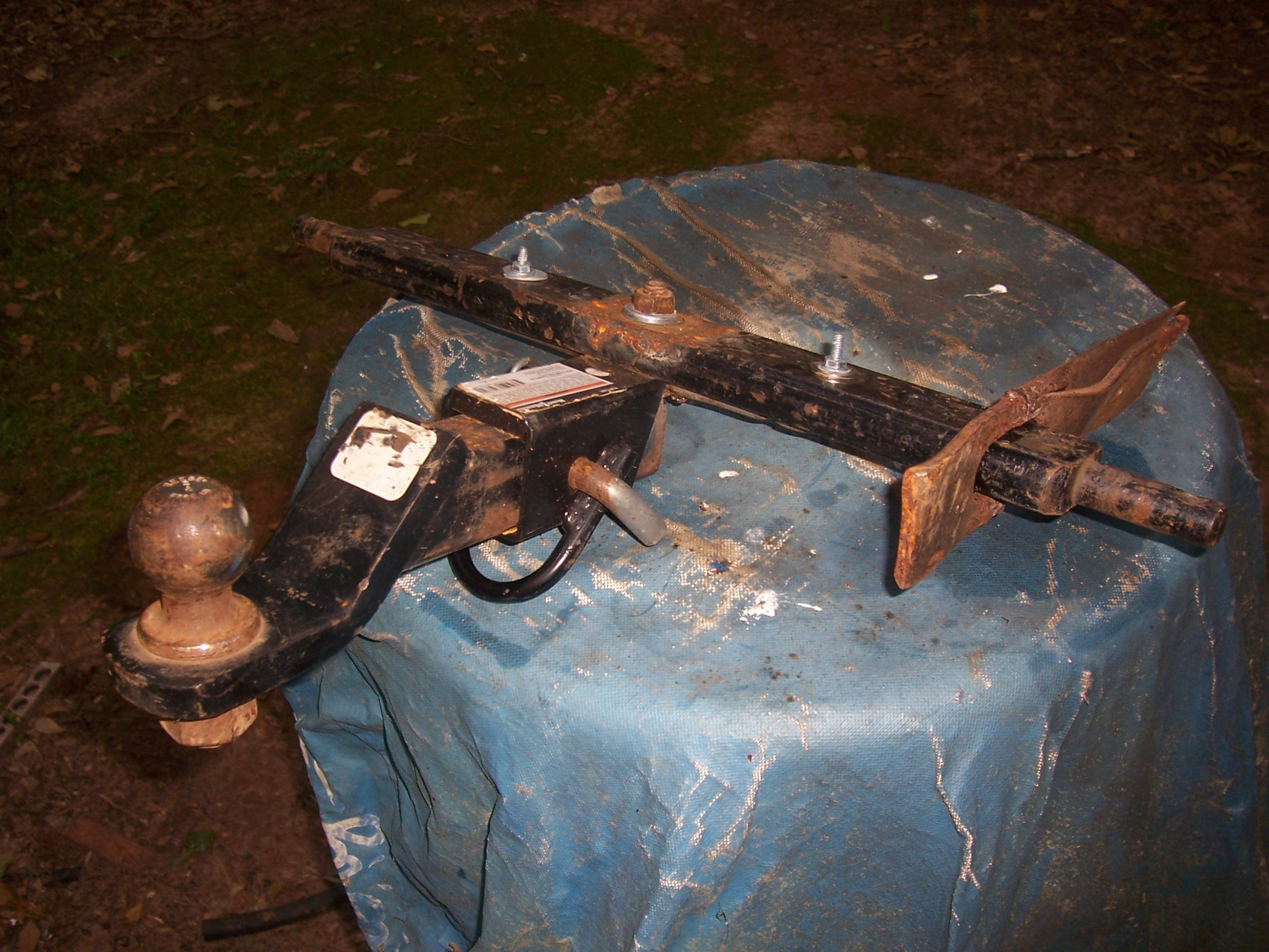

This works well esp. with the Yanmar 2000. Use a couple different Trailer setups. I made it easy for both type of Hitches. Many Yrs ago but I believe TSC.. Super cheap 25$ maybe!! I did put the getto rig on it for when I use the trailer hitch. Keeps the Bar from tilting. Old Lawn mower blade.

Nice, and Ive done something like this prior too. The only downside is, the weight limit ability is on the lower 3PT arms whereas on the bottom of the rear axle to take a much higher load.
I have a 14,000 loaded trailer to move seasonally. So easy for the Yanmar to hook up and go.
With the smaller garden trailers, the drawbar 3PT lower arms work well.

The only problem I have is not weight but Tongue weight. This Double Axle 3g Lbs. trailer is great. But!!! the small single axle garden wagon you have watch out and not get the weight behind the 1 and only axle. I've Dumped it quite a few times. The 3Pt. arms Will lift Weight but won't hold them down.
