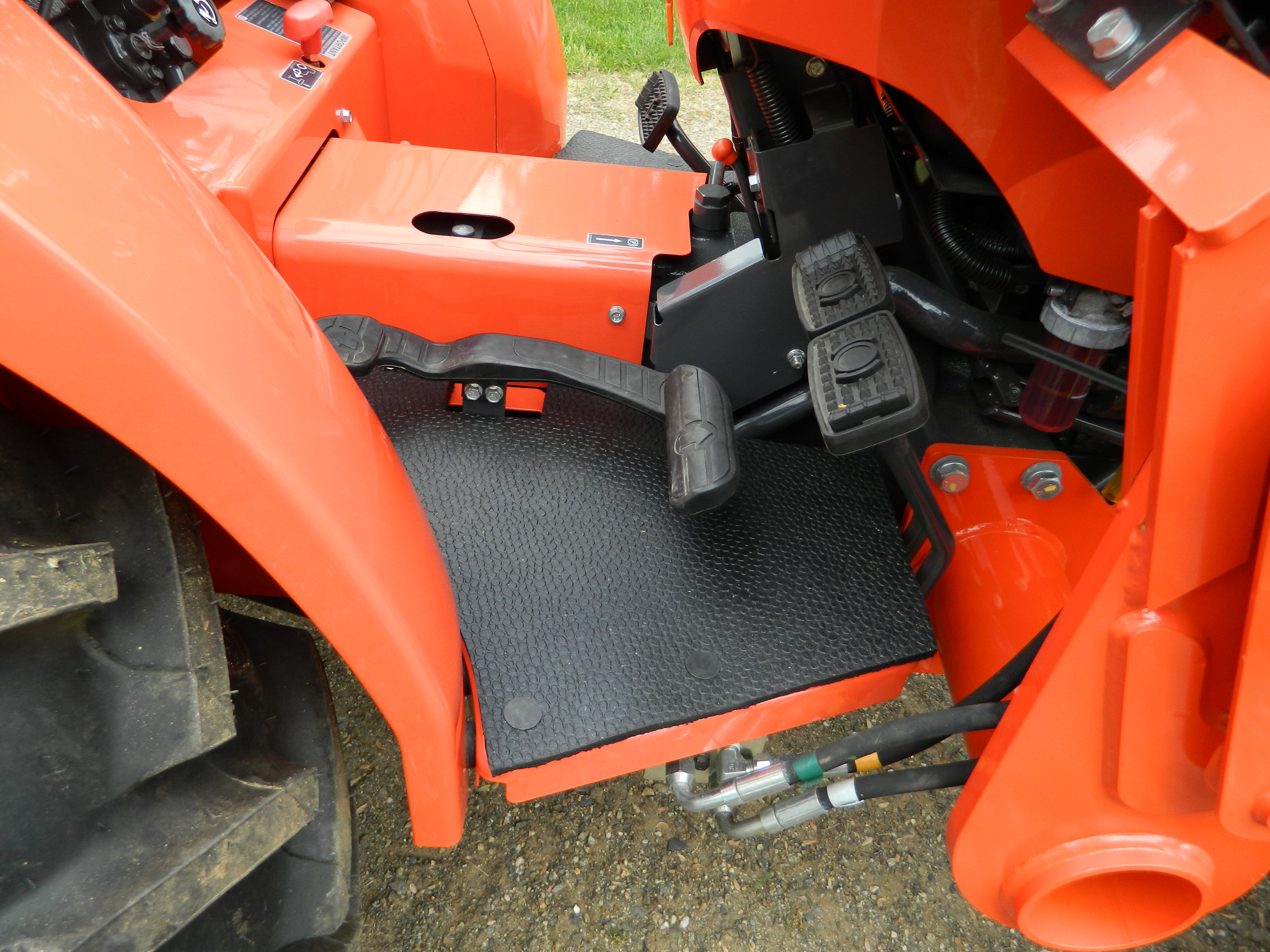

If the deck of your tractor does not have any rubber, fabricating one will not only protect the paint (if that matters to you), it also adds better traction. DSCN1261.JPG

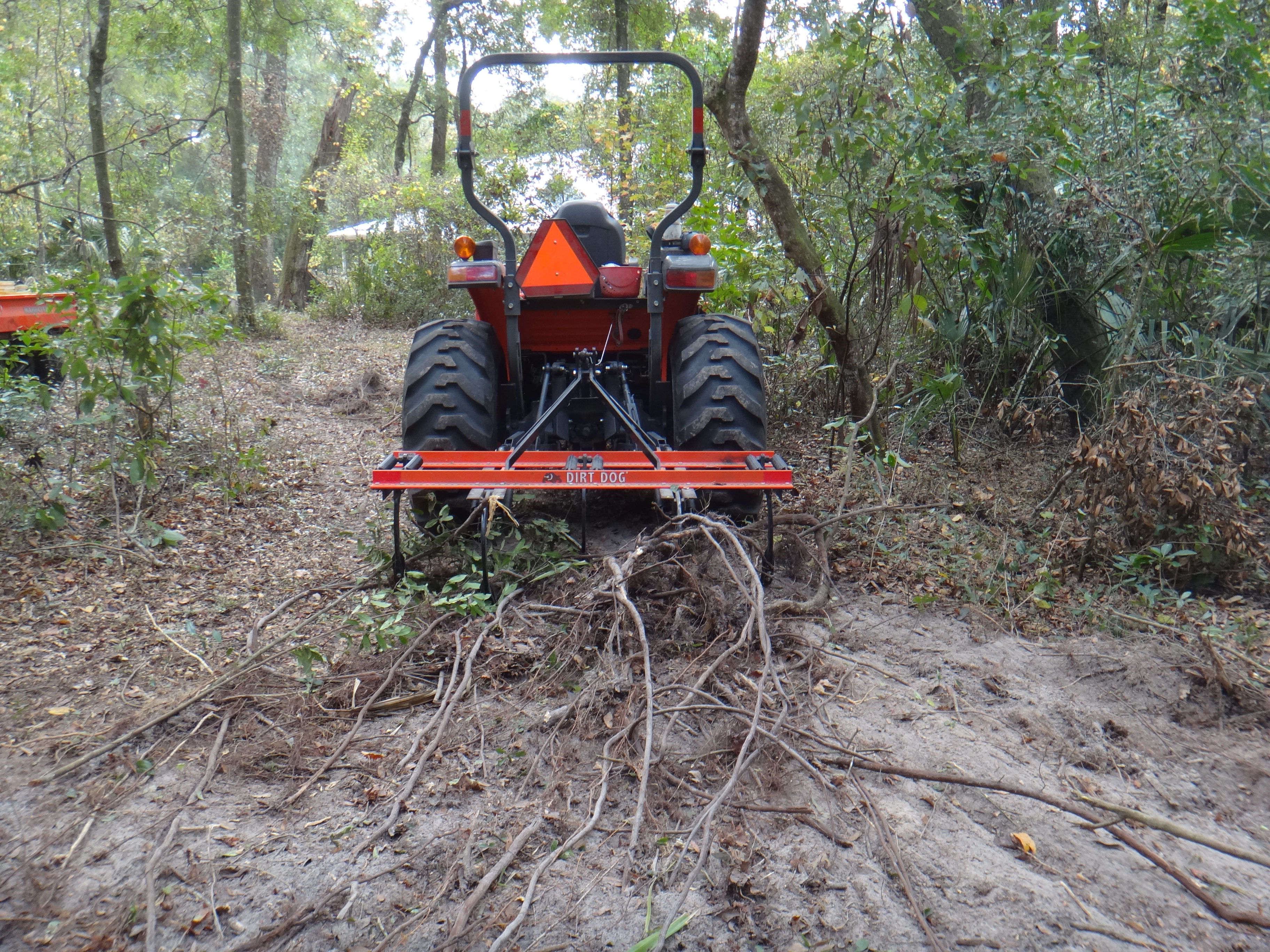

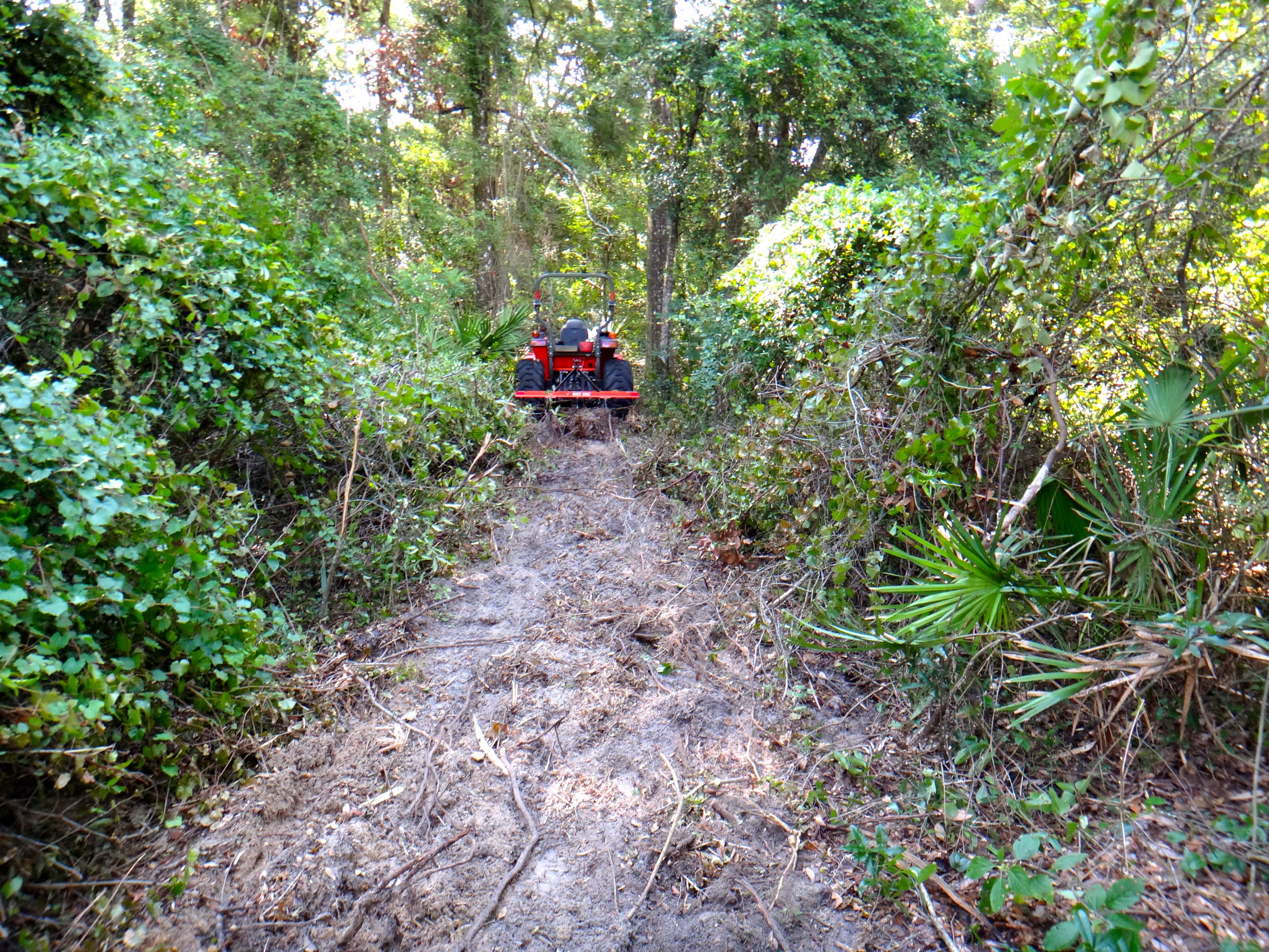

I cleared a lot of Florida jungle, transporting the debris on aluminum Debris Forks. Debris Forks require significant hand loading and carry a lot of soil with the debris. However, very good for transporting firewood.
Later I bought a Dirt Dog (brand) Field Cultivator to clear out wild grape vine roots, wild rose corms and soft-wood tree roots. I found the Field Cultivator, lifted 6" above grade, to be an excellent method of transporting snarled debris without having to load by hand and without carrying dirt in the debris.
Just offering this as an alternative thought should clearing vines, corms and roots be on your agenda. <$1,000

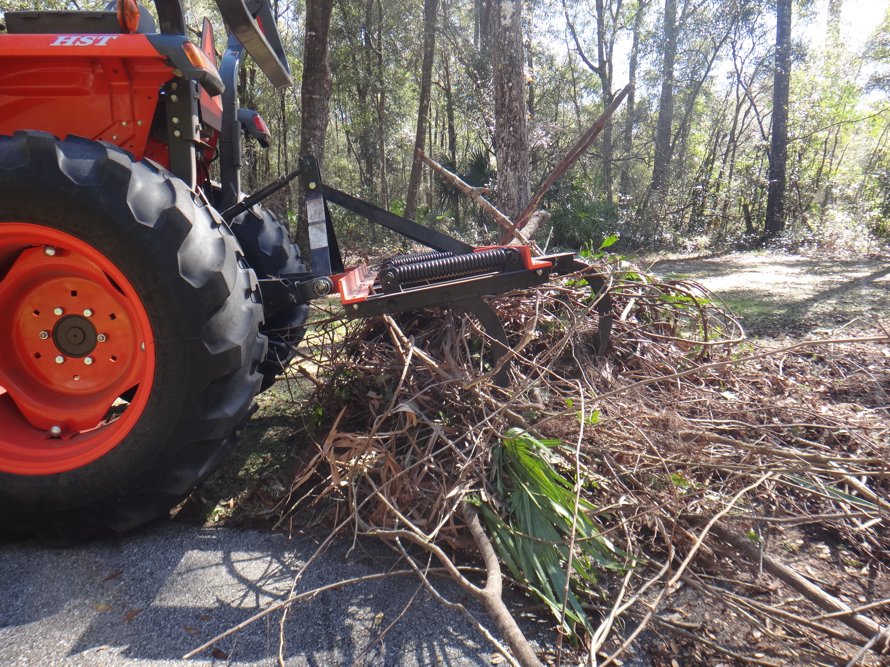

The best attachment for COLLECTING and PILING debris is a Ratchet Rake bucket attachment.
Photo #10 ~ Probably 1,100 pounds of snarled, damp, jungle debris.

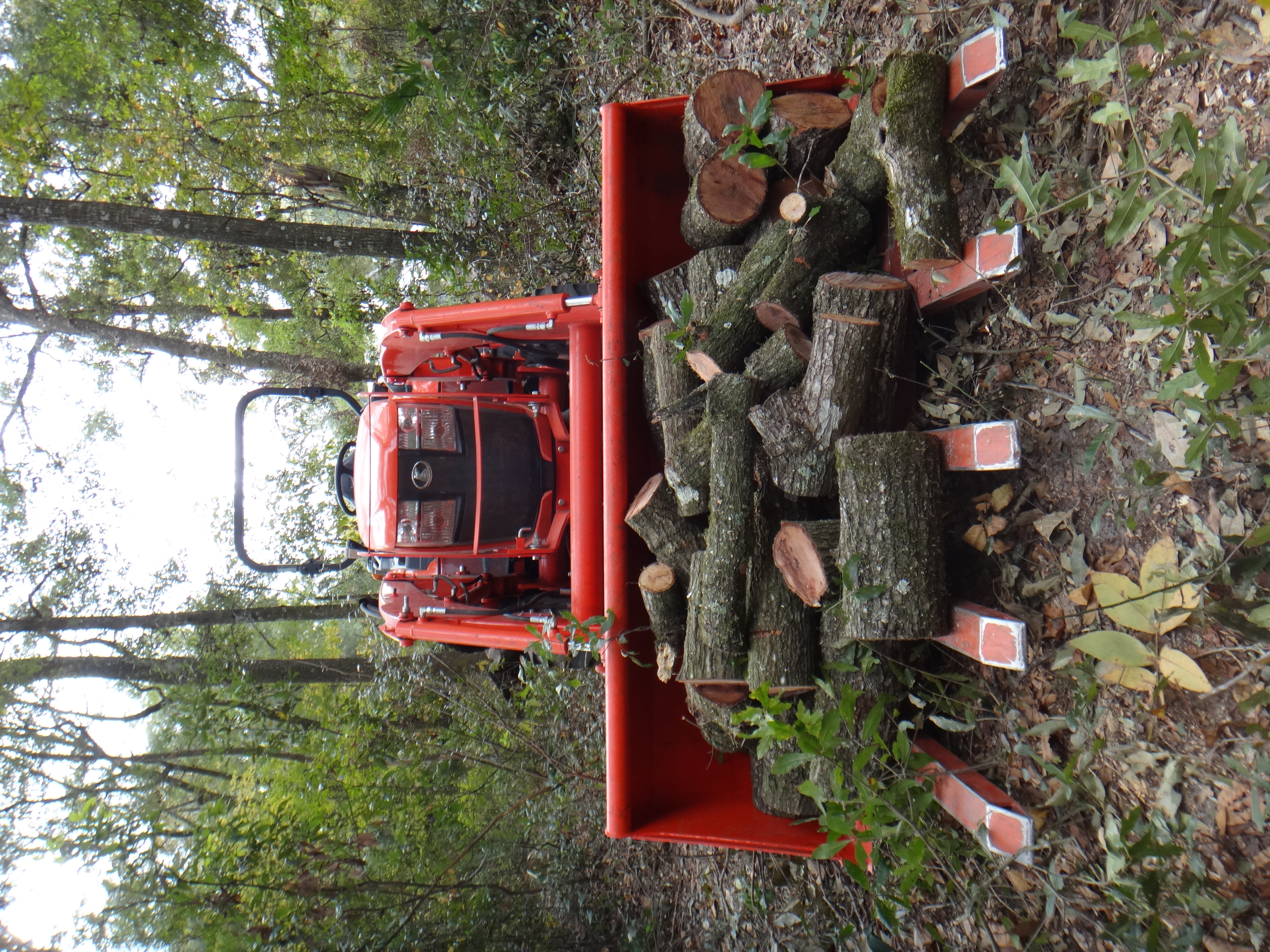

What is a carry all? These are homemade? Any pictures of good ones?
Here is a photo of mine:
Typically the metal frame is purchased, and the user builds the platform or a box on that.
As you can see from the chips in the first photo I use mine for carrying firewood. The ropes you see on the left are used to secure a big load. I also use to carry my big-wheel string trimmer up and down our hills - the cord looped in the center catches a hook on the front of it to hold it in place.
