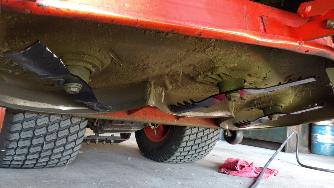

Installed a set of Oregon Gator blades on my BX. I also leveled the deck, it was 1/2" high on the right side, greased all the spindles, idler pulley, center pivot, gauge wheels, and checked the oil in the gearbox. It's good to go for the rest of the season, if we get enough rain to make the grass grow. After an unusually wet spring, it's been almost two weeks with no rain, and looks like it might be a couple more before we get any decent amount.

Nice!
I been running Gator blades for a few years now on my mowers, their also great for mulching leaves

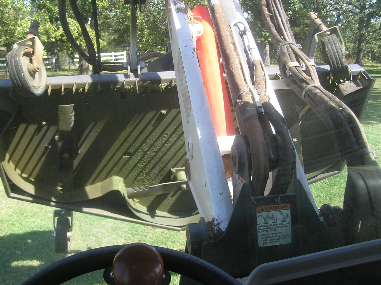

I also put Oregon Gator blades on my 6' finish mower:
The view from the seat with the deck raised:

Well, today I finally got to put the Gator blades to the test. They run nice and smooth, so they must be balanced pretty well, and cut really nice. A couple of things I noticed was that they kick a lot of cuttings out of the left front corner of the deck which then pile up on the deck itself and even up onto the floor of the tractor, and they cut 99% of the buckhorn. the old blades left about half of the buckhorn standing, even when the blades were freshly sharpened and running the same speed. Now the yard was pretty dry today, so if that makes a difference or not, I don't know. It was so bad that clippings got into the radiator screen and plugged it up making the engine overheat. I've never seen the temp gauge above a quarter of the way up on the dial, but it got up into the red before I noticed it. I let it cool off and pulled the battery cover and radiator screen and blew them out, then put my long reach nozzle on the air hose and blew the radiator out from both directions. It had pushed some coolant out so I refilled that and everything was back to normal.
But yes, the blades to a great job of cutting grass and do seem to cut it up finer than the stock blades do..
