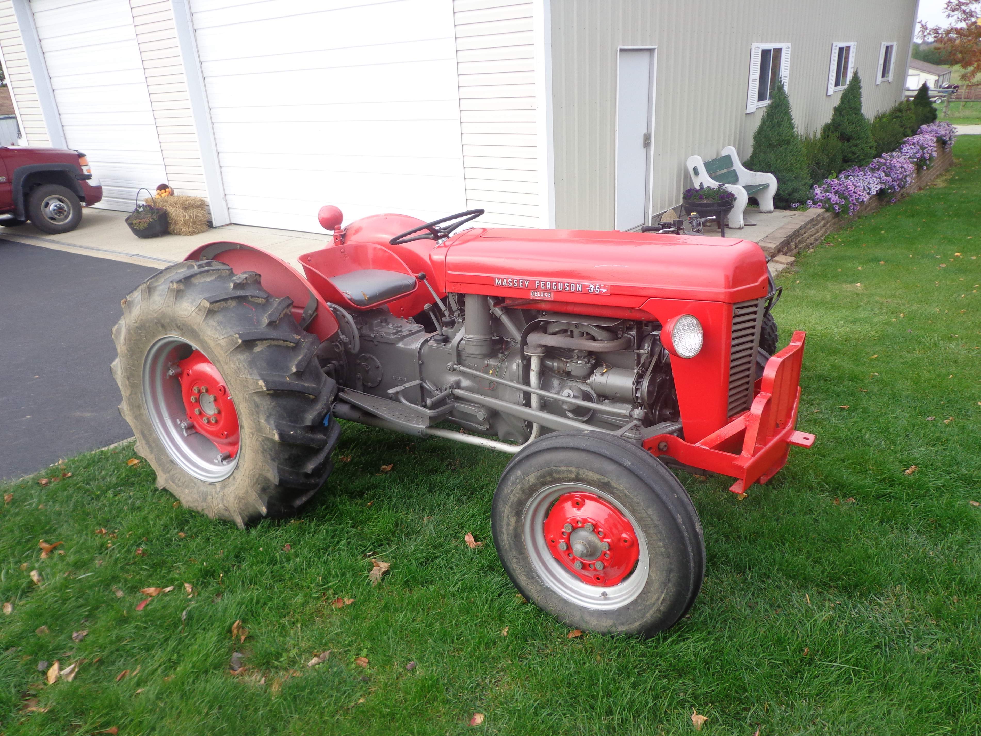

210.jpg my mf 35 which is the next generation of the to 35
Depends on if yuo are just tryin gto get it to work or convert to 12 v you could conver to 12v with a new alt, VR and coil, 12 v battery Rewire is simple just get a wiring diagram and make your own harness

Nice 35 Bucktaker. Did you restore that your self ? Thats what I had hoped ours would look like.
