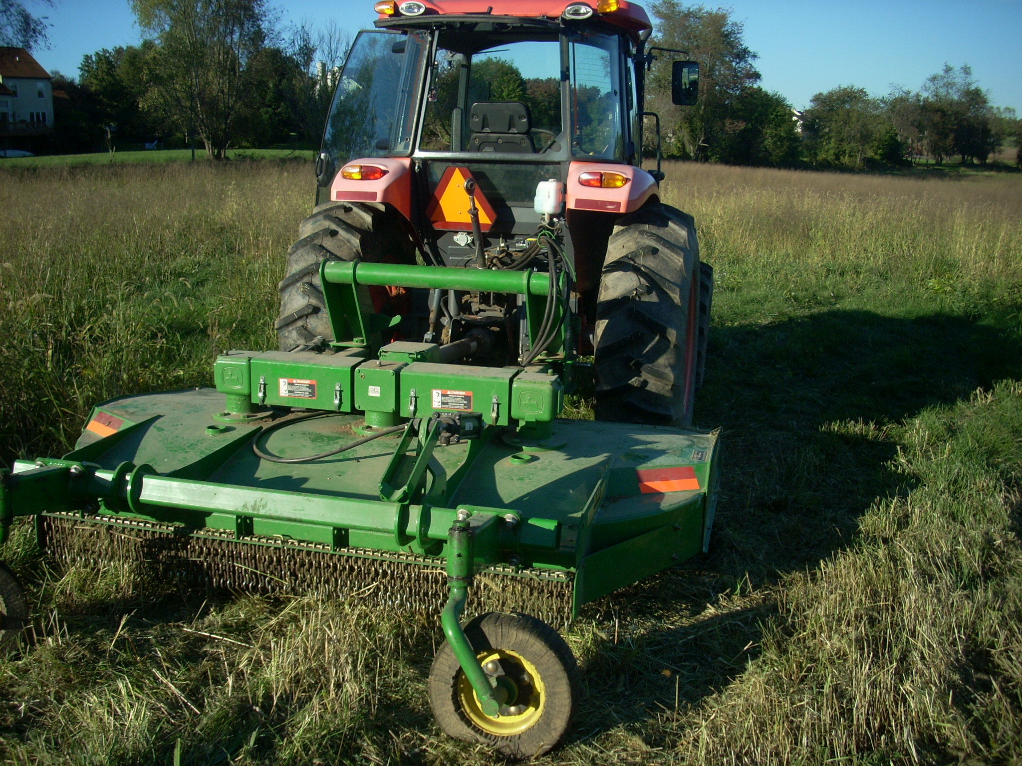

I own an MX-8. What a sweet mower. I have the hydraulic tailheight adjust and the hydraulic swing on mine. Got it for $3,000 used-looks like a brand new mower. Couldn't be happier.

I looked at that front hyd cylinder in your pics and it didn't click for me that was for the "offset" mower deck. Very nice. Keep the rear tire and the cab away from all those things that just happen to reach out too close..
Yah, I'd bet those laminate tires can get a bit "jiggly" at 20mph on blacktop roads!

I have the aircraft tires & light kit on my "order" list with the stealer. All I gotta do is call him and pull trigger. The laminate tires really aren't too bad. What I don't like is they tend to really pound the mower when going down the bumpy roads.
I really love my MX-8. There's definately a build quality about it and a finish quality missing on other mowers I looked at. Lots of grease fittings. Very easy to get to them. Did I mention it has stump jumper pans on it, too? Looking & considering a Landpride "commander" 10 or 12' single wing, but $12,000??? That's crazy. I could buy an older open station JD5300 4x4 with a 8' flail mower for $12,000!!!

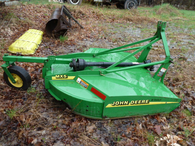

I have a MX5 was mowing a feild and the output shaft broke . It was clearly a foulty casting and John Deere Said go pound salt !!!!! I will never buy Deere again !!! And yeah , I can buy a new gear box for $700 and the new pan for $600 !!!! that is the parts update, Can't buy or replace the broken shaft. Thed new gearbox and pan is the 3/4's the price of the new unit. Like I will get right on that Deere,,,,,,,,,,,,,,,,,,,,,,,,,,,,,NOT
What makes you think the casting was faulty? It broke at a circlip ring groove. (the weakest point). They can make the groove with small radii at the bottom to improve strength. Was the stump jumper pan damaged? Hitting something unmoveable can put an extreme amount of force on the shaft. When a shaft breaks from overpowering, it will break in a "coiled helix" type break. When it has too much side load, it will shear as yours did. Like when you hit something and the whole mower jumps up and comes back down on what you hit. I would think that you could buy that part if you can decipher who makes it. Except for the gear teeth, the thing could be easily made at most machine shops.
Its a relatively fine line making it hard enough to do the job but soft enough not to break. Better quality steels broaden the line.
I have the cheapo LX5 and I've hit some pretty bad stuff with it. So far, I guess I've been lucky.
I would recommend against buying a 7 footer for this reason. Too much load can be put on the shaft with a 3.5 foot radius. Unless you are only maintaining pastures you know about, shy away from a 7 foot single shaft mower. Move up to an 8 footer(2- 4 footers combined) or go back down to a 6 footer.

Mines not a pull type....it's a semi-mount. At first I was hesitant, but now I love it. You get the rigid control of a 3 pt mount, but it floats more than a 3 pt. Most of my mowing wouldn't be as easy with a pull type. "Backing the trailer" isn't my favorite manuever for most of my customers properties, and I'm a CDL driver that backs big trailers all the time!!
That's some strange grain in that shaft, I seriously doubt it was a casted part. I've seen shaft up to 8" snapped off and not have that odd grain in the break. Doesn't appear to have had any previous cracks in it or you be able to see old cracks, they usually always shine, as in oil penetration or rust, like a sore thumb. Was it rotating when it broke, it looks almost like a sideway break and not a twisting motion break.
