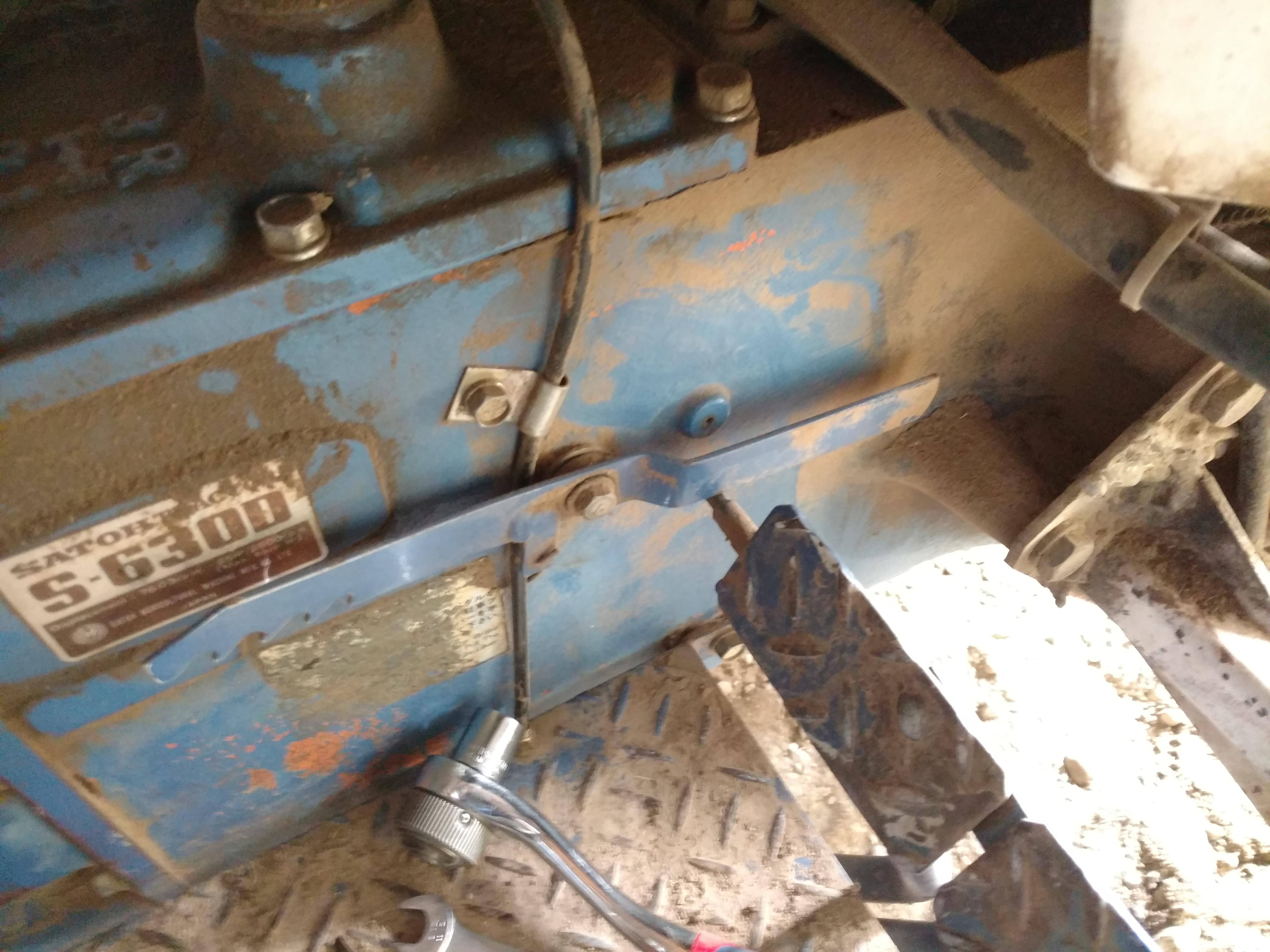

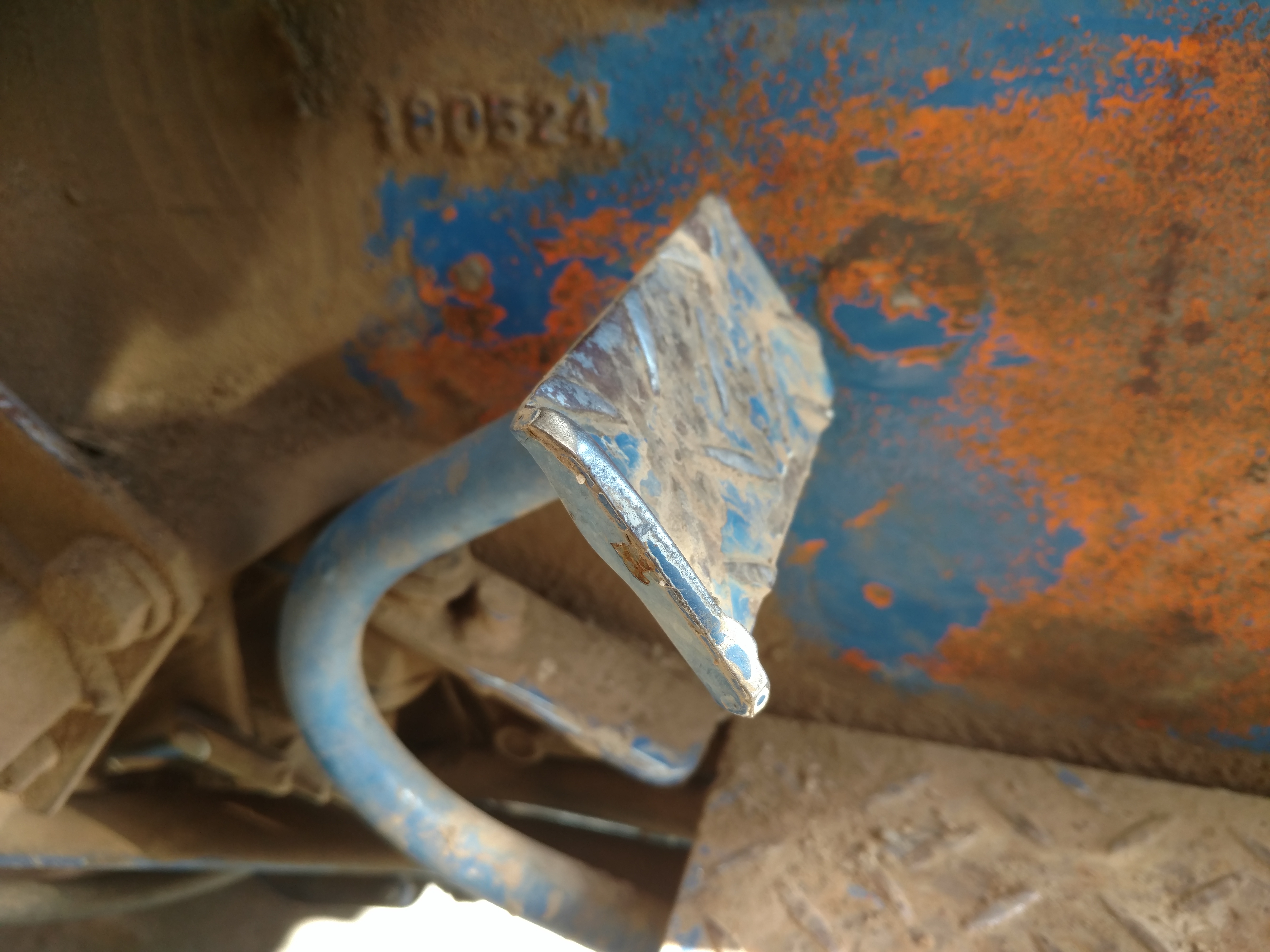

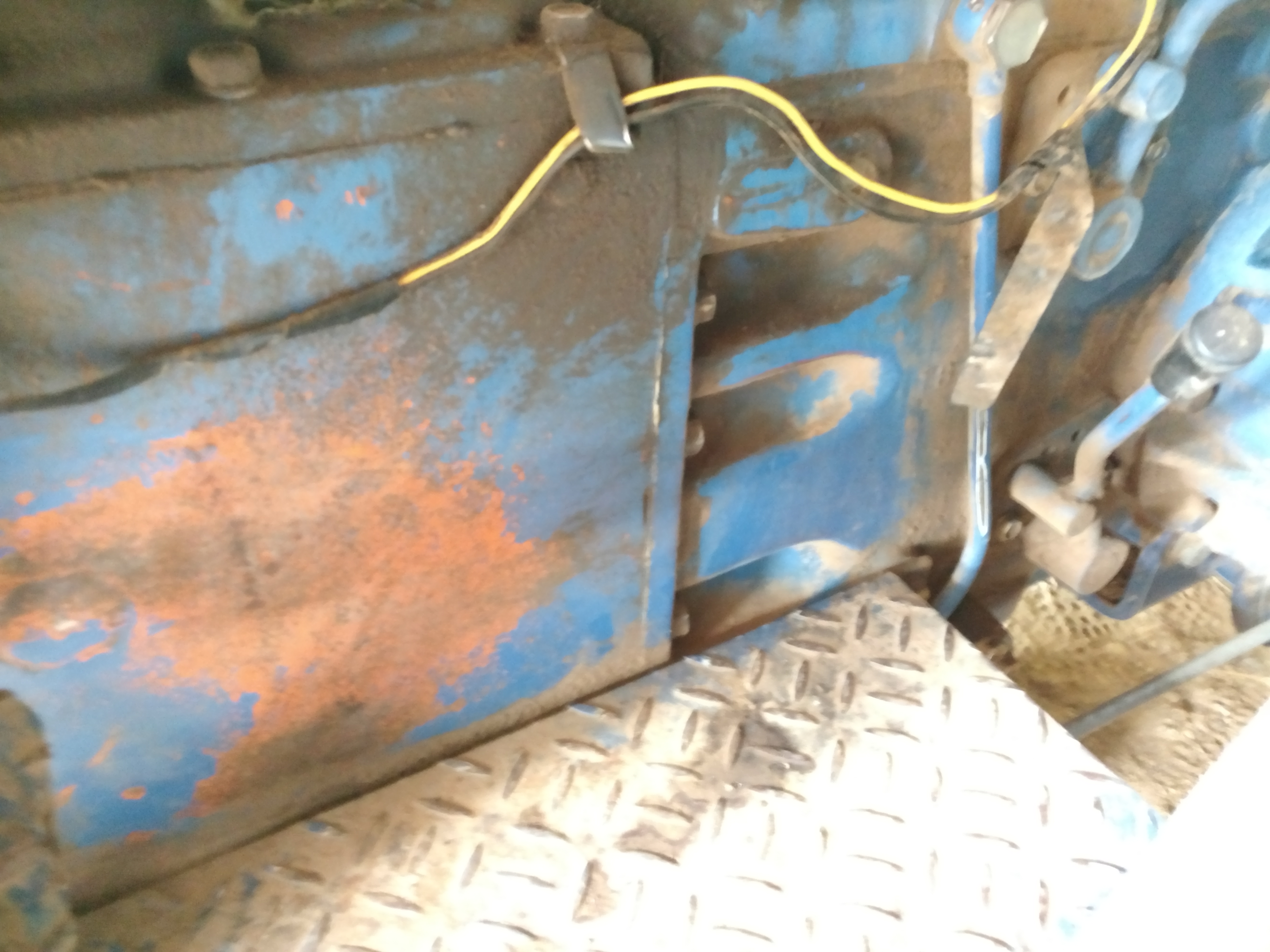

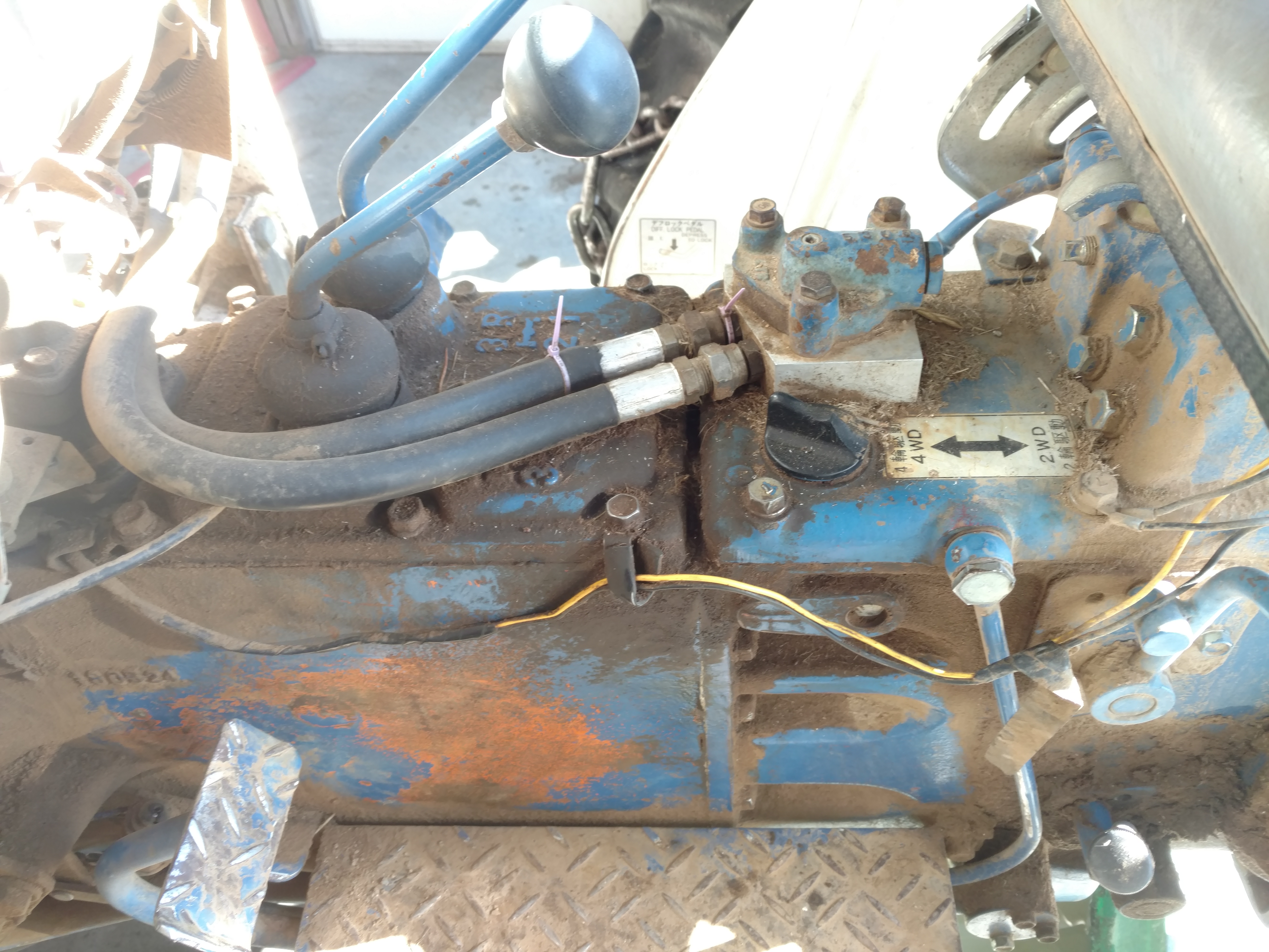

I believe the level plug is on right side of transmission about half way up the housing.
   / NEW MEMBER with Satoh Bull
#11
Thanks for all the support and info. I have drained the fluid 3 times and while it is not as cloudy (cream color) it is still not just oil color. I will try to upload pics. The right side is where the drain plug and the plate with the filter. I don't see anything else to check the level by. Let me know if anyone has any other ideas. Oh and I removed the 4 screws for the filter, the plate won't come off.
