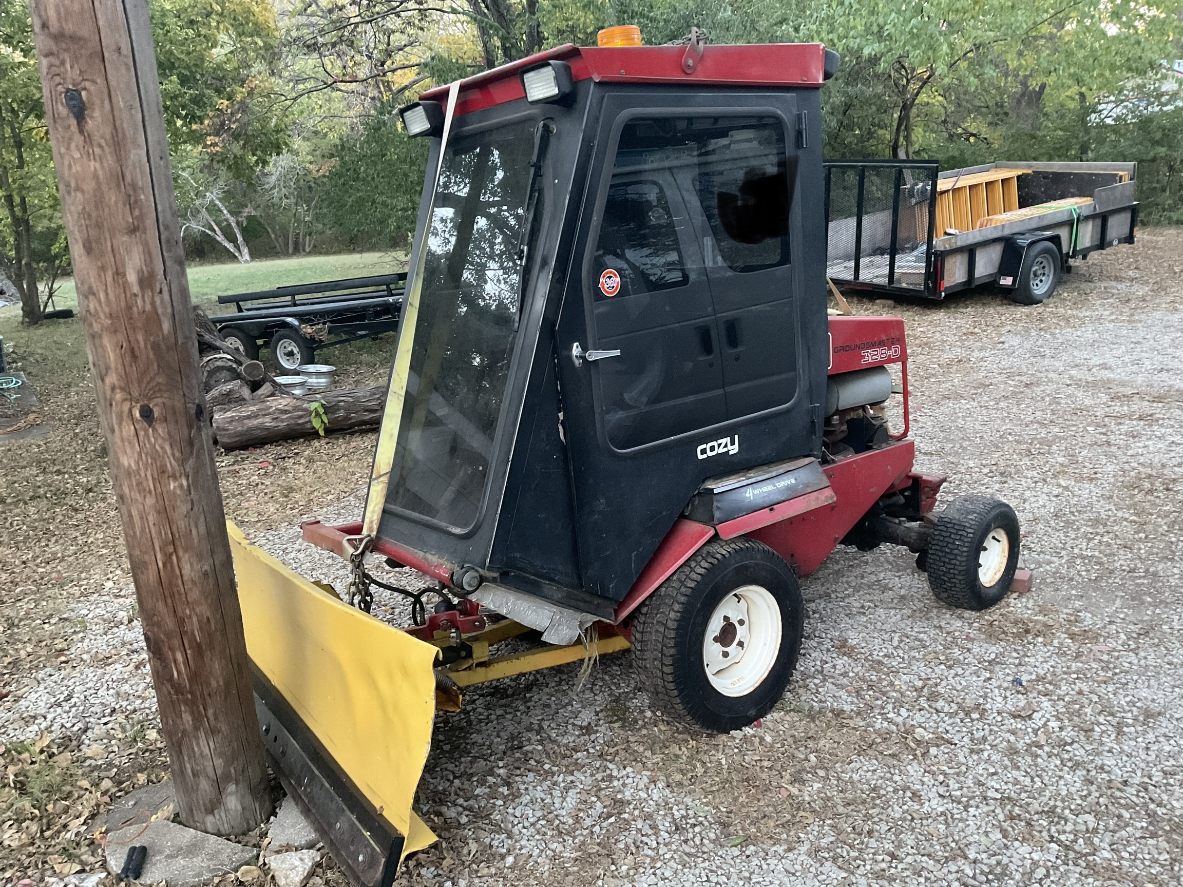

I guess I’m not a new member, but this is my first post. A Toro followed me home Monday. Got it in a government auction. Once it’s running and up on maintenance. I plan to remove the blade and cab and install my schwartz loader from my simplicity sunstar. Im not fast at all with these projects. It came with a book of manuals. And Xfaxman has been great about answering questions. 1400 hrs Here’s a few photos.

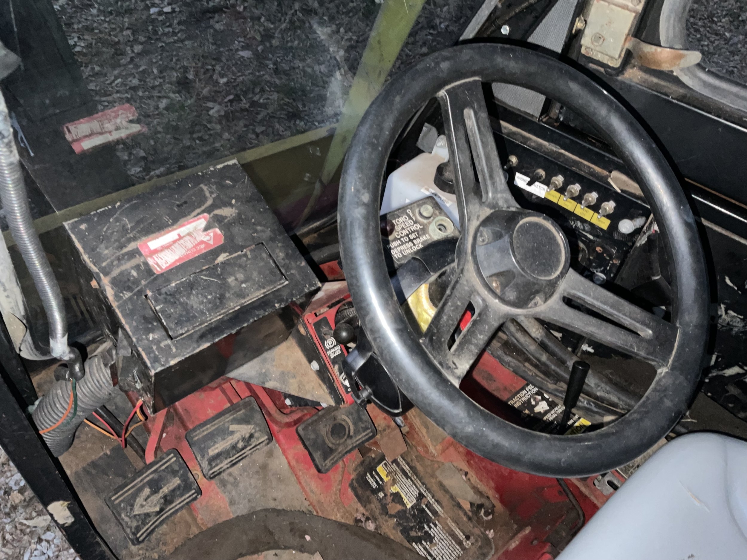

A little bit of progress today. It is currently no start no crank. I have instrument panel lights. I think I can hear the fuel pump clicking. Also a single click from starter solenoid. Seat switch is good. Pto position switch is good. I’ve cleaned various contacts and grounds. I haven’t found the starter solenoid yet. But I need to locate it and clean contacts there.
My last pinpoint tests today were the fusbile link by the starter. Not completely sure on that test yet.
I also have 1 positive wire (14ga) that may have been loose near the battery. I don’t know if it’s factory or where it went so it’s disconnected right now. I could use insight on any of the above. Thanks, B
