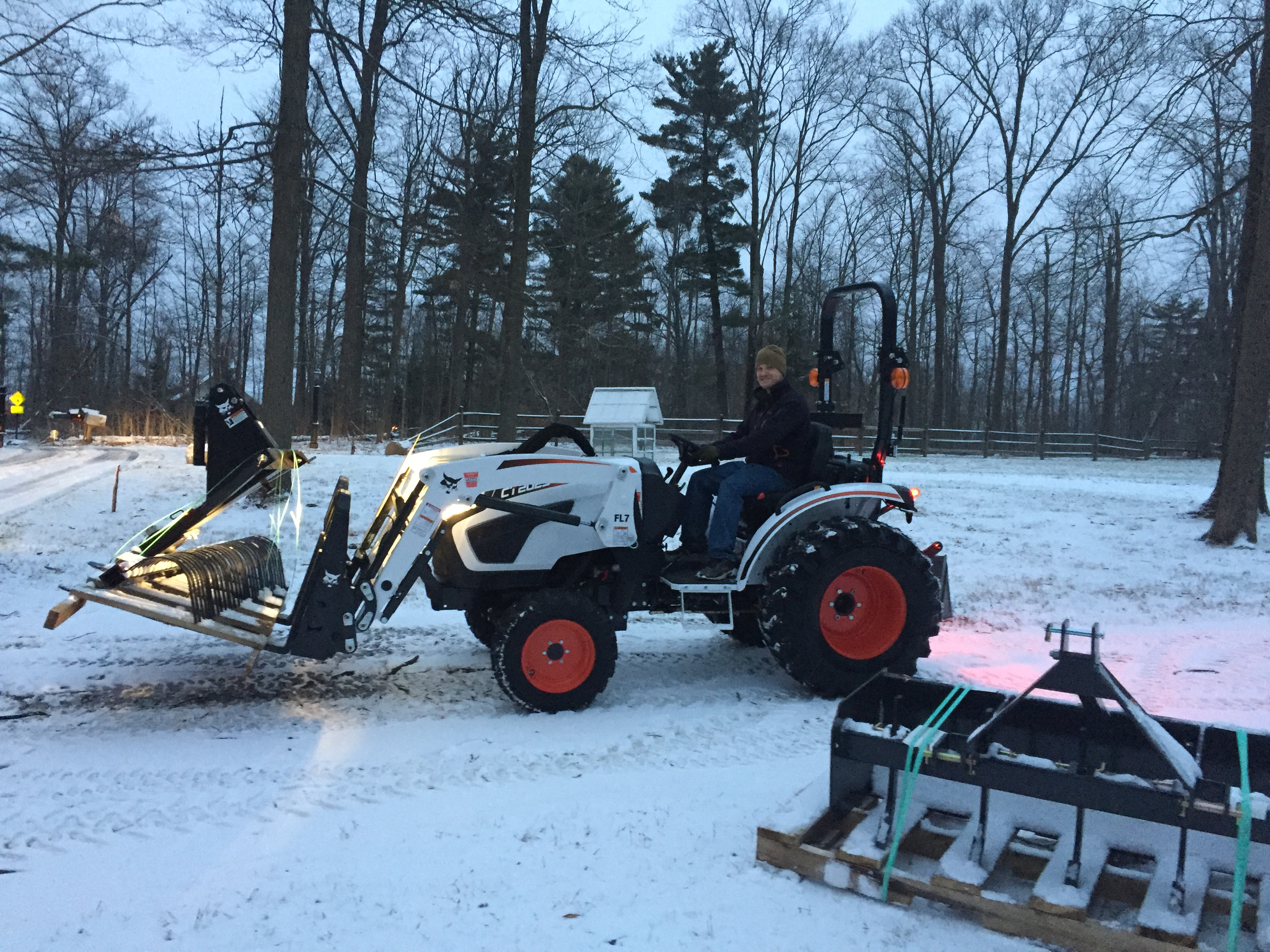

New member here, just got my new tractor last week. Bobcat CT2025 HST. I ordered it with R4 tires, front loader, 2 pairs of detent remotes, linked pedal, toolbox, 60 inch box grader, 2500 lbs forks, and a tine rake.
I plan on adding some LED work lights, a beacon (I run it down the road every now and then), cruise control, and a third function down the line, as well as some other implements.
I mainly will use it for moving things, grading, and eventually some snow removal.
I joined this forum to learn more as this is my first compact tractor. It seemed to be a good value and it was considerably cheaper than the Kioti CK2610H I was quoted. The dealer was also top notch.
