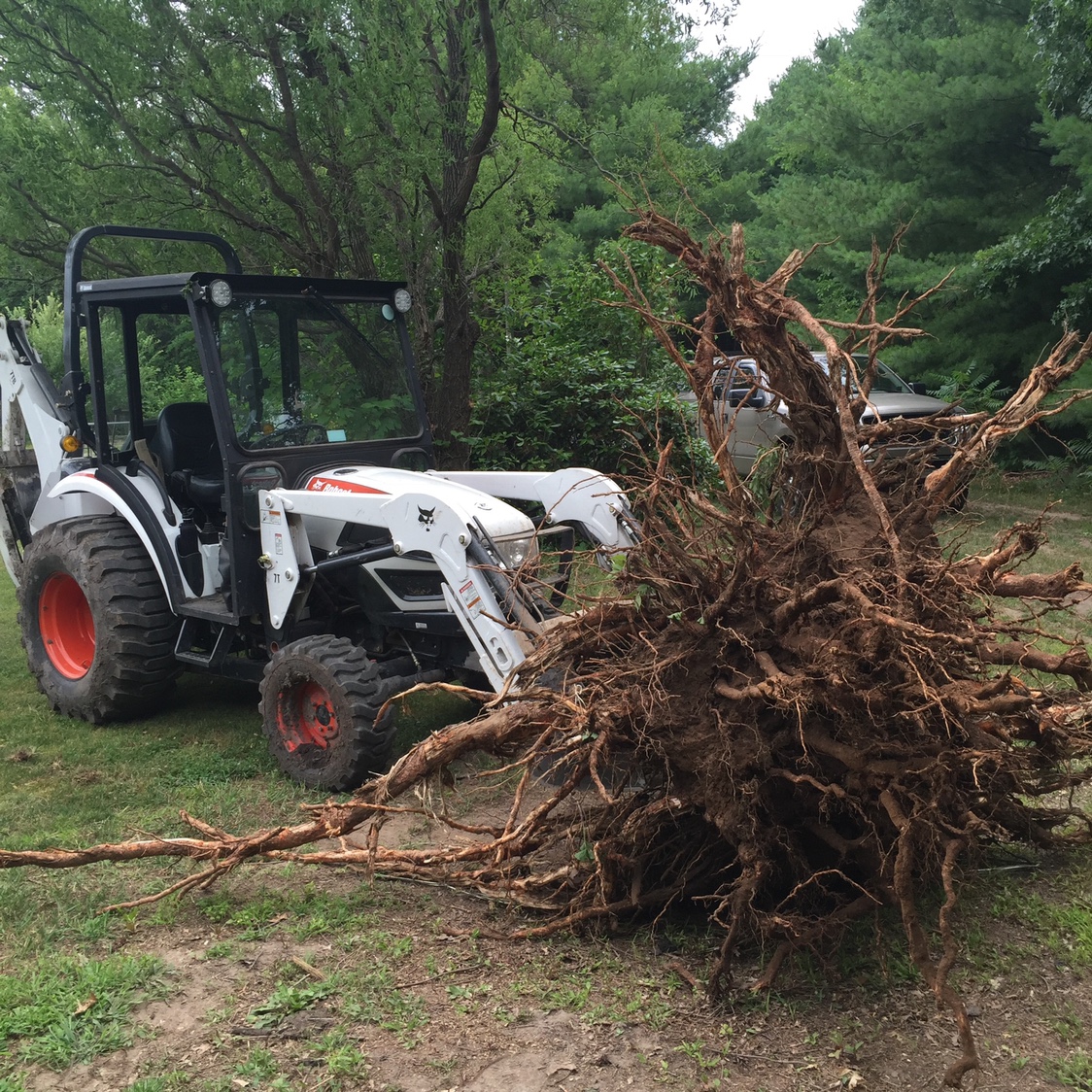

Here’s a picture of my older CT 225 doing some heavy lifting

Congrats on new tractor and welcome. View attachment 679717
I love the cab. They don't make one for the 2025. I almost went for the 2035 so I could get one with a cab, but they didn't have any in stock, and would have been at least 2 months to get one. I had an immediate need for a tractor.
