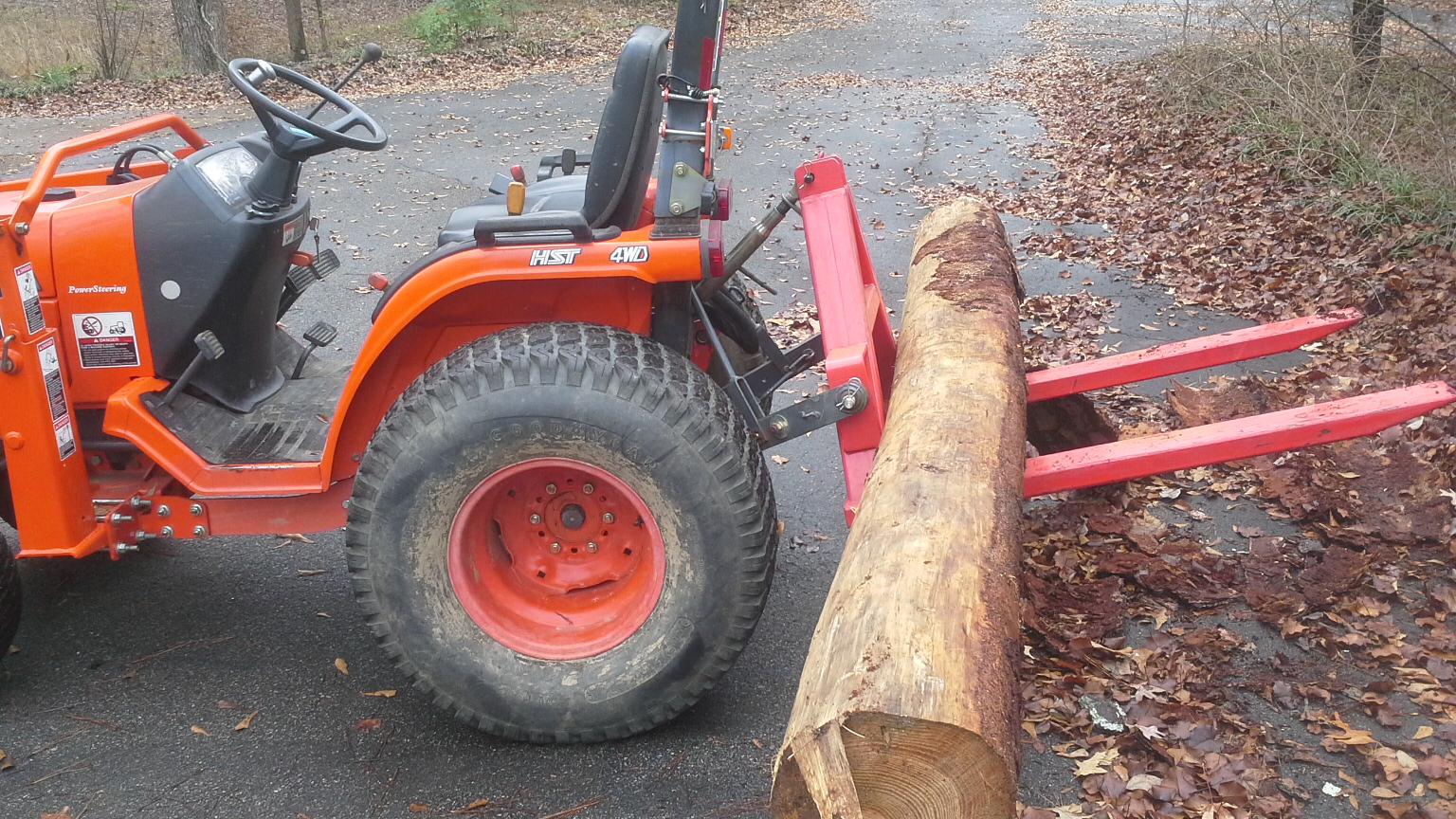

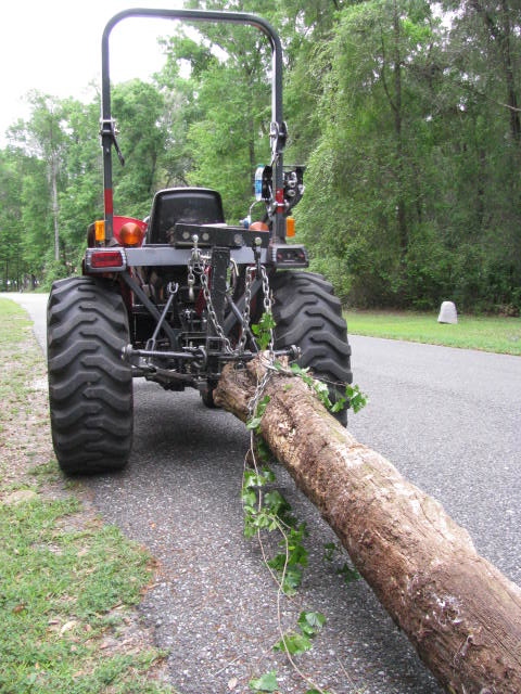

Due to the great mechanical advantage of large rear wheels, even a small 4-WD (25-hp) tractor can drag around logs from the tractor draw bar, however the logs will get dirty.
To keep logs clean you need to transport them using forks attached to a Front End Loader, in which case you need a larger, heavier, 4-WD tractor more like 35-hp to 45-hp.
For gravel road maintenance a 3-Pt. hitch mounted LPGS (Land Plane - Grading Scraper) would be a good implement choice.
Filling rear tractor tires lowers the center-of-gravity on your tractor making it more stable. As you have hills and are new to tractors consider having rear tires filled at time of purchase.
When shopping, ask of each model, can the wheels be moved out to increase the tread width? Some can, some cannot.
Photo #1, #2 (heavy) Kubota L3760, Photo #3 (light) Kubota B3300 SU

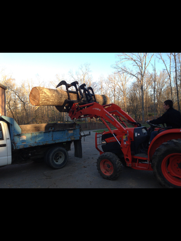

Logs - there are basically two ways for a tractor to carry a log - crosswise (on the FEL or 3 point) or drag behind.
You don't say but it seems to me if you want logs 12' long your talking for a sawmill or similar application. A 12' x 12" white oak weighs about 650 lbs.
Easily lifted on the 3 point of a small tractor like my B7610.
attachment.php
It is starting to push the limit for the FEL on a small tractor. However to carry a 12 FOOT log crosswise out of the forest will require about a 14 FOOT or wider path. I don't like to make extra wide paths.
"Dragging behind" approach, especially with a log arch is easier and you only need a narrow path.
I don't normally like to suggest far more than the OP needs, if you are dealing with NO trees over 18" DBH a 30 to 35 HP tractor should have enough power.
