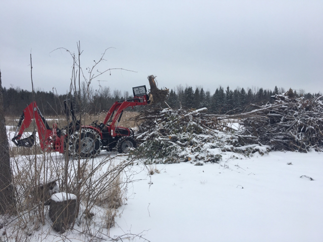

I was able to light the big pile in the middle about 5pm or so. That was after about 7 inches of snow Sunday. It took a bit to get it going but once I did, the snow be melting quick! LOL
I let that burn for about an hour and a half, then used the 3550 to start pushing the two piles, one on each end, into the fire.
Like you, I have burned many a large pile over the years. Trimming up trees and removing the ones you don't want, etc. nice to get rid of it and especially burning and having the stumps completely gone!

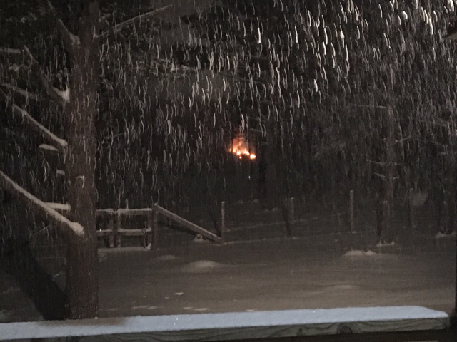

This is a picture from the back porch of my house while the snow was still falling. The fire is in a large open area way behind the trees and down by our pond. I'm hoping 90% will be gone by tomorrow.

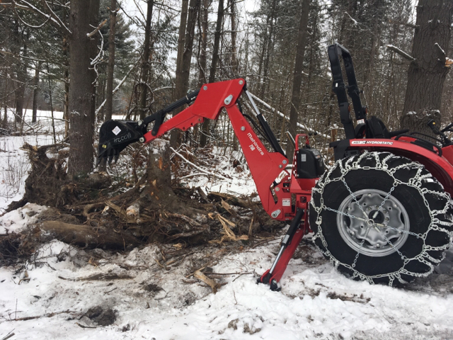

How'd the backhoe perform digging the stumps out?
Oh. Those stumps were dug out at an earlier time. I was just using it to free them up. I had four of them in there all frozen together but on top of the ground. I had dug them up with my John Deere 210C that I just sold a while back. Ground is frozen a good way down here now. So I will wait until late spring before I start doing any digging.
