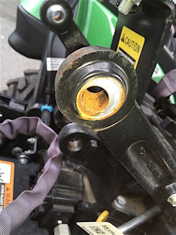

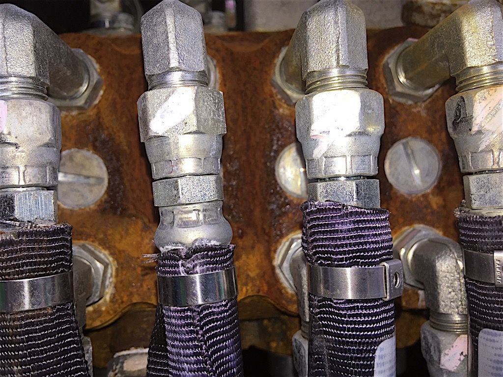

I'm sort of a captive customer - on an outer island in Hawaii. Only one dealer on my island. I would like to purchase a John Deere 1025r TLB, but there is only one in stock. It is a 2015 and been sitting outside for about six months - in a rainy area fairly close to the ocean. The dealer has offered $800 off due to the age, another $750 off for the JD special Bonus promotion discount for two implements - and the 0%/60 mo. financing.
I am told it would be the end of Sept. if I were to order a new one. That would be four long months looking at chores I needed to do. :(
But, I am concerned about the degree of rust I see in some areas. I am a complete newbie when it comes to tractors, and not all that smart about equipment maintenance and condition. The overall appearance looks good. And it is new - 1.4 hour. But for $25,000 and a new garage to park it in, I was kinda planning on having this for a very long time. Or at least keeping it in good condition - for resale value
What would you do???

If you will be storing the tractor outdoors, in the same conditions, what difference would it make?
If you will be storing indoors, I would order a new one.

I have been in the shoes of a perfectionist and know you will not be happy with that tractor. Way too much rust to be acceptable. Remember, there are metal and electrical parts under covers and such that probably look about the same. Life is too short to buy what you don't really want.
Order one and I'll bet it shows up sooner than you think. Buy that one and every day that rust will bother and every night you'll wonder why you didn't order one. Just my two cents.

I personally would not buy if he offered a $5,000 discount. That is a lot of visible rust, what about the rust you can't see. RUN, don't walk away from that deal. Bite the bullet and wait. Unless you just moved to the island you have already been waiting. Don't rush into a purchase you will regret later.

Is it possible the new one will look EXACTLY like this one down the road... Bare cast iron and that area of the country don't mix.

That is kinda what I was asking - is this normal for six month's outside storage? Or is it indications of something else? I'm on the Big Island of Hawaii, and the main port is Honolulu on Oahu. I don't know for sure, but a lot of the "stuff" that comes from Honolulu is on open barges. I was worried this might have come that way and had a wet and rough trip. And perhaps it just wasn't rinsed with fresh water upon it's arrival.
But I have no way of knowing - hence - my question - is this a normal condition for six months in rainy weather, outside near the coast???

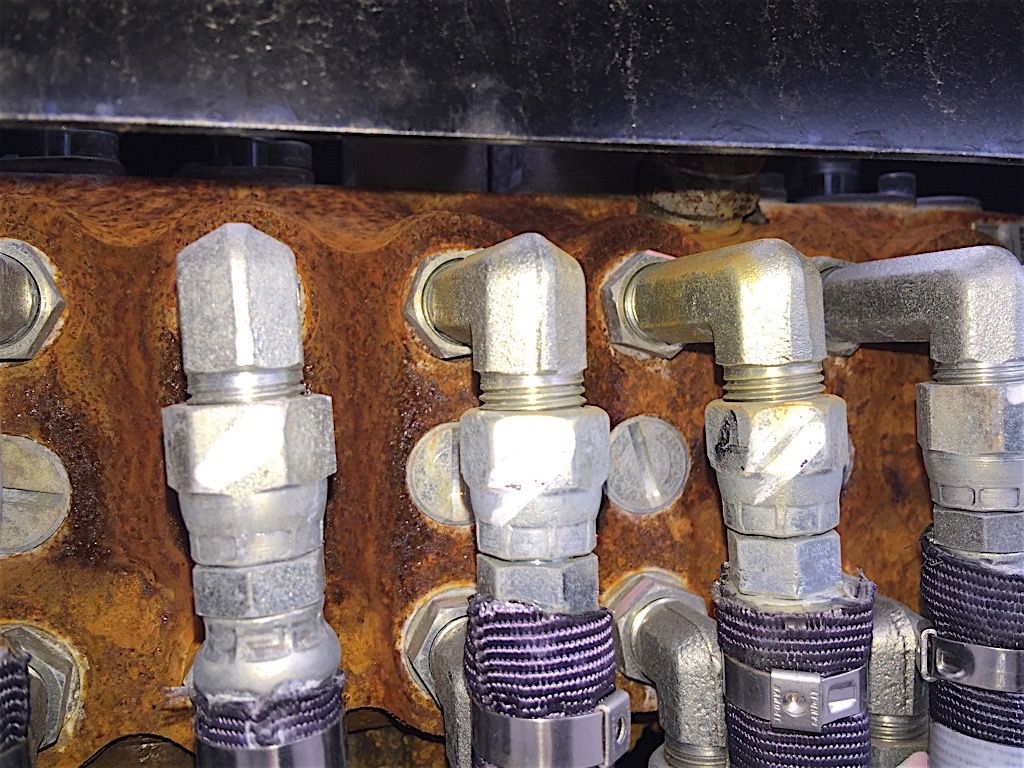

Buy it and take it home and spray the rusty area's with WD 40.

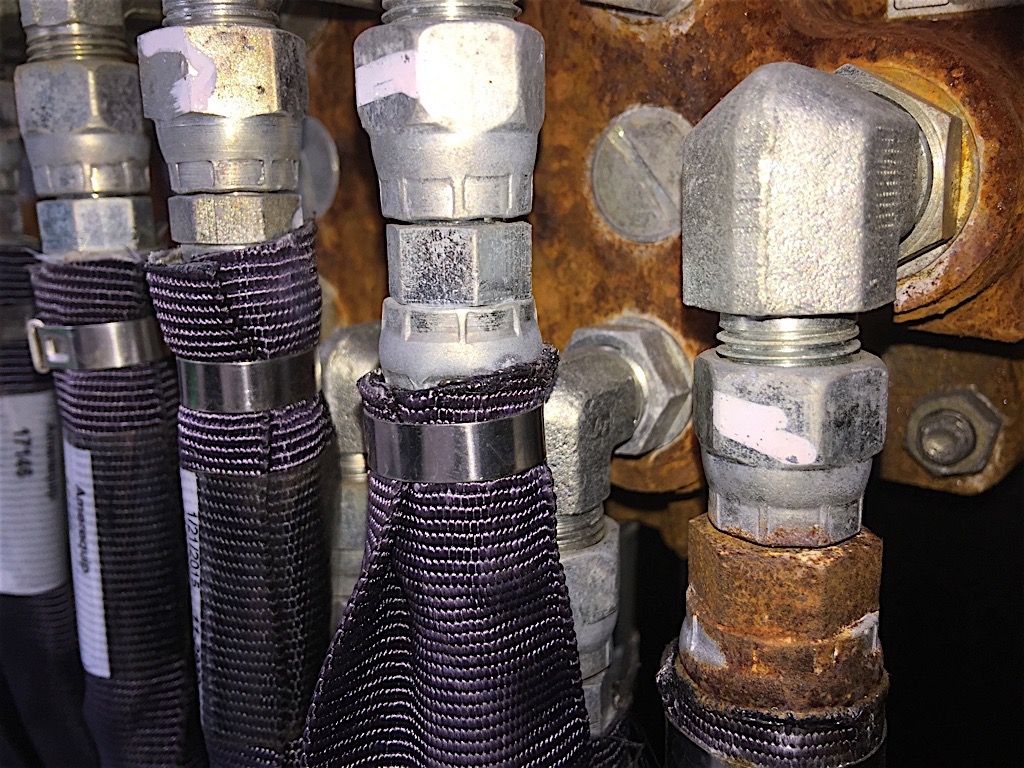

Galvanized fittings do not get to that level of rust in 6 months without help. You can just imagine where this will all lead to in 10-15 years.

:thumbsup: exactly. Let the dealer know about your worries and see what "dealer intstalled" options you can get out of him, like an extra pair of rear remotes and/or a 3rd function valve on the loader. You can get a lot of "bang for the buck" with these items. His costs are low and these are expensive options to the consumer. The $800 off costs him $800, while $1000+ in options might only cost him a little shop labor and dealer cost of the option.
Spray those area's down and don't loose a minute's sleep over it. The hyd. "block" is not going to rust through and a few hose ends that didn't get the best coating at the fitting factory will not fail due to rust.

I wouldn't worry on the rust on the ball ends, those will clean up. Hyd valve and hoses more concerning, but they might clean up just fine.

Smoke, fire extinguishers, and salt spray are all highly corrosive and damaging to any electrical or electronic wires, contacts, and switches. In my business any client getting thir equipment expsed to these three items replaces those items because even if they work tempirarily . . . they will fail.
An occasional salt spray hat gets hosed off is one thing . . but that is not what your pictures indicate. In my tractor search early last year I came across a unit like the one I eventually chose. But that first unit I saw was rusty in many places even though it was at a dealer where it had no ocean exposure. But it had been on a lot right next to a highway and must have gotten frequent salt spray from vehicles going past in winter. I would not have bought that unit for a 30% discount because the amount of repairs would endup being huge (plus ser warranty for electrical and switch limitations on coverage).
Tractors today are improved in convenience and performance over those of 25 years ago because they are made of different materials and technology. A tractor 25 years ago coukd handle wide spread rust much easier than today's units.
I'd find another product that us not already "substantially used" in its brand new state.
Lets recognize an important detail . . salt spray is one thing . . but the unit you pictured has been in an ongoing salt bath and that is a hugely different scenario.

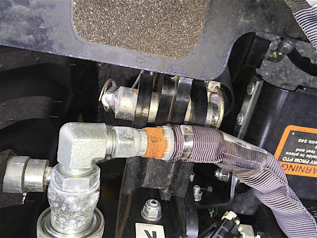

I would negotiate a larger discount and plan to replace the HYD QDs. A little bit of rust in the sleeves of the QDs will freeze them up. We have rusting problems here in the PAC NW and that is the first thing to seize up when forced like I am to store outside. Keep all moving parts lubricated and disconnect often for prevention. Remember a little rust always looks worse to the buyer than the seller.
