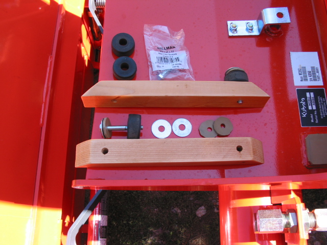

Best mods after the thumb was raising the seat a few inches. After that some handy things have been finding a used Bradco QA rock bucket. Nothing sorts rocks from dirt faster than a rock bucket. Also it was good to weld some real hooks on the bucket, and one small but important thing was to make a holster for the chain saw. Mounted like it is in the picture gives just enough room in the loader frame for a bit of spare oil, gas, chain, and tools all held in place by the chainsaw bar. You can see it in the picture.
Good Luck,
rScotty

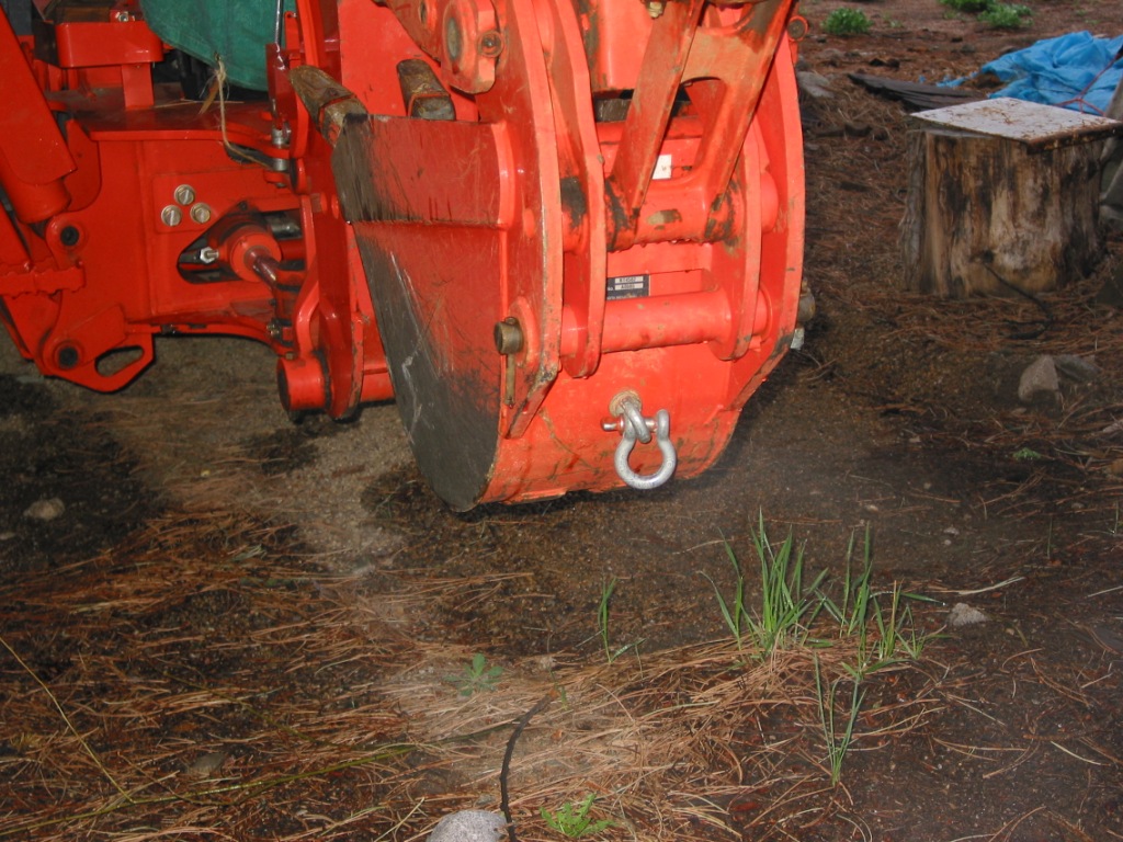

Glad you mentioned the hook on the bucket. I put one on the bottom of the bucket - actually mine is a heavy cast eye bolt through a hole drilled in the smallest BH bucket rather than a welded hook - and it is one of those simple but extremely useful things that makes you wonder everyone doesn't have it. At first I was afraid that the cast iron eye would interfere with digging or get itself broken off, but near as I can tell it never has taken part in the digging stresses at all.

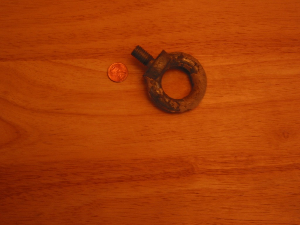

The eye bolt is an interesting alternative to a grab hook. I need to get a 12" bucket for stump removal and that would be a good place to try that. So far I have been wrapping chains around the bucket, which works but is hardly elegant.
I agree in principle on the rental approach

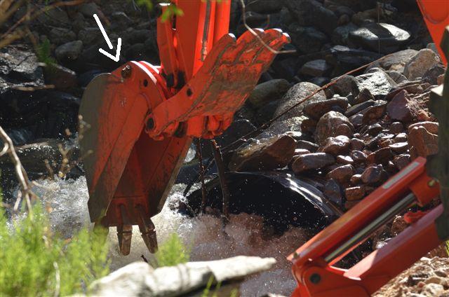

Wrapping chains around the bucket never worked all that good for me. Here is a picture showing what I did. The eye is 1/2" steel with a 1 1/4" diam. eye. all cast. This one got used because it was handy, but wish I'd had a slightly larger one so that the grab hook on my favorite utility chain would pass through it. You can see that the location is protected from digging. Inside the bucket is just a washer and nut loosely attached with the bolt end peened over so that the eye will swivel.
Agree on the 12" bucket being more useful in the mountains where lots of the work is with roots and rocks. Mine came with a 20" bucket that seems enormous. I've never used it.
As for the rental implements, it's nice to have the ability...but using a rental implement means mixing the hydraulic fluids and that has made me a bit gun shy on doing it with mine.
BTW, here is a picture with an arrow showing the spring pin that was original equipment on my BH bucket mount. If yours is like that, be sure to replace the spring pin with a double-nutted bolt. Otherwise something expensive can get bent when the spring pin falls out and that big pivot pin moves sideways. Easy to do when digging and really hard to spot in time. A real brain lapse by Kubota.
rScotty
The eye bolt does look like it is probably the simplest solution, and easier than welding on a grab hook and having to prep and later touch up the paint. Kubota did address the issue with the lynch pin on the bucket QA, and now supply a bolt plus nylock nut option.
I agree about avoiding mixing fluids with rental attachments. I am running the new SUDT2 fluid in mine by the way; no issues so far but I haven't done much with it yet being winter. I think I will get the hydraulic auger as I will need it for enough projects later to justify it after the pole barn build (wood shed, stock shed, fences, gates etc.; one can also get an auger-mount cement mixer). A nice thing about the M59 is the 16 GPM hydraulics, allowing low flow skid steer attachments to be used (it should work for a front mount snow blower as well).
It is good to see the bucket pictures - looks rather more used in these pictures, like mine! In your earlier picture of the chain saw mount the tractor looked awfully neat. Made me feel guilty as mine is still sitting out until I get some storage built.
